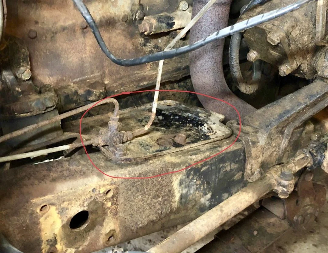

Ok, I’ll help get your mind off those silly points. What’s that flatish plate thingy circled in your pic? Looked at both my rigs and I don’t have anything, of course one rig is an SBC.

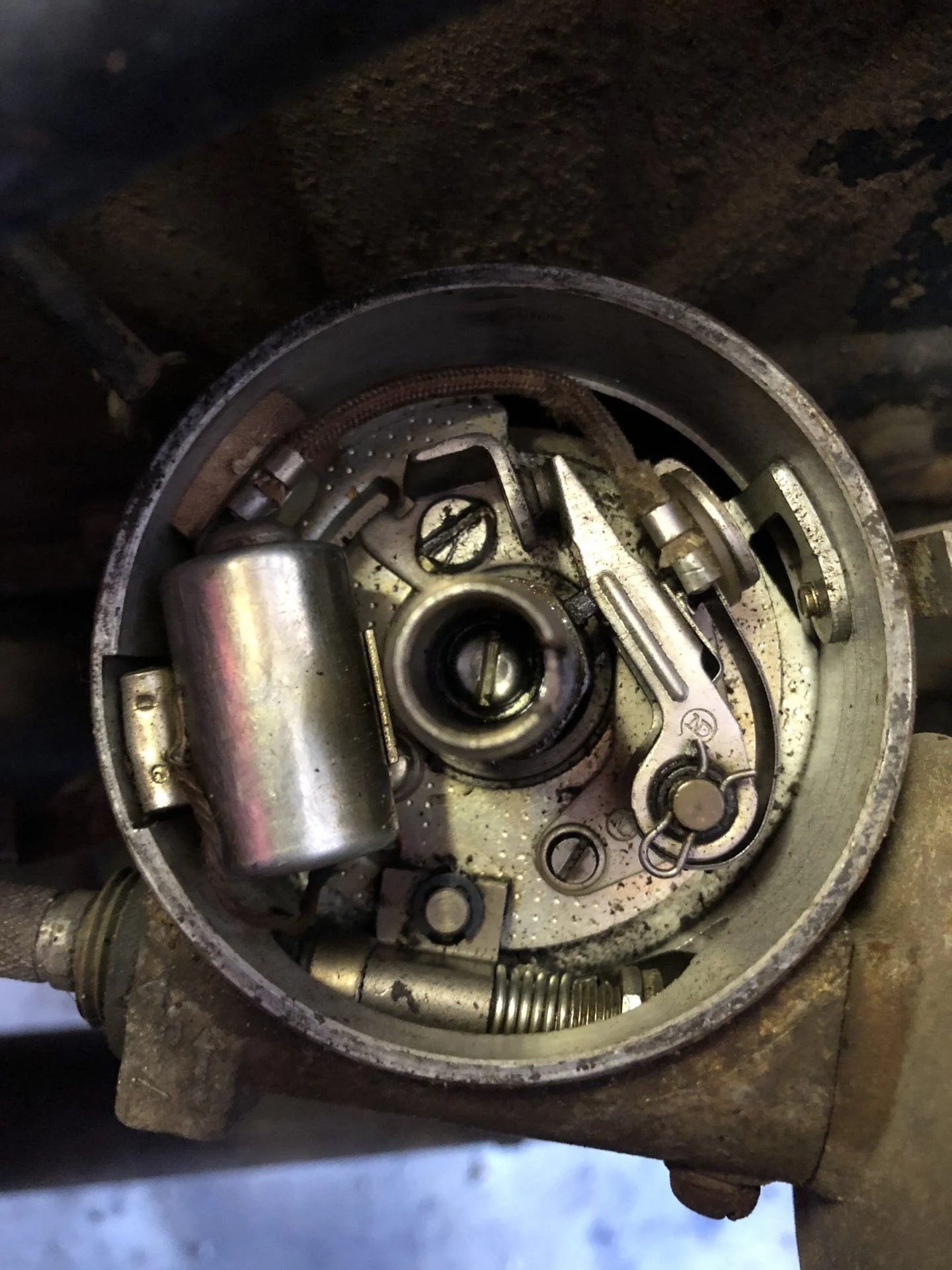

Any way to visually inspect?
Yes. open distributor, remove points, and inspect contact points. Points are inexpensive and you may just want to change and gap a new set as it is very easy.
While you are educating me tell me what all this does in here
Are they closed?
Are they closed?
Certainly appears so. If you look at the center shaft , there are 6 high spots on the shaft. there are flat spots also. Yours is sitting on the flat spot. That means they are closed. A few screws and they come out. When installing new ones, you will need to ensure the wiper that rubs on the center shaft is on a high spot. Then you can adjust the gap.

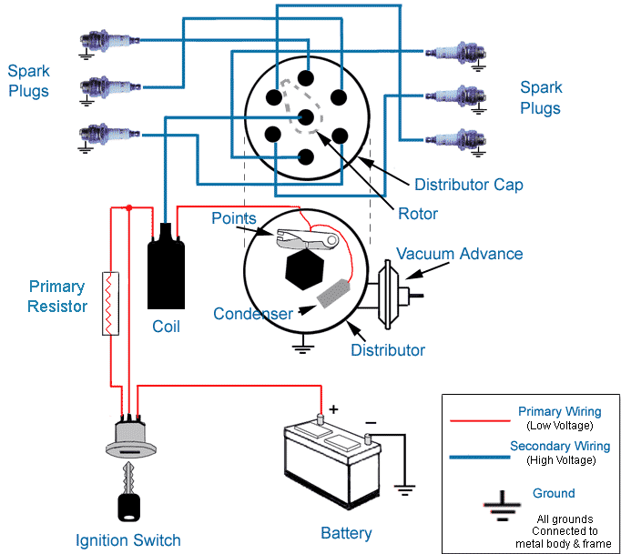

Thank you. That diagram helps.
This is all assuming me leaving the key Burned them up though, right?
When I get my new thermostat housing and fire it up it could be fine, right?
I’ll order some in the mean time but the housing will get here first
Sure they could still be fine. You can do a simple check by putting your finger on the wiper side and move the points open and see if they are stuck, or easily opened. Image shows what to move.

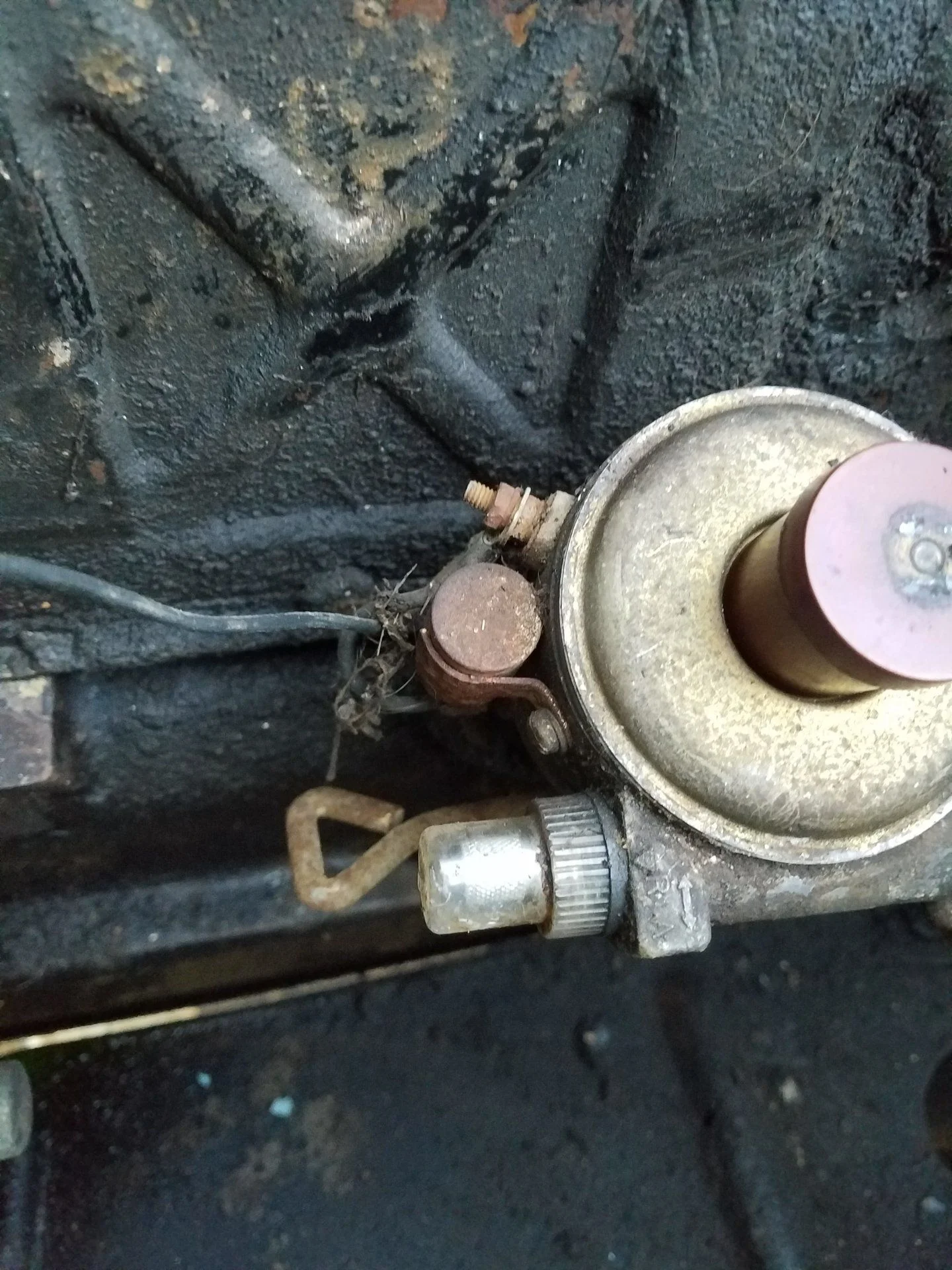

Anyone know why my condensor is outside the dizzy.
