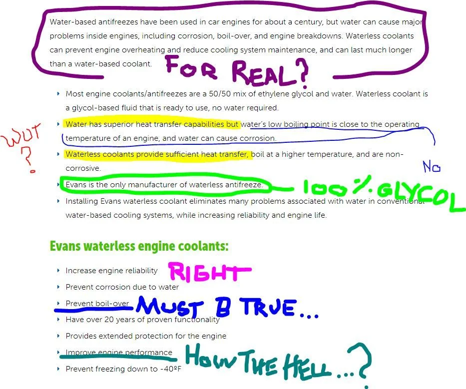

The only reason I'd change coolant types is for increased cooling ability. This product appears to have decreased cooling ability when compared to water-based coolants. From the website-
  • Water has superior heat transfer capabilities but water’s low boiling point is close to the operating temperature of an engine, and water can cause corrosion.
  • Waterless coolants provide sufficient heat transfer, boil at a higher temperature, and are non-corrosive.

Whats wrong with running 15% Coolant / 85% Distilled water + water wetter in hot climates? Does the trick for me...
That coolant has thermal conductance similar to a straight ethylene glycol... .27W/mK Which isn't great In simple terms this number is a measure of the solutions ability to carry heat out of the engine. The closer the number is to 1 the more capacity it has.
Ethylene Glycol / Distilled Water
  • 100/0 (100% glycol) 0.26 W/m.K
  • Your linked magic coolant 0.27 W/m.K
  • 50/50 0.47 W/m.K
  • 30/70 0.50 W/m.K
  • 0/100 (100% distilled water) 0.67 W/m.K
In addition to the conductivity the fluid needs to have the capacity. See the Specific Heat Capacity number. This is the measure of how much heat the solution can hold, expressed in J/(kgK). The rate depicts how many kilojoules of energy are required to change the temperature of one kilogram of said substance by one Kelvin
  • 100/0 (100% glycol) 2.69 J/kg.K
  • Your linked magic coolant 2.63 J/kg.K
  • 50/50 3.44 J/kg.K
  • 30/70 3.91 J/kg.K
  • 0/100 (100% distilled water) 4.07 J/kg.K
A high boiling point means nothing good for cooling, simply the more solutes the fluid has in it the higher the boiling point will be. So without getting waaaaay too deep in the properties of thermal transfers the coolant you linked would highly increase your risk of overheating.

But... it doesn't cool as well. It just has the capacity to hold more heat before it boils. Normal coolant boils at well above the point where your engine is already overheating.
All of their sites info is laughable.
They claim that 50% glycol/water boils at 226 degrees is close but doesn't factor in what the pressense of a radiator cap will do... By pressurizing the system the boiling point of the 50/50 mix is nearly 260 degrees. Their claimed max boiling point is even on par with that of straight ethylene glycol.
I'm convinced this is just 100% straight glycol that they are marketing and selling for a stupid mark up to suckers.
Literally I bet they are buying prestone concentrate at $10/gallon, putting it in their $2 bottle and selling the whole thing for $50+ S&H. For the love of god don't buy this bull****. If you want to see what it's like to run a straight glycol mix in one of the hottest places in the country just go to walmart and get a cart full of this:
