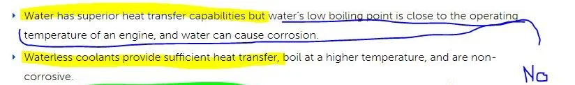

Lets examine some of the statements on the site.
    • "Water has superior heat transfer capabilities..." next sentence "Water-less coolants provide sufficient heat transfer" -
    • Waterless coolant is 60% worse at heat transfer than water... I guess that leaves what's 'sufficient' up to you....
    • The second statement about waters low boiling point is close to the op temp of the engine is 1) incorrect 2) assumes a straight 100% water mix 3) does not account for designed pressurization.
      • Water & glycol in a 40/60 mix under 13.7psi will boil at roughly 260 degrees
      • any mix of glycol over ~15-20% provides acceptable levels of corrosion protection
  2. Statements that running this coolant will prevent overheating is false and misleading

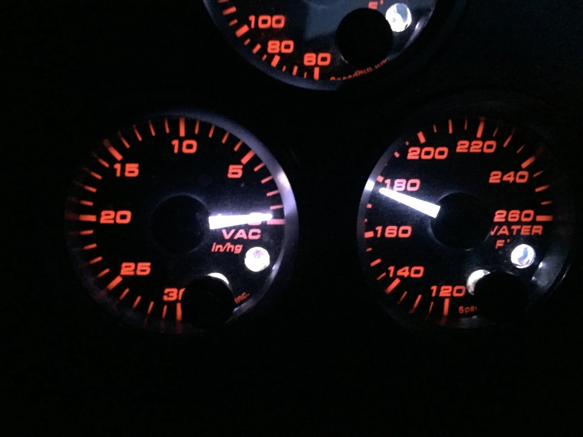

I took the photo below because I was shocked at how well it was cooling. This was about 3 miles from the top (Eisenhower tunnel). Notice my vac gauge is pegged at 0 showing I was still flat out when I shot this.
You got it, thats because it's not. @OffRoadScott you need to mix your own distilled water / glycol mix and shoot for an 80/20 or 85/15 mix. You can add a bottle of water wetter for increased protection against cavitation and air inclusion.
Proper mix + tight belts, a sealing radiator cap and a functional fan clutch go a long way. Remember it's a cooling system not a cooling component. Replacing my fan belts and radiator cap combined with a blue fan clutch and 85/15 mix resulted in my rig actually cooling itself down from 185 degrees to 177 after 40 mins of full throttle climbing to the 11,000' pass summit. The old snail maintained 65 mph the whole way, pretty surprising when you consider she tips the scale at ~7,000lbs and it was 96 degree ambient.
I took the photo below because I was shocked at how well it was cooling. This was about 3 miles from the top (Eisenhower tunnel). Notice my vac gauge is pegged at 0 showing I was still flat out when I shot this. View attachment 1746549

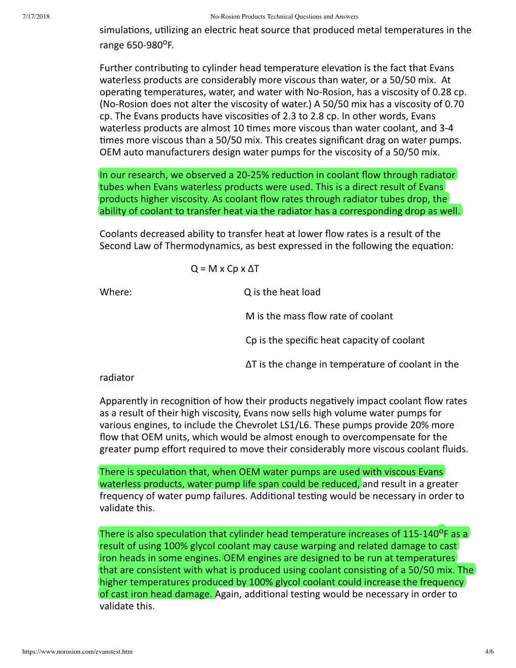

So it's time to walk away from the but dyno and catch phrase marketing.. Read this laboratory test report on how the Evans claims fall on their face. After you read this you will see that running Evans is doing more damage and exposing you to more risk than running regular coolant. Not to mention that the Evans mix is 5x more expensive than the exact same fluid thats in the prestone concentrate bottles you can get at walmart for $10
file:///C:/Users/reedn/Downloads/No-Rosion%20Products%20Technical%20Questions%20and%20Answers.pdf
sorry to pop your bubble. Perhaps this is a lesson that what they say on the bottle is meant to make you buy it rather than be truthful. The lab results don't lie. Stop being duped by a scam product.
I see this as being like which oil is best... use whatever makes you happy and understand and accept that other people will have different opinions based on various facts of varying legitimacy.
But the difference is that all oil we debate will provide adequate lubrication to help the engine last hundreds of thousands of miles.
Running Evans has serious negative impacts on the lifespan of the engine since it runs it so much hotter. It also increases the risk of warpage, valve seat damage, knock and overheating.
