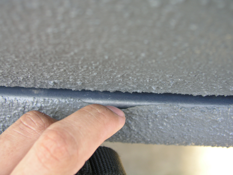

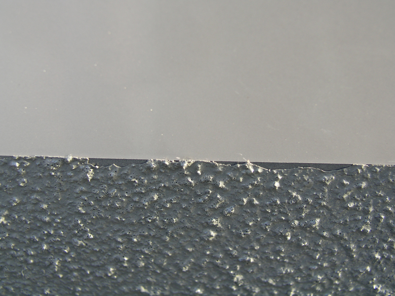

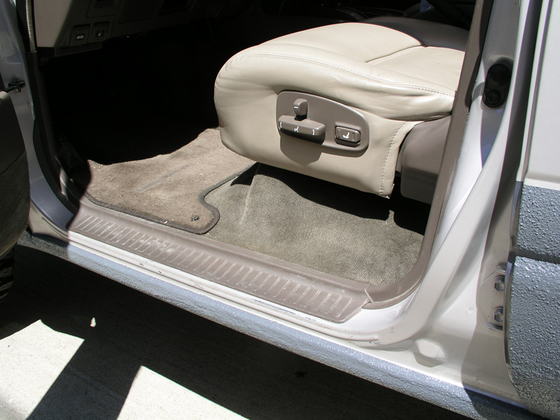

So my problem started when I was removing the tape after my fourth coat of Durabak wich seemed to dry very quickly on an unusually hot San Diego day (90° aprox). The first fender and door came off great then the Durabak started pulling off as I removed the tape. As I got around to the tail gate it just started going to HE!! where I had to pull iwth one hand and cut with an exacto knife with the other hand. The last side I did saw practically no sun all day but still hardened quickly and made removal difficult. So now I have edges on the door sill and on the tail gate where I can pull the lining away from the body. This is where more prep work near the tape would have been a GR8 idea. :doh: But after seeing my buddy the day before remove tape from his Herculiner job with no problem I wasn't worried and figured mine would go just as smoothly. So to fix these problems I am thinking of cutting back at the door sills so it doesnt wrap over or using what Durabak I have left over to finish off the sill, after really good prep work. I am also considering finding a good clear sealant that I could put on the edges where the paint meats the rough stuff.

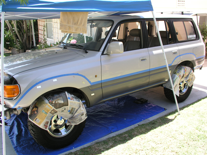

Before Without Flares (LUV it without flares)
After 4 coats and tape finally removed

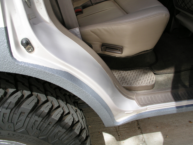

Here is the door sill where my foot steps when getting out of the truck.
And a close-up of where the tail gate just went to HE!!

Looks good! Prep is the key to avioding little spots like that though. You could probably carefully remove the loose edges by cutting back from them with a razor blade or exacto, the remask and really rough up those spots then re-apply. If you are careful it should look fine. You'd notice it on close inspection but it would keep it from peeling back. Roughing it up sufficiently and cleaning it off with xylene before applying the liner is a must.

Pics are working for me firetruck and Shep yeah I think that is the best solution so I plan to do that this afternoon and tomorrow.

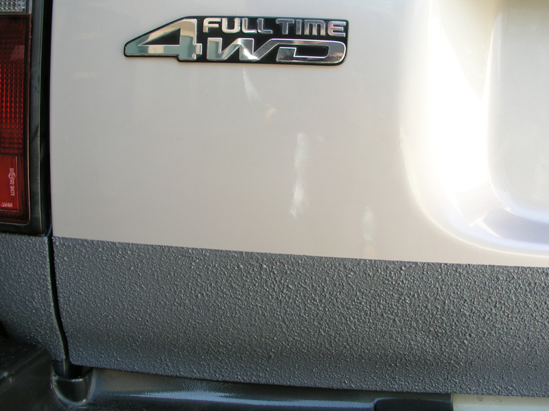

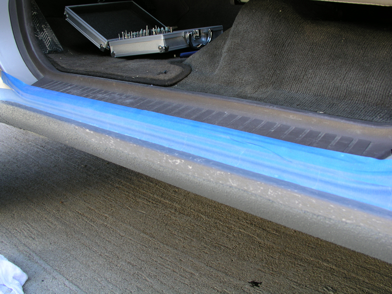

OK, so I fixed my major problem areas this weekend. One main problem was I didn't do the door jams and the Durabak ended at the corner of the door sill. So I re-taped and cut away the lining on the drivers door sill where I had pealing.
Here is how it blended just an hour later and it's decent but I hope it gets a little better after a night of drying and sealing.
Here is the back door

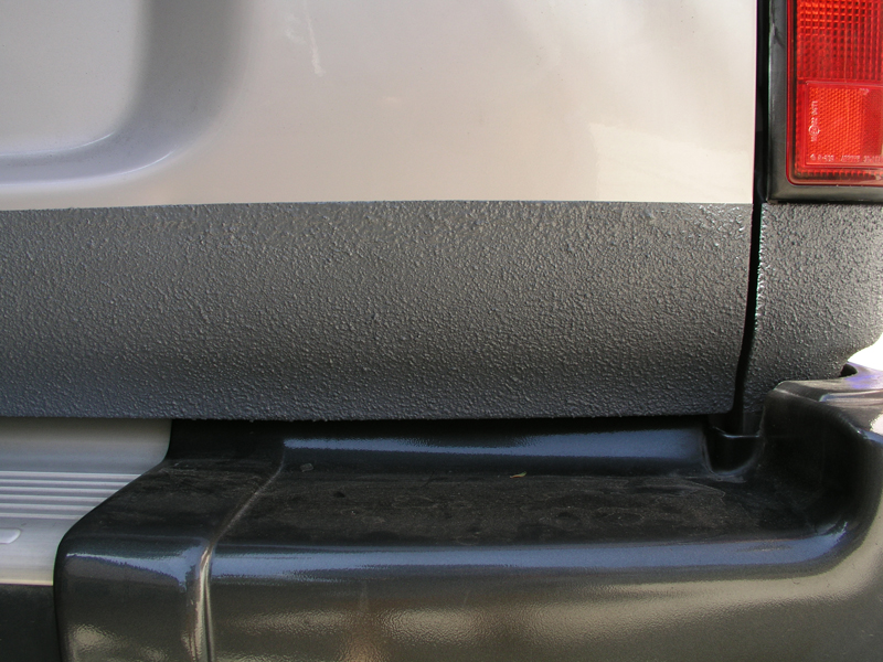

The other problem was the tail gate so I just re-taped that a little higher and used a small dremel brush to chip away an 1/8" of lining and scuff up the paint again. So here are some shots.
The left side blended a little better than the right and I probably should have bought another roller instead of using a brush.
But at least someone will probably learn from my experience.
Left
Right
The fix looks great.
Your "left" and "right" look wrong. (same image?)
BTW: that's a nice looking Dremel case.
now that looks clean and done right. Nice job. I can't wait to see if yours fades out any since it's grey. My black does, so i have to hit it with armorale every so often.

First off, I will state that the Durabak is very textured. I called it stucco when I first had it on. But it has held up very well and the UV coating has surprisingly held it's color better than I would have imagined.
I did use aluminum tape over the holes, if you are comfortable with bondo I would recommend a light coat over the tape because with just the tape you can see an indention if you look really closely.
I did 4 coats of Durabak using 1 gallon of material. I did end up buying an additional quart to repair a few spots you can see up in previous posts.
If you want a smoother finish I would recommend the Al's Liner and I will see that being applied first hand as my buddy is going to go that route with his Lexus.
Anyway I think that answers all the questions I have had over the last couple of weeks via my PM.
So this was Day 1
And this was last August, 2012 - 5 years and 9 months later.
