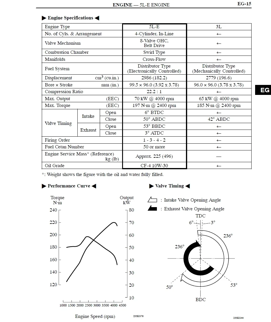

Took some measurements, talked to a liner manufacturer. They say that the 5L liners are, in fact, too large for the 2L series blocks. This would imply that the 5L engines are longer than the 2L and 3Ls then. However the 3L and 5L share the same crankshaft, so I'm confused.
With my calipers, it seems that there is about 14mm between each cylinder, at the thinnest point, counting the liners. This means that there is about 10mm of block material between the cylinders.
Running 3L liners and pistons would reduce block thickness to 6mm.
Running 5L liners and pistons would reduce block thickness between cylinders to only ~2.5mm.
However, I believe I should be able to run 3L liners and pistons. If I opt for the 1mm oversize stuff, I could still get displacement up to 2.7L.

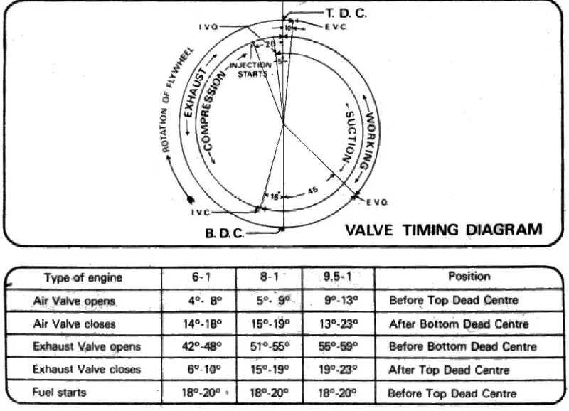

At 190 g/Ps/Hr, the 2LTE and 2LTHE should indeed be running at a max of about 31% thermal efficiency.
The Lister engines, which use, what seems to be, a modified Ricardo Comet I combustion system, run only a 17.5:1 compression ratio. Apparently they cold start just fine, and without and glowplugs too.
I think this lies in the Comet I system, in which ~70% of air is forced into the swirl chamber, and with the cam timing, which is radically different from modern IDI's.
