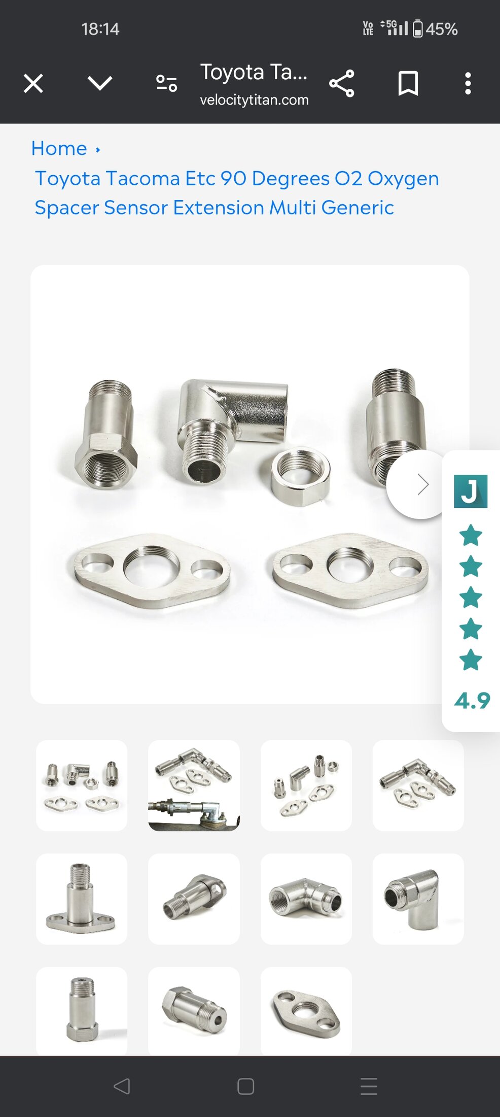

you need a sensor spacer or resistor trick or a cat to fool the sensor.
Like this?
yes.
i don't have experience with the spacer but people swear by them.
i resisor modded mine and it works fine unless I have to to do a bunch of stop and go traffic.
