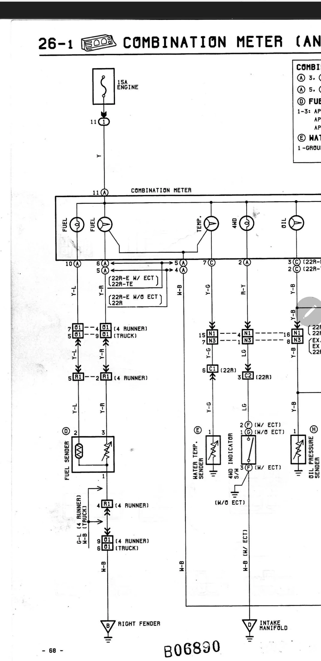

So that's a bit confusing to me I then found the factory pinouts and I am having trouble figuring them out. I see on the cluster with Tach C6, C-5-1 (not sure what that means) Without Tach I see C-5-2 (Not sure what this means) and C-6. Then it looks like the fuel gauge and temp gauge on the tach cluster share C-4-1 and C-5-2. I am wondering if I should switch pins 1 and 2 red\green and red\yellow. I am just a little nervous I may damage something. Hopefully someone can help me out. Here is a pic of the wiring diagrams..
you need to have key on from pin 11. that runs through the gauge and OUT pin 5 to the sender.
both clusters appear to be pinned the same. however my ewd (86) shows pin 11 as yellow. may or may not be relevant but this is what you should be seeing

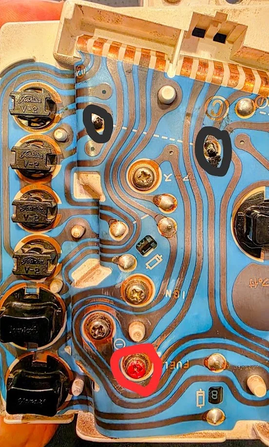

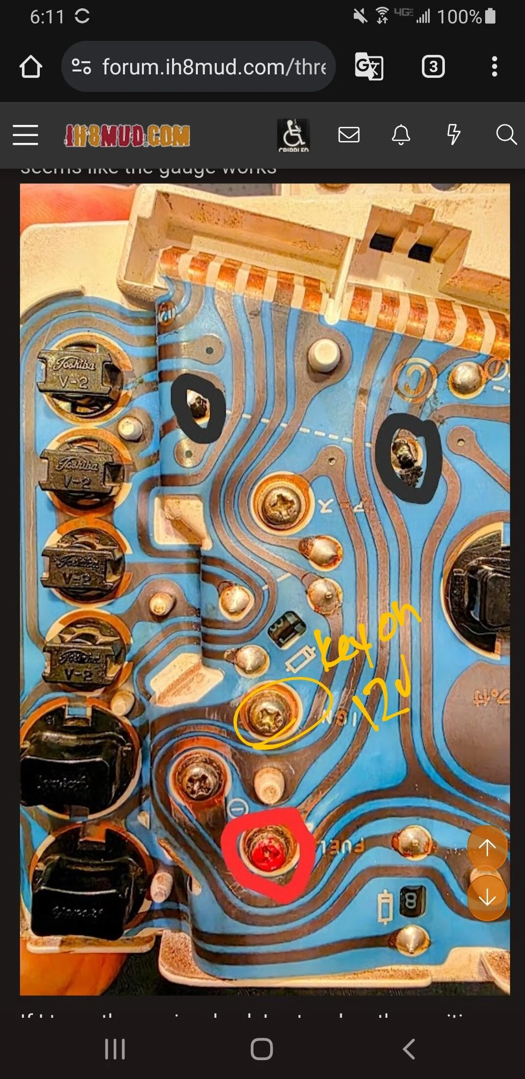

Thanks for the reply and bear with me as I try to understand this LOL.. I did some more testing and Pin 2 and 11 on connector C show ground with ignition off then 12v with ignition on. The red screw on the fuel gauge in my pic is constant cround all the time. The top screw you circled is gnd with the ignition off and 12v when ignition is on. The Screw labeled - is gnd all time. Could you elaborate more on "toggling resisted ground through the yellow wire in #5 should change the gauge position" as it is always showing ground. How would I accomplish this? Thanks again!
your red screw goes to pin 5.
power comes into the gauge from pin 11. exits the gauge from your red to pin 5 then goes to the tank sender.
the gauge moves based on that resistance value. the values should be shown in your fsm.
if you don't have some kind of voltage at #5 with the key on, you have a gauge problem. it should not be grounded.
Yup I double checked I never get voltage on pin 5. Checked with a meter and test light. Crap sounds like the gauge is bad. Wonder where I can source one of those? I have one from my 93 Land Cruiser and it looks pretty much the same. I doubt it is though. Could not find any part numbers on it..
do you have voltage at the screw i show in yellow?
Yes The top screw you circled is gnd with the ignition off and 12v when ignition is on. The Screw labeled - is gnd all time.

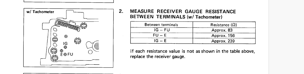

I think maybe you are correct and I have a bad gauge. I found this in the FSM:
My reading across the IG-E terminals only shows 40 ohms. The other two readings were 96 and 130 so a bit out of tolerance. I am going to source a new gauge and try swapping it out.

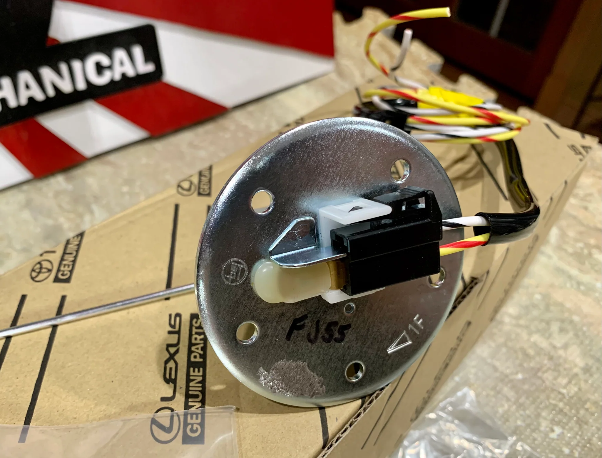

is your fuel tank sending unit on your 87 a single / 1 wire or a double / 2 wire style type ?
This is a
double / 2 wire type below .....fyi
This is a
Polishing those contacts was one of the first things I did and it did not help anything. As for my fuel sending unit I am not sure, but since it was a base model truck I am assuming it will be the two wire sender. I am hoping to convert it to a three wire to get the fuel warning light to work.. I'll cross that bridge soon when I remove the bed.
make sure the cluster actually has the light, first... ask me how i know 😂
LOL it does he sent me pics of it. Do you have any experience making this light work on a non SR5 truck? Looks like to me the C10 connection yellow and blue wire is what is uses.
as long as the wire is there its gravy.
otherwise you will need to add the wire from the cluster to the sender. but its simply just that one wire. it works like the sender. power from the key, through the light and grounds through the sending unit.
that diagram i posted above shows it
