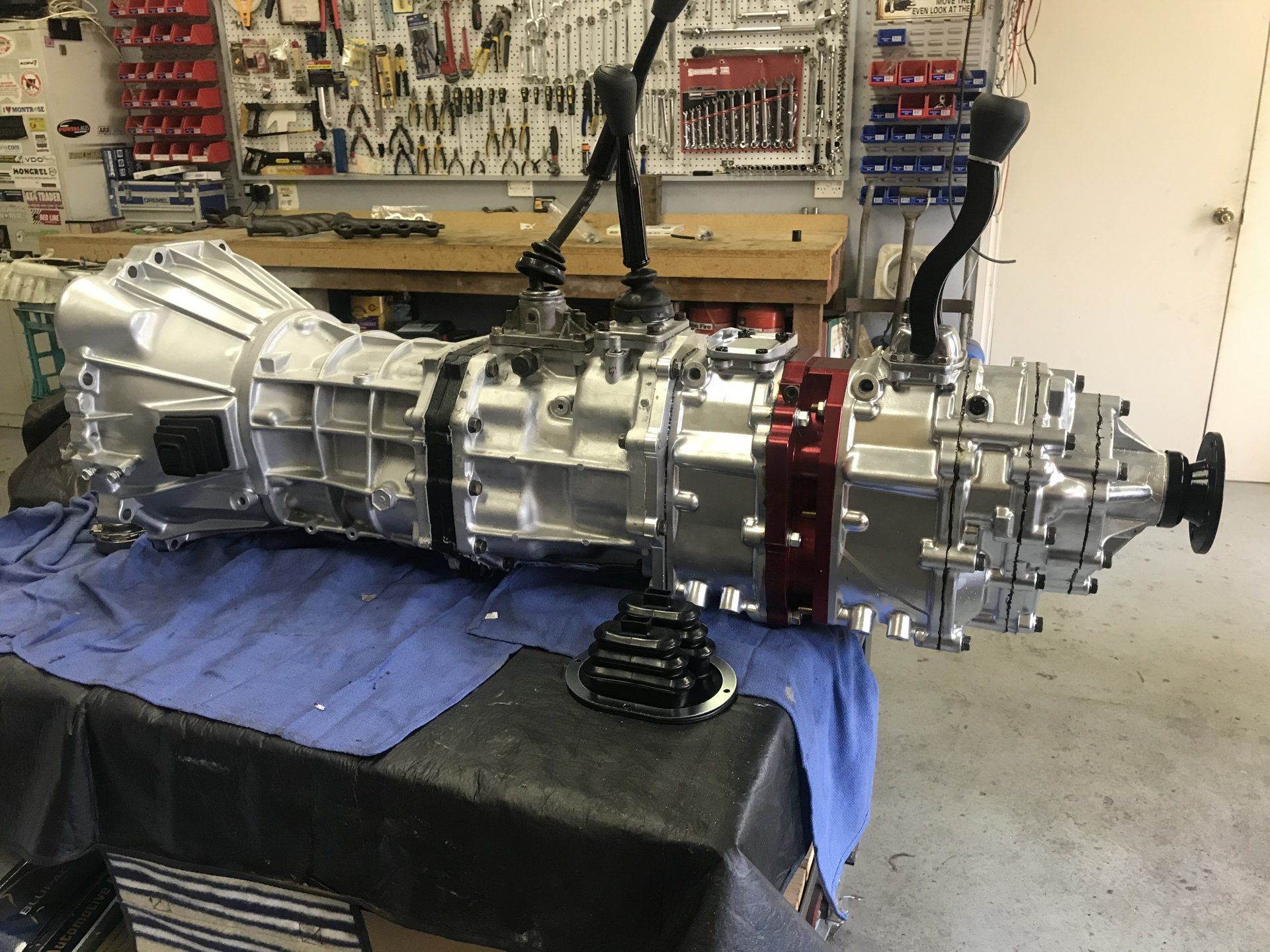

Have a look here, link below to Pirate, everything you need to know :).

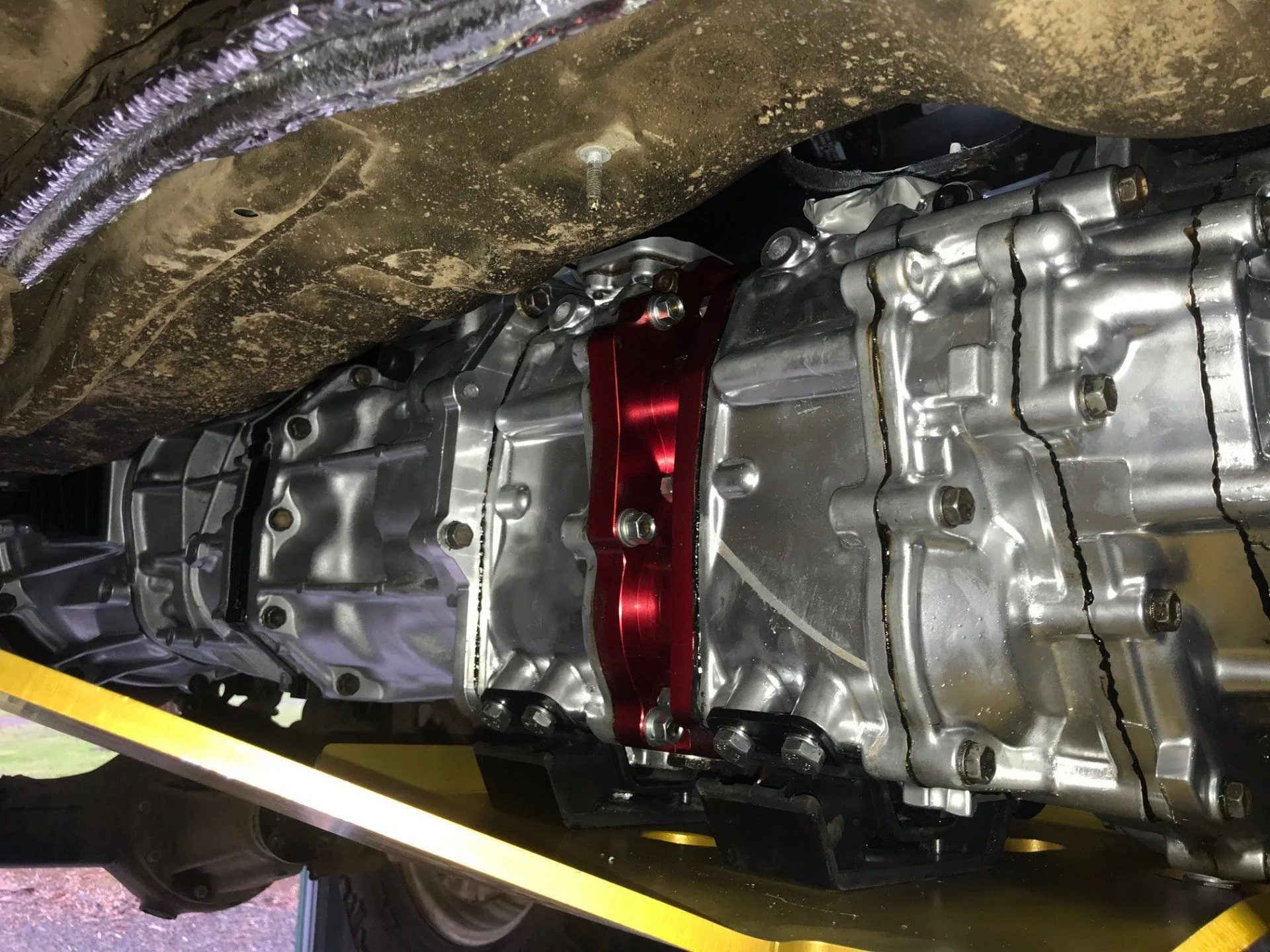

I've been mucking around with my crossmember for the last few weeks rebending it to move the gearbox centreline over by 15mm to actually get the transmission in the middle of the tunnel....
Aftermarket isnt all its cracked up to be. And 10mm plate takes a lot of bending to move just the centrline and keep everything else in the same plane....
Plus I had a machine shop add an access slot for the front driveshaft bolts so I can get to them underneath AND move the drain hole for the crawl box as they got that wrong too despite my mm perfect dimensions as to where to put it sigh.
Yes, all Marlin except the R151 to gear drive, thats Trail gear.
