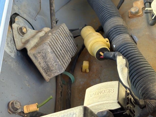

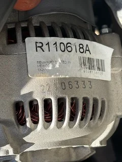

I headed to one of the autoparts store and did find one that had the equipment to perform a load test on the battery so we could rule that out. Battery passed of course. They were also able to test the alternator with the same tool and the alternator passed, but the voltage regulator did not. So, now I'm looking around for new voltage regulator. But all the ones I see online don't look like the one I thought was in my 4Runner. Which has me wondering what this block with fins behind my fusebox on the passenger side of the engine bay is.
So after doing some more digging, I've now figured out that Toyota (I'm a noob to Toyota), has the voltage regulator inside of the alternator! So after looking at the cost of a new voltage regulator and an alternator, there's not much difference in price. Depending on brand, a rebuilt alternator is cheaper than the voltage regulators that are available. So here are my questions:

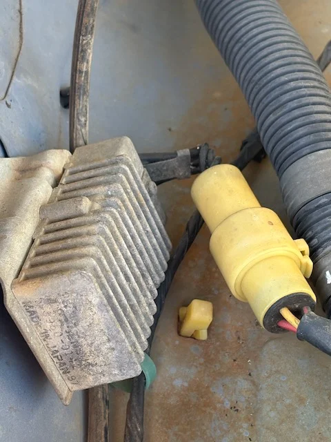

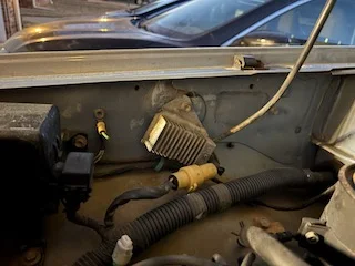

  • What is that part behind my fuse box with fins connected to the harness with the same 3 prong plug as the one going to my alternator?

All the Toyota alternators of this vintage that I've seen have the regulator built in. IDK how your parts store tested them separately.

That part on the picture is not a regulator it looks like a battery isolator for a dual battery set up. Your regulator is inside the alternator, you could buy it from Toyota if you want good quality or take it to an electrical shop that works on generators/alternators etc.

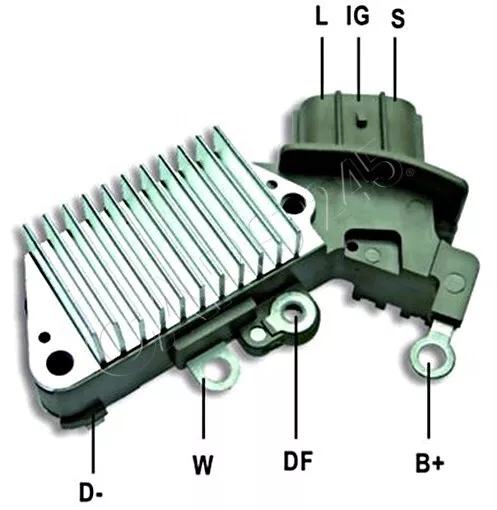

This is a typical Toyota/Denso voltage regulator.

If it had Denso/OE alternator @gnob, that would be an easy decision, just replace the voltage regulator. I'm learning quickly that any Denso parts should not be suspect or replaced without sufficient testing.
Too many alternators are junked when that is all they need. Shoot, most of the time you can drop in a set of brushes and call it a day. Same with starters ... contacts, plunger, and done.
Totally agree @pappy. One thought is to buy another complete alternator, and then when I have the spare funds, replace the voltage regulator in this remanufactured unit from Mexico that was probably and auto parts store sale, which is typically a price point and high margin return item than a quality part. Obvious on the latter in that voltage regulator failed. But having a spare alternator might not be a bad thing. But then again, Toyota used this alternator on a lot of vehicles from that era and supply should be available for the foreseeable future.

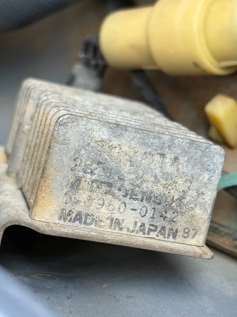

I don't think it is a battery isolator for dual battery set up. It's a Denso unit, but the part number is a bit faded to tell for sure. And it's clearly factory tied into the harness. I doubt the factory had a dual battery setup.
Correct, not a battery isolator. That is the resistor pack for the fuel injectors.

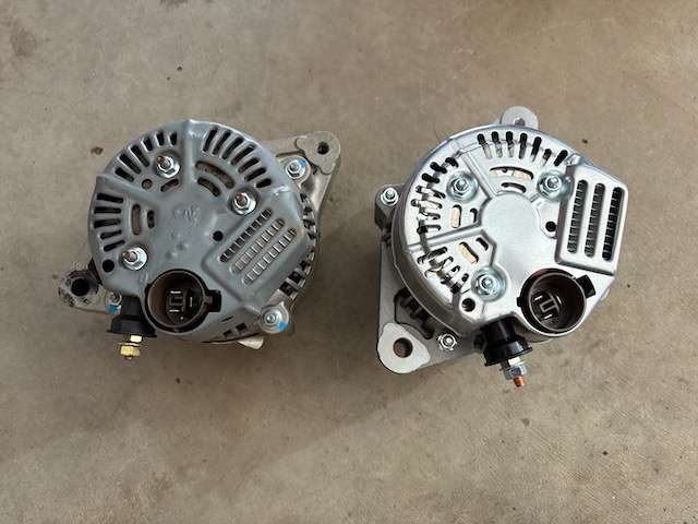

Okay, I acquired a whole new alternator over just replacing the voltage regulator. I chose a new alternator over just replacing the voltage regulator, mainly because the cost was about the same. Picked up a new AC Delco alternator over a remanufactured unit. I know... it's not OEM or even a popular Asian brand, but AC Delco in my experience has produced many fine alternators, both domestic and foreign.
As a result, all the lights on the dash went out after putting the new alternator in. I'll keep the old alternator and get another voltage regulator when I have the spare funds. That way I have a spare alternator if I need to put another in.
The old alternator is on the right in the below picture:
The AC Delco has a better fit an finish the old one which was a remanufactured unit.
