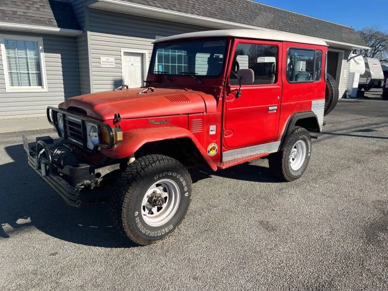

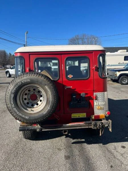

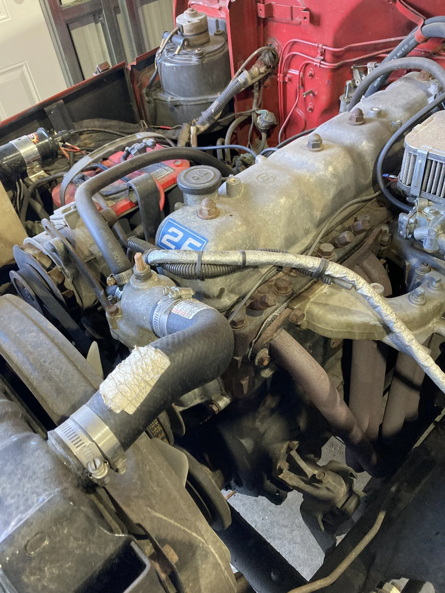

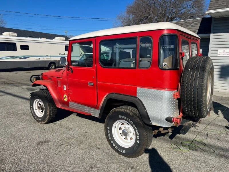

Found this 1980 I took a look at over the weekend. I looked under the truck at the diamond plate areas and didn't see any rust holes but maybe I wasn't looking at the right areas. Mininal rust on the floor. Seams on the top didn't appear to have much rust. Some rust on the front fenders but the owner had purchased 2 new fenders he never installed. Has been sitting a while so took a bit to get it going but once warmed up she ran well. Not sure if the brakes need some work or that's just how brakes from 1980 work but almost went through a red light when trying to stop. Took a long time to slow down. Glad there wasn't anyone in front of me. Asking $18,000. To me seems like a good deal.

Personally the Diamond plating is no go for me.

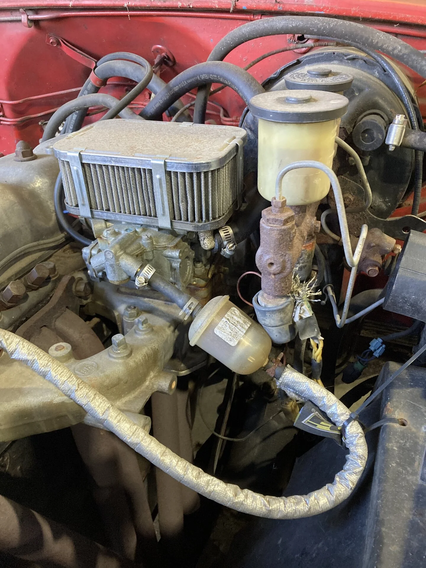

Brief look at pics, paint everywhere under the hood around engine.
You can do better, pre 79 has less rust in most cases. Definitely find one in south.
It could be a great truck, but this wouldn't be the one for me. Mostly because of the diamond plate which may or may not be hiding rust (given it's in the NE, it's probably hiding rust) and the cut quarters. Also not excited about the overspray on the hardlines and rubber under the hood, aftermarket carb, fenders not being painted on the engine bay side, etc.
I'd be surprised if there wasn't a pretty sold exhaust leak here. The flange shouldn't be bent like that.
