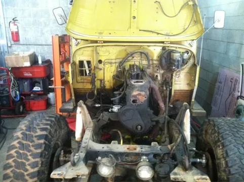

Donor is getting moved to the engine stand next week for disassembly .
Okay back to business. I'm slow I know.
Got the motor on the stand. What a mess. It's an 84 supposedly with 275k on it.
What a mess. But it's not what is on the outside that counts.

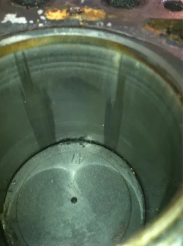

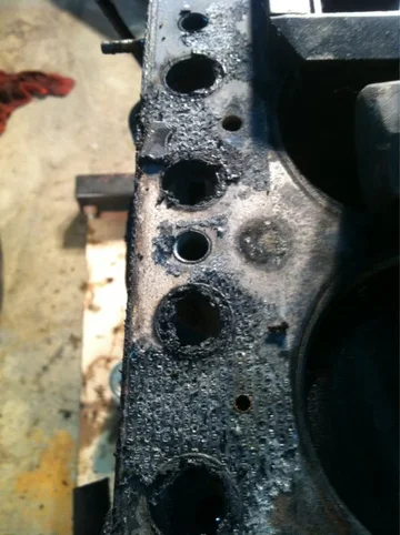

Yanked the head and immediately found out what was wrong with the motor. Blown head gasket.
Between 1-2
This is where it got interesting. A motor that has 275k on it should have a good size ridge at the top or oversize pistons. No ridge at the top. Pistons are standard size and the bore specs out. So my assumption is that there is no way this motor had 275k on it. Maybe 75-125k. Bearing we're all in pretty good shape as well. Cam looks almost brand new.

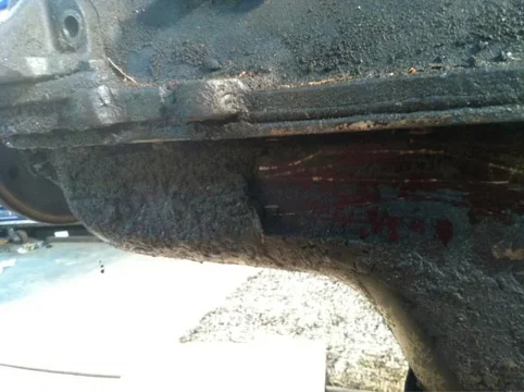

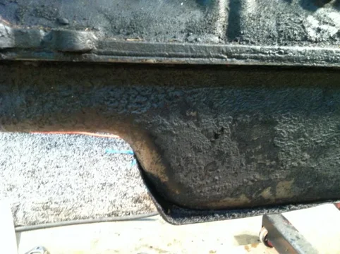

Upon draining the oil I had a good gallon of water come out before the oil.
You can see how deep the crap was on the pan after I scraped a layer off

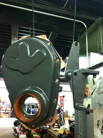

Parts to be powder coated by Smoking Gun (ACC).
More parts.
Parts getting cobalt plated they will all be black.
Smoking Gun doing their magic
First bake
Second bake
Third bake
These guys don't mess around. Plus they are a cruiser shop and know what needs to be covered up and what doesn't. I told Brian to keep it classy and that was about it. My next motor I do with them won't be so tame.
