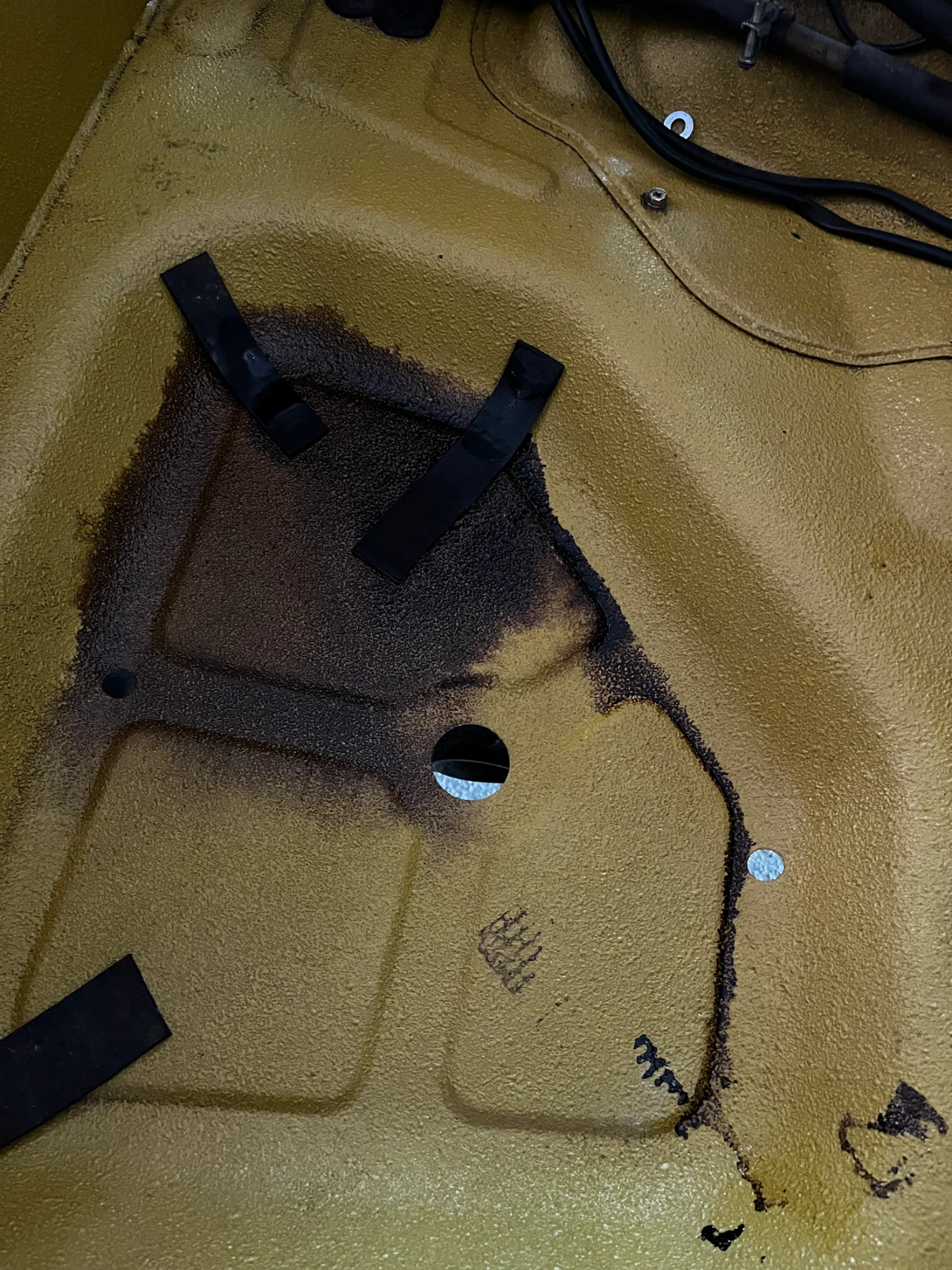

Mystery solved. I used some torch down rubber roofing material strips under the gas tank. The last bit of gas wicked out sideways under the tank as it was draining and the gasoline dissolved the rubber torch down material and turned the gasoline black. It was a bone head choice of material to use in that situation. Strange though that rubber fuel hose handles gasoline without any degradation but rubber roofing material turns to mush.

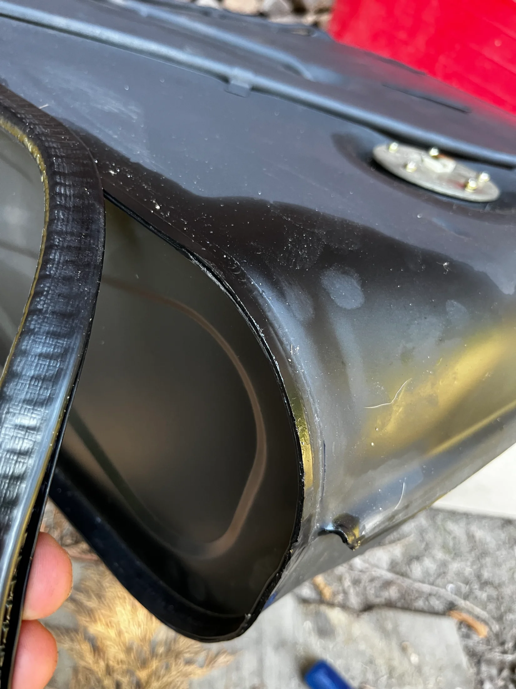

The gasoline tank from CCOT has leaks in the upper corners. It came with a rubber tubing that covered the seams. Had I looked underneath when I first got it I probably have noticed the problem. Oh Well. Hopefully they’ll make it right
CCOT isn't my favorite vendor. I don't think POR gas tank liner is very good stuff. Learn to inert the tank properly then Weld/braze, silver solder the leaks. Next do an alcohol resistant liner. There are gas tank rated epoxies - might be ok at the top where the gas only sloshes on the leak spot
