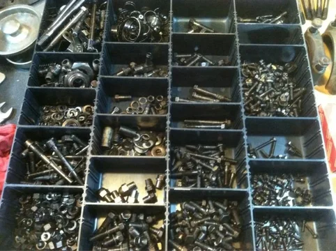

Well I got 99% of the parts in and ready. Sorted everything.
All black zinc.

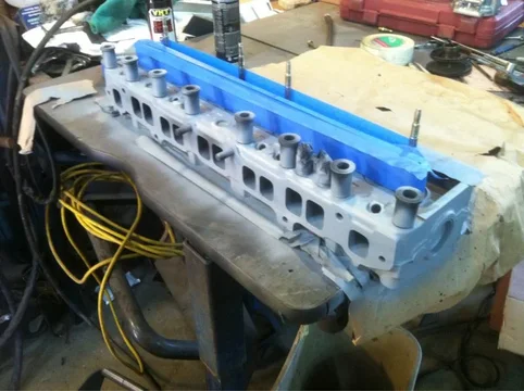

Primed the block
The head

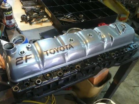

Top coated with semi gloss black
More

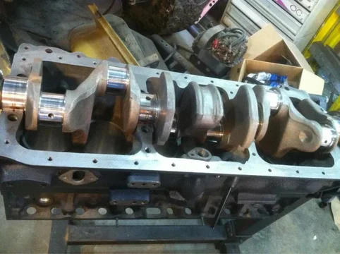

Set the crank.
