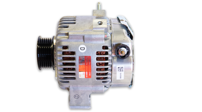

I buy only Toyota remanufactured. A second choice would be Denso reman. Both are Denso, but Toyota is remanufacture to a higher standard.
I would go with dealer reman. I have been happy with mine and don't trust others.

You can also buy the 2003+ 130A Denso Reman alternator that is in stock. Swap the connector and nothing else is needed.
If you had more than a week (like maybe 2 weeks), then I'd say the local rebuild is the best option. You can buy OE voltage regulator, brushes and both bearings for $150/delivered. Typical remanufactured alternators only change the parts that are bad/out of spec and who knows which replacement parts they are using.
Alternator went out on mine and tried putting a Non-OEM (O'Reilly) which had problems and still displayed the charge light. Got a Toyota Reman. and has been great.

Thank you everyone for your detailed replies. Rebuilding the old one myself is too much in this case, so I decided to go with purchasing the OEM rebuild from Toyota dealer (just not the local one in CA). Ended up ordering the following:
Part NumberPart NamePriceQuantityTotal
27060-50260-841998-2002 Toyota Land Cruiser - Alternator$207.621$207.62
90980-11349Housing, Connector Female$8.511$8.51
Plus the Standard Shipping: $27.58
Where $207.62 includes the Core charge of $75 as this is from the official Toyota dealer.

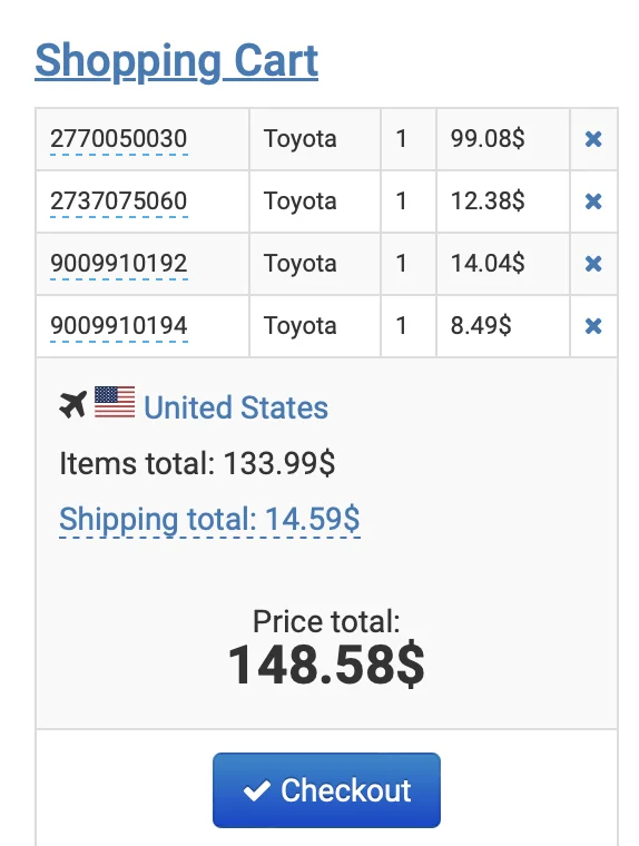

180 amp alternator from DC Power.
