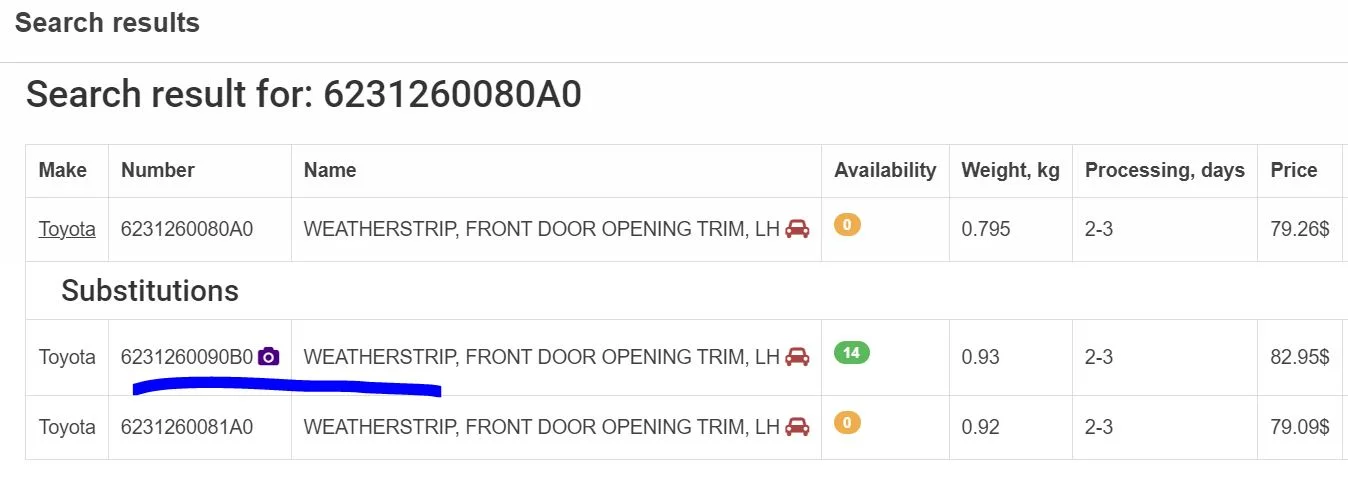

QUESTION 3:
Driver's side weather strip on a door. I have tan/beige interior. The only PN that I am coming up with (and stock) shows what seem to be gray part? Is that correct or it's something else? Only substitution available..

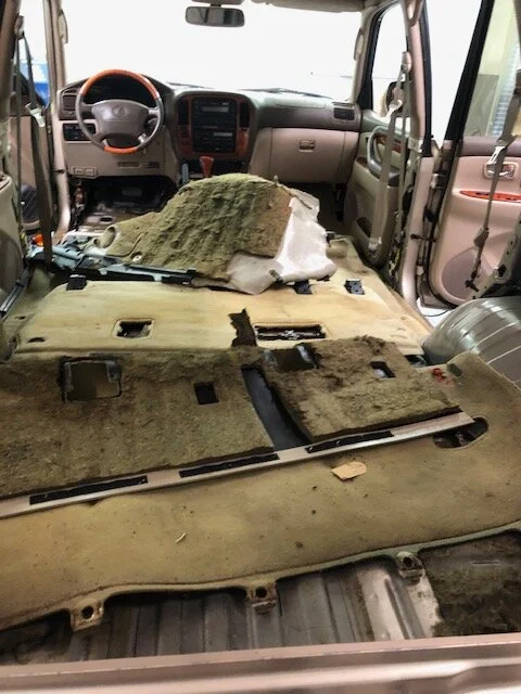

Moving on. Interior out. Very filthy. Pictures here. Someone looks like spilled oil in a trunk, all insulation under carpet soaked. All carpets out, will be getting thoroughly cleaned. New leather in process of ordering. Seat belt webbing will be replaced. Other than that - interior was never disassembled, that's good part.

Meanwhile - all carpets pulled and cleaned. Some stains just wouldn't give up, but those won't be visible. Cleaning process underway, after it I will start assembly as much as I can. It sux because it's ideal time to run wiring.
