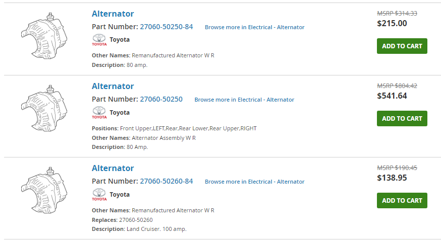

Boch Toyota has OEM Reman part number 27060-50260-84 at the link below for $135.30.
27060-50260-84 - Alternator - 1998-2002 Toyota Land Cruiser | Boch Toyota South
1998-2002 Toyota Land Cruiser - Alternator - 270605026084. Genuine Toyota® Parts & Accessories. Manufacturer Warranty. From the Dealership to your Door. Experts standing by.toyotaparts.bochtoyotasouth.com
Serra Toyota has the same part number but the description says Reman Alternator with Reg/Assy for $230.
Remanufactured Alternator with Reg Assembly #27060-50260-84 | Autoparts.toyota.com
Boost your Toyota's power system with our Remanufactured Alternator with Reg Assembly. Ensure a smooth drive and efficient battery charge.autoparts.serratoyota.com
I thought the part number is the part number. Do I need the one with a Regulator assembly?

There's always the Sequoia ones.Picked up an OEM reman for $133 at my local dealer in San Juan Capistrano and am back in business. Not sure how long it will last as the OEM lasted 24 years. Removing the alternator was cake in my 99 so if it does go out I’ll be able to swap it out quick. I wish a new OEM alternator was still available and would gladly pay a premium for it.

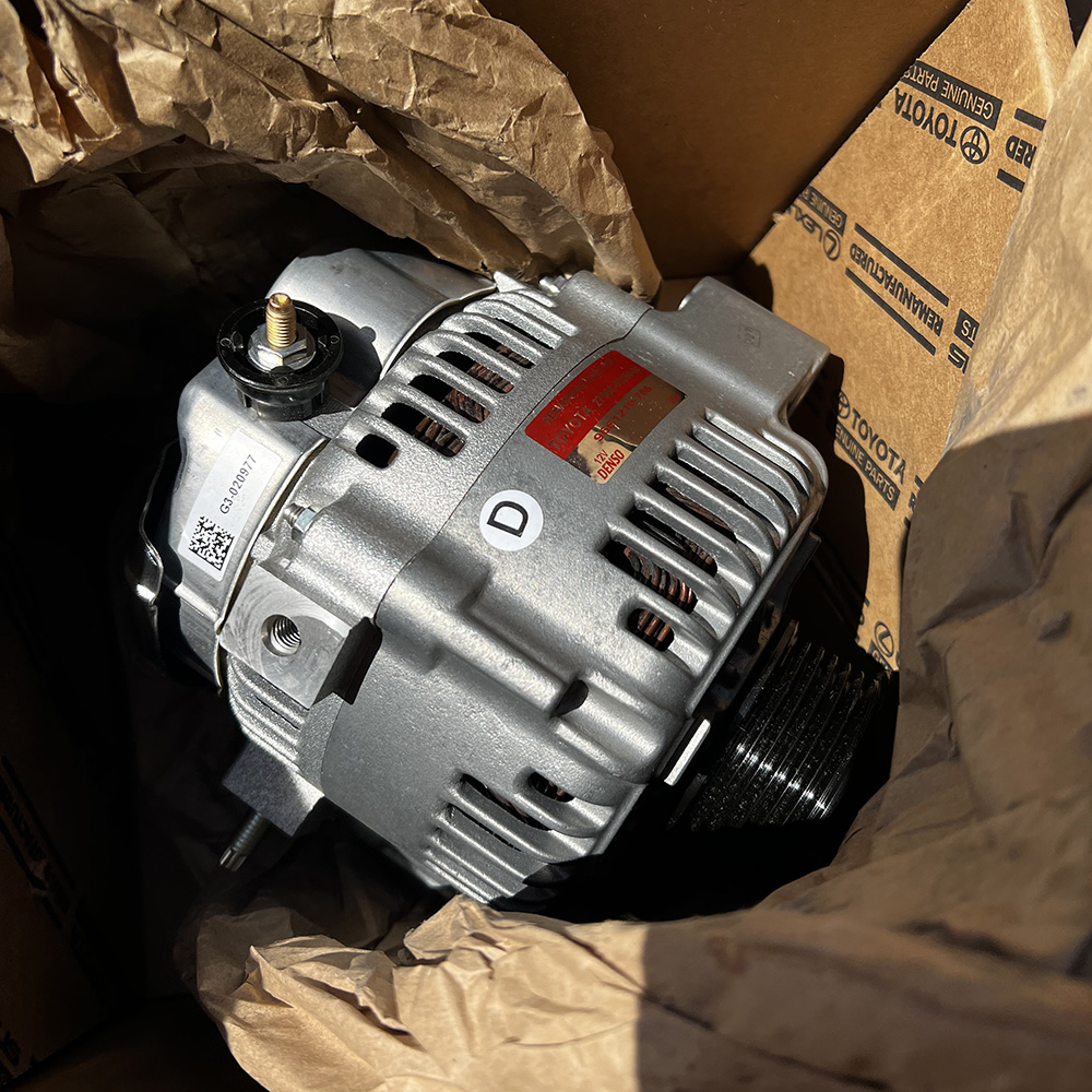

How long did it take you receive the part once you ordered it?Toyota Reman just came in, looks like brand new. Also ordered the cable housing.
