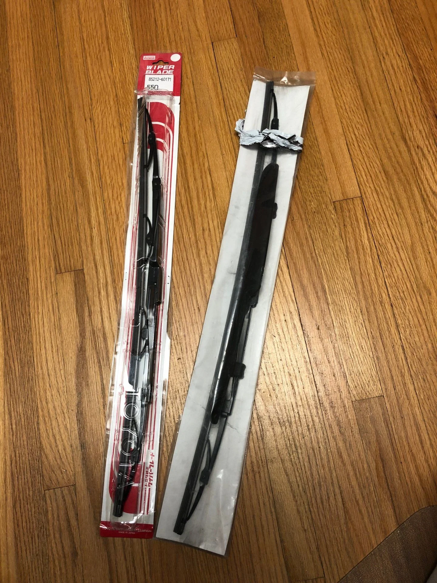

More easy stuff. Wipers were OK but somene broke plastic clips off and blades were working themselves out during operation. Not good. New Toyota parts.

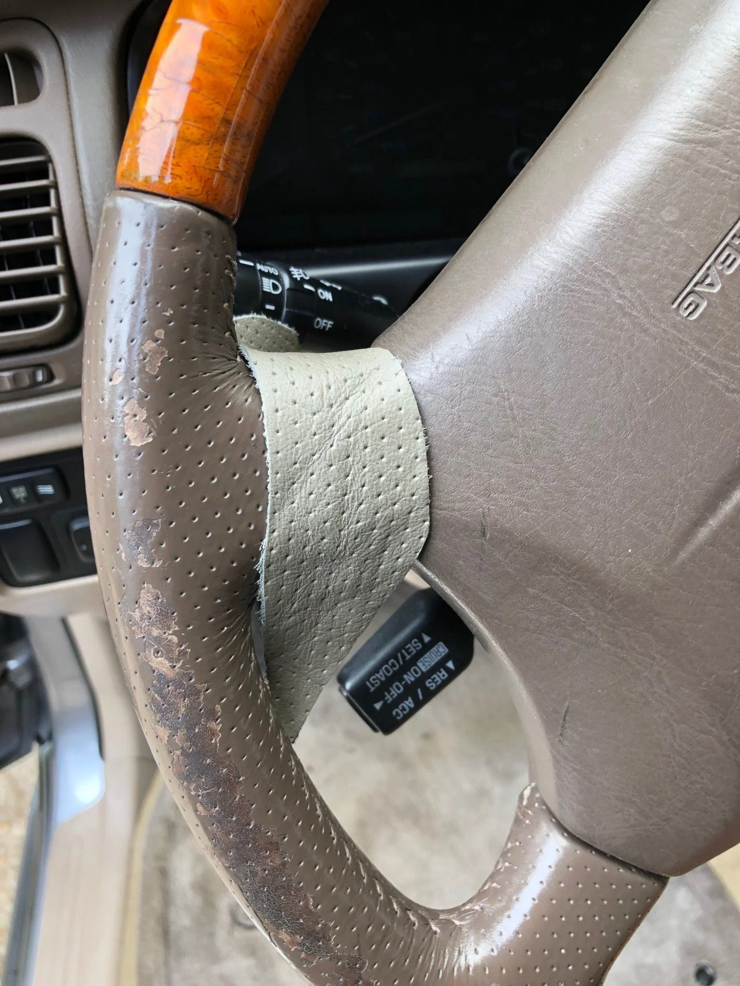

Leather sample for steering wheel is no good :( Will be either going non-perforated or wait. Hard to buy leather in needed color in small quantity.

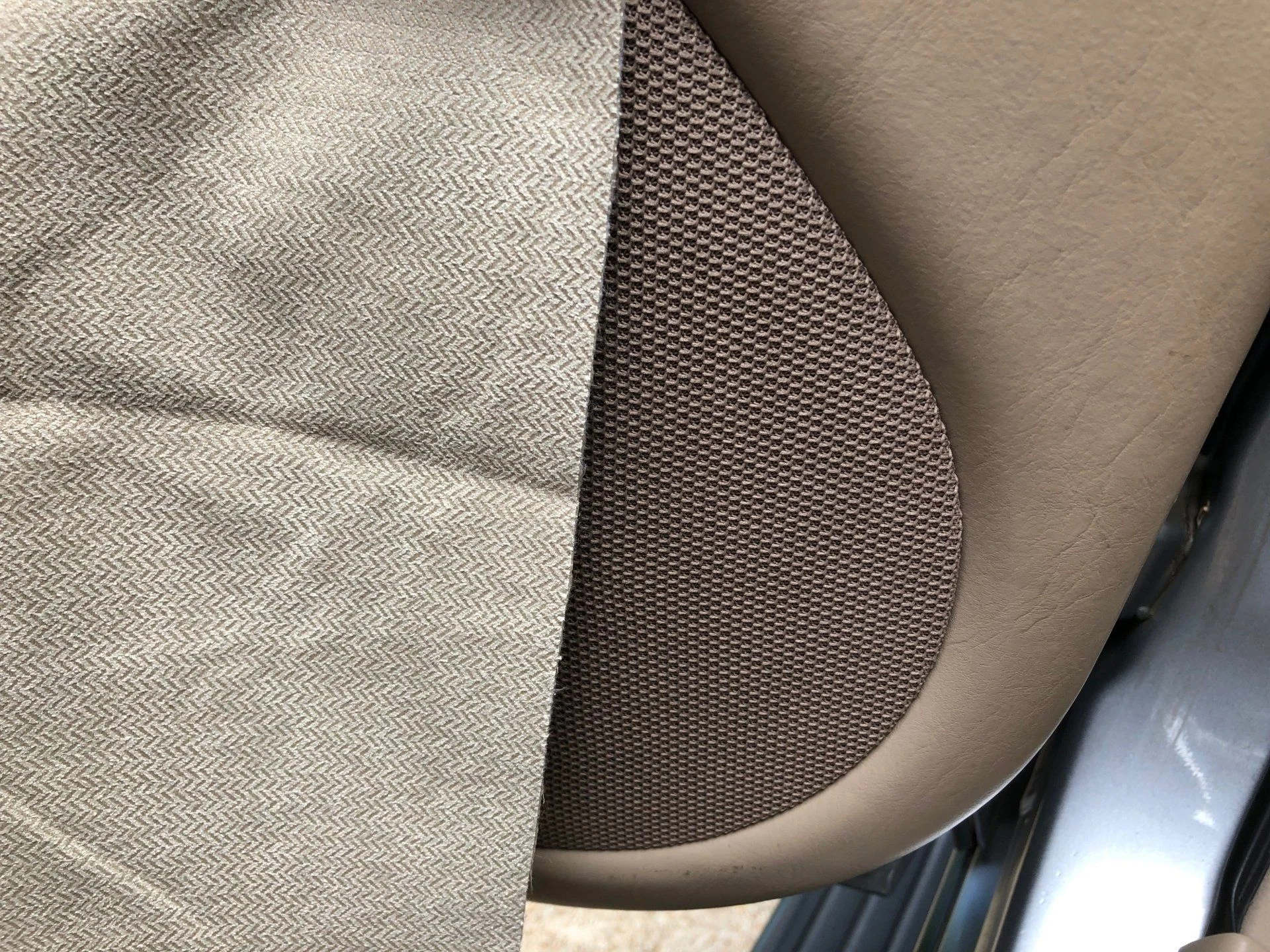

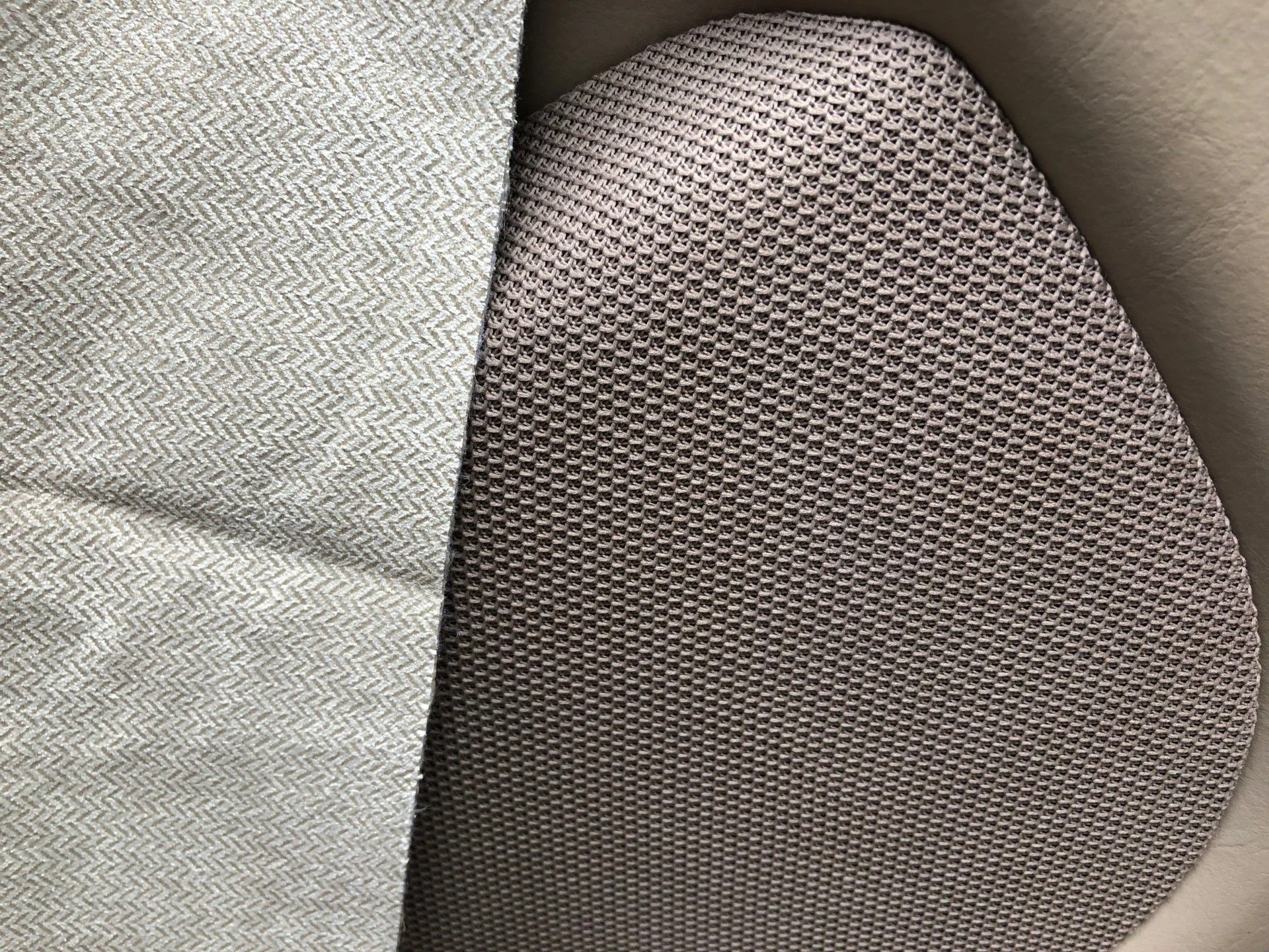

If someone looking to replace speaker cloth (mine was ripped on FL door)- DO NOT get it from one well known store. For $50 + $18 shipping I was expecting dead match to OE. Instead I just got 4 pieces of beige drape cloth that doesn't even match color let alone texture. I can get "similar stuff" at joe ann much cheaper than that. Seriously. Very disappointed with seller. Not going to return it because of 25% restocking and then store credit only..

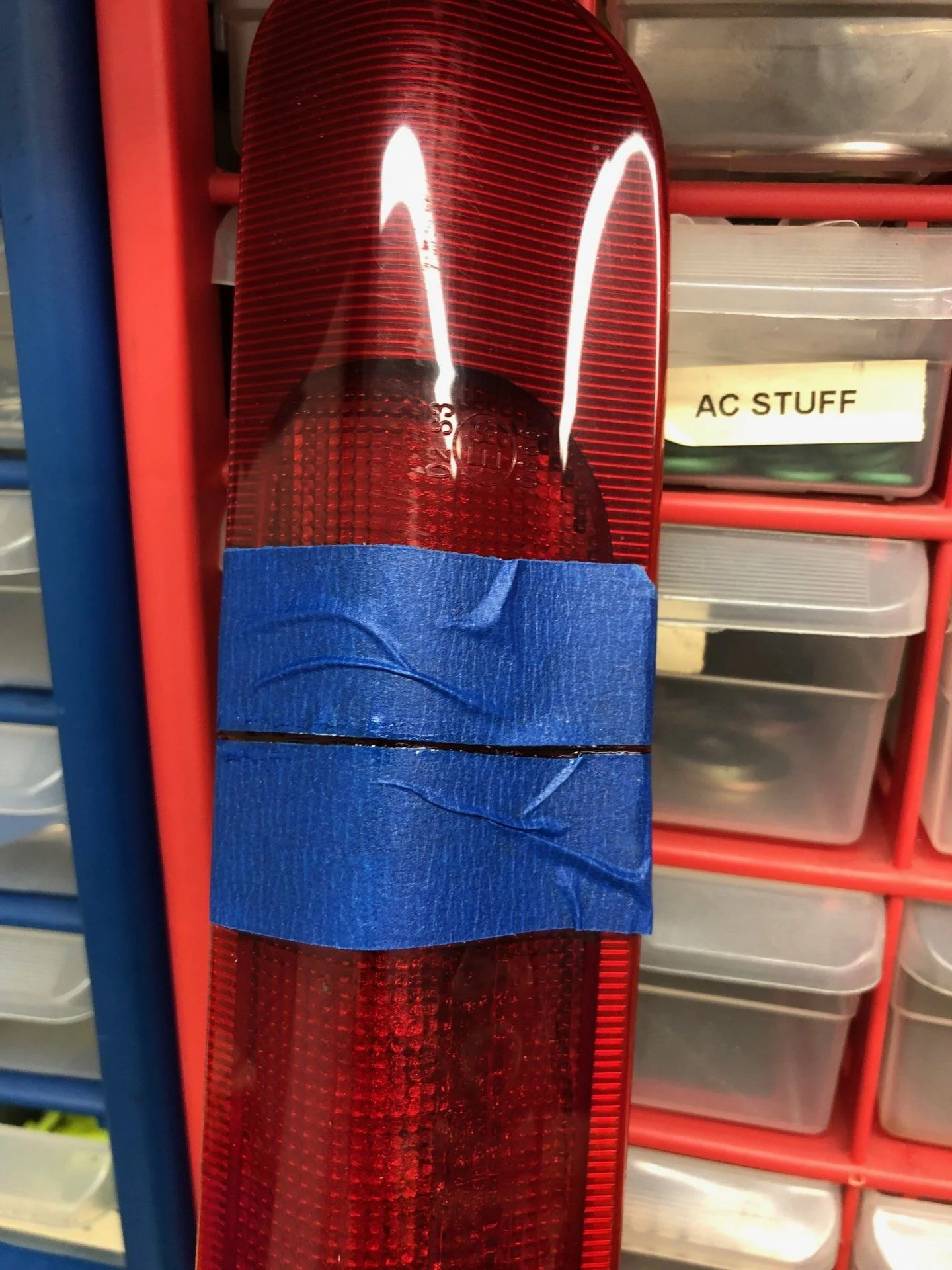

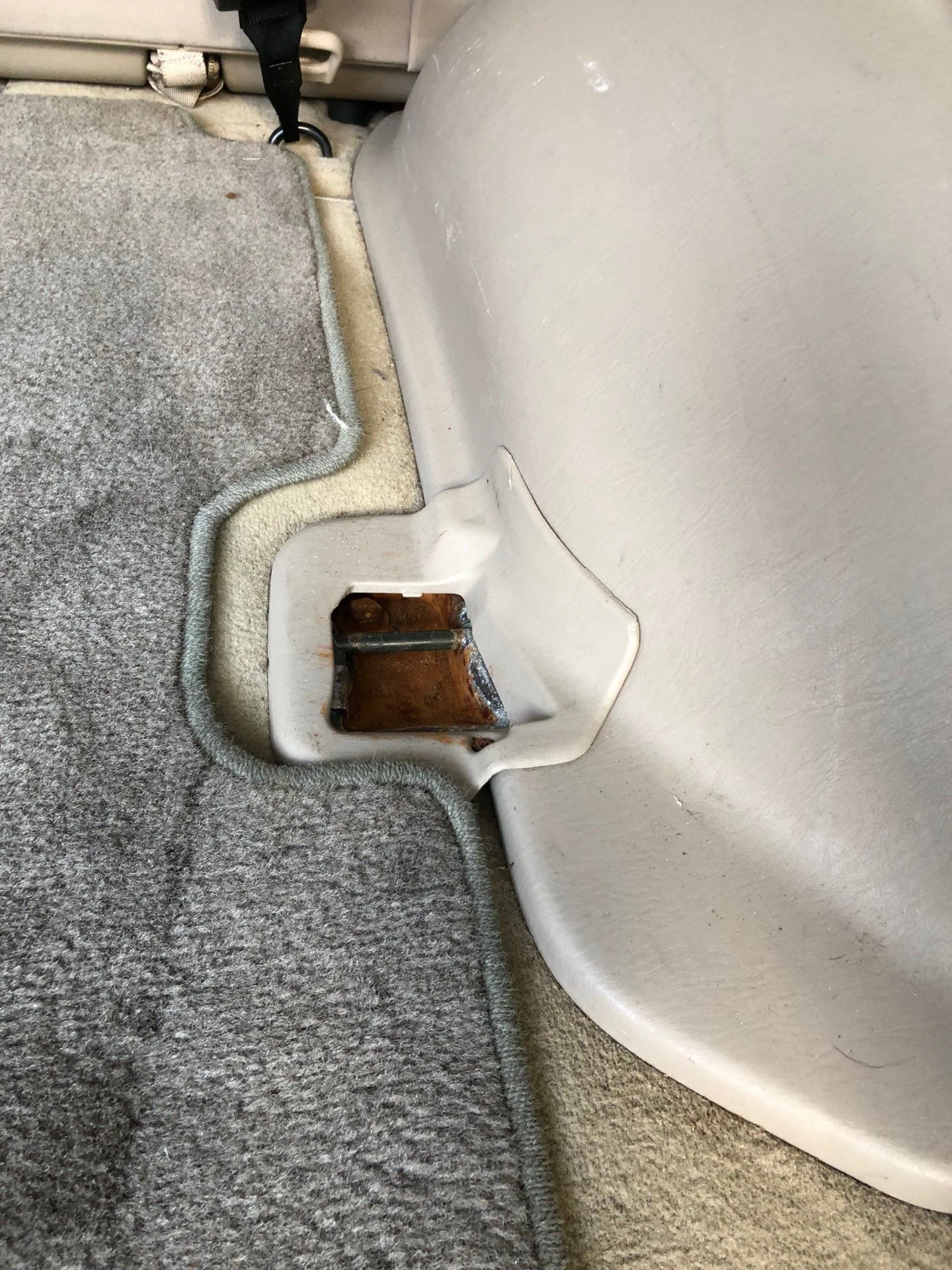

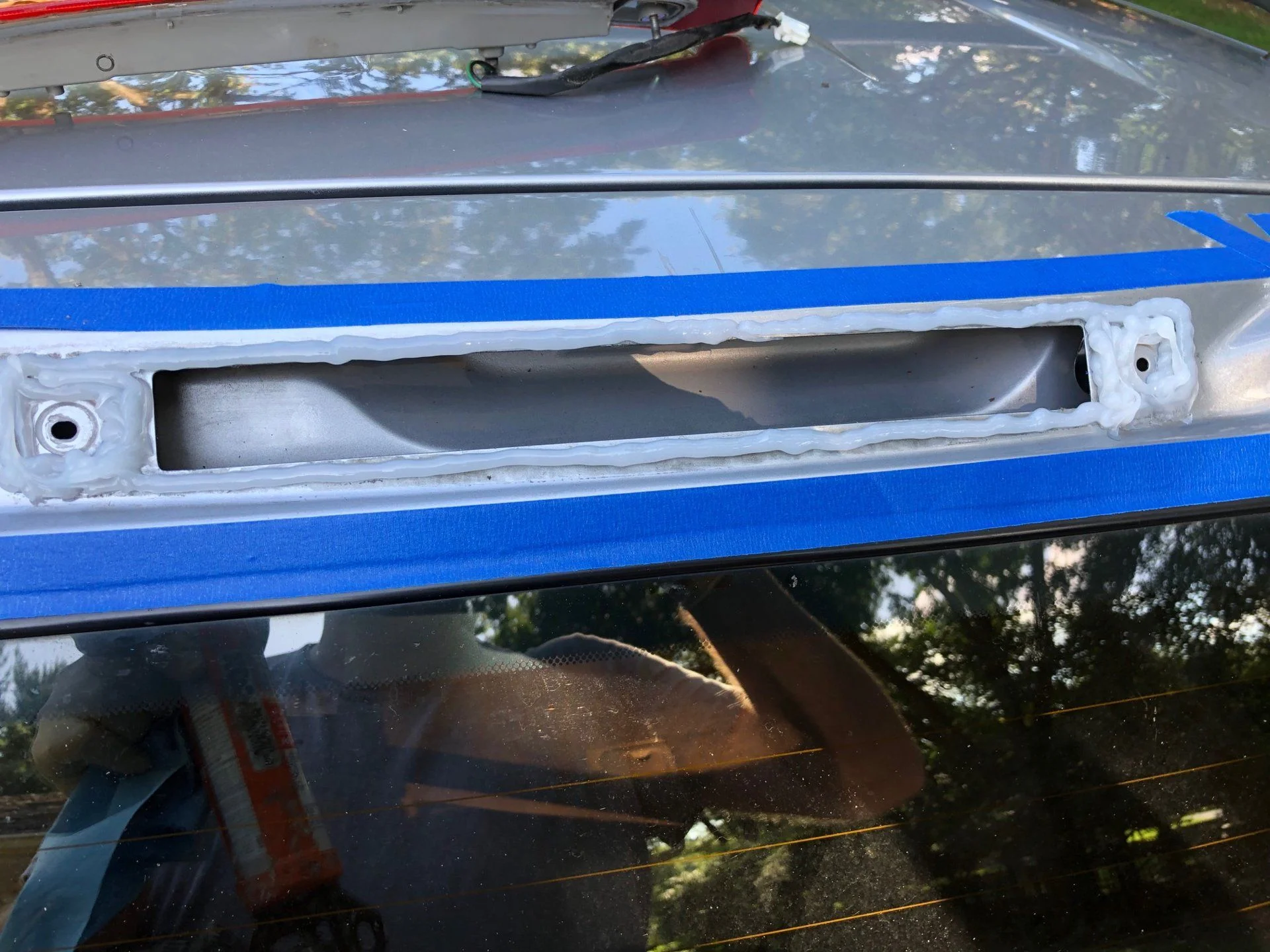

Yesterday I noticed (after rain) that when I open back door I had puddle on lower hatch. And when I close it back I had some water coming from rear window moulding. Anybody have any Ideas? Also, see 3rd raw seat rusted. Is that just something PO spilled there or it's some common issue? I'm thinking about brake light leaking inside of the hatch.

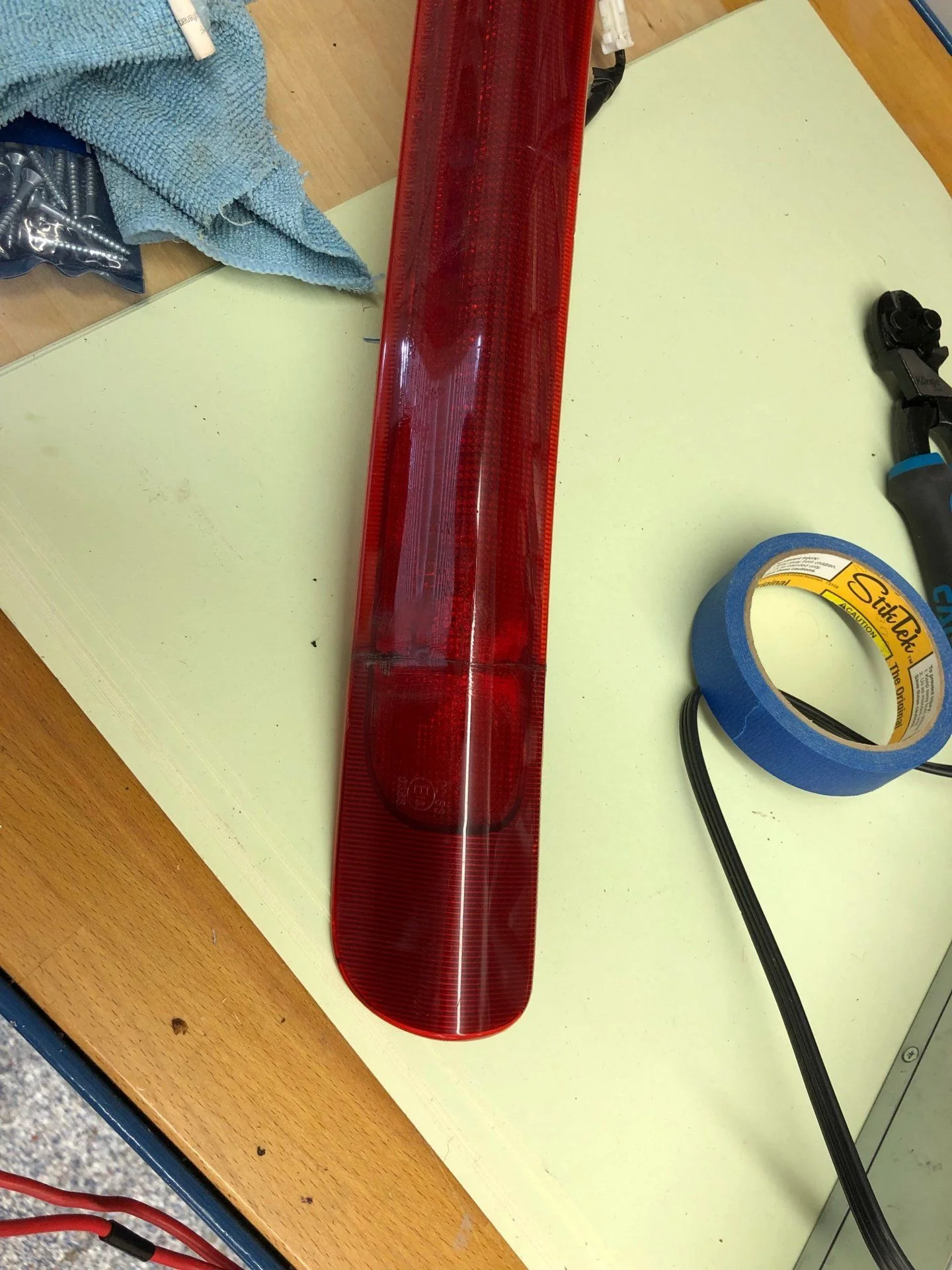

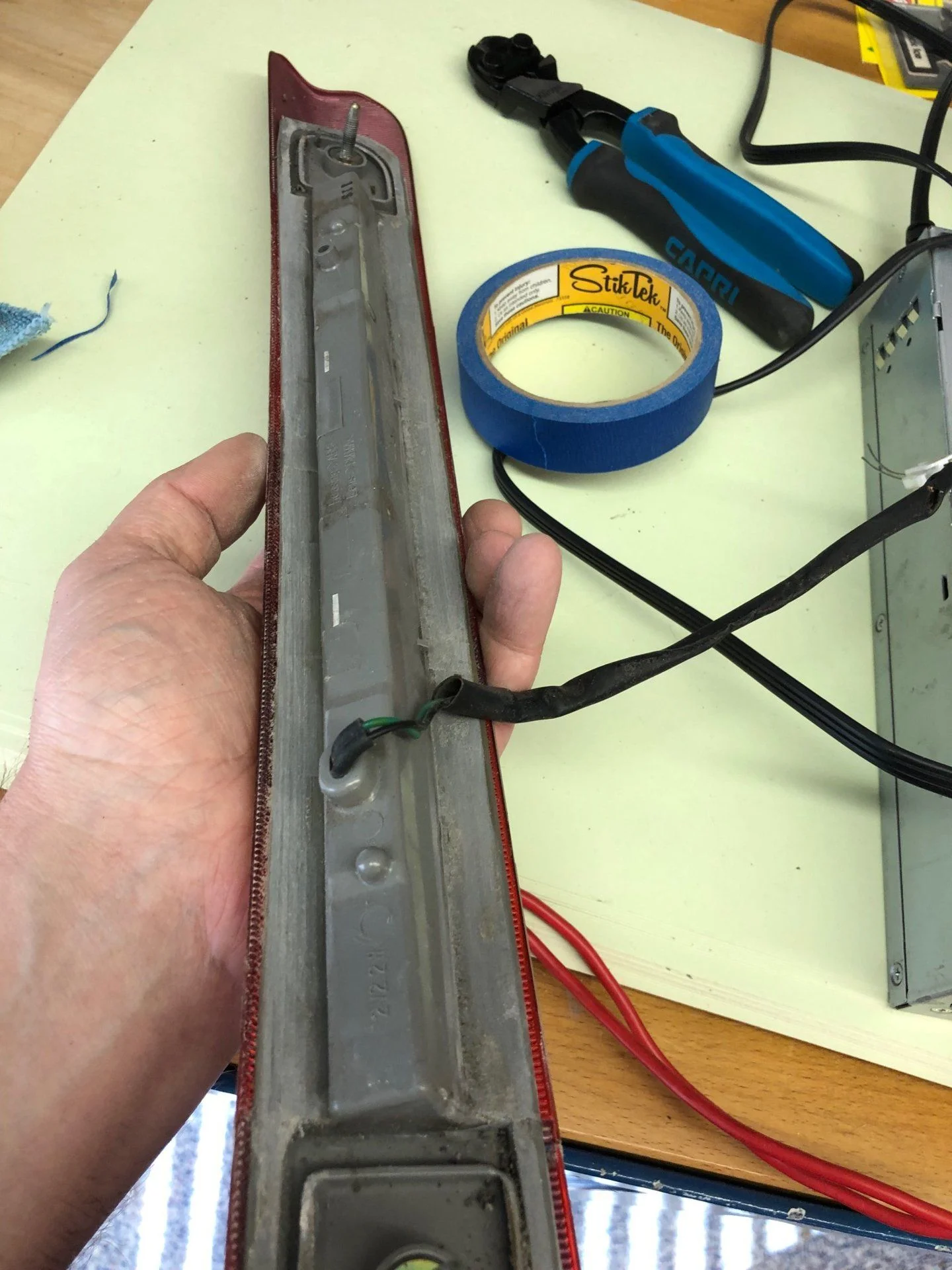

Light was cracked. Took it off, cleaned off old foam seal material from both lamp and hatch.

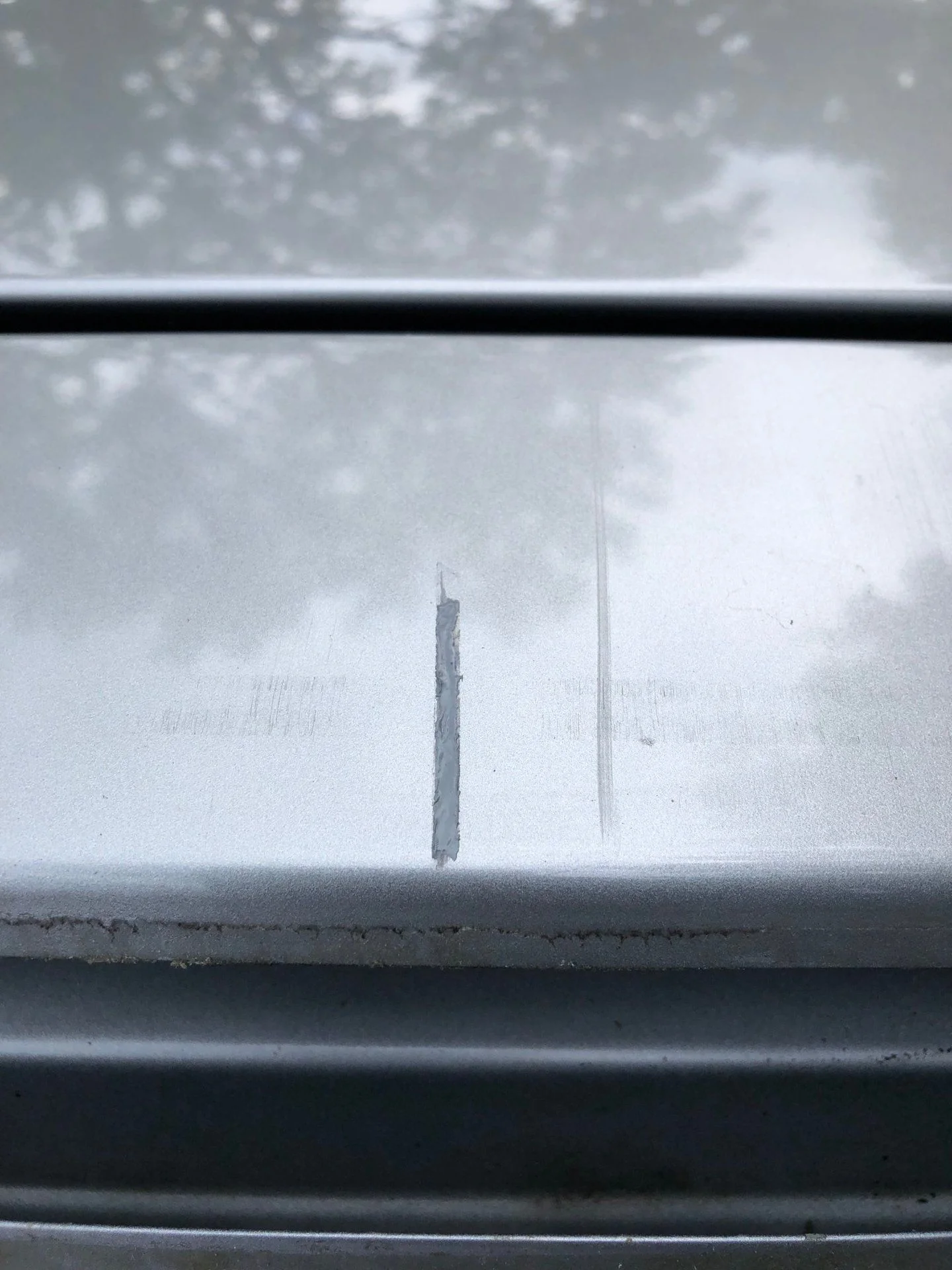

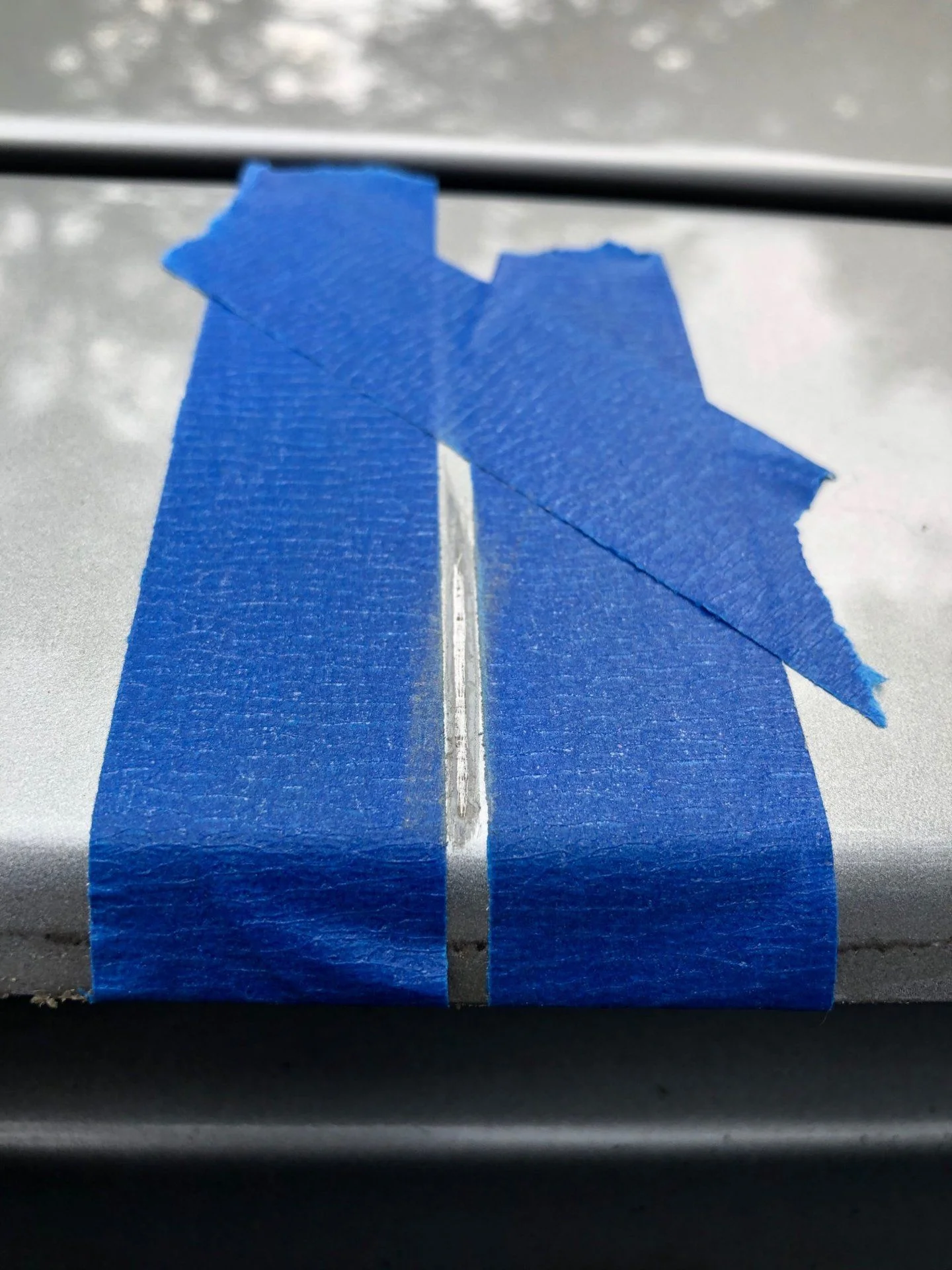

Filled small scratch in paint with primer. PO scraped while loading somethin on top and I guess this is why light cracked as well. I didn't want to do seamless job. I just wanted to stop rust. I'ts not visible anyway.
Used superglue (maybe not the best), then sanded and polished light. Installed on silicone. Crack repair definitely visible if you are looking. But for now it's about functionality, not about perfection.
I don't have any major rust in hatch, only light bubbles around pull handle. Nothing around license plate light. Hopefully this will slow it down for now.

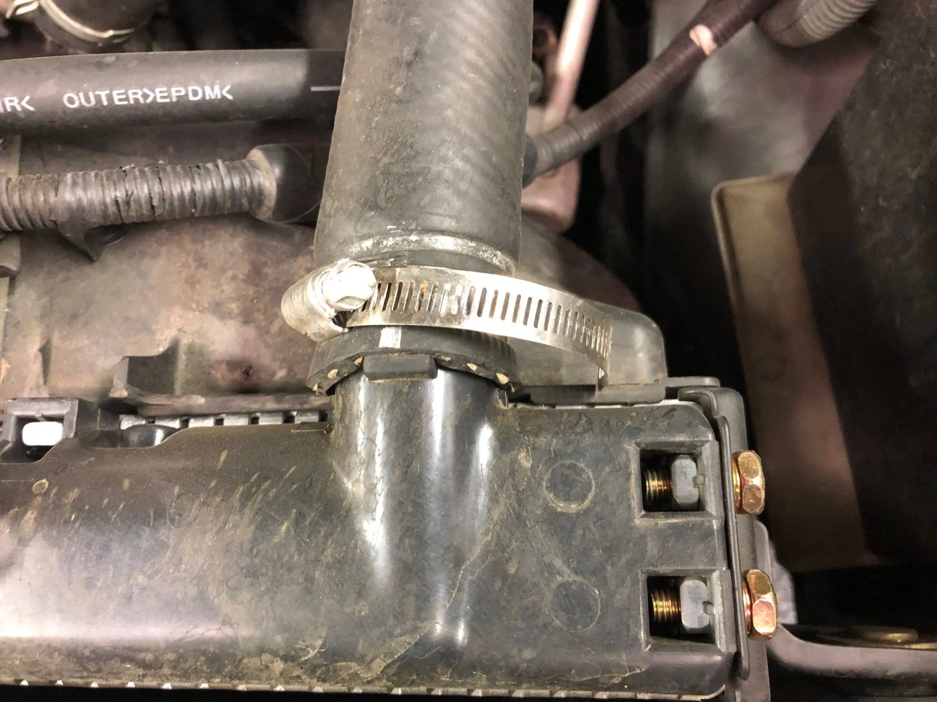

During weekend I did "Ghetto" fix, added 2 clamps to PS can just so I can clean all traces of oil and see if it's just the spot where it leaks to assess what needs to be done to PS system

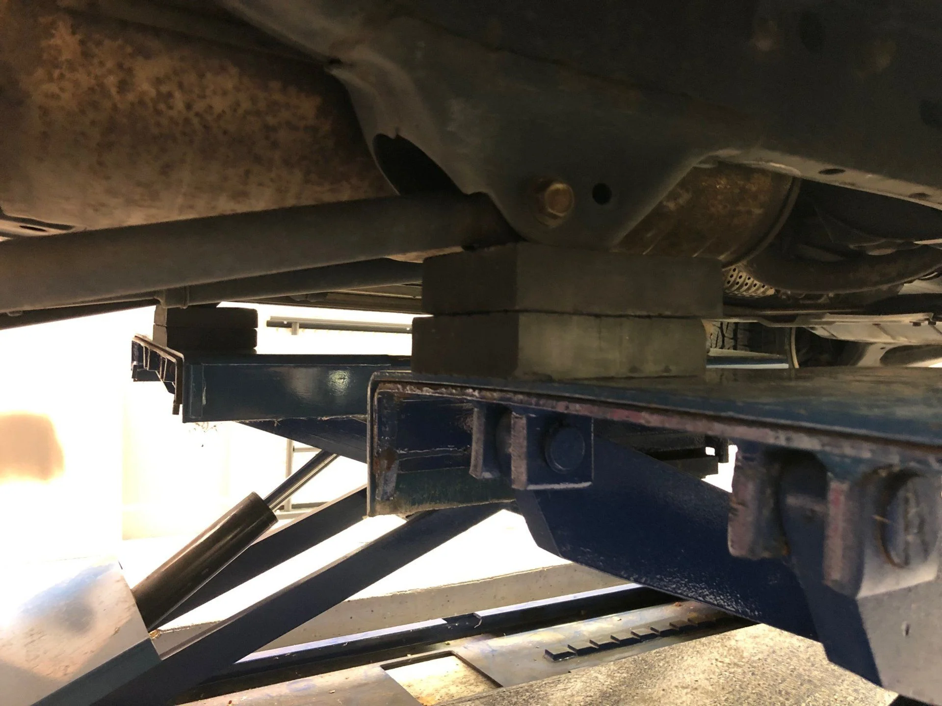

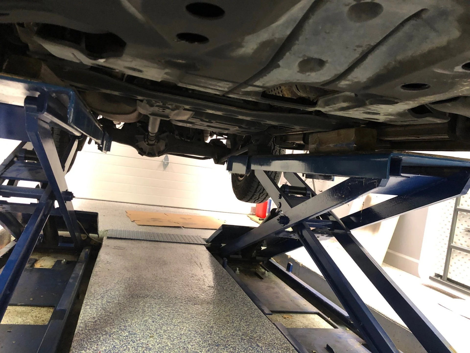

Now I'm little confused about lifting truck... I know it's not popular here (to have a lift). But I do have scissor lift. This is 7000lb lift, so no issue here. However I'm not 100% I got jacking points right. On a rear it should be fine (per FSM). However, on a front - the best I found is by cross-member. Anybody have any input on this?
You're to far back. Vehicle is front heavy. Look in those FSM for lift points!
FSM is not encouraging. Says don't use this type of lift. I will have to ignore it then :( This is as wide as I can support it front to back between wheels. I did shake it, stays solid. Its safe, the only question is if this front cross-member OK to use.. I used it already but if there is big no-no for some reason I won't do it again (doubt it because this seems like the only spot.)

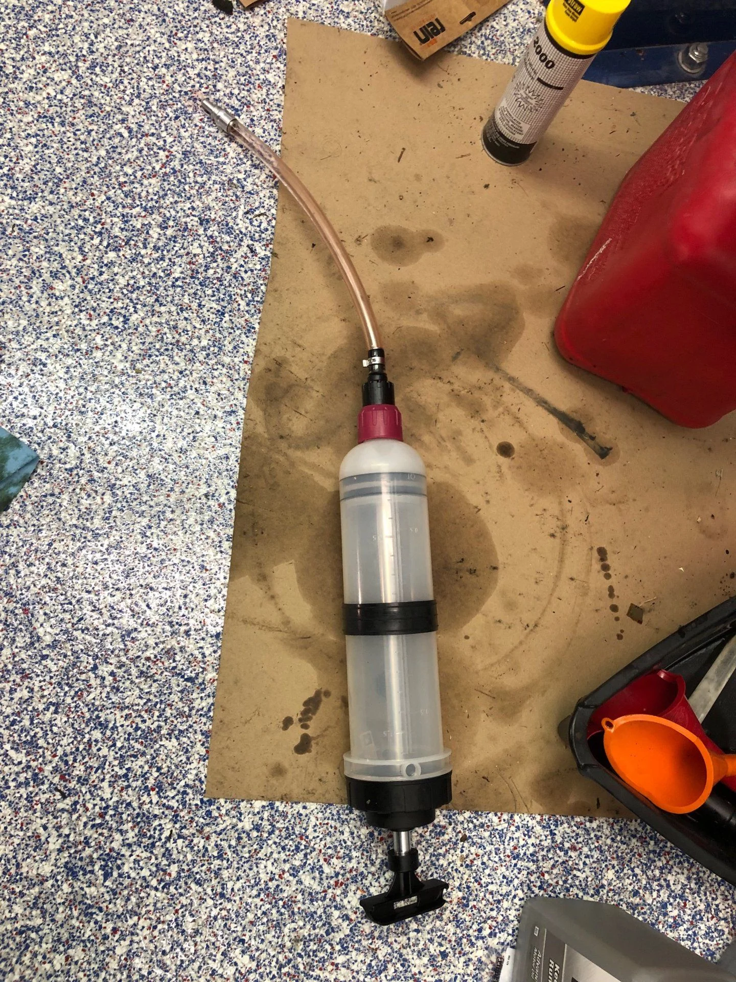

Differential oils: Used my pump - highly recommend. I used it for my other cars, very convenient, easy to fill, easy to clean, easy to use..

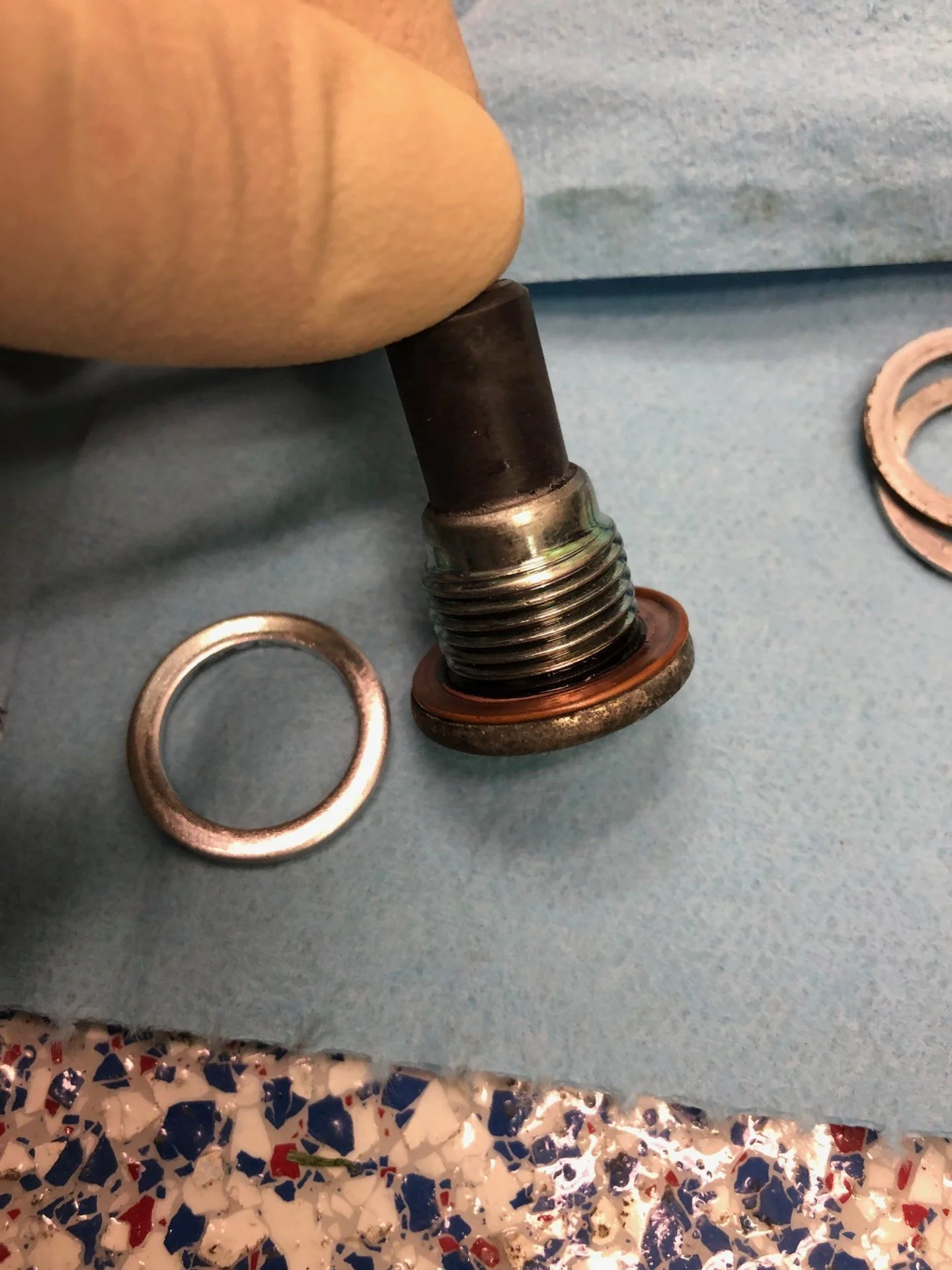

Drain plug has 2 washers. Copper and aluminum. Normal? See pic..

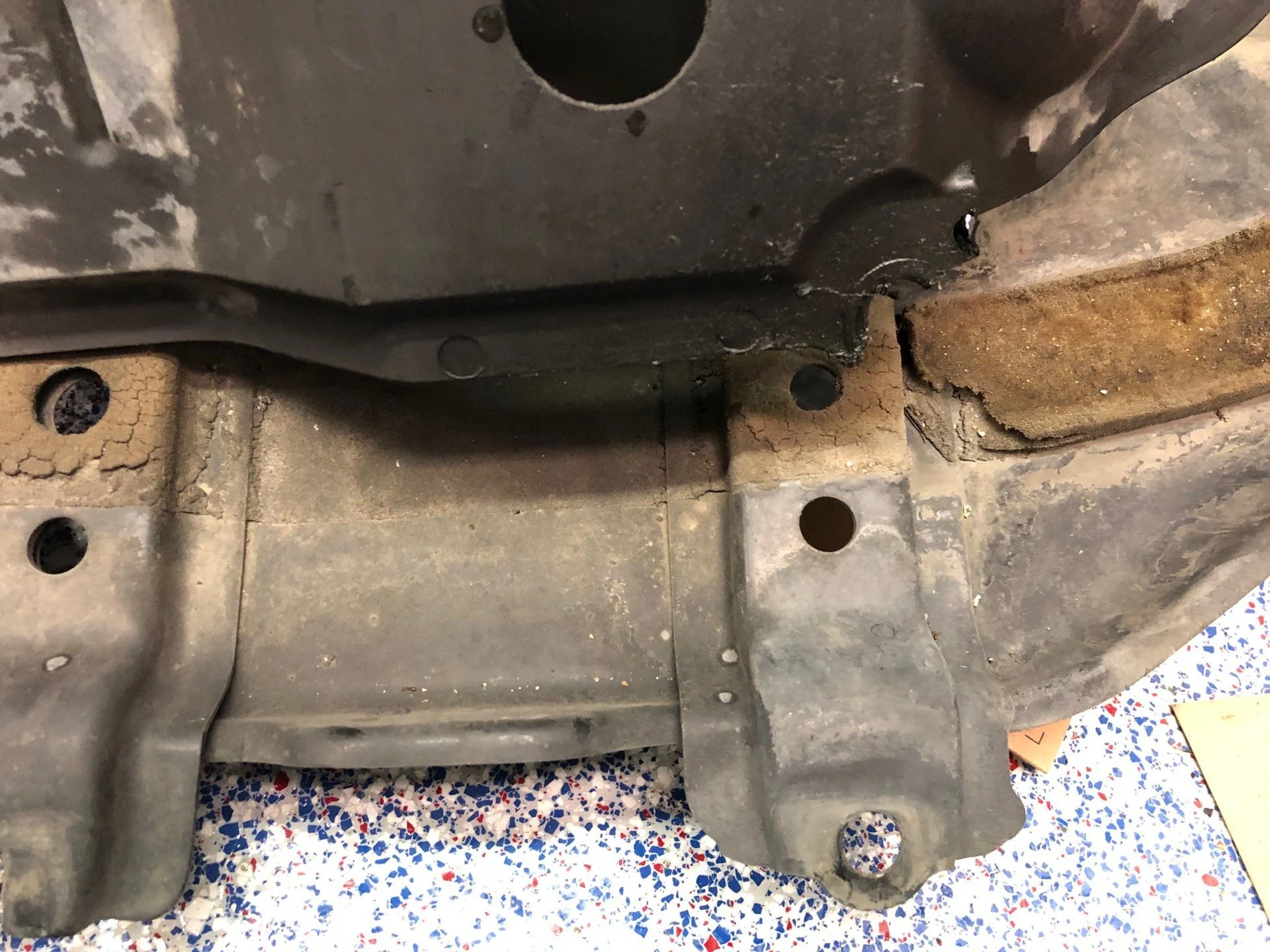

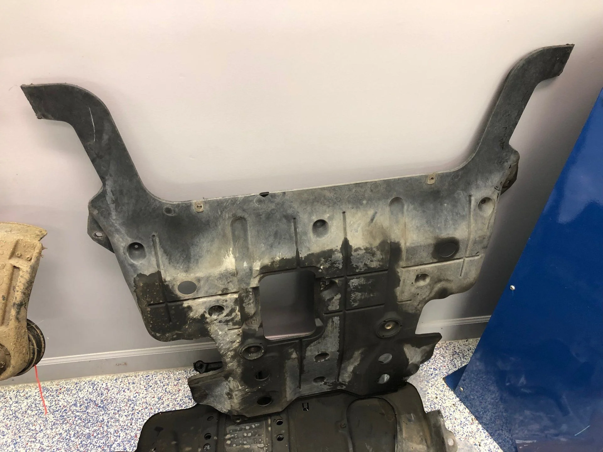

Plastic pan has 3 broken tabs and was held by 2 bolts only. Oil drain cover was missing. I hate when I see this. Why they do this??? This car was serviced in DOBBS(?????) Seems like every place they touched have something screwed up. Wrong clamps, missing bolts, etc. Hate it..
What is a good source for replacement pan?

For the engine underbody protection plate, if your original part has tabs missing, i would replace it with a proper metal plate. A few options are available from usual vendors. Much cheaper than OEM part and much more protection
Can you post link please? I'm new, so "usual" vendors don't tell me much. Metal would be nice for sure. Especially if it's cheaper as well.
I do have tabs and may be able to repair mine, but I definitely don't want to buy OE part for what it costs..
