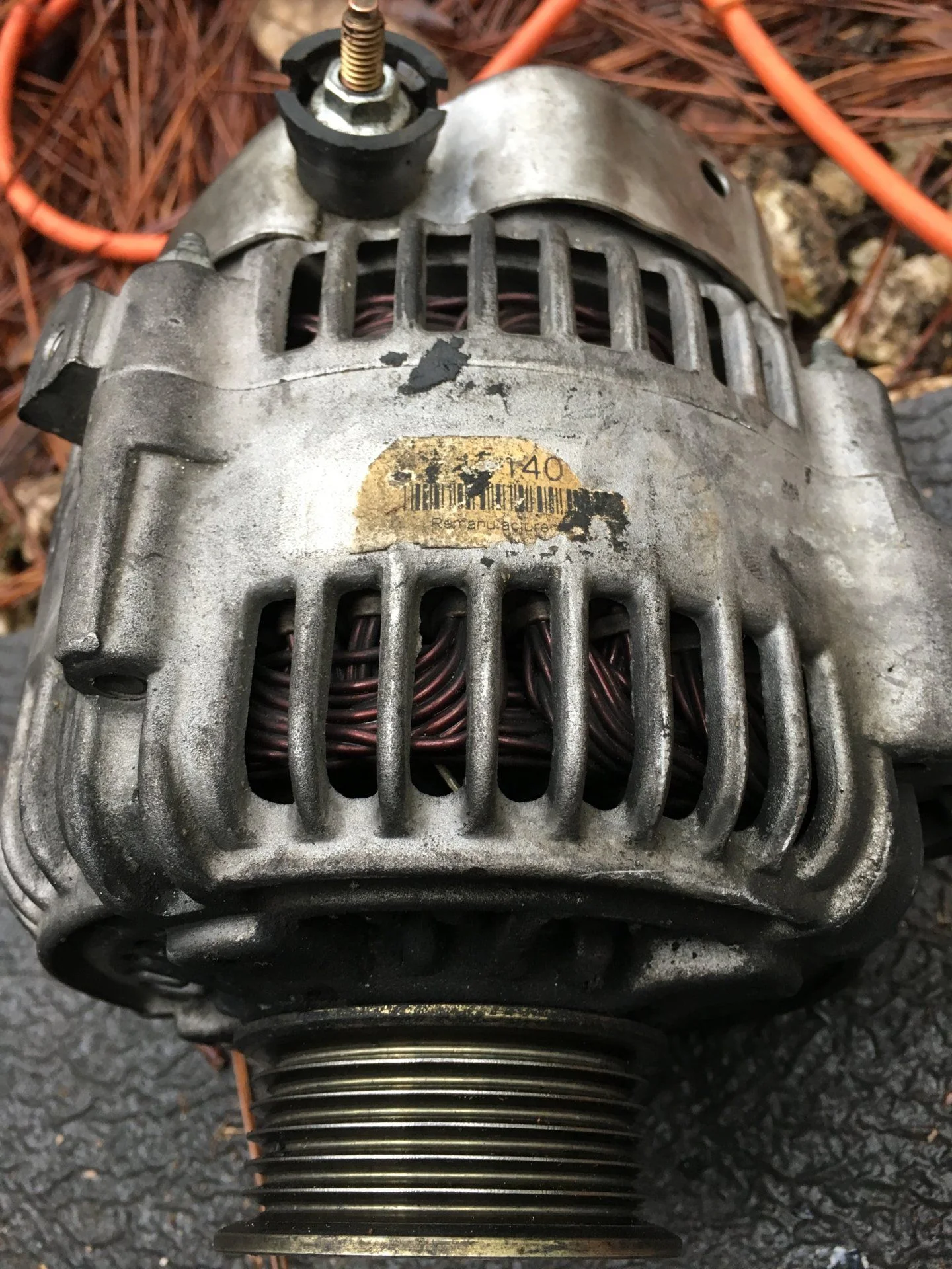

Where to get the plug to connect to new alternator?
Common part or dealer only?
Also, any idea what brand old alternator is here?
Thanks
I've found most plugs housings are available at dealer. You can try a parts rig, but it may also be brittle.
Thank you. Any idea of the brand of the alternator it does say remanufactured but I do not remember the brand

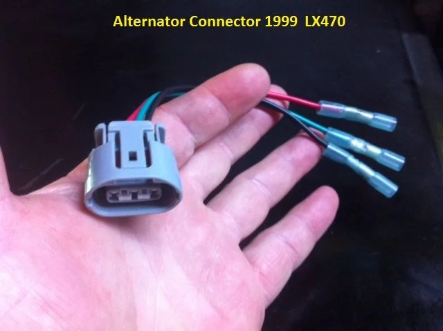

I always recommend folks have the replacement connector on hand before starting an alternator replacement IF it the first time it has been done. All too often we read of a replacement being halted/delayed because the factory connector crumbles when being removed.
Also because of where the alternator and wiring live...it is best to solder the spice and heat shrink it or use the weather proof (heat shrinkable) butt connectors.
The earlier 100's use a connector that is oval shaped. Later models use one that is sort of rectangular.
ALTERNATOR REPAIR PLUG HARNESS 3-WIRE FOR LEXUS LX470 TOYOTA LAND CRUISER 4.7L | eBay
ALTERNATOR REPAIR PLUG 4-WIRE PIGTAIL CONNECTOR TOYOTA LAND CRUISER LEXUS LX470 | eBay
I purchased mine off of Ebay...but they might be available at certain Auto Parts Stores as well.

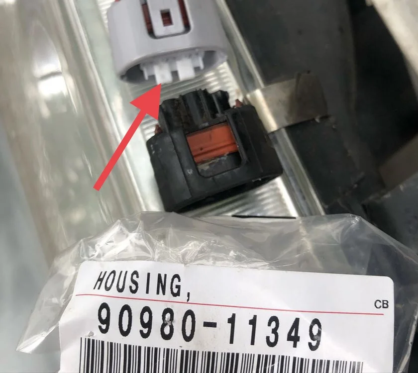

I called the dealer back with the part number to the housing that @Tres Toys kindly provided. They had it in stock and I bought it for $10.53. Now I am trying to simply plug the three wires in. Two snap right in but the white wire doesn't want to be so easy.
Aren't all three metal ends exactly the same? Does the white wire need to be oriented differently that the other two?

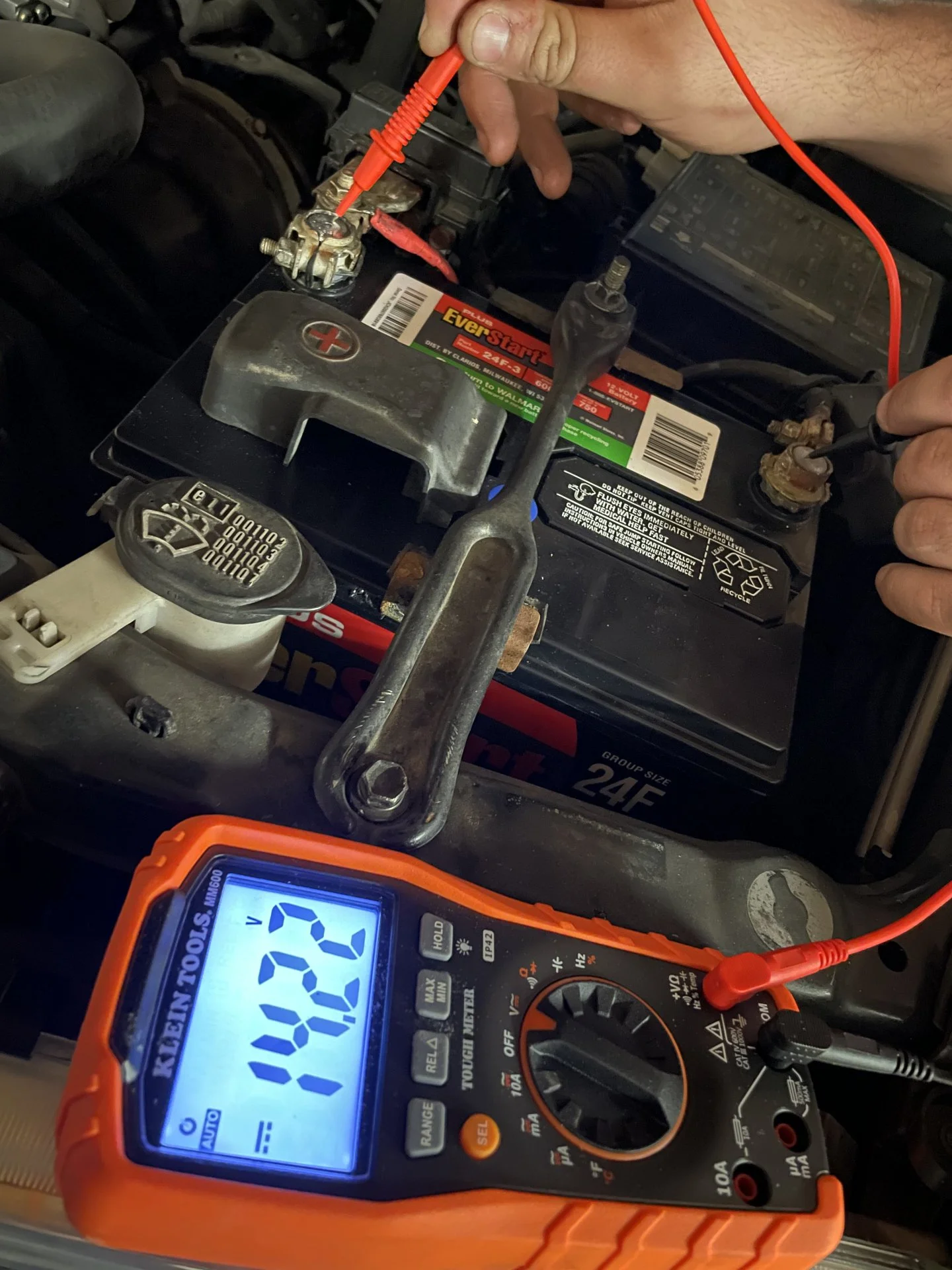

Finally got alternator on. Showing a little more than 14 volts running now.
Now off to look for a barbed hose connector....even though it seemed to run fine without it.
Ginormous appreciation for the help from dudes better than me. Thanks

A bit delayed, but the alternator plug has a tab/snap that pulls out (opposite side of where wires would run into). The locking tab is located in the center of the plug.
Pull this little tab/snap out using a dental pic. The tab/snap locks the wires into place. This tab should be removed prior to de-pinning the plug, and reinstalled after new wire ends are inserted into plug.
Pic for details. Red arrow is on locking tab (that is partially pulled out of plug, which would be the "unlocked" position.

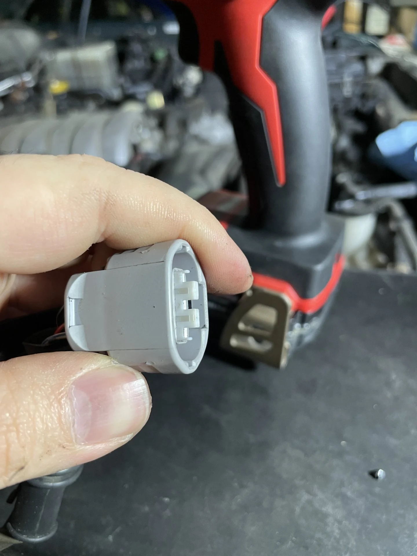

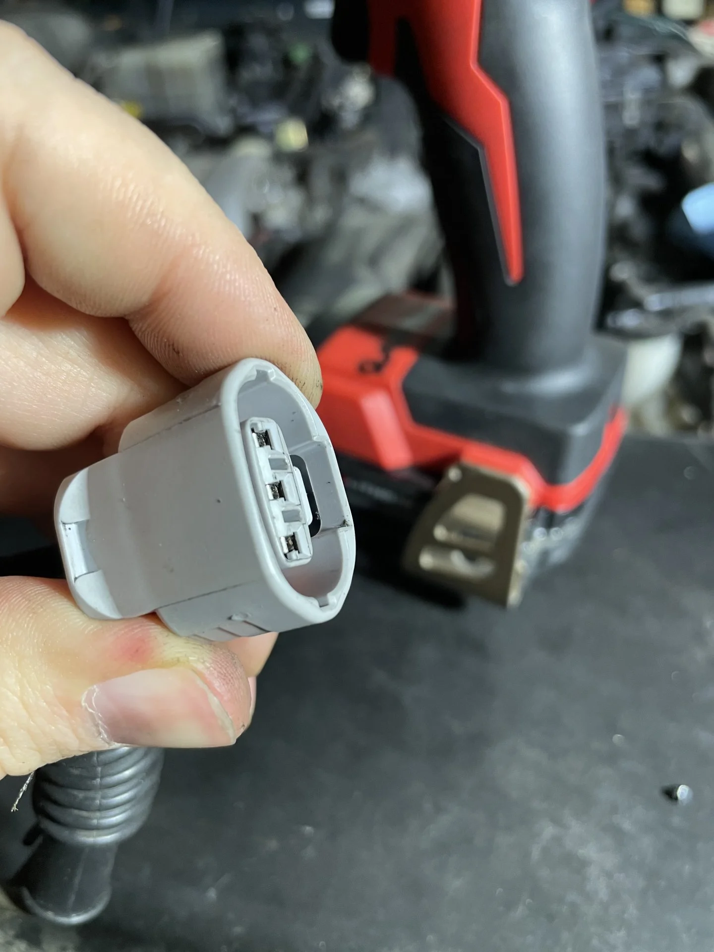

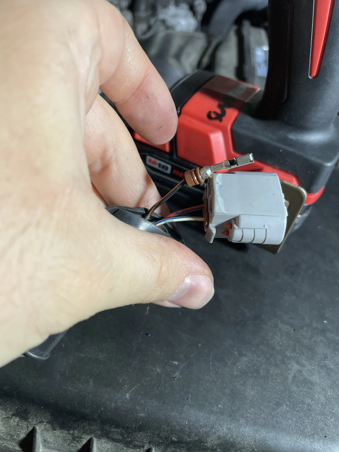

crtx you are a LIFESAVER! I've been chasing my tail on this since it died in January. Attaching some photos for the next guy that comes along. Pop the little white tab out with a pick or needle nose pliers and the connectors snap right in.

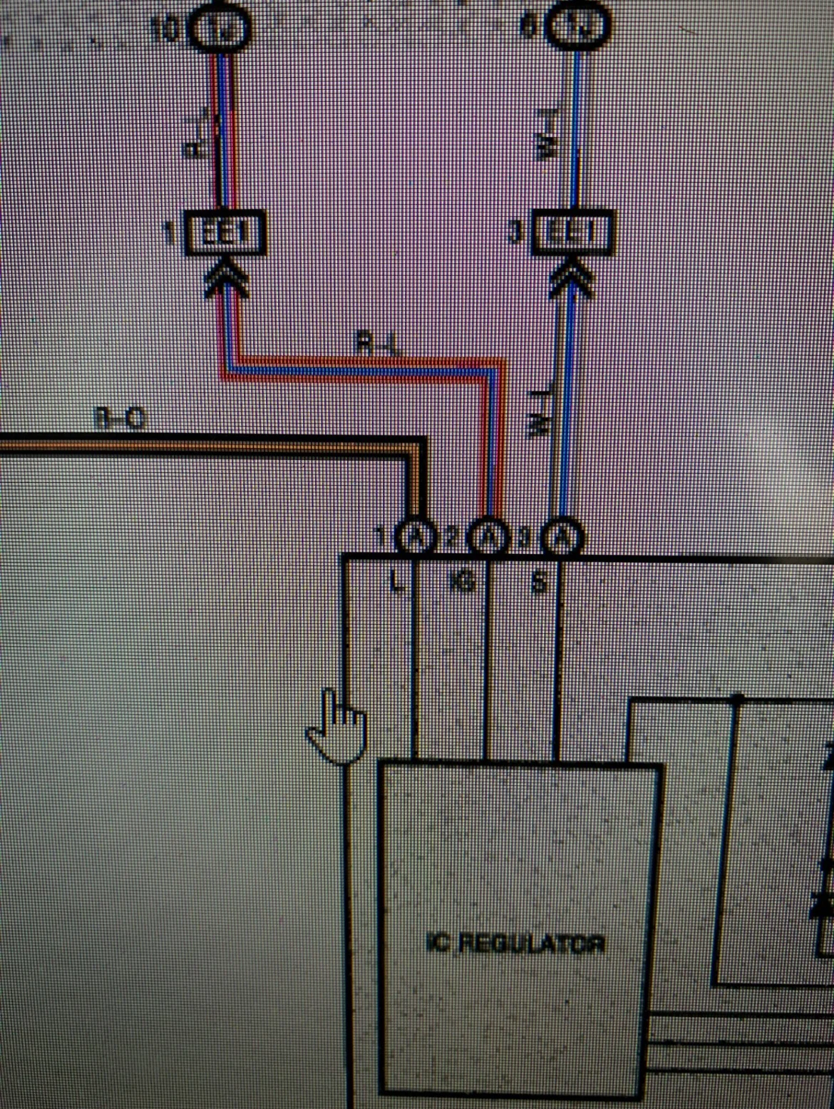

Also adding a diagram I found that was super helpful in rewiring. I'll try to find it again when it's not midnight so I can credit the original poster.

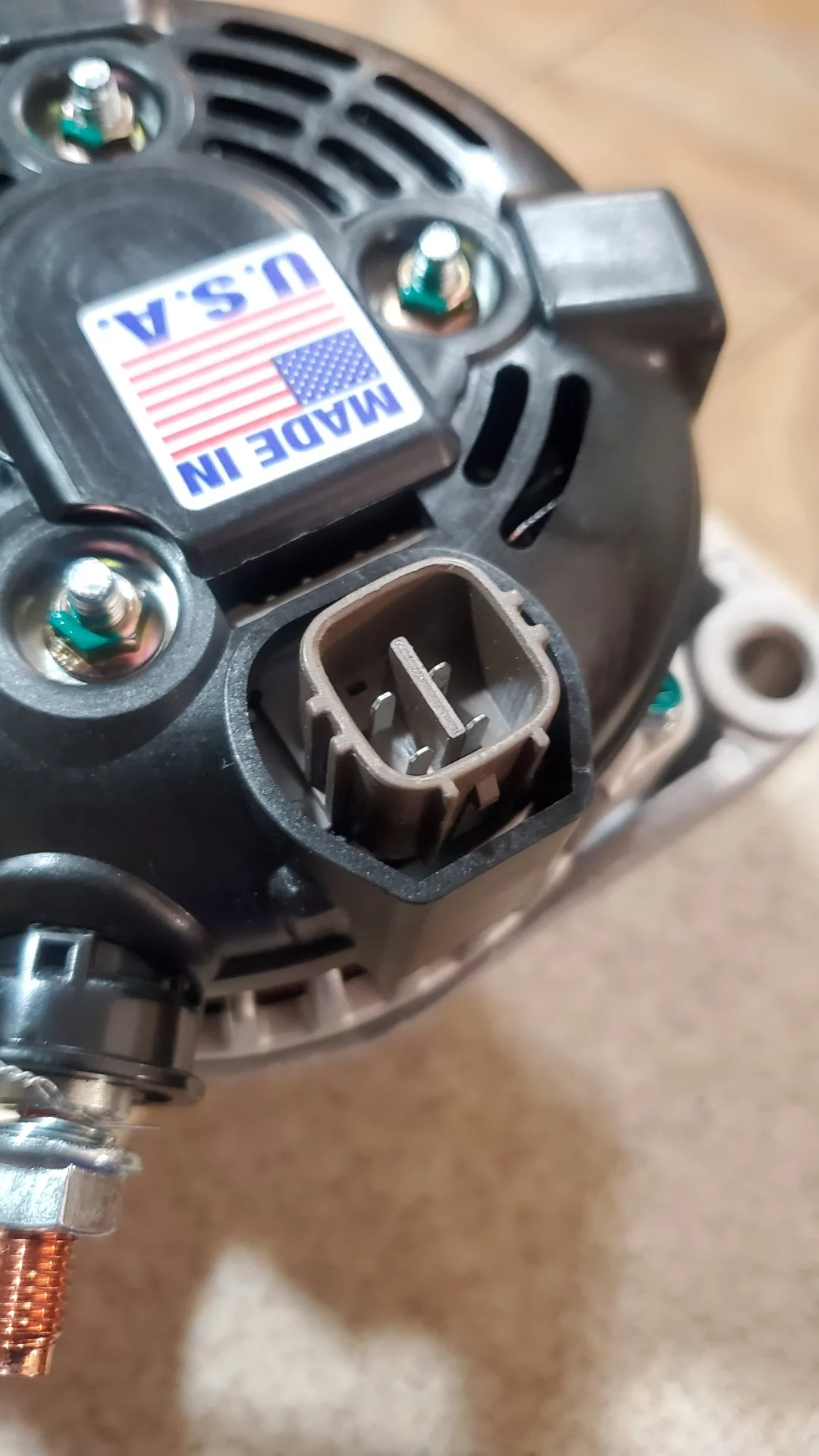

What am I missing here? I just got a high output alternator and this is the connection on the back it doesn't look anything like what it's supposed to. Should I return it? Otherwise it's a pretty good 250 amp alternator from Tucson alternators. Looks like for the Tundra and not the Land Cruiser?
What am I missing here? I just got a high output alternator and this is the connection on the back it doesn't look anything like what it's supposed to. Should I return it? Otherwise it's a pretty good 250 amp alternator from Tucson alternators. Looks like for the Tundra and not the Land Cruiser? View attachment 3019641
That alternator has the 4-pin connector that comes on new model years. I assume yours has the 3-pin connector? There is a post where someone swapped from the 3-pin to the 4-pin plug.
Yeah this is turning into a mystery ... at first I thought they gave me one for a Sequoia ... then I saw so many posts with the three pin connector ... BUT then I noticed that the 200 series uses a 4 pin so I thought maybe the goofed up on the model year. THEN I am seeing that the 100 Series with AHC MIGHT have the four pin ... I am not willing to trade my time to swap this out to it's going to a shop but I want to make sure I don't give them a problem to solve for no reason. I am still researching ... looking through the FSM as well. Denso compatible part numbers show the 4 pin so it's anybody's guess. I am hoping the 06 LC with AHC has the 4 pin ... but this one also has the third bracket that "may" fit or may not fit as some guys have been able to do a Sequoia 150amp swap into their 98-02 cruisers. It's anybody's guess. I should have sold this truck before dumping all this money into it lol.
@hoser mentioned that my 06 with the 130 original amp alternator might be a 4 pin in this thread.
This is the thread I was referring to. It should give you some good advice.
130 amp alternator install in 00 LX - https://forum.ih8mud.com/threads/130-amp-alternator-install-in-00-lx.1247074/
