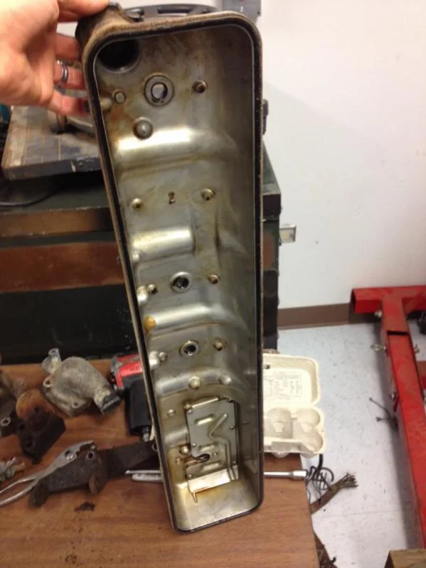

Got the engine trans and transfer case out of the 60 this week. The clutch was brand new! Flywheel still has the machine marks on it! Transfer case needs resealing for sure and the engine too. I did pull the valve cover off and someone must have recently been in there as the inside was pristine. The bell housing spent the day in the solvent tank and will be painted after some ruffing. Pretty exciting to finally be under way.
Finished the head gasket job on the 4runner but now I am having issues with getting it smogged. Sensors, codes and vacuum oh my. When I get it done then I can get the pig in the shop and start removing the drivetrain. Stoked.

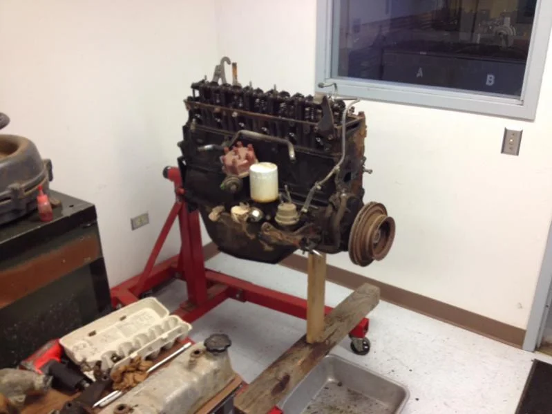

Started tearing into the engine today. I just could not throw it in the pig without knowing its condition. Plus it was caked with old oil and dust and rust. Some good signs so far. Looks like someone just did a valve adjustment as the inside of the valve cover was spotless. Should get the head off tomorrow and then I'll really be able to see what condition my condition is in.

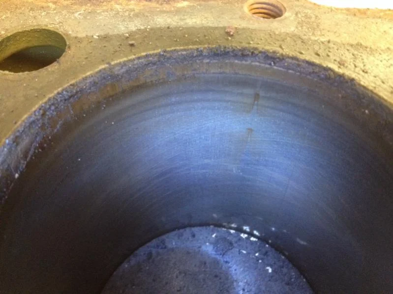

Once again I'm stumped. The 60 had 240k miles so I wanted to get into the motor just to see if a rebuild is necessary. Everything was leaking too so I wanted to reseal it. Got the head and oil pan off and there is little to no wear. I am pretty sure that it is original... So what should I do? Reseal and run it? New oil pump for peace of mind? Go wild and do rings and bearings so I never need to pull this thing again? Keep in mind, I am a school teacher with two kids and a penny pinching wife!
simple is usually right... 1973 fj55
Depends on how long you're keeping it and knowing you WILL have to go back in someday. With that many miles, you know the valve stem seals are bad and the rings have some wear on them.
What's the valves look like? If the head needs work, then I would put rings in, also.
Some of these things you can do at home. Borrow a spring compressor and put new seals in, decarbon the valves, etc.
Run a hone in the cylinders and put in new standard rings.
Leave the bearings and oil pump alone, if it's not in the budget right now. It's a slippery slope, for sure :)
Some of the other guys will have better advise on this, so do some more reading before making any moves.

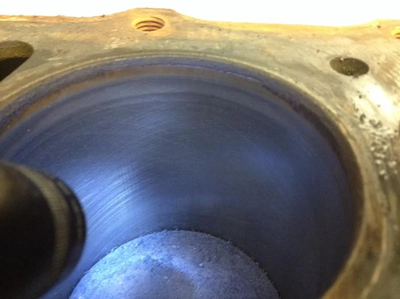

In one pic the flash light looks like a hole in the side of the cylinder on my phone. Thought you had yourself a 2 stroke.

I have finally made some decisions. I am going to completely disassemble, hone the cylinders, rering, replace oil pump, and leave the bearings. They are so clean and such little wear. Seems right as rings usually wear out before bearings anyway. I am doing all the work myself so the cost is minimal for the peace of mind.

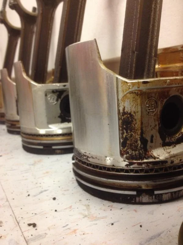

Yesterday I reamed the ridge at the top of the cylinders and pulled pistons. I did not want to damage the pistons pulling them out! There was quite a bit of carbon build up around the top ring so I think I have made the right decision. The bearings look great as do the pistons and cylinders.
Can any 2F guys or gals tell me how to tell if my pistons are original ones?

I was going to ask if you cut the ring lands.
You will keep the bearings in their original location, yes?
I was going to ask if you cut the ring lands. You will keep the bearings in their original location, yes?
Yes! And yes. Thank you for checking in as there may be something I forget. I have numbered rods and caps and organized all bearings and lifters so they go back in the same place.
Happy that I decided to do the rings as the carbon build up was insane. The oil holes that go through the oil control ring lands were all completely filled with carbon. Got them all scraped and solvented.

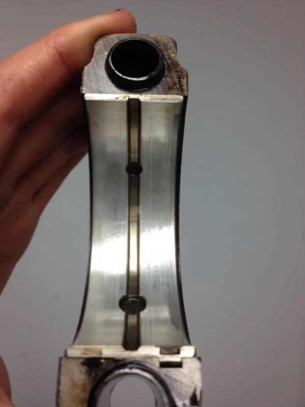

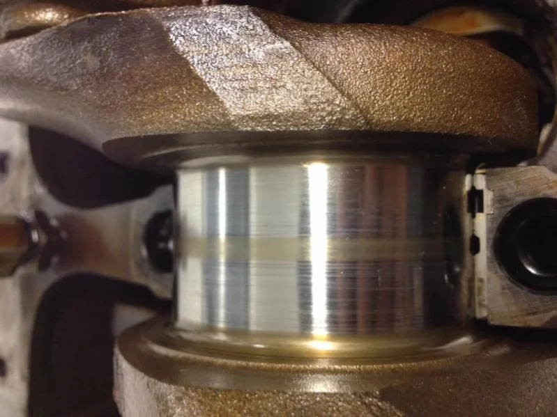

On the down side, I have noticed an oddity around the oil holes of 3 of the connecting rod bearings. Anyone seen this before? Think this is something I need to worry about?
Rod bearings take alot of pounding, looks like they are showing wear. I would think about new rod bearings.
What about the head? Doing anything to it.
Rod bearings take alot of pounding, looks like they are showing wear. I would think about new rod bearings. What about the head? Doing anything to it.
Yeah, now I'm thinking why not do the bearings too?!?!?! Have not really looked at the head yet. I will remove valves and check everything out. New stem seals but that all I had planned on. Any recommendations? Ever seen the eating away of a bearing like the pics above? I have not and it kind of freaks me out... What would cause that?
