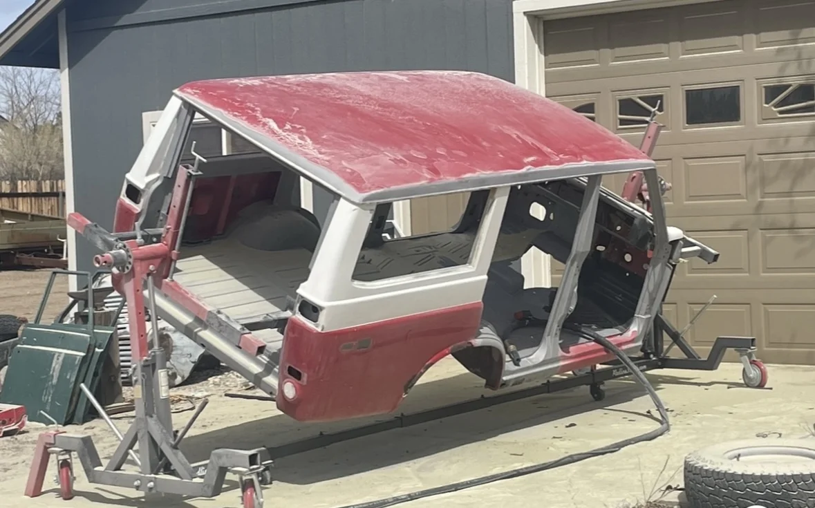

Anyway the Pig is still undergoing rust repair but I’m in forward planning mode. With this big a project I want to do it up. I’m interested in an FJ-80 chassis and suspension. I don’t need a CJ5 ride quality anymore…
