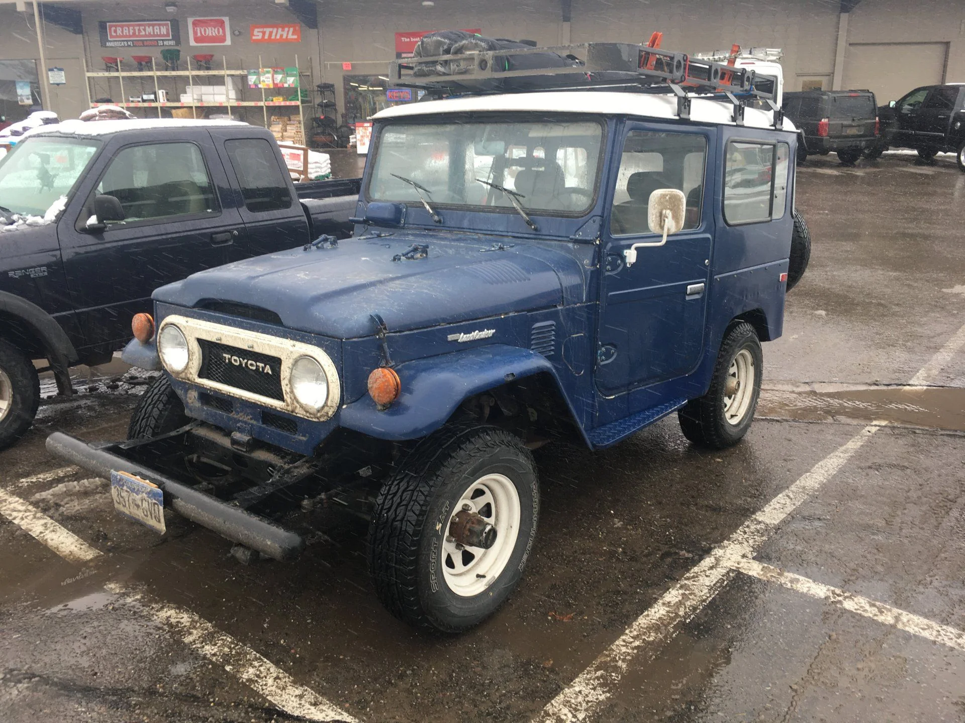

over the past two days ive been driving my 1978 Fj40 from Denver up to Spokane where I go to school. It’s been running fantastically other than an issue that’s starting to worry me
- back story, I left my gas cap in Cheyenne at the station but didn’t realize it until a few hundred miles later. During this time the cruiser developed a cough at high speeds in 4th gear, anywhere from 50+ (will normally cruise 60 no problem with no wind or hills). I drove through some fog, heavy wind, and blowing snow at this time. I bought a new cap so the system is sealed up again.
The cough occurs randomly and you can feel the engine lose power as if dying. The cruiser then jolts quite noticeably for 4-5 seconds and then regains power and accelerates again. It would do this occasionally but usually could go a an hour or two between fits. I assumed it was some water that got in the fuel tank while I had no cap, and that the coughs were just water going through the engine.
Today I’m not so sure though. It’s been having the cough almost all day (about 150 miles so far) but only at high speeds in fourth gear. I’m beginning to worry it could be something else. Carb from changing altitudes? Bad spark plugs? Ive driven almost 900 miles so far, by the end I’ll be around 1100. I’ve had the cruiser for about 3 years and never experienced this.
Has anyone had this problem before or know what could be causing it? Any help is greatly appreciated.
