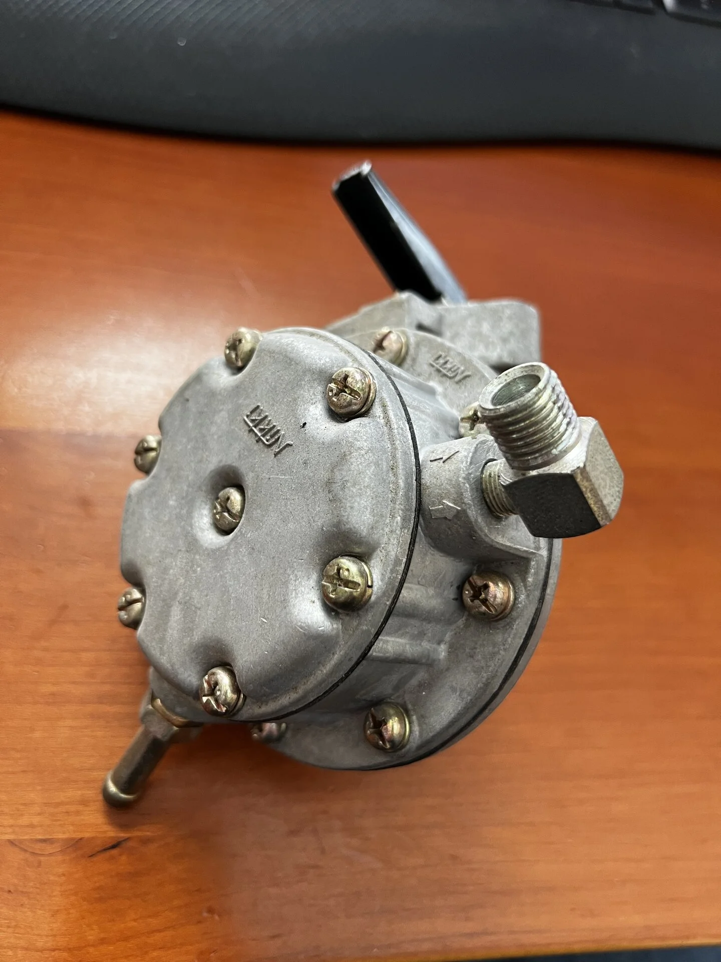

If you decide to go mechanical, I have one available from my '76 40 with 2f. I bought it new, and mounted it to the block during my restoration, but never connected it. It's never had fuel run through it. When I got further into the resto, I decided to go with EFI.
If you're interested, PM me.
View attachment 3551058View attachment 3551059
THe one that we have on there is different, it is for a 77-78 year.
I believe the only difference between the 9/73-9/77 and the 9/77-1/79 is the inlet is horizontal on one and vertical on the other. So it's a plumbing issue from the tank. Probably easier to keep things the same.
