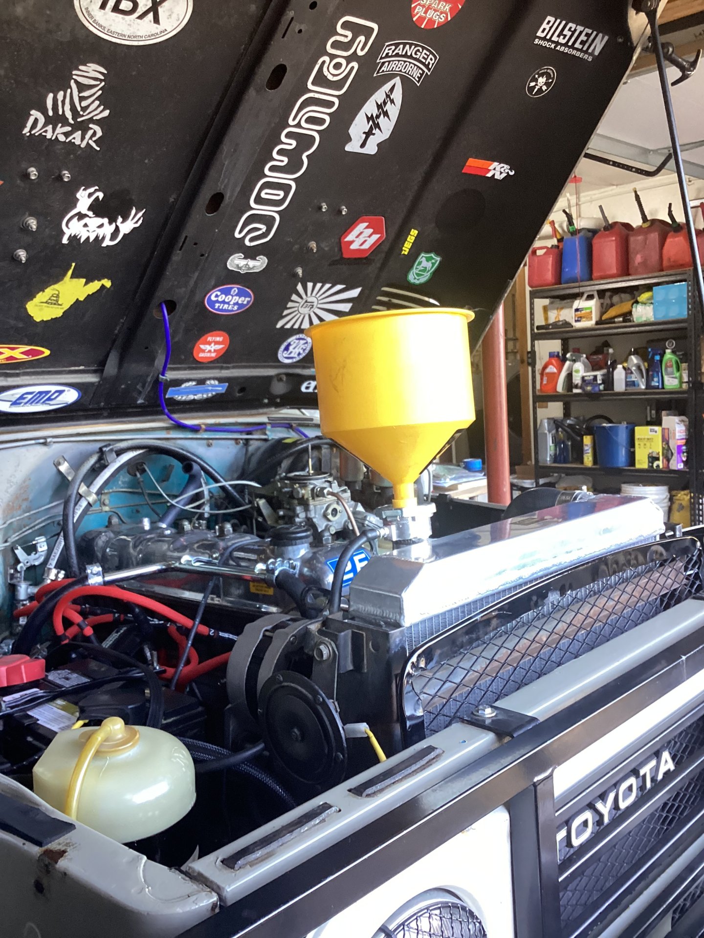

Burp kit. Runs about $20.
That thick rubber gasket between housing pieces should not be used, it should be a thin paper-type gasket, with sealant. I think your thermo leaking as you stated is a good assumption. And burping is also necessary. Where you at BTW?
Nice. Where’d you find that? Is it generic?
This is the NAPA version. Available at most automotive parts stores/centers. Wally World sells them as well.
