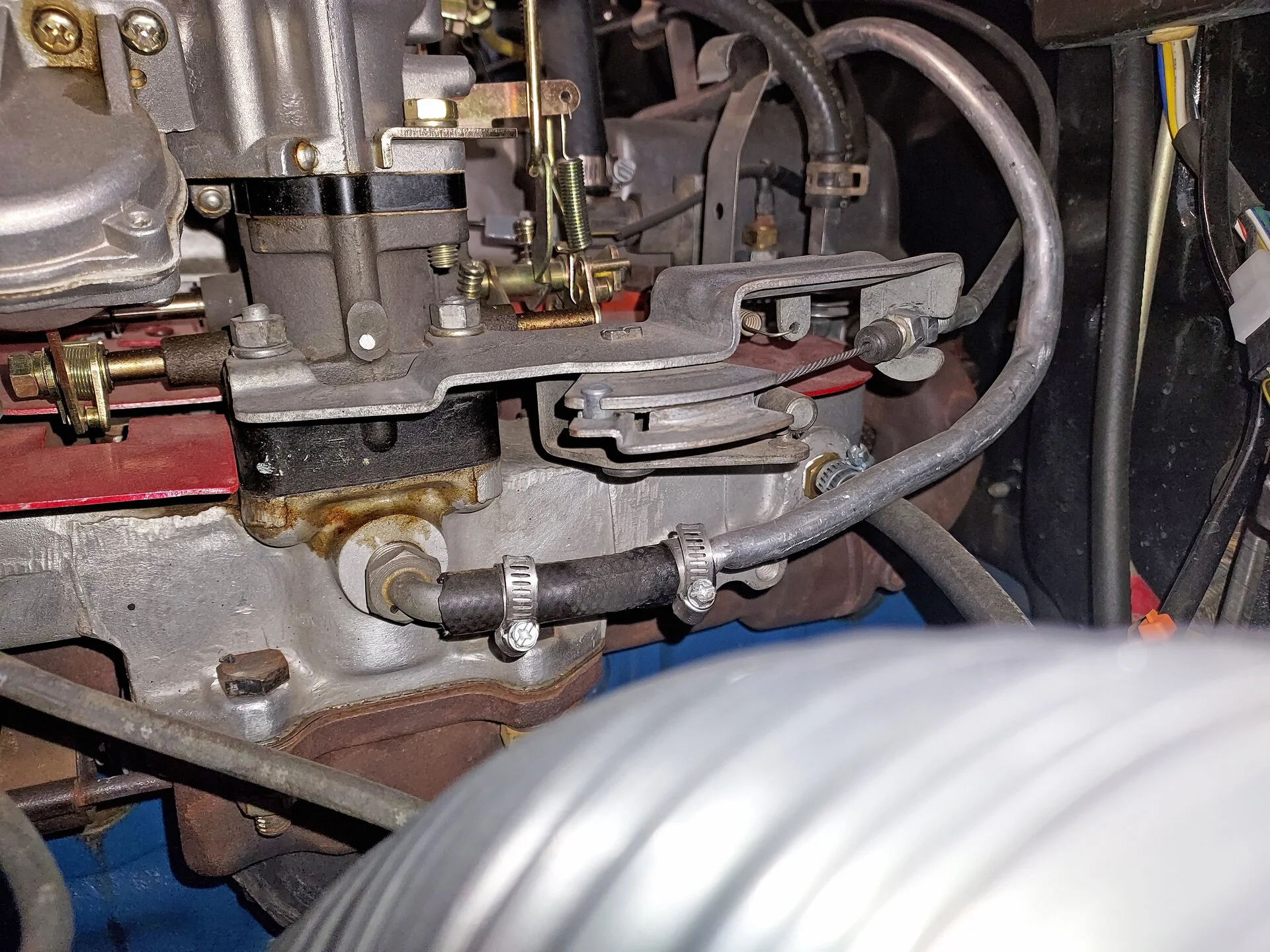

I am now focused on the PVC system thinking that the loss may be contributed to the system it shelf.
The hose / tube runs as it should from the side crack case / PVC valve across to the intake manifold nipple under the carb base area as seen.
PVC valve is fully functional and clean and have three that have been rotated in to see if one maybe defected, all are good.
I starting to believe that maybe the vacuum from the intake manifold may be to much causing excessive oil pull into the intake but have no way to check. I have checked inside the tube on the .manifold side and it appears clean without any oil build up inside but has the stain around the carbs base.
Question is - would this be a possible place to focus more attention on and what should now be checked ?

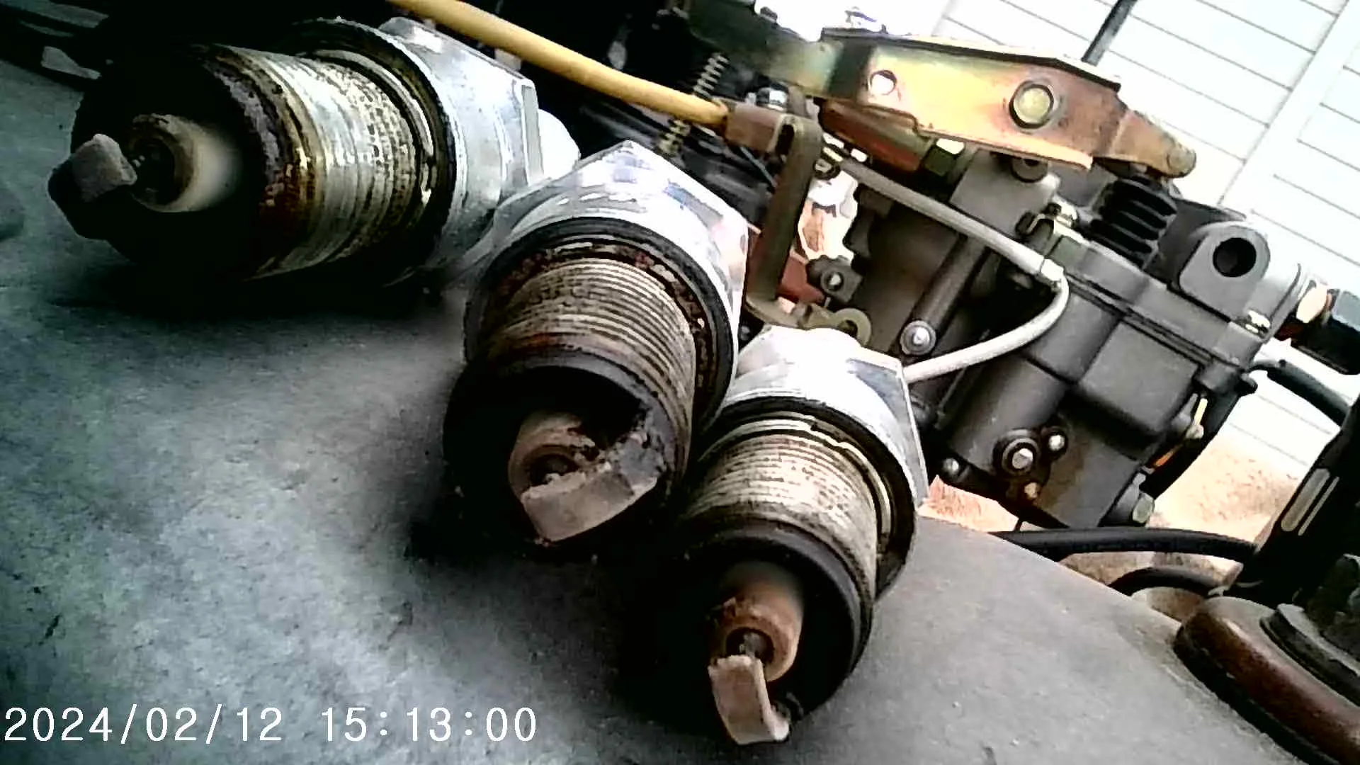

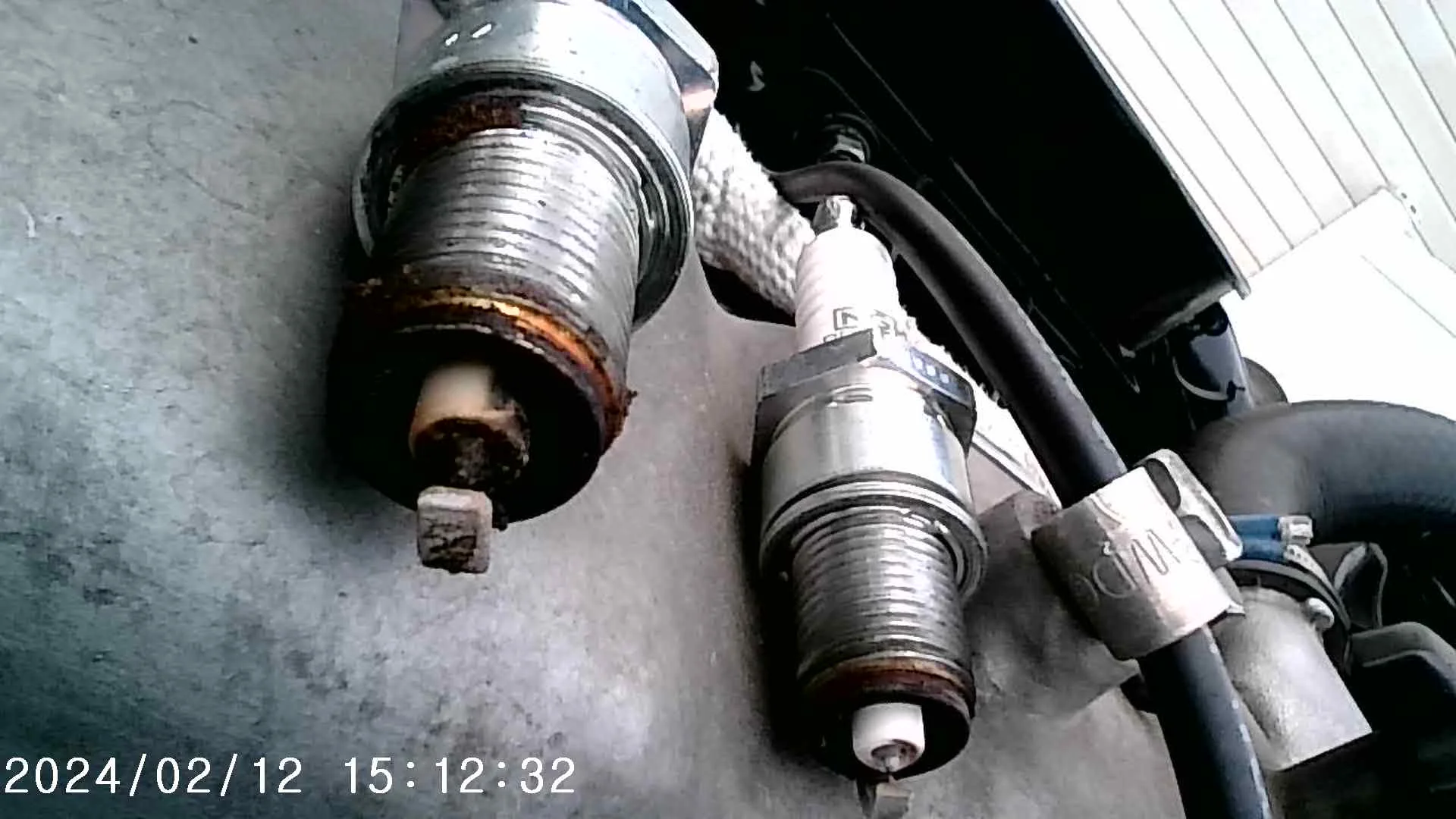

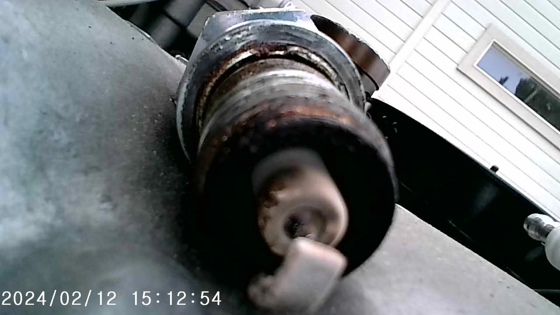

Looking at the plug, it appears your burning the oil.
Yes thats why I posted the picture of one, oil maybe being pulled into the intake as I said by way of PVC system.

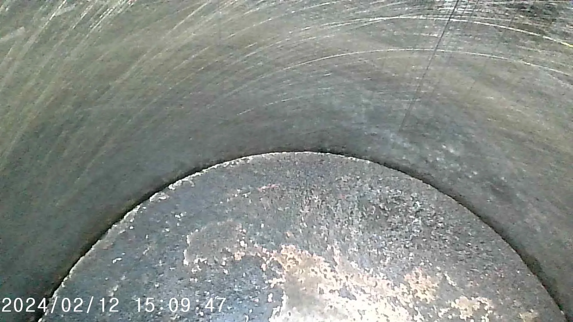

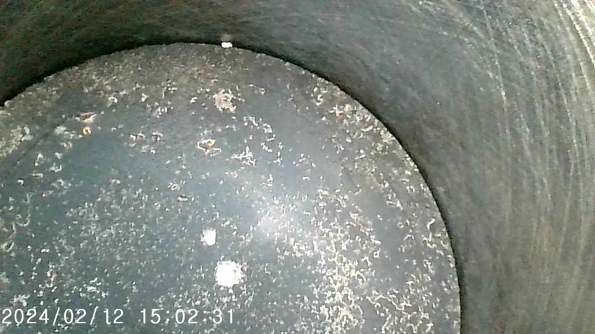

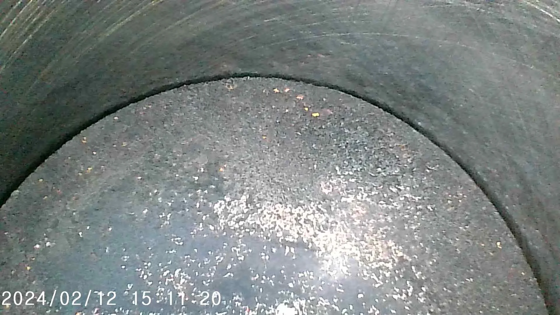

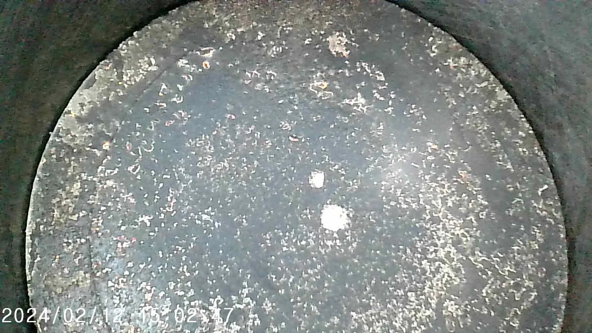

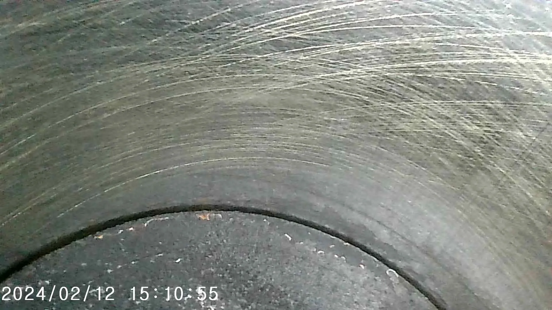

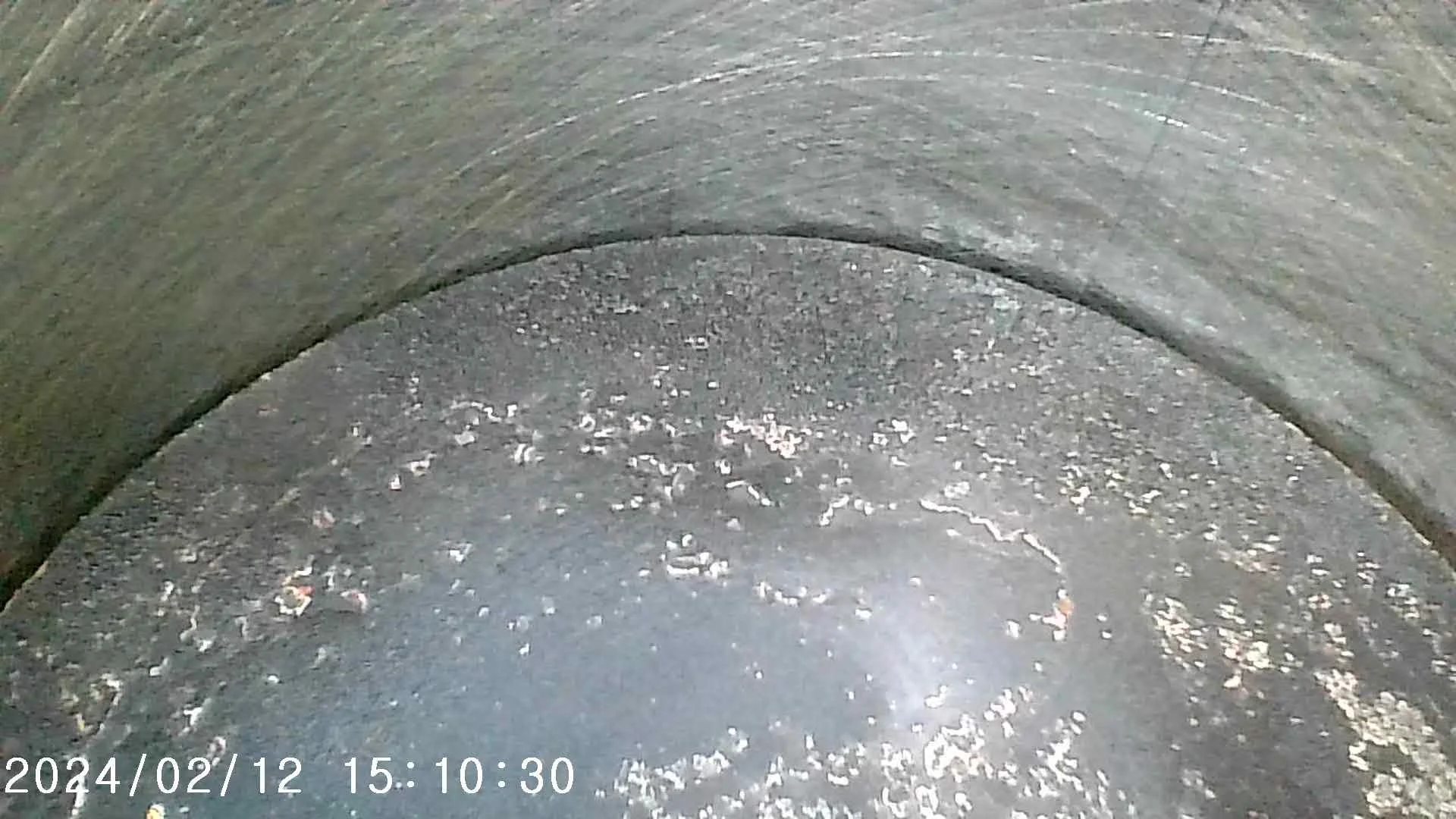

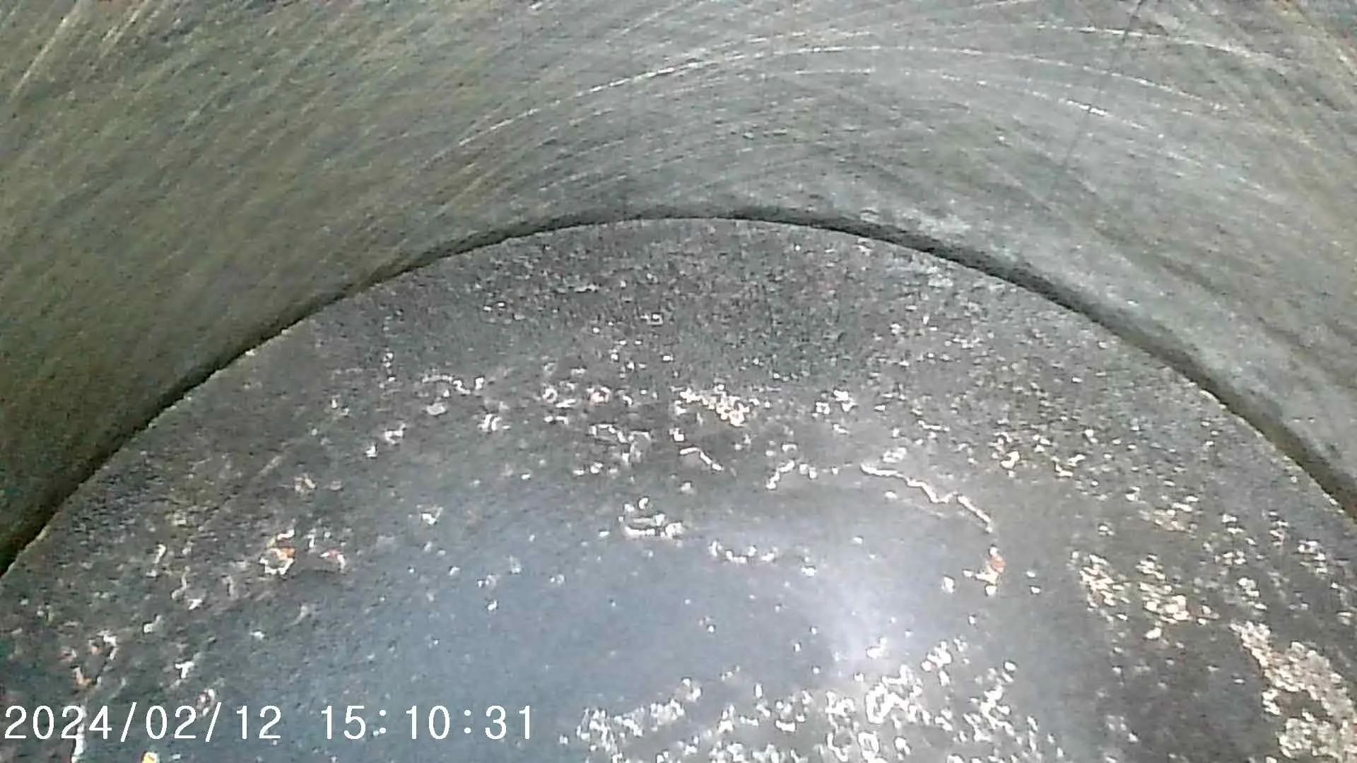

Well I started the oil change a bit ago, and while letting the 2F get hot, I let it idle a bit then gave it a rev, this showed a puff of blue smoke, not heavy but one were it was noticeable. So it's loading up on the idle so its now making me believe that it maybe in the valve train, guilds, or stems or? I gave it a valve adjustment last year so that had been checked.
I also did a prob with a bore scope into each cylinder and took a few pictures. One can see the hone pattern and it shows no deep scratches or loading of oil in the bottom around the piston top. Unfortunately my scope does not do a 180 view where I possibly could get a picture of the valves but as far as the rings go they are fine.
There is a trace of oil in the intake below the carbs base area, I could not get the scope into the small cavity of the carb but it shows signs oil.

The plugs look a bit crappy after only 100-200 miles

Cross hatch doesn't look too bad; a bit coarse but they did hone them. That last cyl has some scoring though.
Why not just unhook the PCV and drive it a few days and see if the problem goes away? I don’t think it will because if you were getting that much oil through it, the PCV and the inside of the hose should be soaked in oil and readily noticeable.
Just warped up the oil change and compression and leak down check and all is good???
While doing al that I removed the PVC valve and wrapped a white cloth around the end of the hose to see how gravity would help on any drips from the hose and it actuly had enough to now buy another PVC valve and give it a try again.
In the mean time yes the cylinders walls do have a few vertical line but not enough to be overly concerned right now.
I am thinking that the oil has to be being pulled into the intake and diluted with the fuel just enough to lightly coat the spark plugs.
When cleaning the plugs it was actuly very soft and cleaned easy with just a tooth brush.
I might give the disconnecting the PVC system a try and see were that goes later, but after I get that new PVC valve and see what that does.
I am with a fine collection of PVC valves. :eek:
