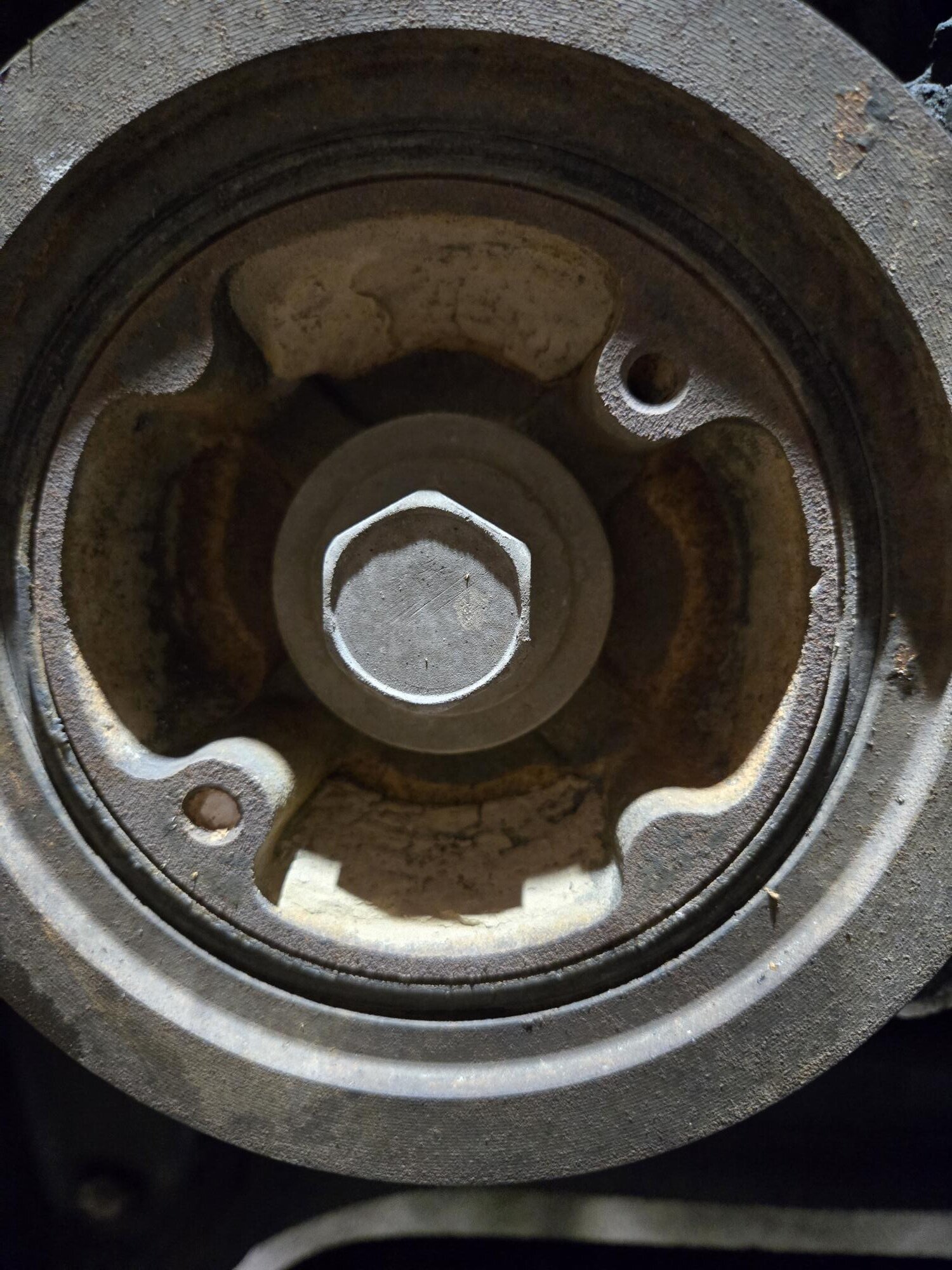

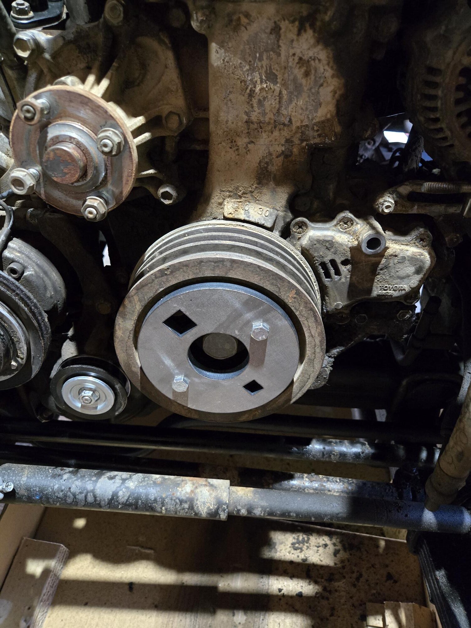

I had the typical 1FZ front engine oil leak, so I replaced the crank seal, oil pump gasket, etc.

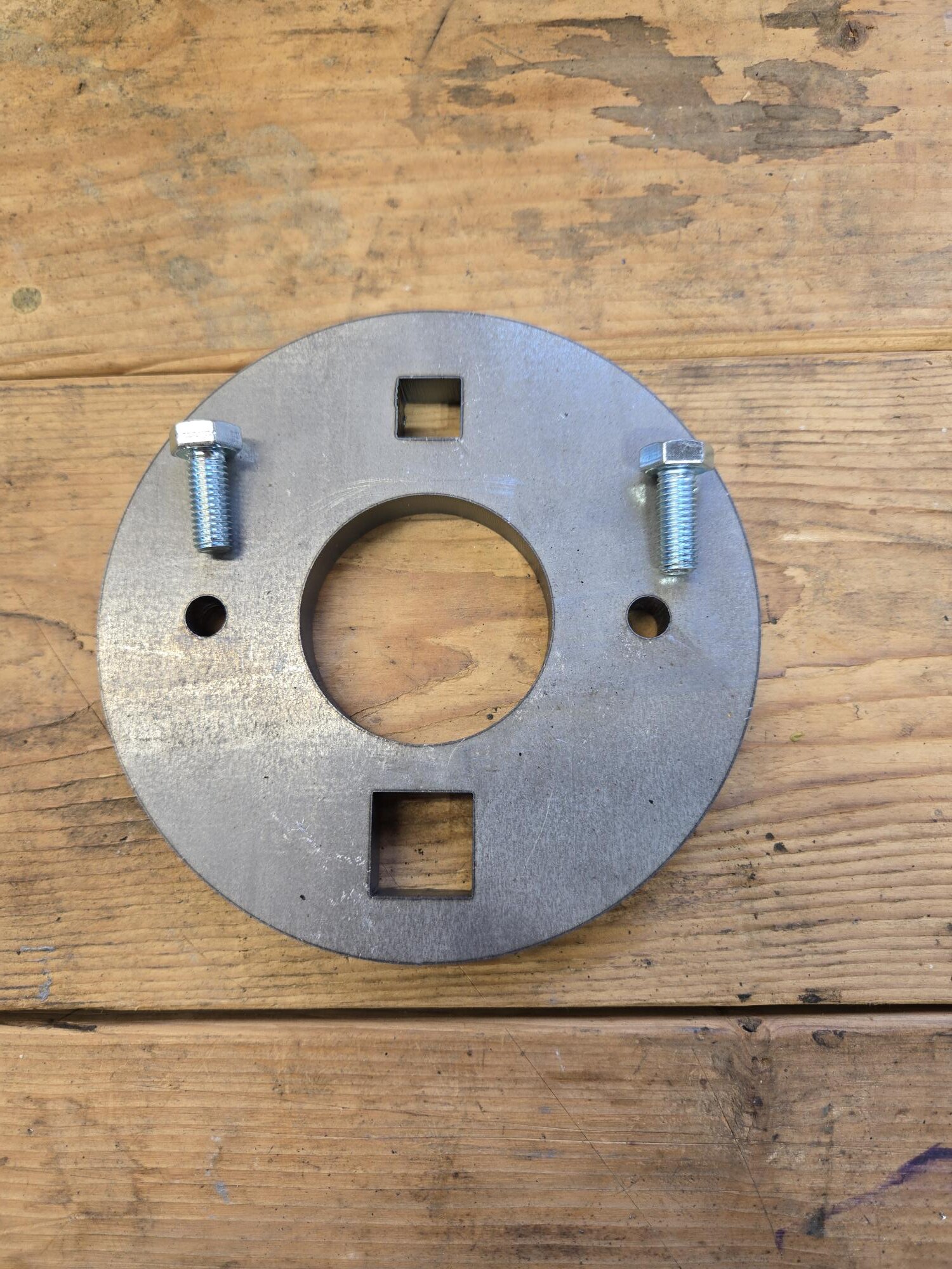

I would highly suggest purchasing the crank pulley tool offered by @CPACruiser, it made my life MUCH easier removing the crank bolt.
Most 80 guys go to a Alan screw when replacing that cover :cool:
And that crank bolt need to be torqued 304 FT LBs if your not aware.
Yes, thanks Broski, I torqued it to ~305 ft lbs. I followed @OTRAMM's videos on this, so shout out to him for making all the Cruiser repair videos.

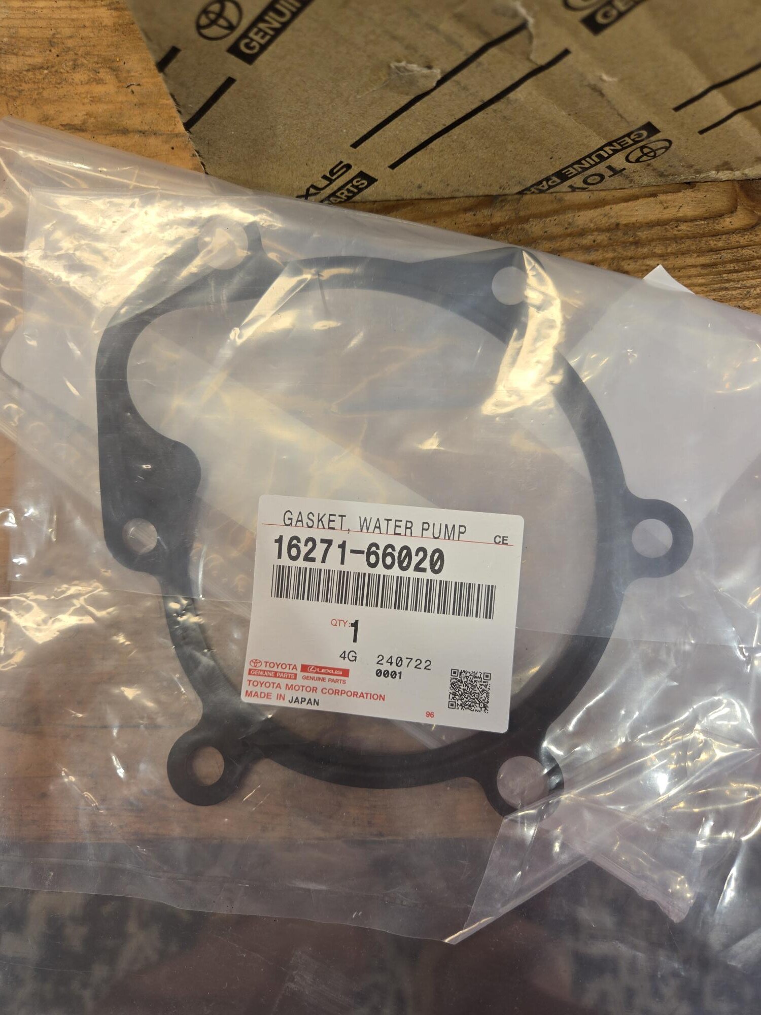

Got the fan clutch and water pump replaced too. I wasn't positive the water pump came with the gasket, so I got one just in case. So, if you just need the gasket the part number is listed.
