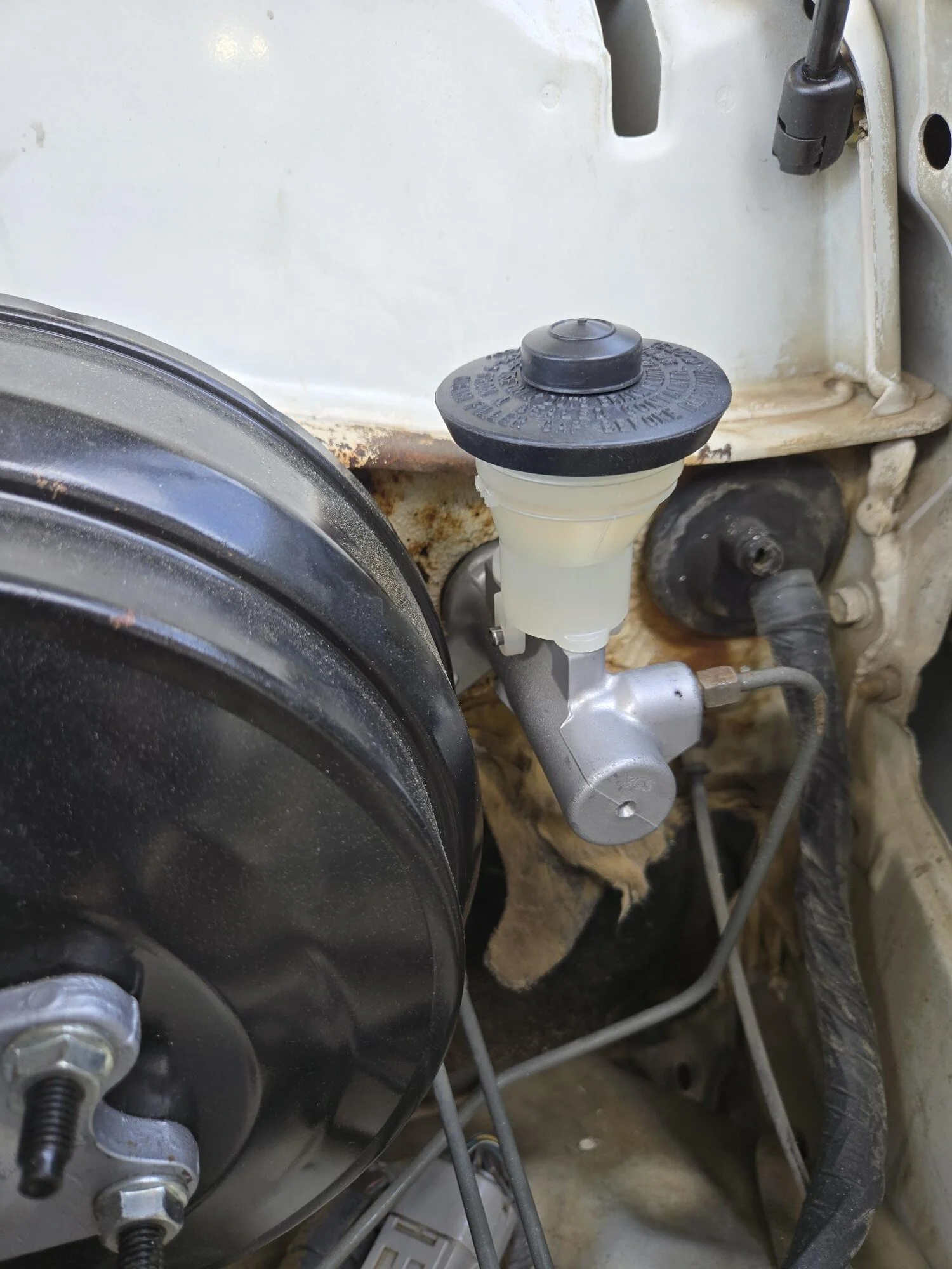

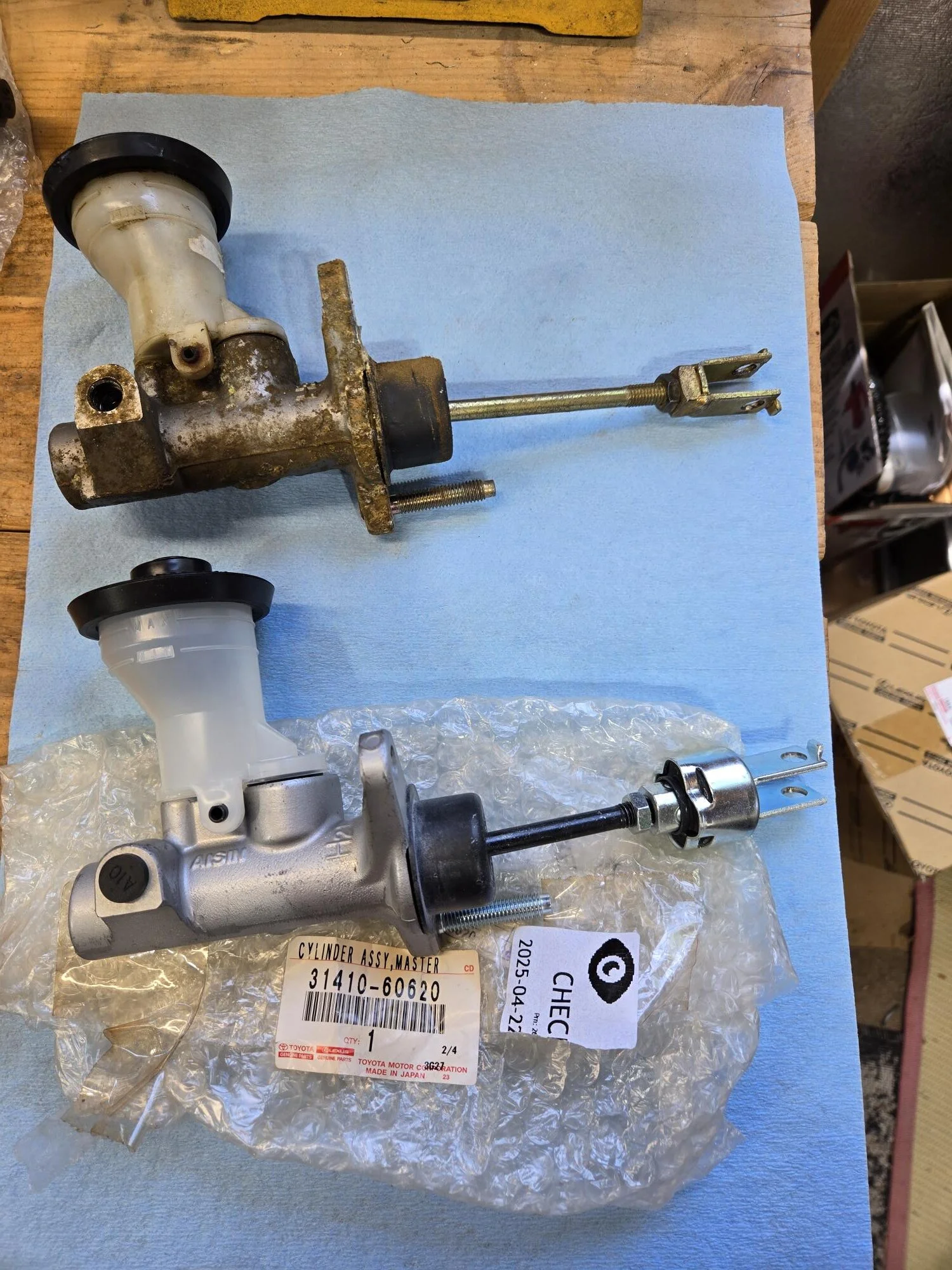

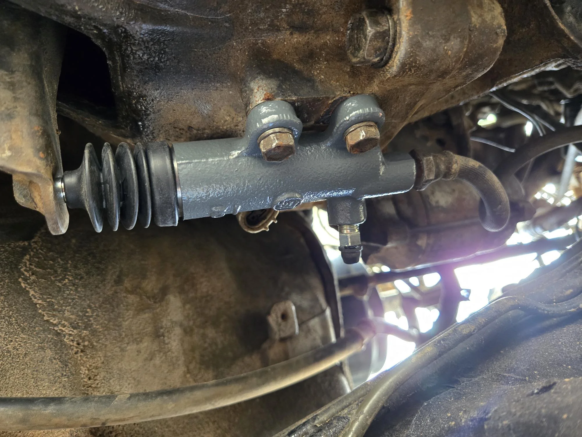

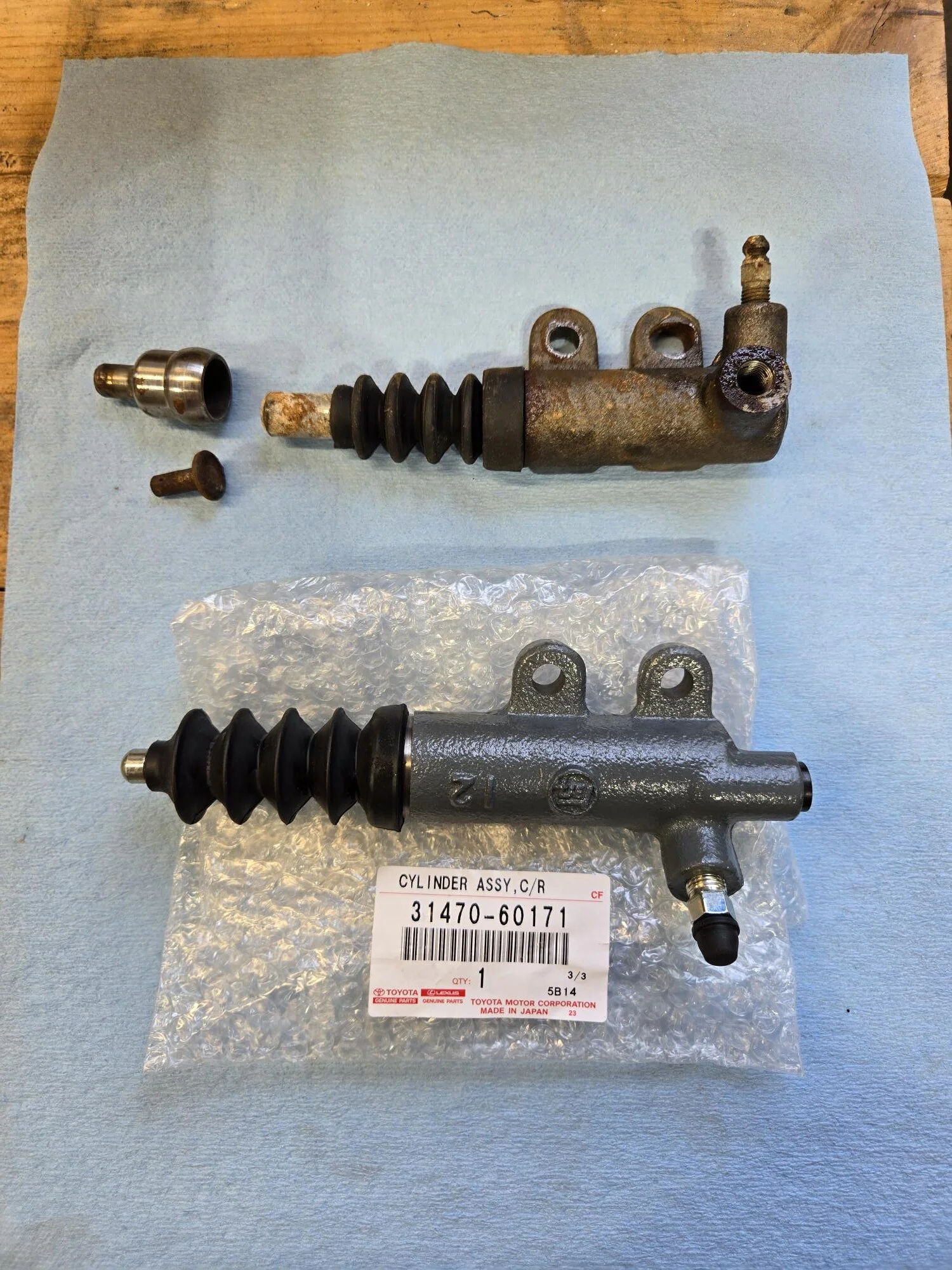

My clutch was sticking about halfway to the floor, but I could pop it back in place with the top of my foot. Turns out, it was a failing slave cylinder. So I replaced the slave & master, and it's back good as new.

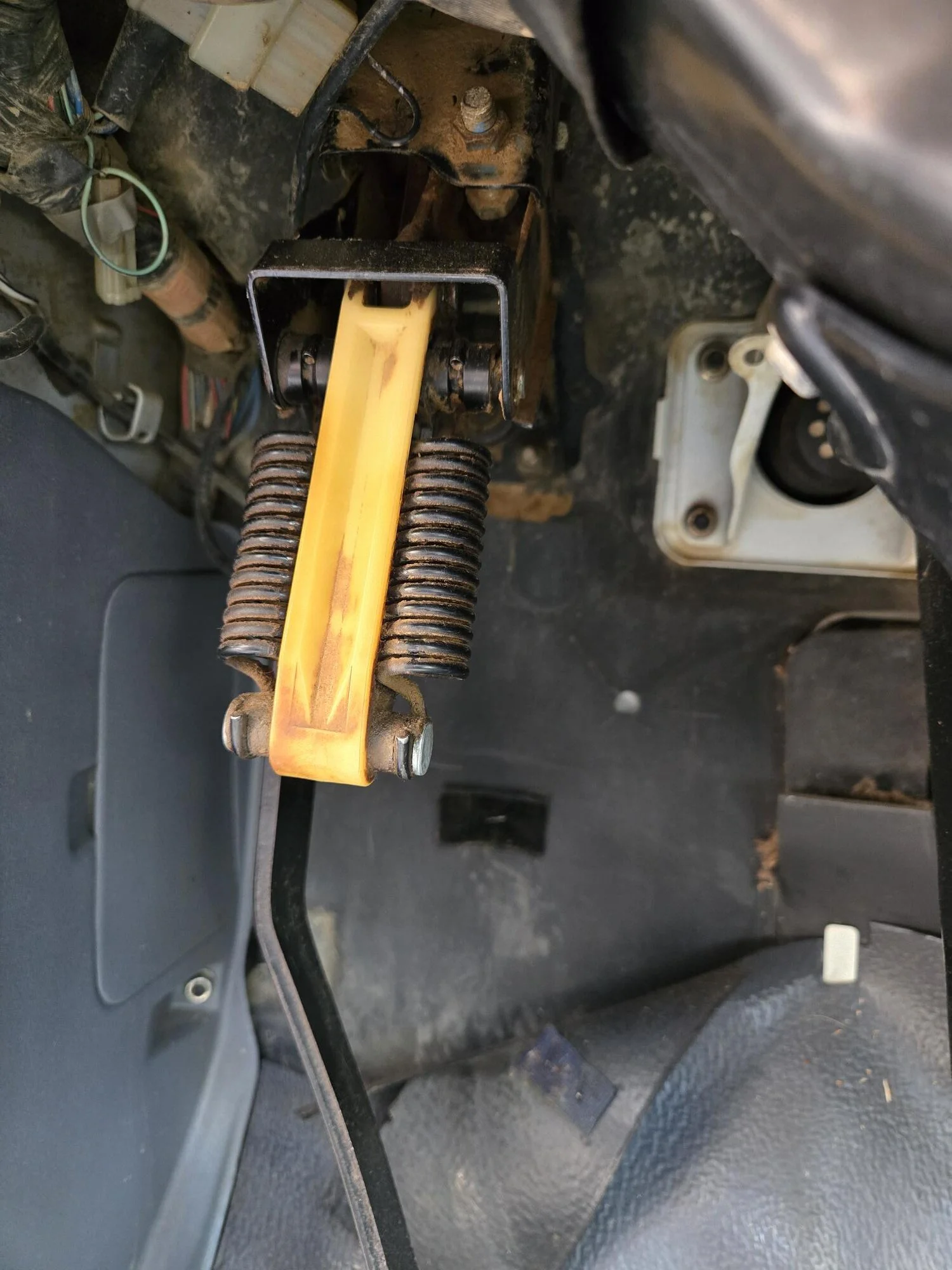

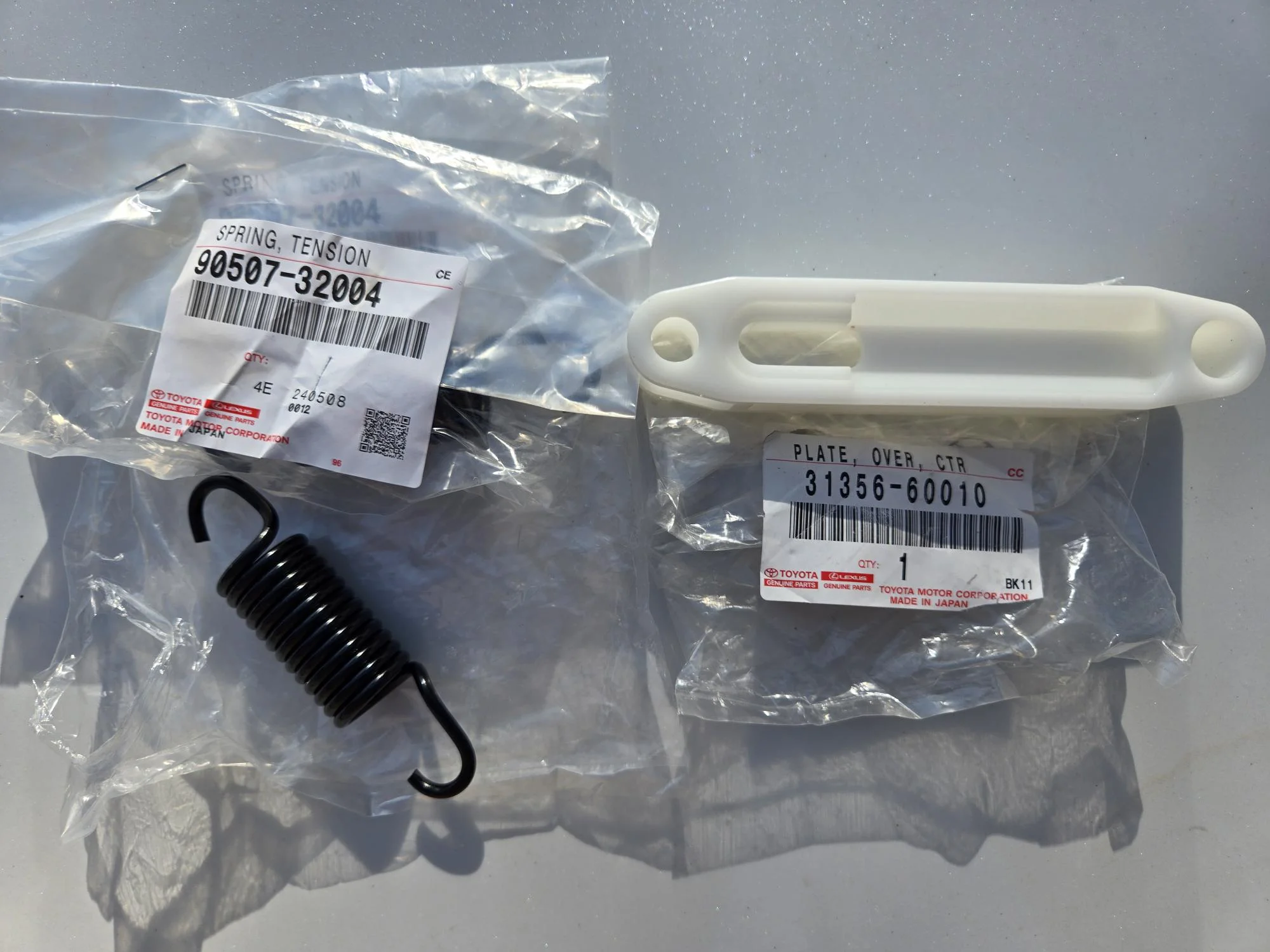

I just used a wire coat hanger. Use the loop on the end of the coat hanger to grab the end of the spring and pull down. Popped right off. However, that was after I tried about 5 other ways to get them off with no success.... ;) I haven't changed out the plastic piece yet, so no tips on that.
I was also going to change the spring from the clutch pedal to the firewall, but it's NLA (PN# 90905-07006). So if someone knows of an alternative please let me know.

I bet those springs are a bitch to change. Ordering now. Any tips?
Hello,
The two tension springs elongate over time. If memory serves, in old age they are up to 5 mm or 3/16 in. longer than new springs.
The other spring is referred to as "tension spring" in the parts catalog. Part number is 90905-07006, and it was available not so long ago when I replaced mine.
A good hook is enough to pull the two tension springs.
The long spring is held in place with two small C-clips. They tend to fly away, and it is good to be careful. It elongates around 3 mm or 1/8 in. over time.
Hope this helps.
Juan
