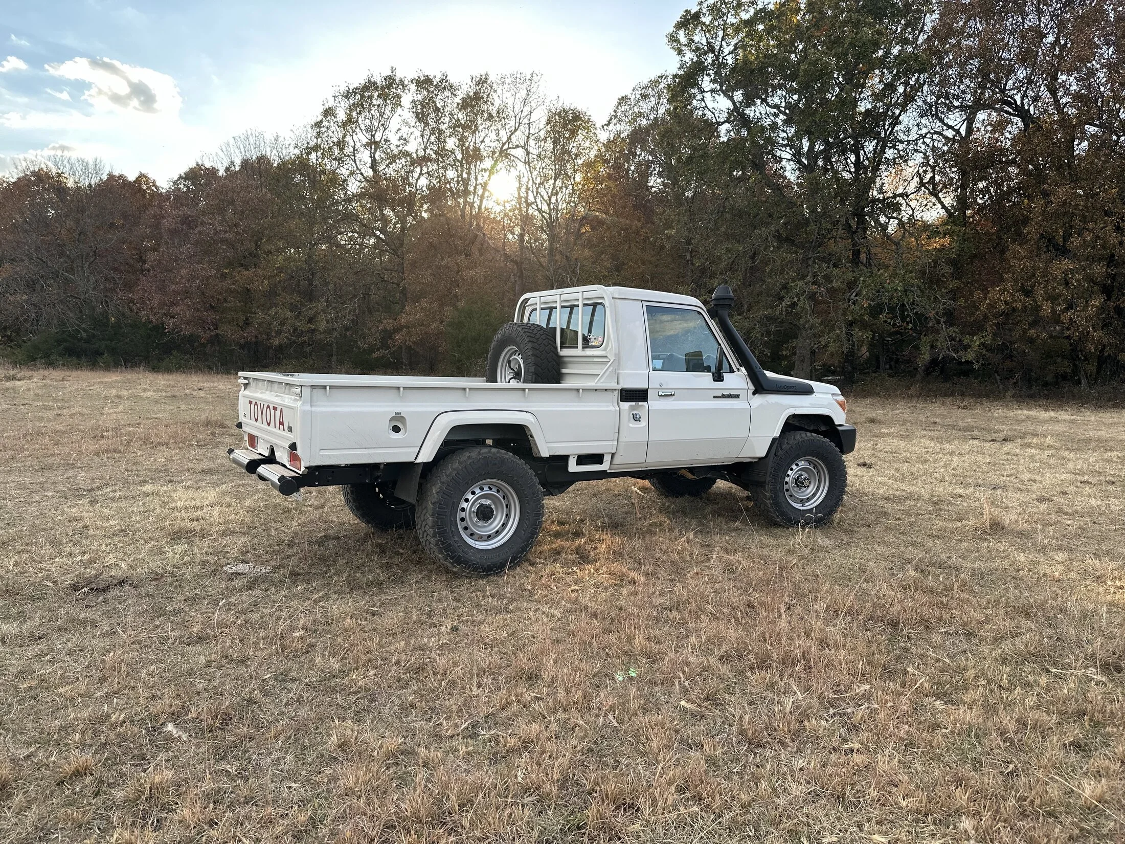

I run a 79 body (2020) on an 80 chassis with 35’s. It has a 2uz from a Tundra and a343 auto from a 100 series. Runs and drives great since I completed the build about 3 years ago.

Do you have a build thread? Gorgeous 79!!
Here it is. Thanks!
Here it is. Thanks!
LOVE IT - thank you!
