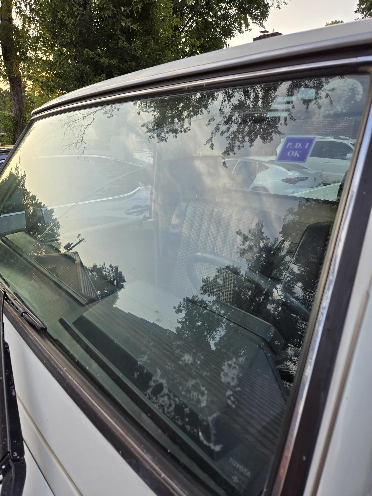

My windshield had some pretty deep scratches from living in the desert. So, I was happy to find you can still order the windshield and front and back weatherstripping at US dealerships.
My windshield had chrome trim on the weatherstrip, but I believe that's NLA. I'm fine without the chrome, I'm trying to de-bling it a little anyway.
