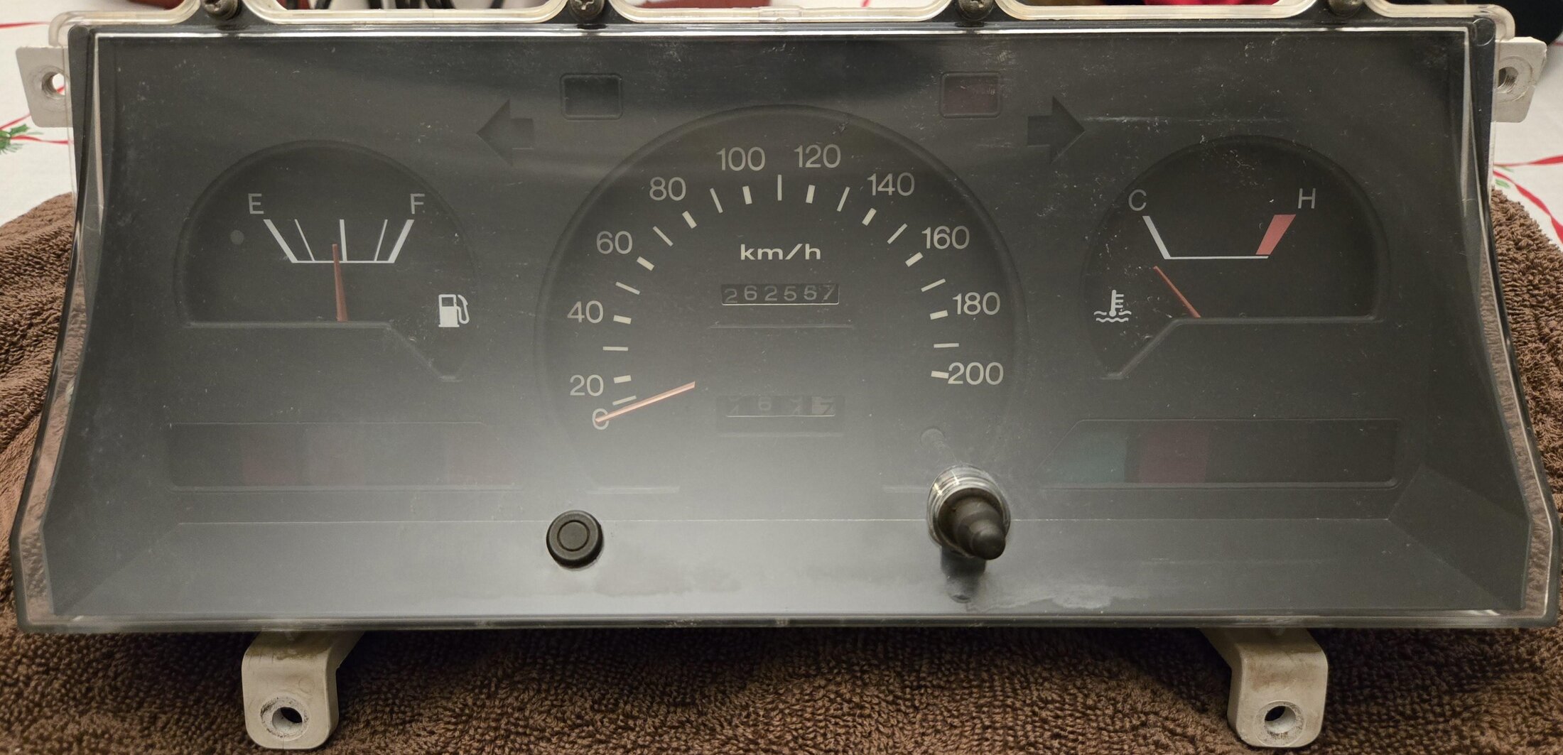

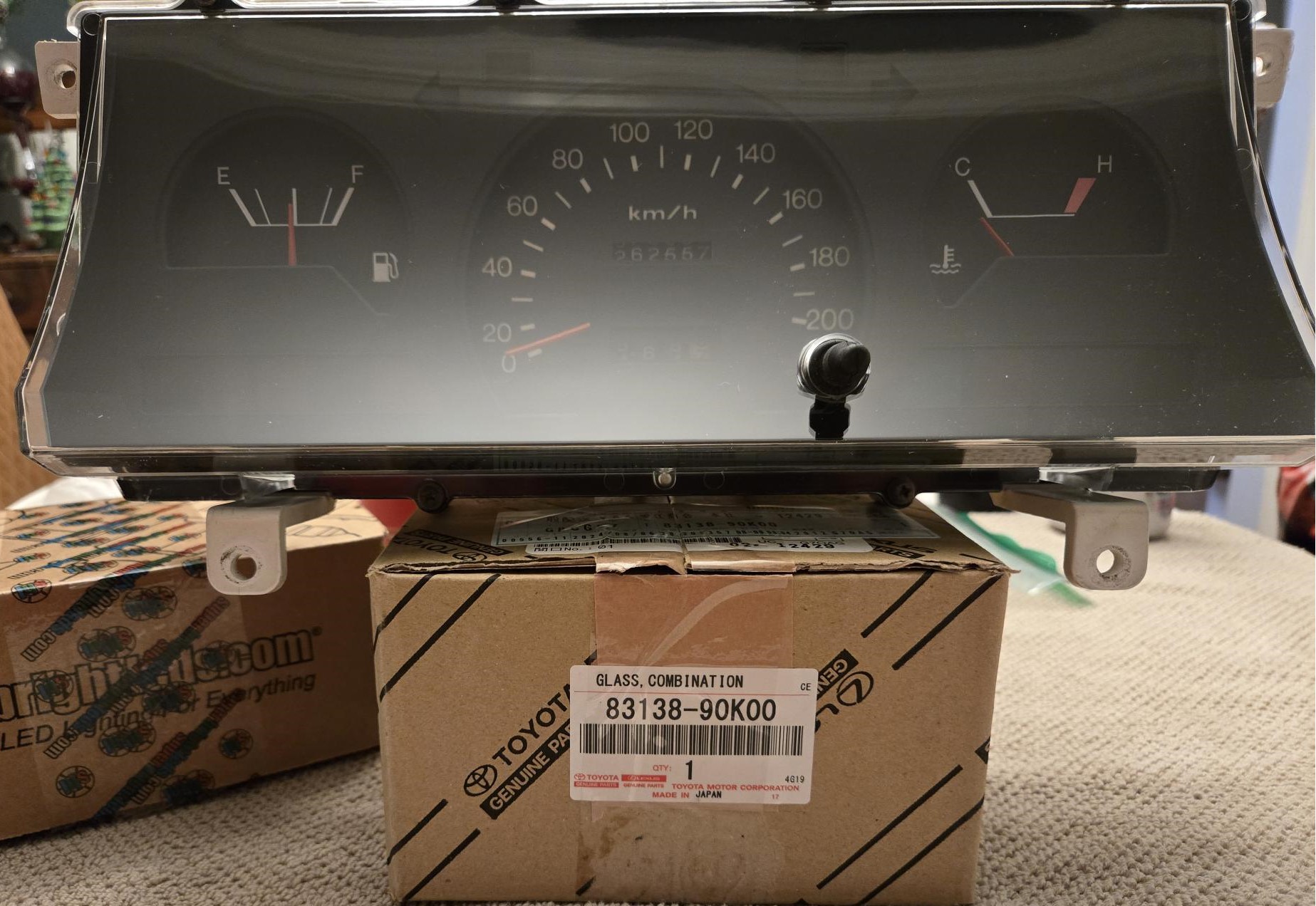

While I have it out, I did a little refurb on the gauge cluster. I swapped out the bulbs for LED's, painted the needles and replaced the glass. My particular cluster has 15 bulbs.
Here is the paint I used for the needles and the bulbs I used from Super Bright LED's. The 194's are the large bulbs and the 74's are the smaller.
194-GCOB1W (Green) 4 req.
194-NWCOB1W (Nat. White) 3 Req.
74-GHP (Green) 1 Req.
74-NWHP (Nat. White) 7 Req.
That original glass ain't bad. Mine looked like someone sprayed oil on it in 2004 and never cleaned it. It was so bad.
Ha, that's actually a used replacement glass I put in to replace the original one that was much worse. I couldn't find a new glass at the time, so I settled for that one which isn't too bad. But I found a new one, so no more scratches (for now..;)
