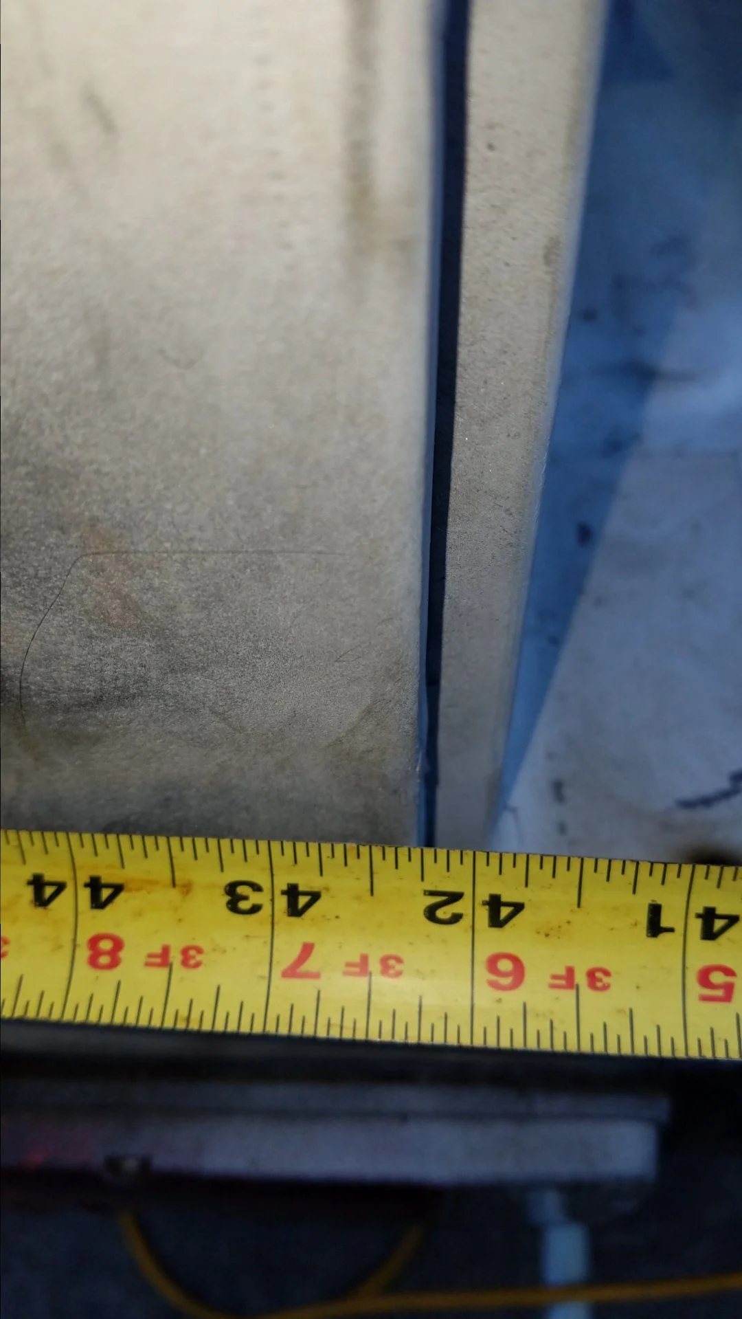

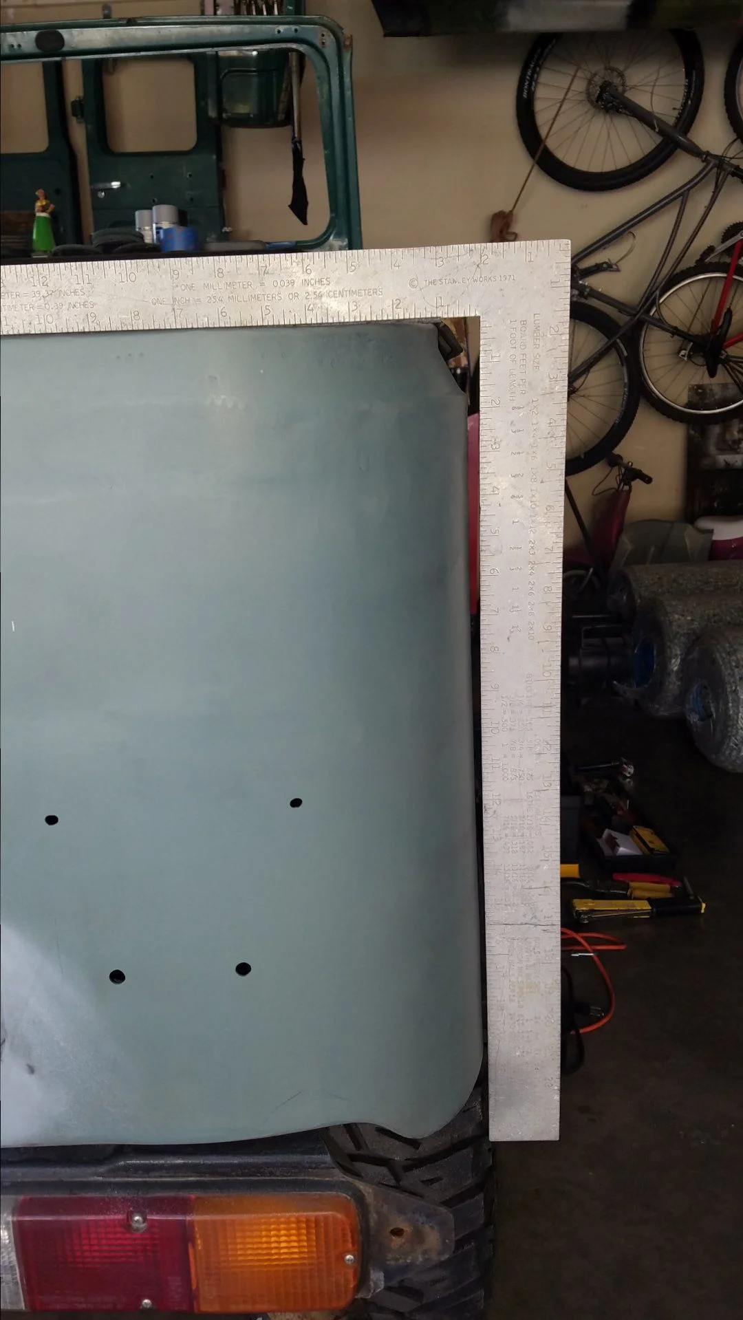

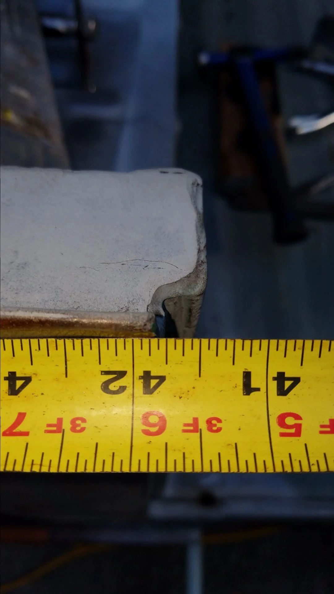

I ran into a a issue today. I thought everything was really close " square and plumb". Well looky here..
1st pic.. top of the tub is 41 inches!! Which is what it should be, because the bed pan is 41 inches, I'm good.
2nd pic. I measured the door jam, which measured 41 3/4 inches at the top. Which is still "square" because I had it welded with a piece of angle.
This is where I have found my problem. I thought I got the quarters squared and tight and "perfect", well I didn't. And I just now noticed it.

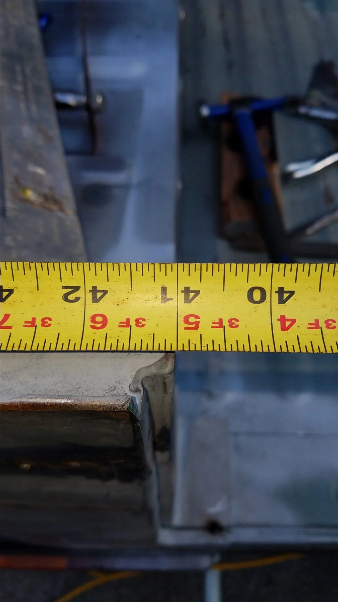

3rd pic measured door jam at the bottom. It measures 42 1/4 inches... thats 1/2 WIDER than the top of the tub.

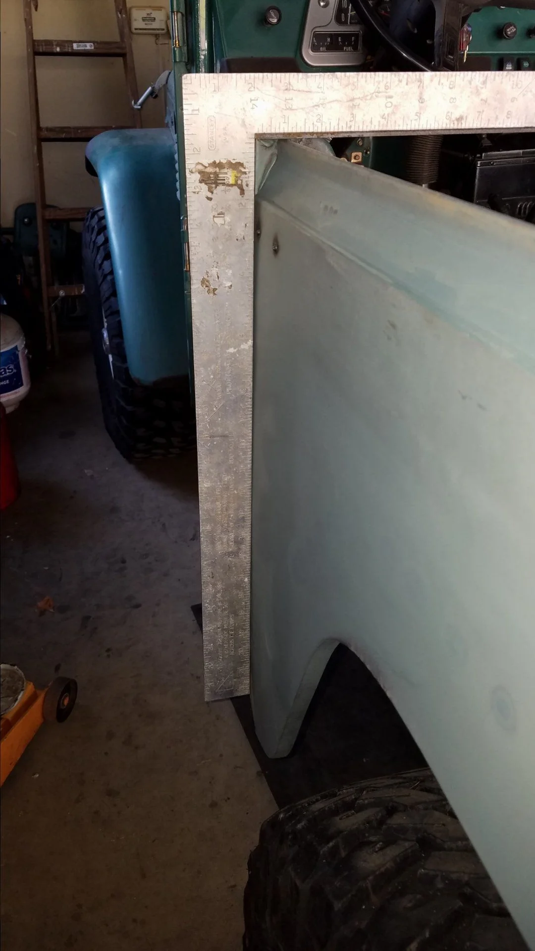

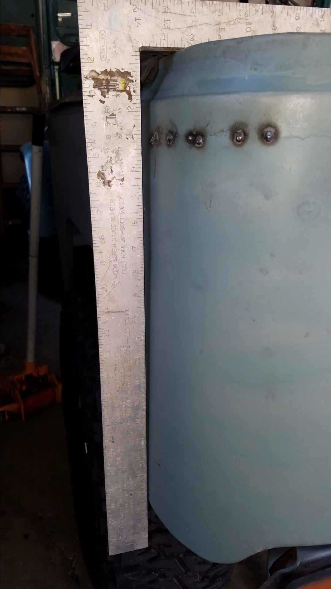

To the best of my knowledge my error was not getting the quarters fitting better at the bottom. I put my framing square against it and each quarter is 1/4 inch out.
I need to put on the top and hang the doors. Fingers crossed, Im hoping it wont be noticeable...

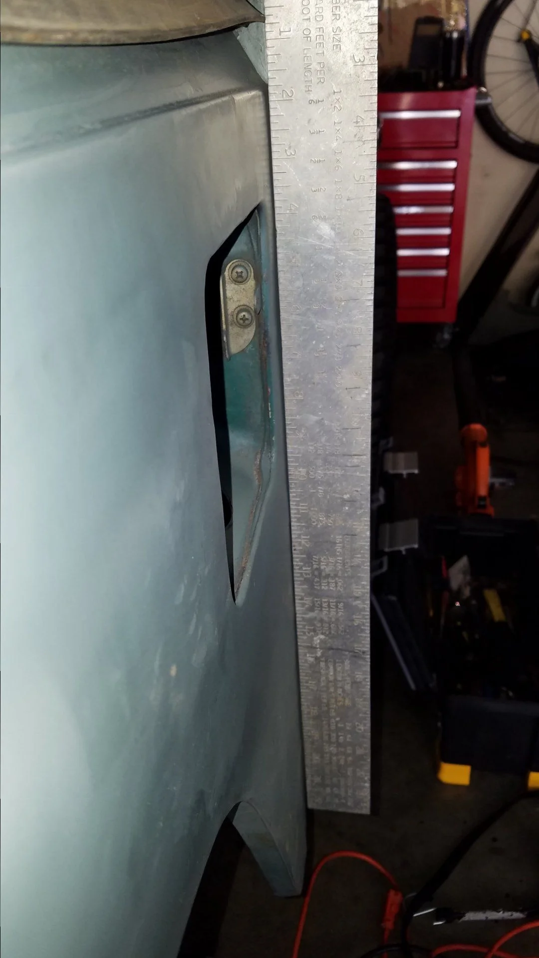

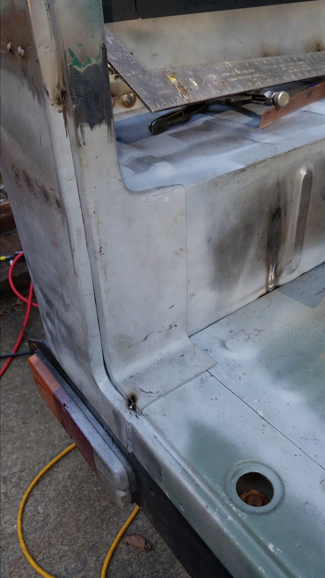

Here are my corner channels tacked in..
Hey @oldschool4wheeling , might have to say :censor: it and cut it and add a piece in. If you do, take your time and fit it so there's enough gap to get good penetration. If you don't you'll end up grinding all the weld off and leaving a crack. Then doing it again. (ask me how I know) Good Sh!t! lol :bang:
Are the quarters flared out at the bottom? If so, maybe cut it loose at the bottom and pull the lower part of the quarters in?
Thanks @gator25!
1. That was one of my thoughts, cutting it and pull it straight to the door jam then weld it up.
2. Add weld to the side of the door jam and grind it flat.
3. :censor: it!! It's close enough.
I haven't had a chance to put the top and doors on yet. We will see ....

This is what i should have done.
Put a straight edge across the back and the use my framing square to make sure the quarter was not flared out.
This pic shows and example of what I'm talking about. ( My straight edge is too long, I would cut it to with of the top of the tub so my framing squares hang freely.
See how my Framing square hangs freely and is tight to the tub..??
But notice zero gap at bottom .... and 1/4 inch gap at top
This is the B pillar...... perfectly square to the top of the tub.
