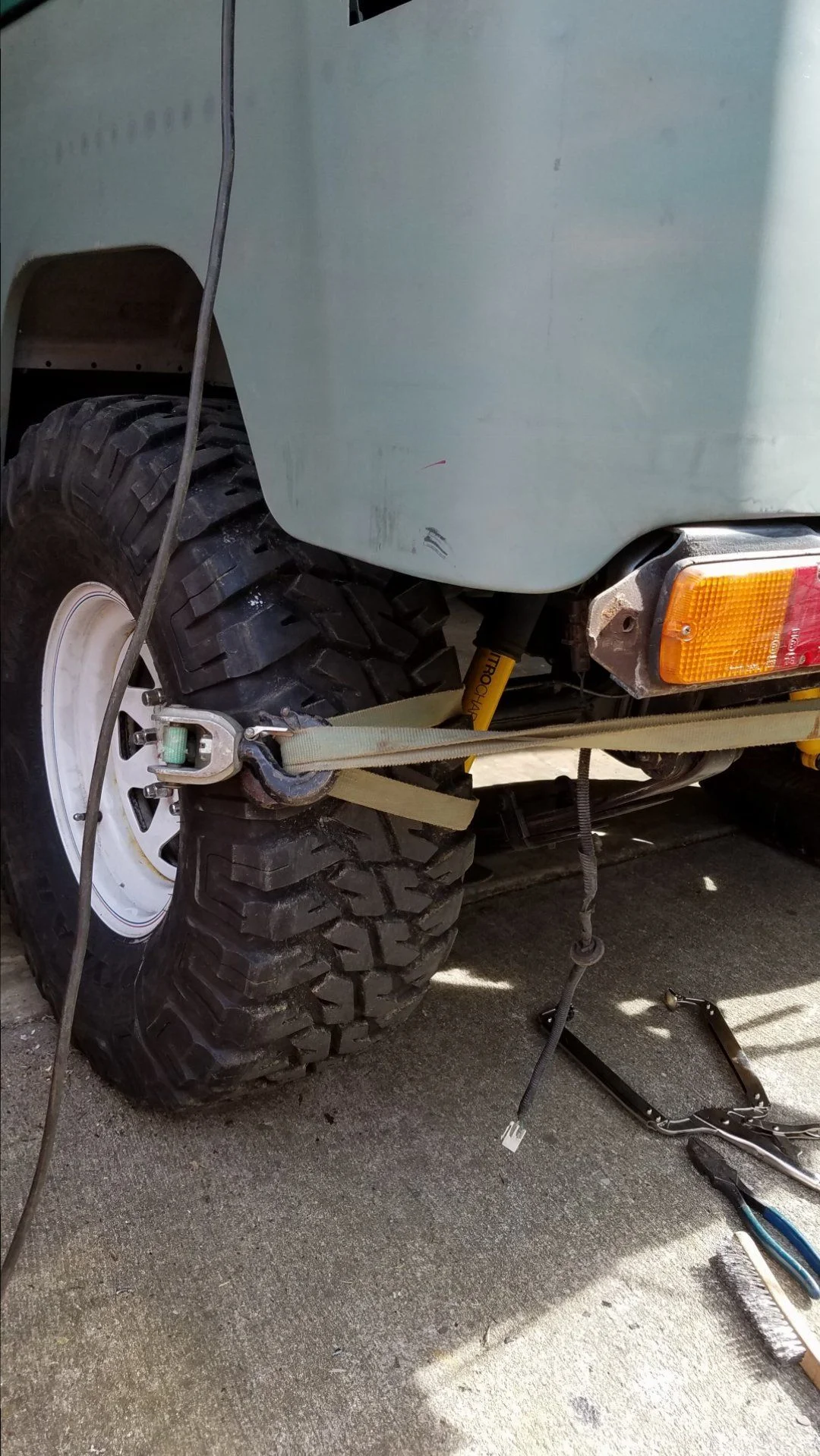

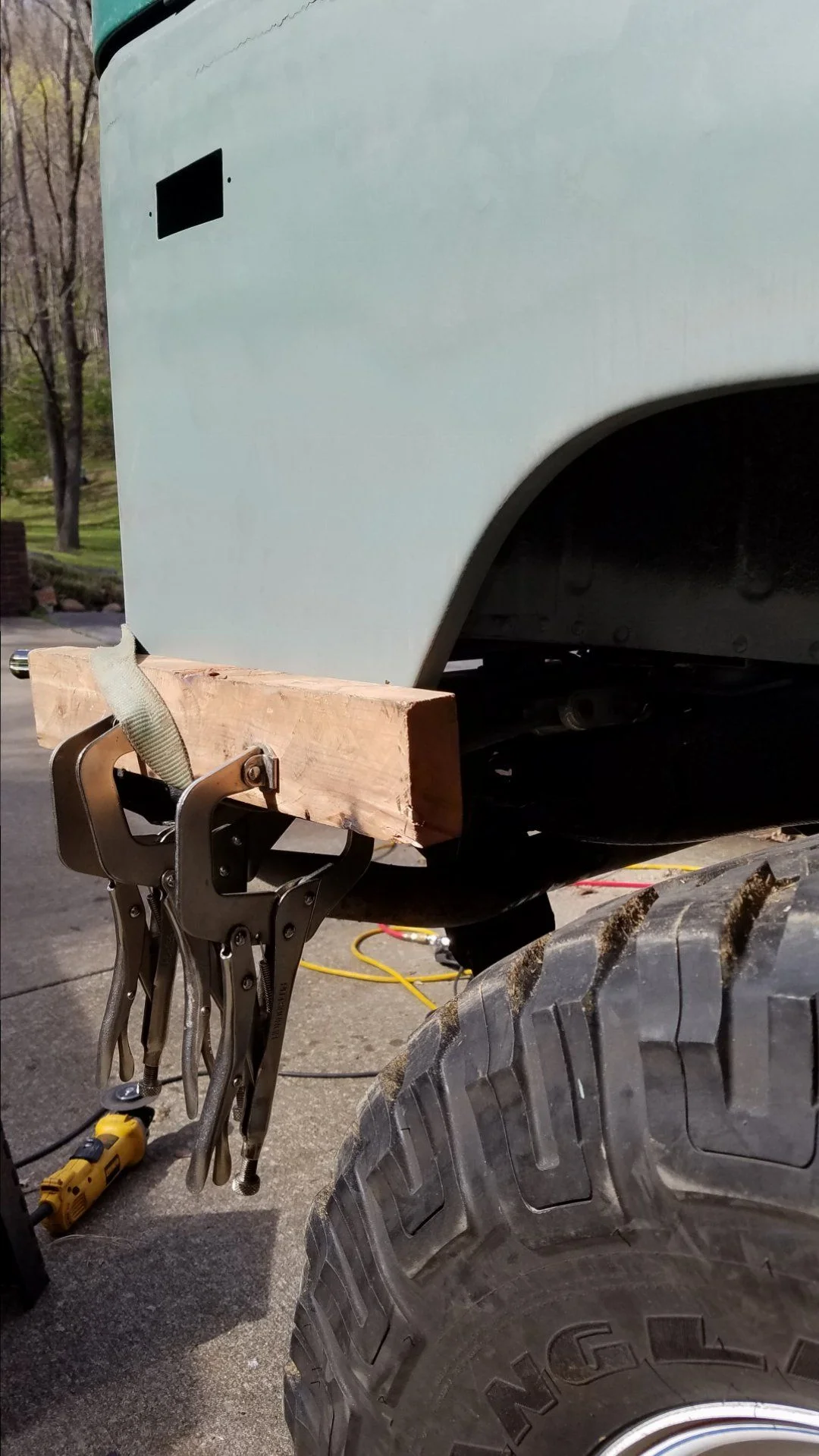

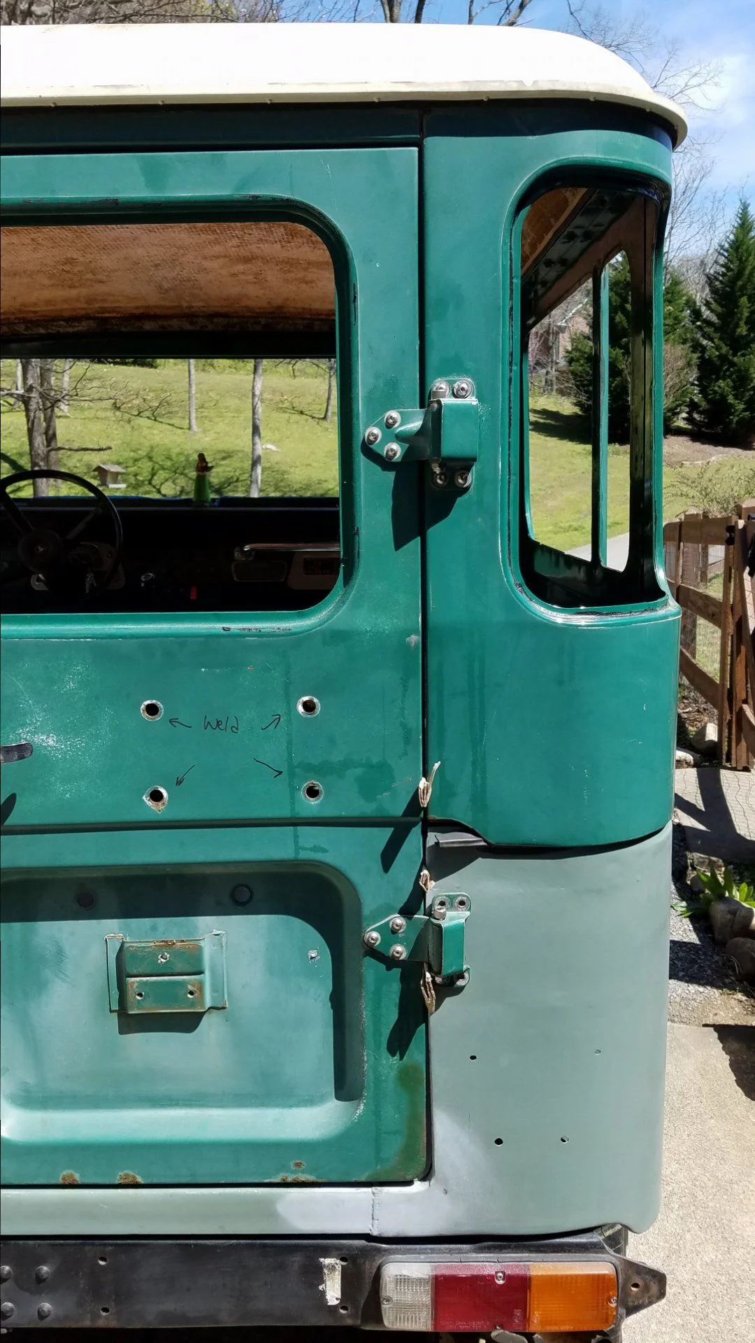

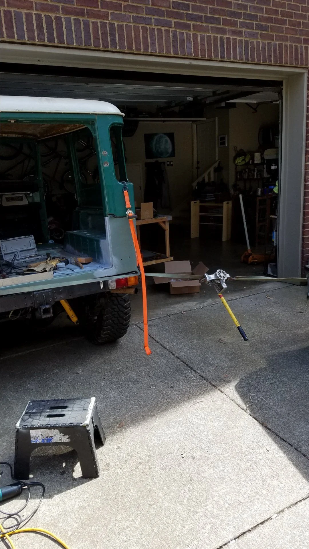

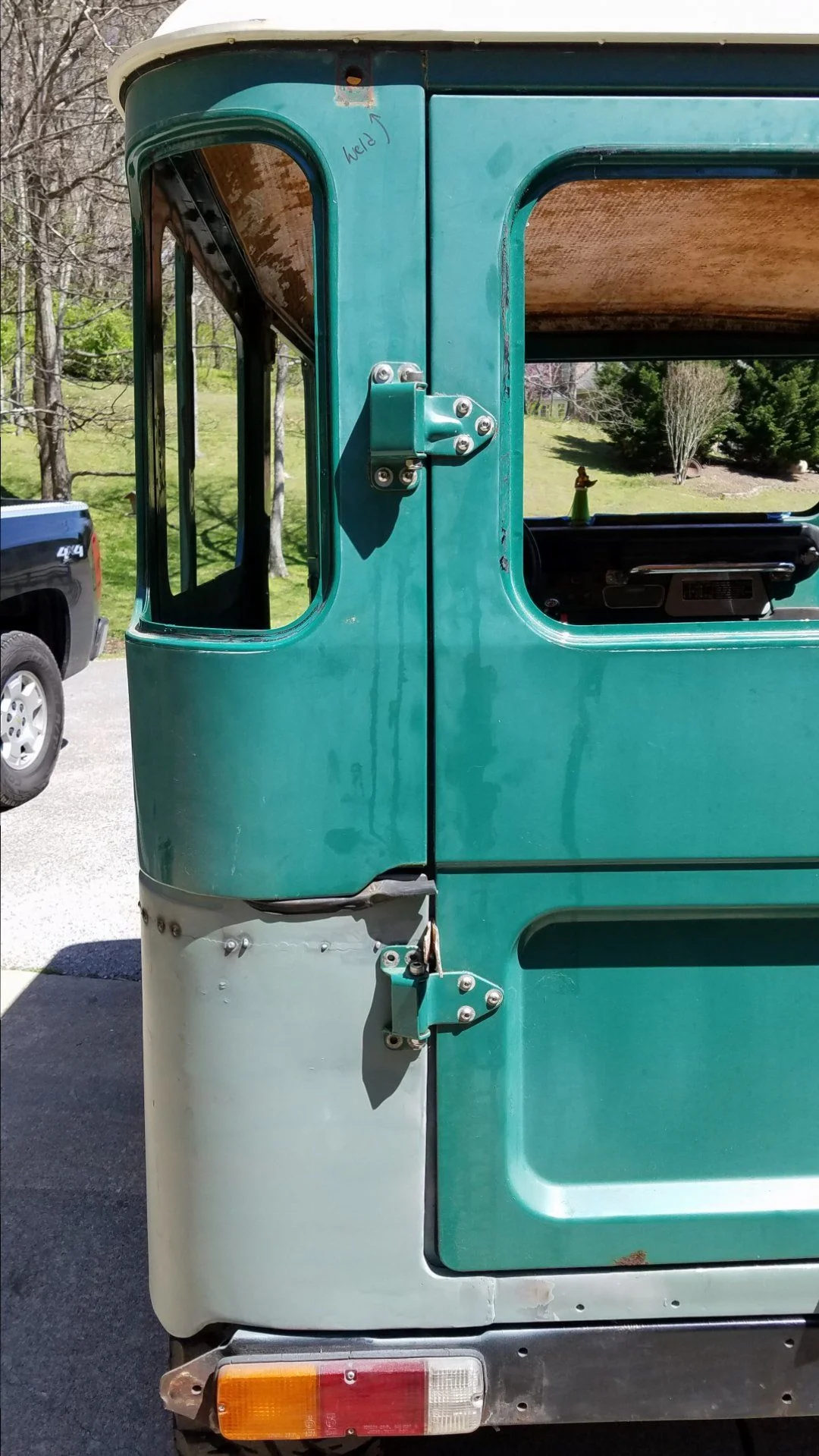

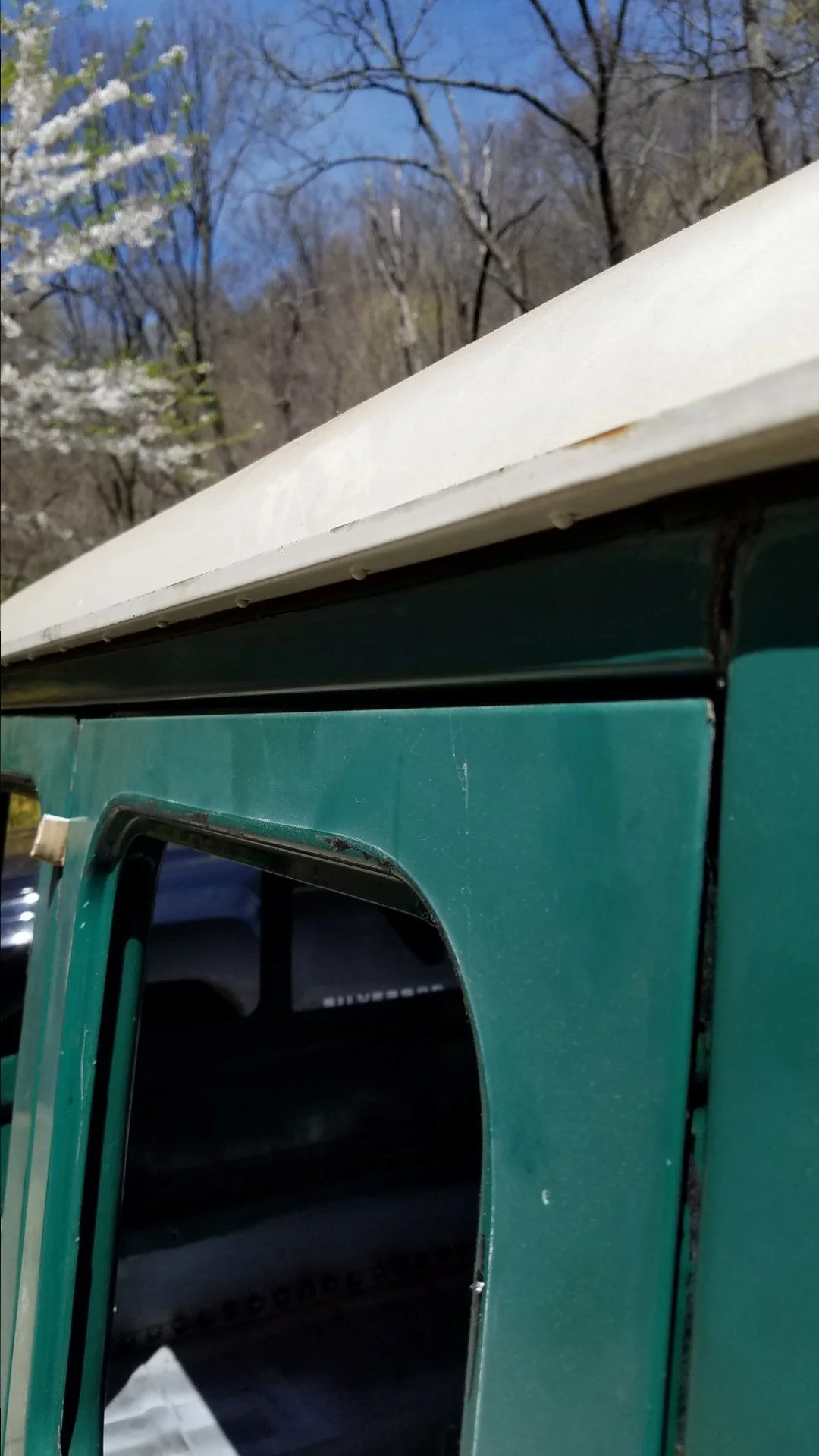

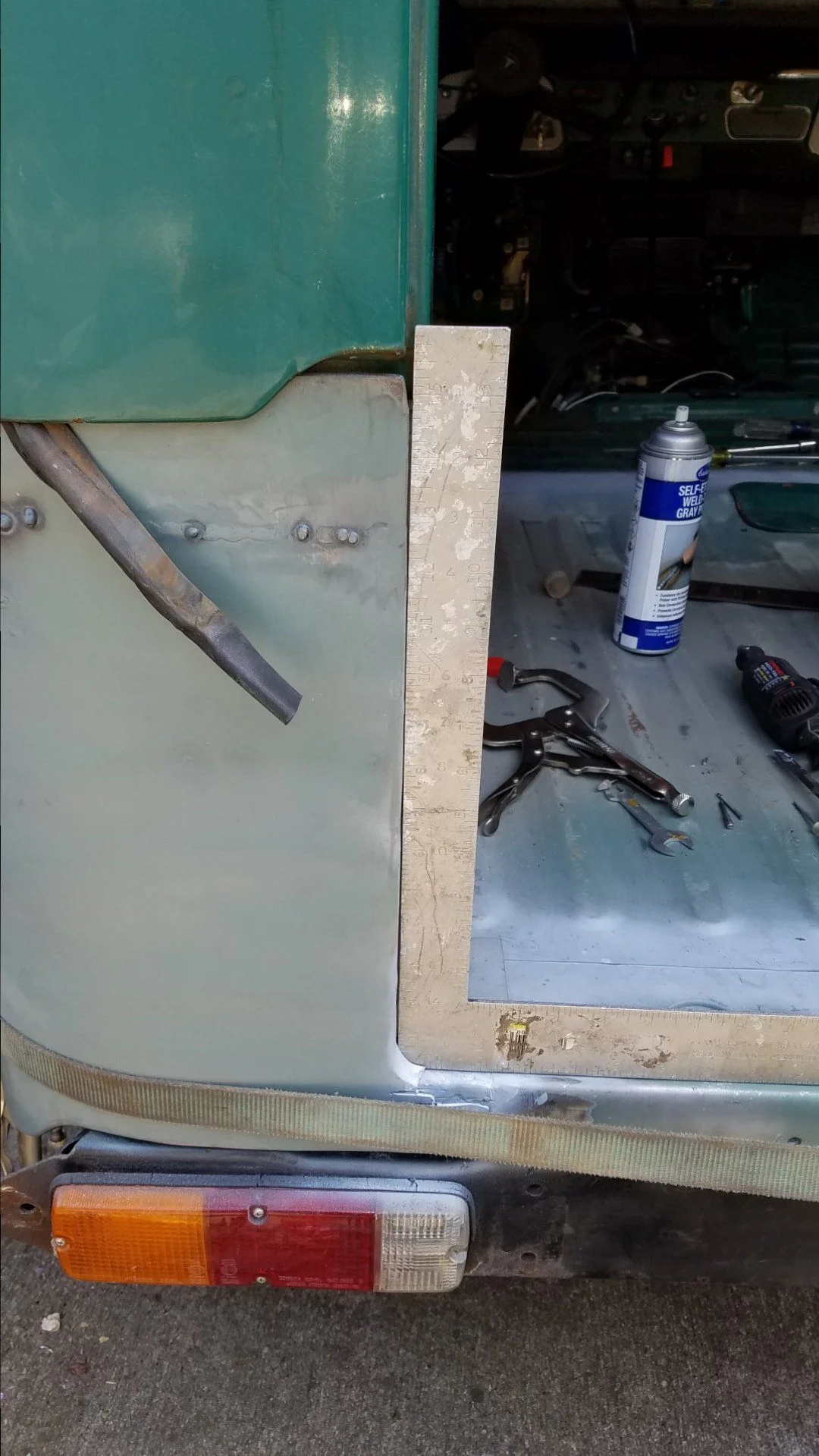

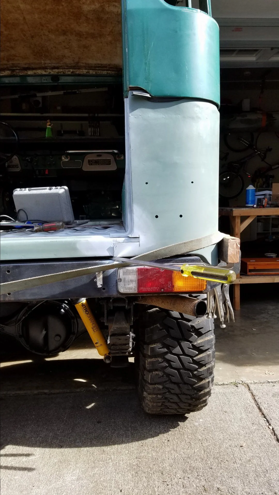

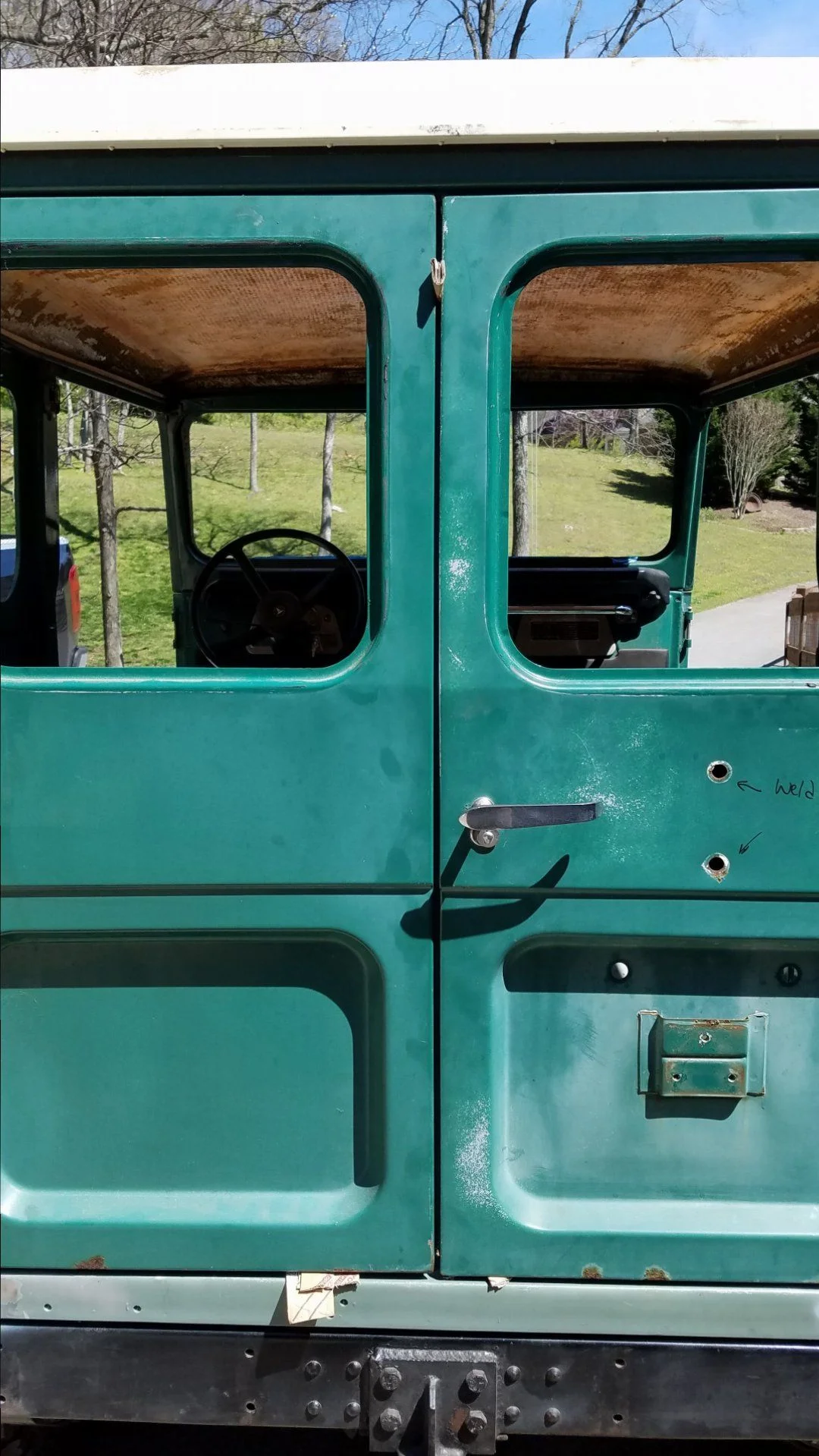

The doors should tell it all... and they did. I shot all the gaps and as you can see it is off by a quarter on each side at the bottom.
Drivers side
Passenger side
@Jdc1 thank you!!!
It took 1 1/2 days to do, but Im glad I did it!! :beer::beer::bounce::bounce::cool::cool::hillbilly::hillbilly::hillbilly::steer::steer::steer::steer::steer:
Hahaha. Im pretty happy about it. I feel real good about how everything is going to fit together!!
Tomorrow I plan on fitting doors for permanent location and tire carrier!!!

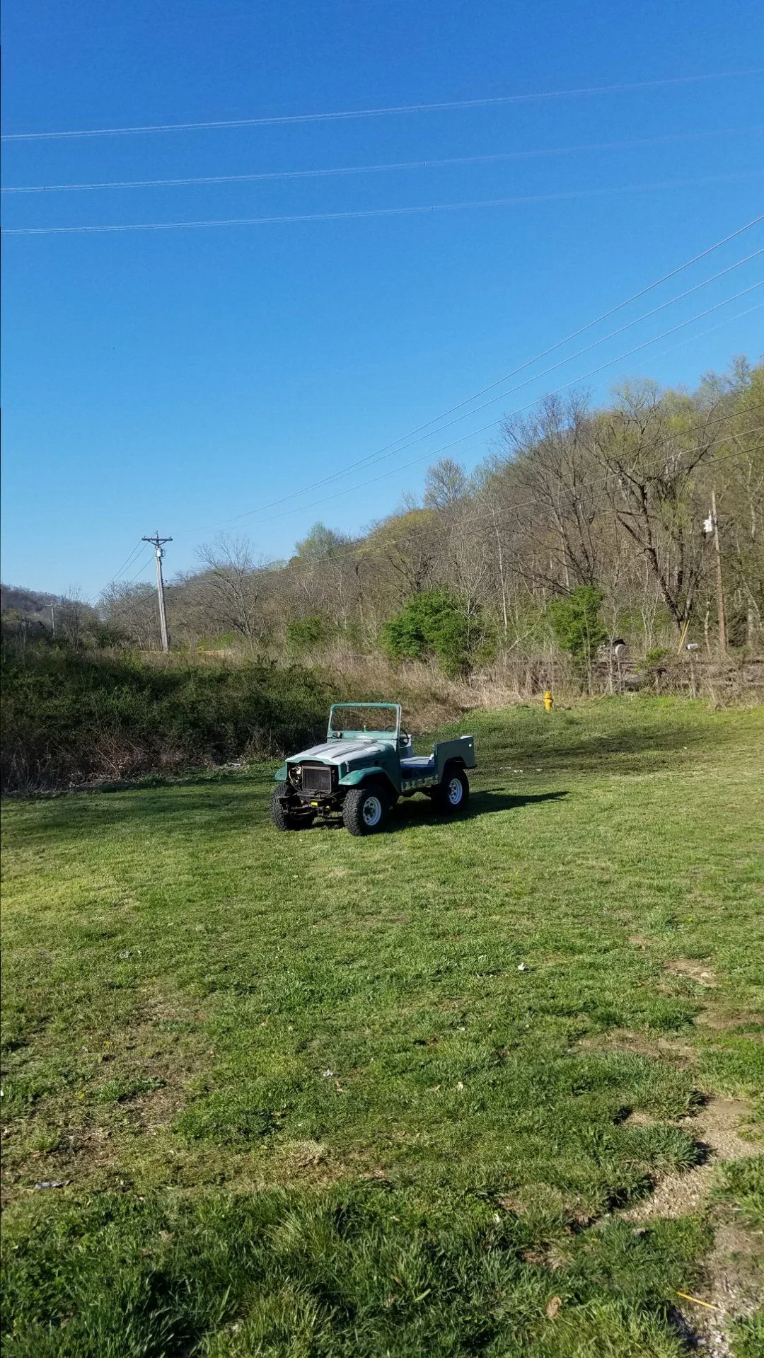

Bolted up gas tank. Put a fresh charge on the battery.
Pulled the choke all the way out..... pumped the accelerator ....... and BAM!! She fired right up!!
Not bad for a 6 month slumber.

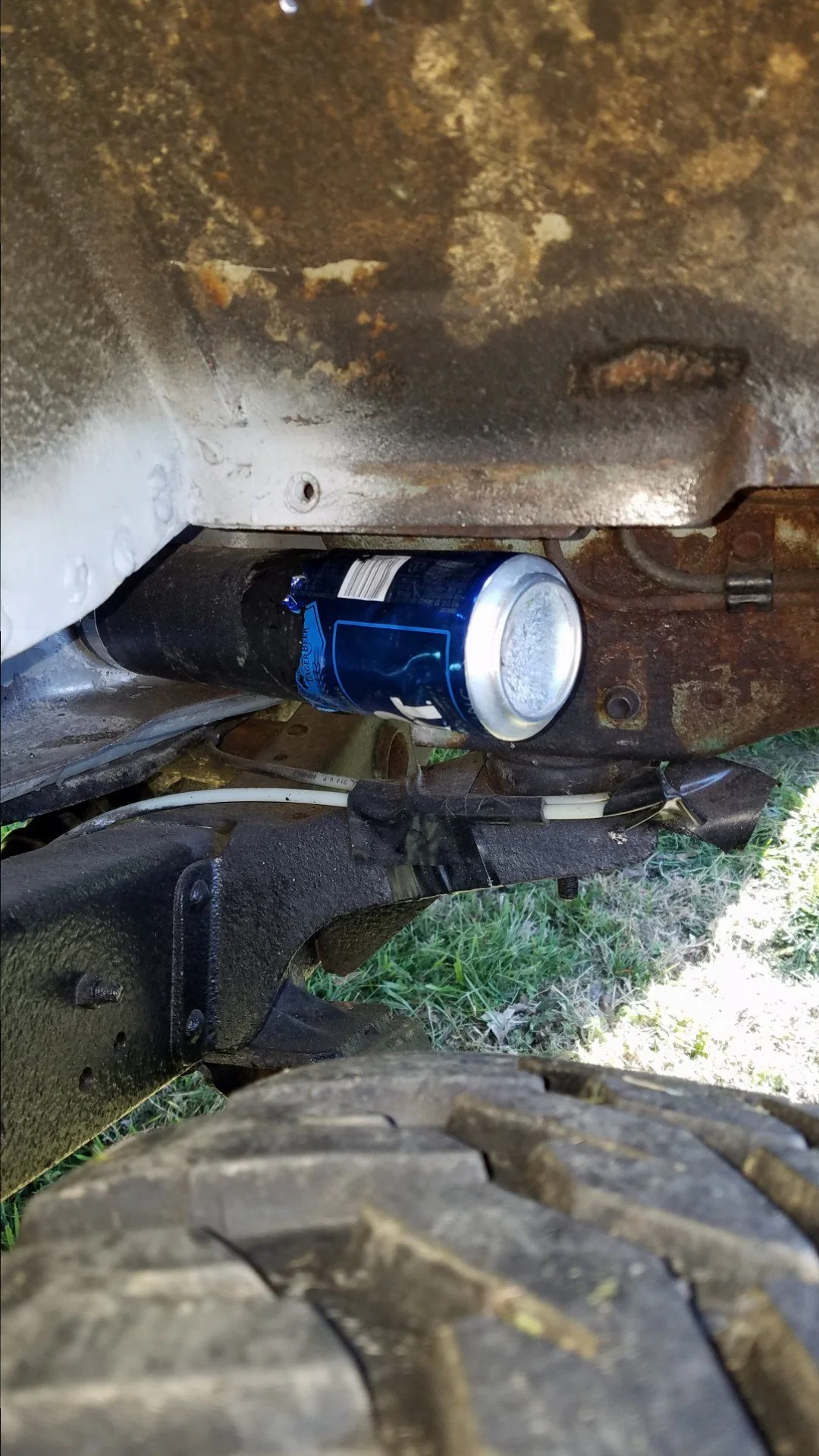

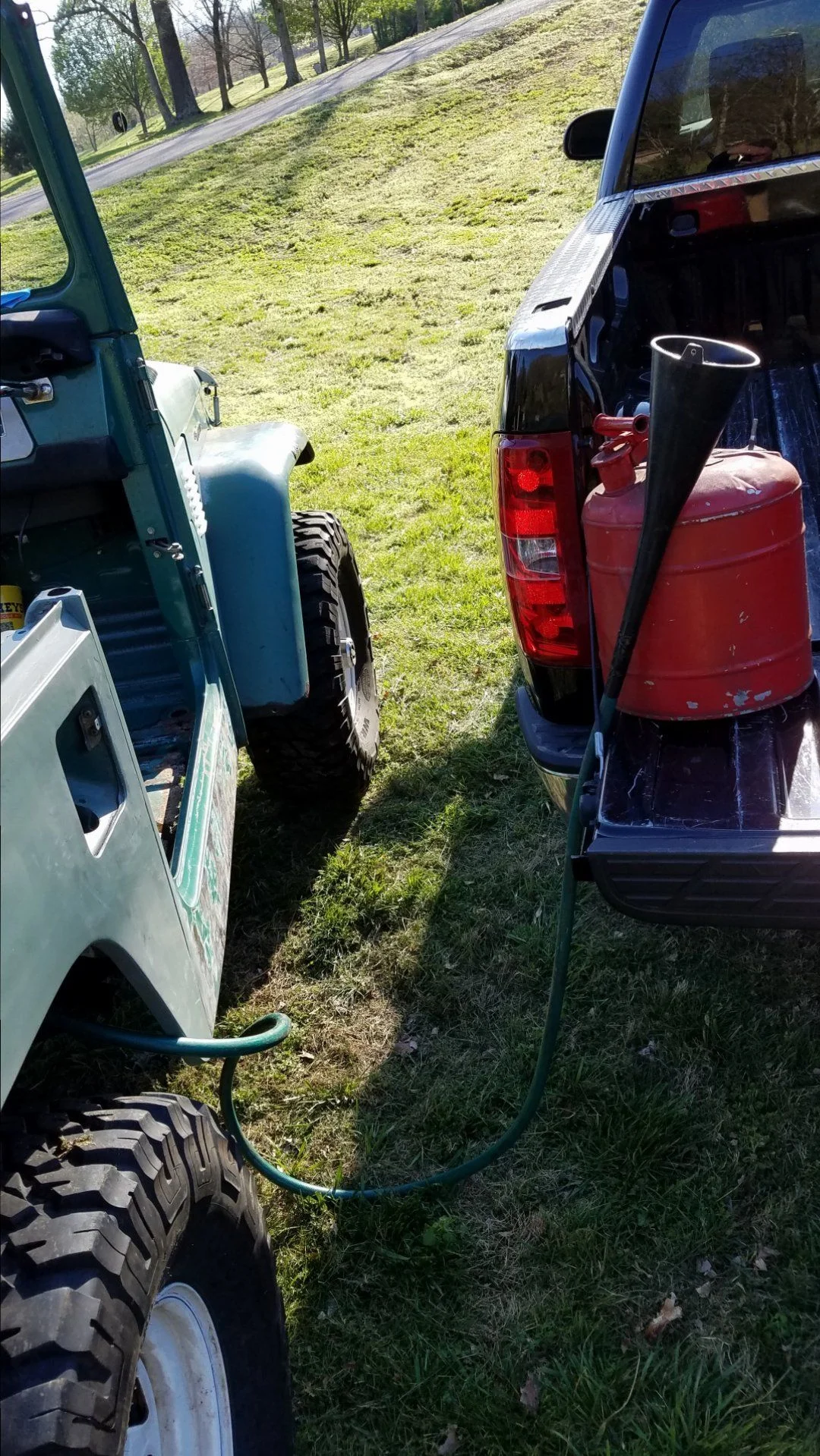

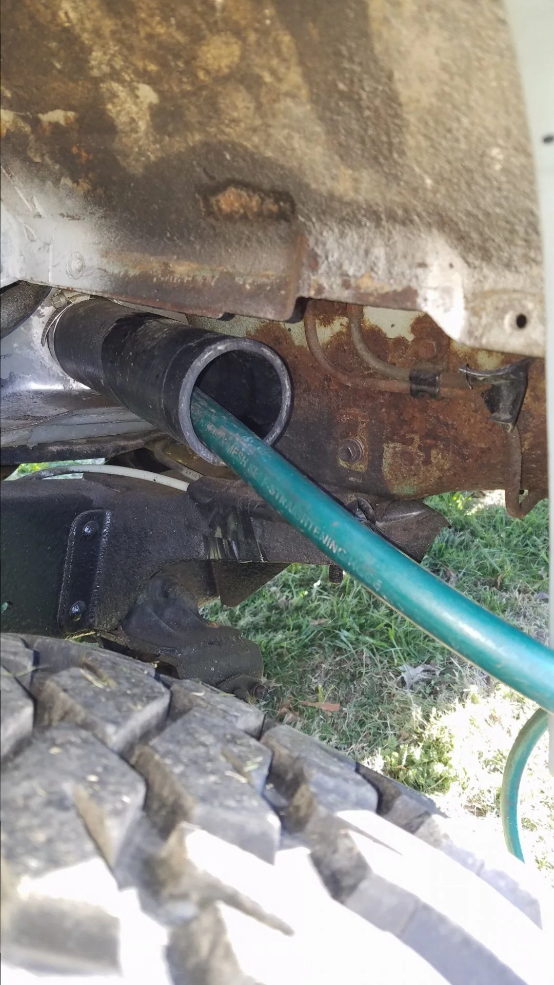

Could not help myself and took her for a romp though the neighbors field. Well a short romp. I didn't realize I was literally "out of gas".
1. remove gas cap (beer can)
2. Insert gas hose (siphon hose)
3. Pump the gas ( well pour it out of gas can into funnel)
Great documentation!!! ;)

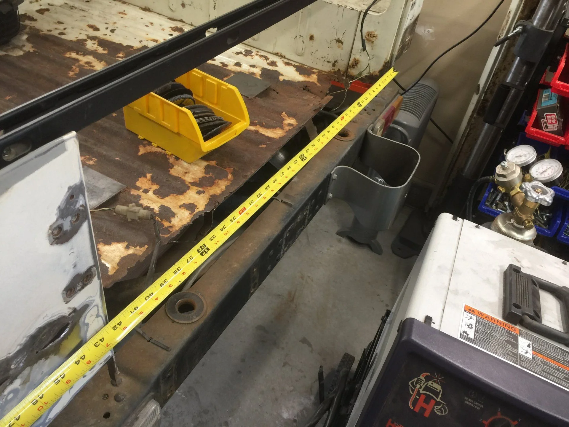

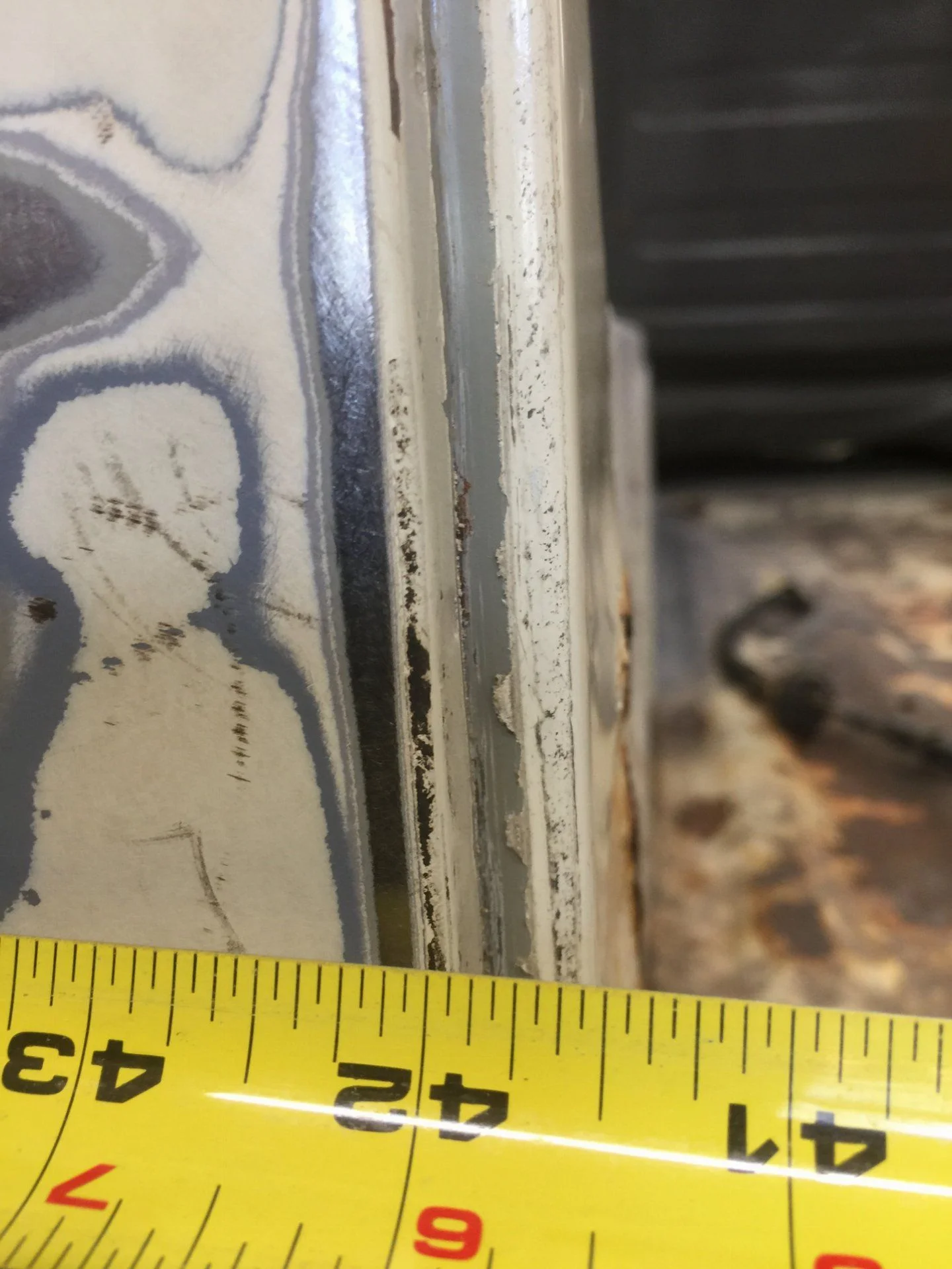

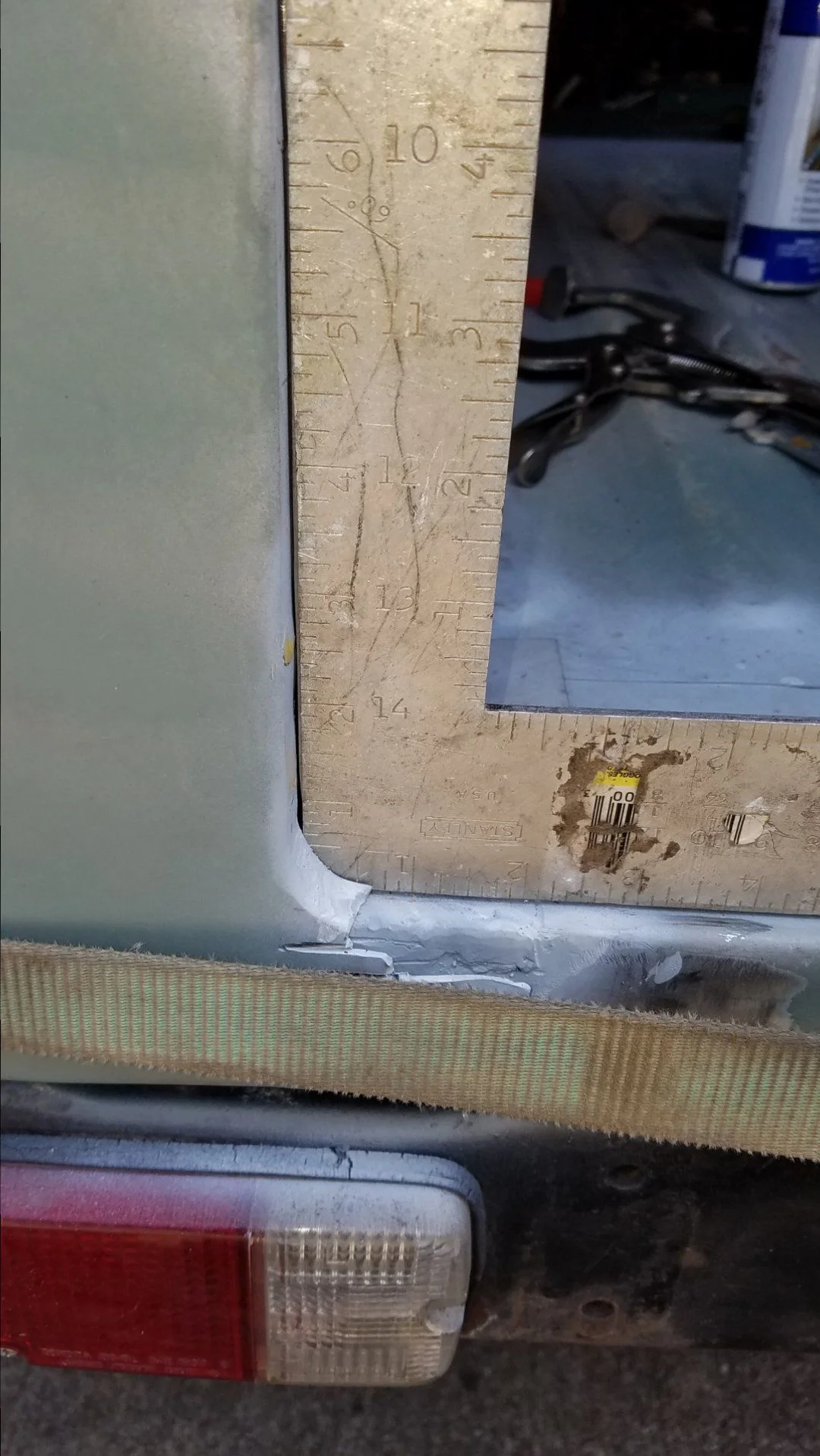

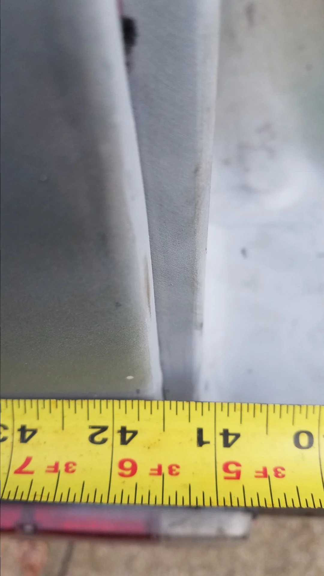

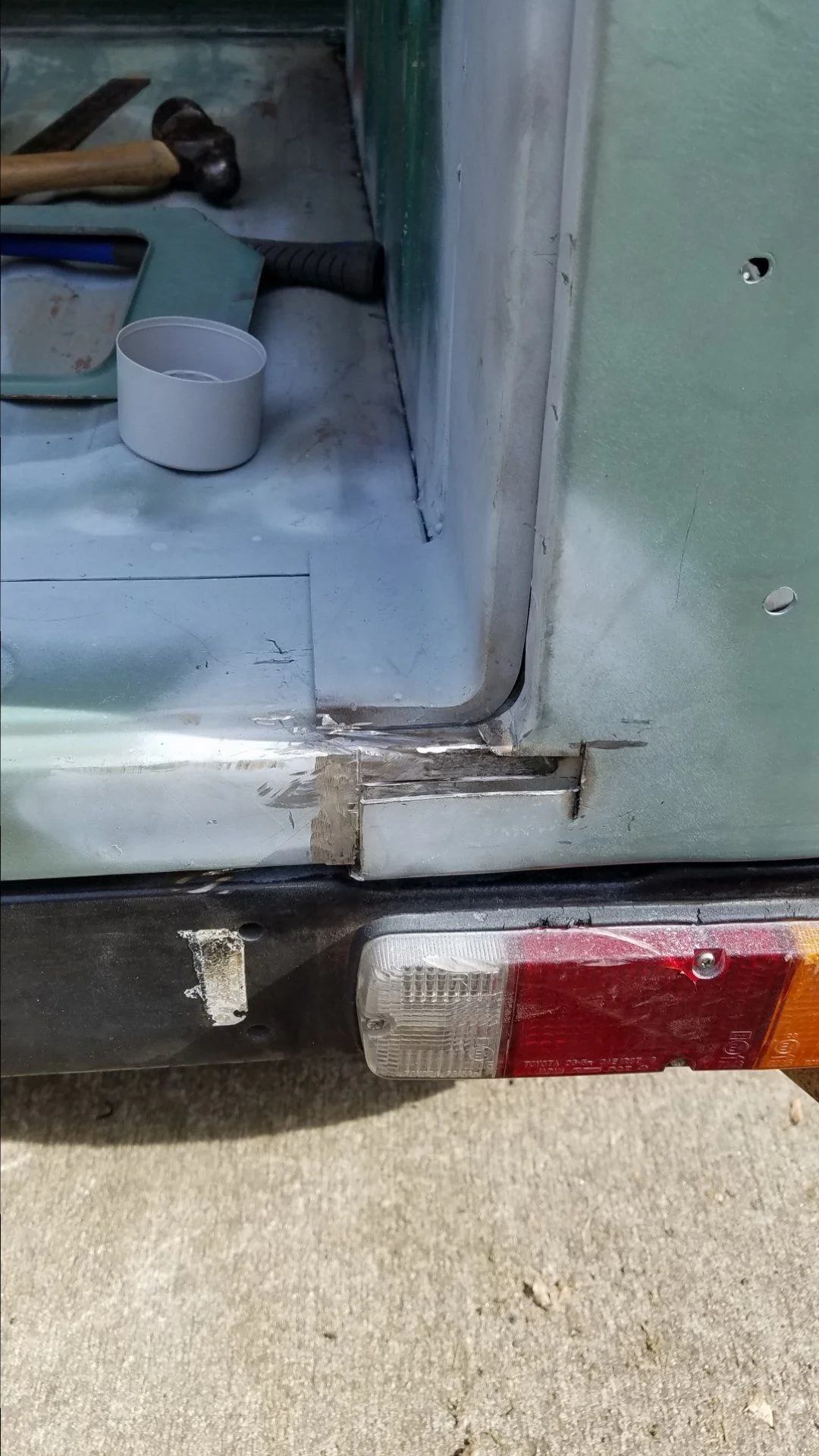

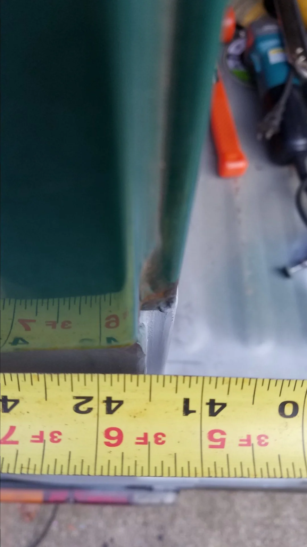

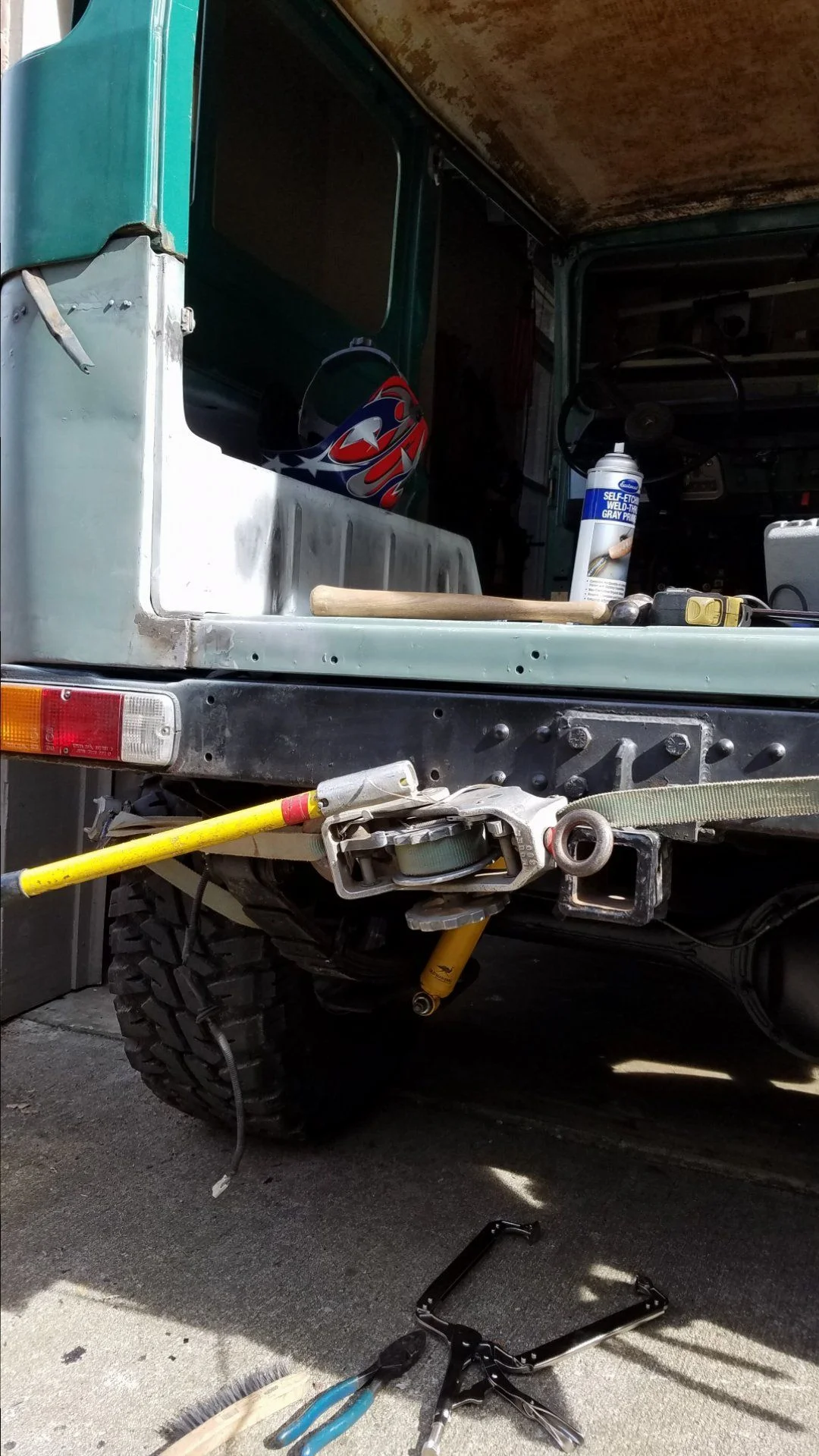

@MOTOV8R yes the only place I cut it was at the rear sill.
My floor pan measured 41" old and new.
Inside my door opening I measured 41" at the top of the top, 41" at the top of the tub and of course 41" at the floor pan.
Inside my door jam I measured 41 5/8" at the top of the top, 41 1/2" at the top of the tub and 41 1/2" at the rear sill.
I would check your top and see what that measurement is. The more reference measurements you have the better!!!:cool: 42" inside door jam is probably good. I know there is all kinds of "slop" in the rear doors on my rig.
