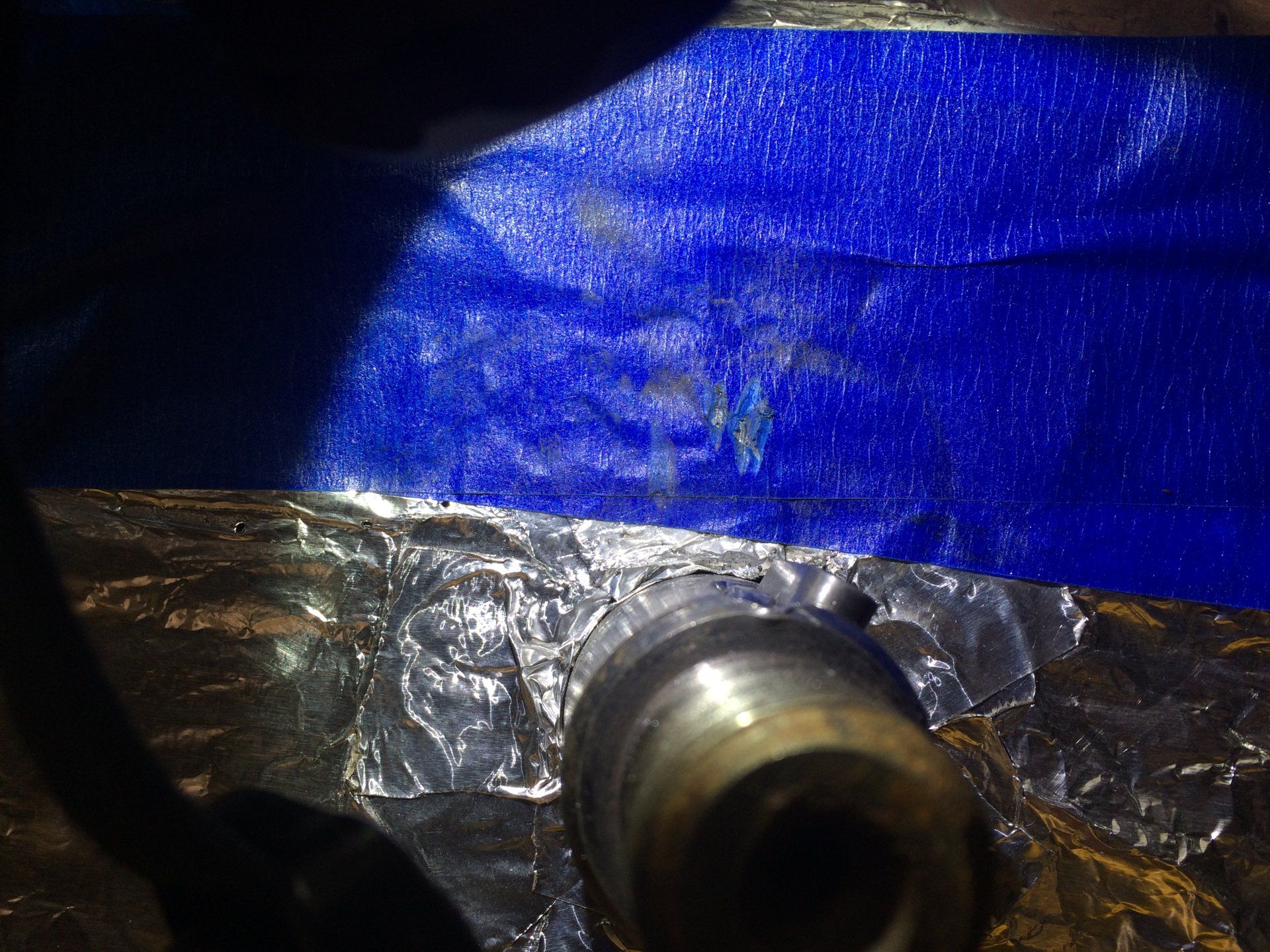

Look what I did. One semi good bead, ground it down very little and HB slides on. ;)
Welded it?!? Goodbye JB weld!
