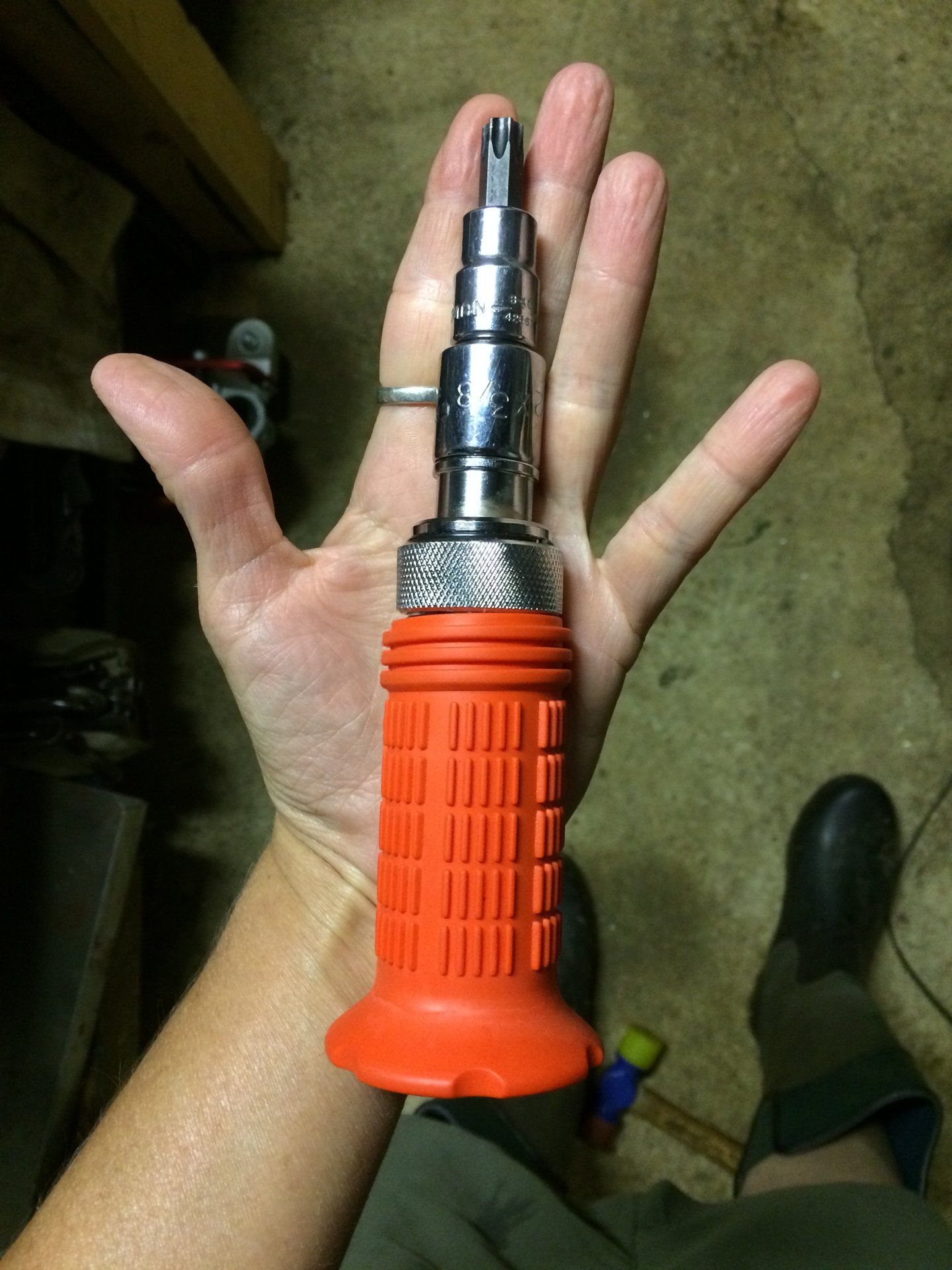

Are you familiar with an impact driver. Not an electric or pneumatic impact wrench but the one you hit with a hammer. To get those Torx out. They work like magic. Issue is getting the Torx bit to fit.
If I had a bit to fit the impact driver I'd hit the head of the screw with MAPP gas starting with a 10 second burst. There's so much thermal mass the heat won't go anywhere. Then hit it with the impact driver.
Having said that I'd be inclined to put the rod bearings in and call it good.
Oh look it's got a socket adapter thing.
Eric I tried some straight shots w/ the bit and a hammer. I do have one of those manual impact screwdrivers but the torx #50 bit came attached to a socket driver and it doesn’t fit..... ignore that. I think I do have an appropriate adapter. I’ll check it out tmrw. I had tried the battery operated Ryobi impact wrench as well and got no where.
Well there it is.... if it’s not a monsoon tmrw I’ll try it.
My impact driver must be real old, like me. I've had it for a long time and the case is metal, not plastic.
