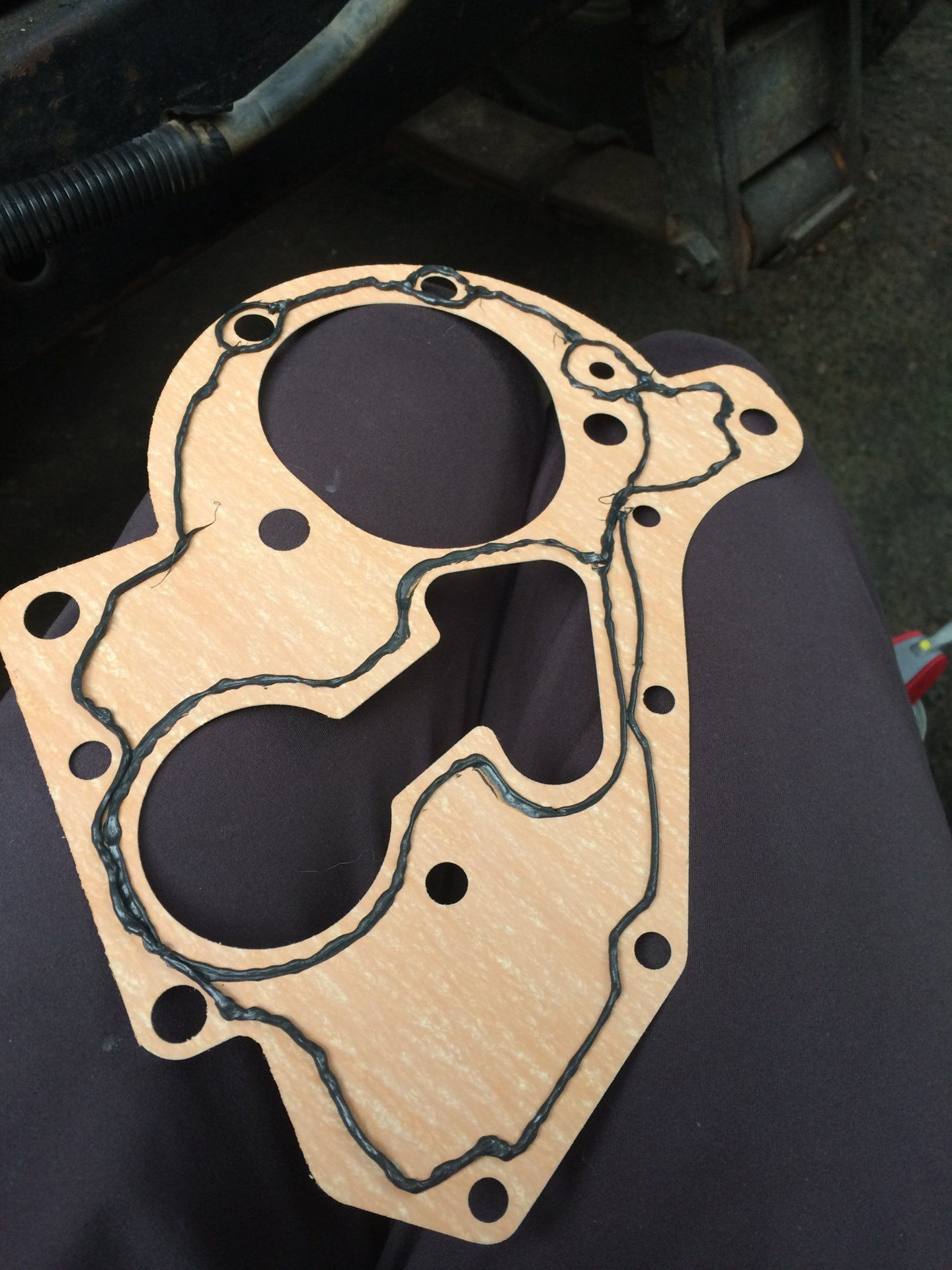

Timing plate gasket (from @cruiseroutfit) and plate added w/ sealer and finger tight for an hour. Outside of gasket comes w/ green sealer rim, slightly tacky. I added a bead of sealer along that line as well. Little bit of futzing to get it back over the crank gear but I did okay w/o much mess.

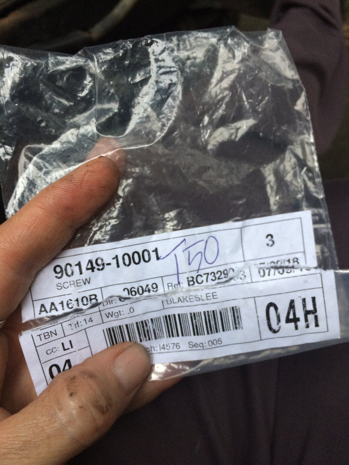

New 50 torx screws.

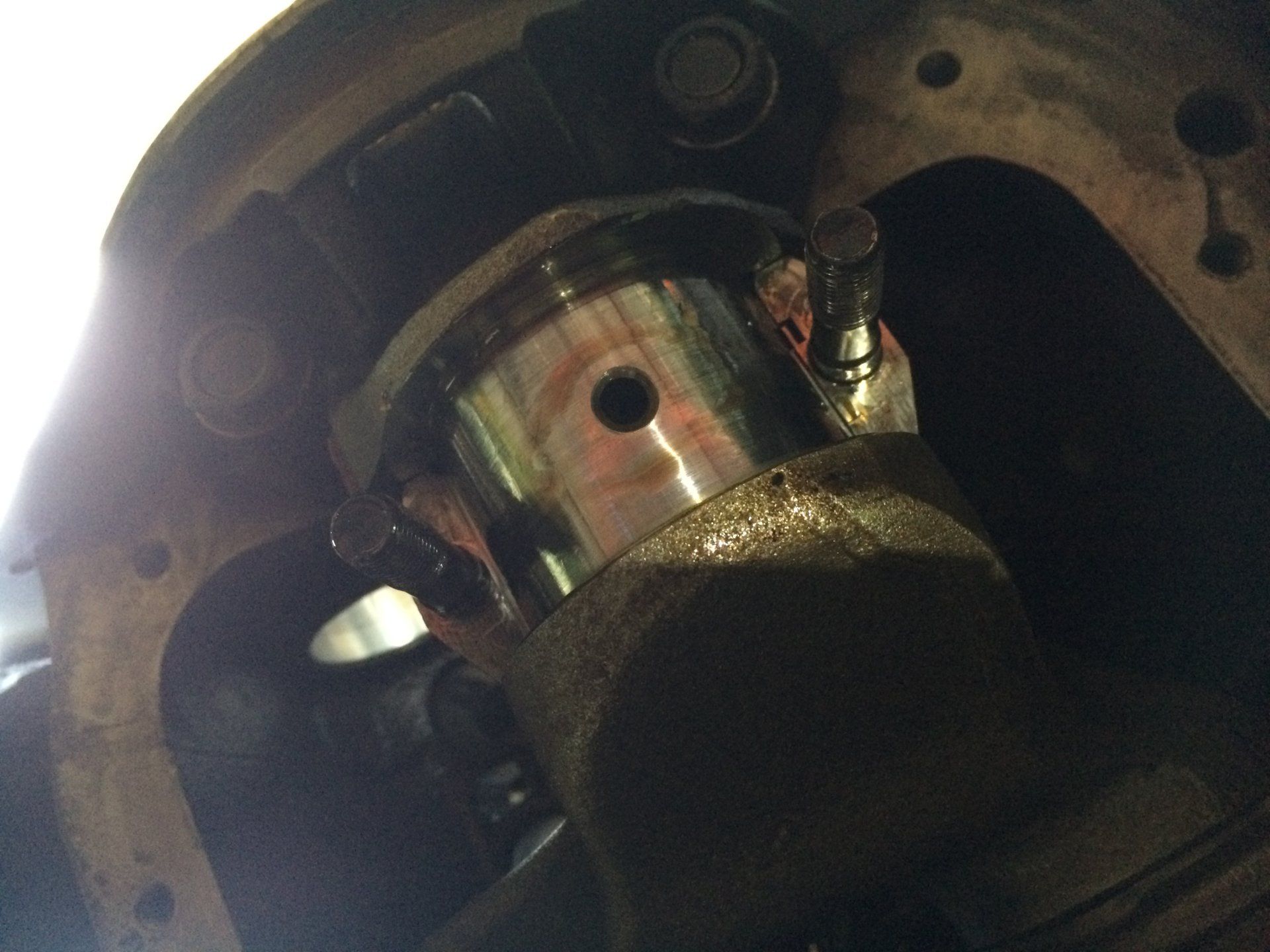

Got back under after work. Pulled all the nuts on the con rods and replaced w/ new just incase I stretched some by over torquing a few weeks back. Set all at 45ft/lbs (fsm says 35-54). When I got to 4 (from the flywheel) I gently sanded down the little bump noted on the con rod w/ 600 and oil. Took it down till it was far less felt w/ my fingernail. Number 1 con rod bearing definitely on its way out. Glad you all prompted me to do this chore. Plastigage all measured .025 if memory is correct on that decibel point.
