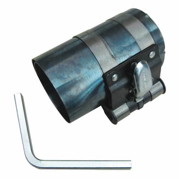

The ring compression tool needs to be held in place on the piston with one hand and the other hand has to turn the allen wrench to squeeze the rings. Another person then taps with the handle of a long rubber mallet on top of the piston to get it in the block. I don't think you could do this from the bottom of the motor as there is no way you can get your hands on the allen wrench with the compression tool in there going at it from the bottom. I have been known to be wrong so if anyone can do it, it would be you. And before any of this happens, yes cover the studs with short (3") fuel lines.

I will say that is interesting to see the tool. Now I find myself pondering. Couldn’t the tool be used opposite?
Nope. I see it only squeezes the uppermost part of the piston and ring and is then inserted, as you said, from the top. How much of the piston is held in that sleeve?
Just toss a big X through all that. Crank would have to be out, pistons probably wouldn’t fit through the 30 year old bore holes... list goes on.
