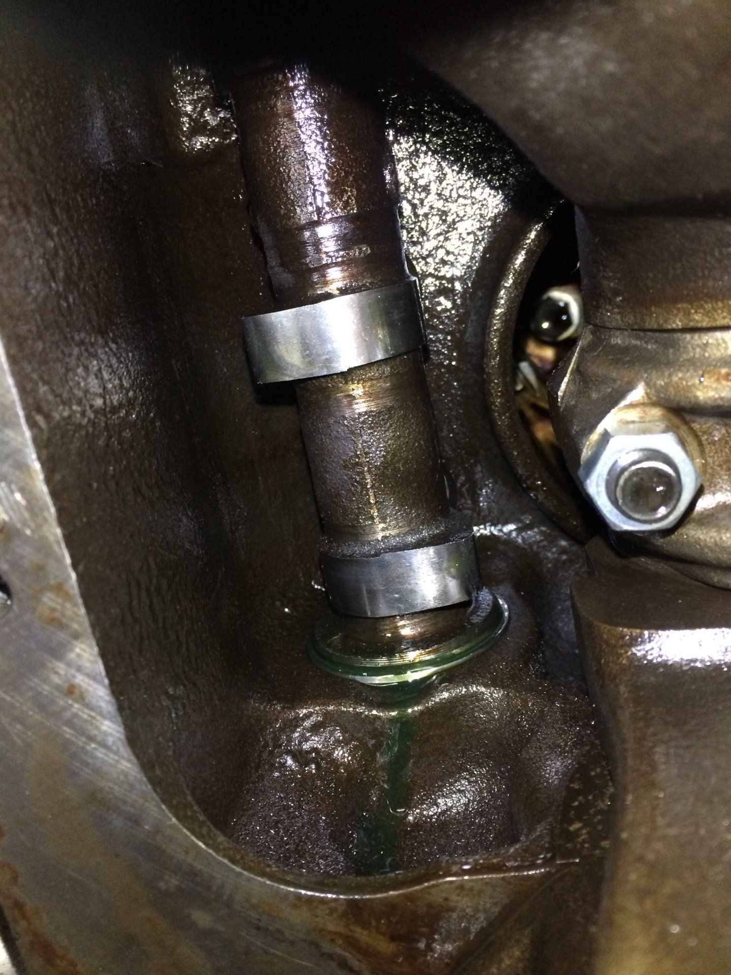

Is this appear correct for no. 6 compression? First photo.
And for no. 1? Second.
Ok and now spun the crank one full turn to TDC... dots not lined up.
Lobes at no. 6 pointing toward lifter side of block.
Lobes at no. 1 pointing toward lifter side too.
Forgive my stupidity here.
Remember it takes 2 turns of the crank to spin the cam one turn. So spin it around as many times as you want and every second crank rotation the dots should line up. The only thing to make sure that the piston it true top dead center...but only you have the crank right in front of you.
Each dot is at a fixed point within the 360 degree rotation of travel for both the crank and the cam. You can spin the crank backwards 7 times, forward 3, and adjust the cam while doing a handstand - the dots will still only line up one way :)
Ok well they’re lined up.

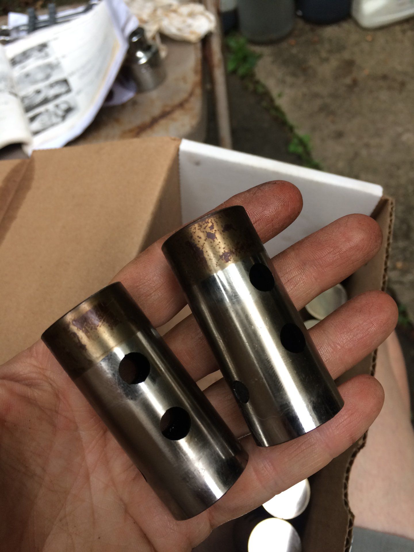

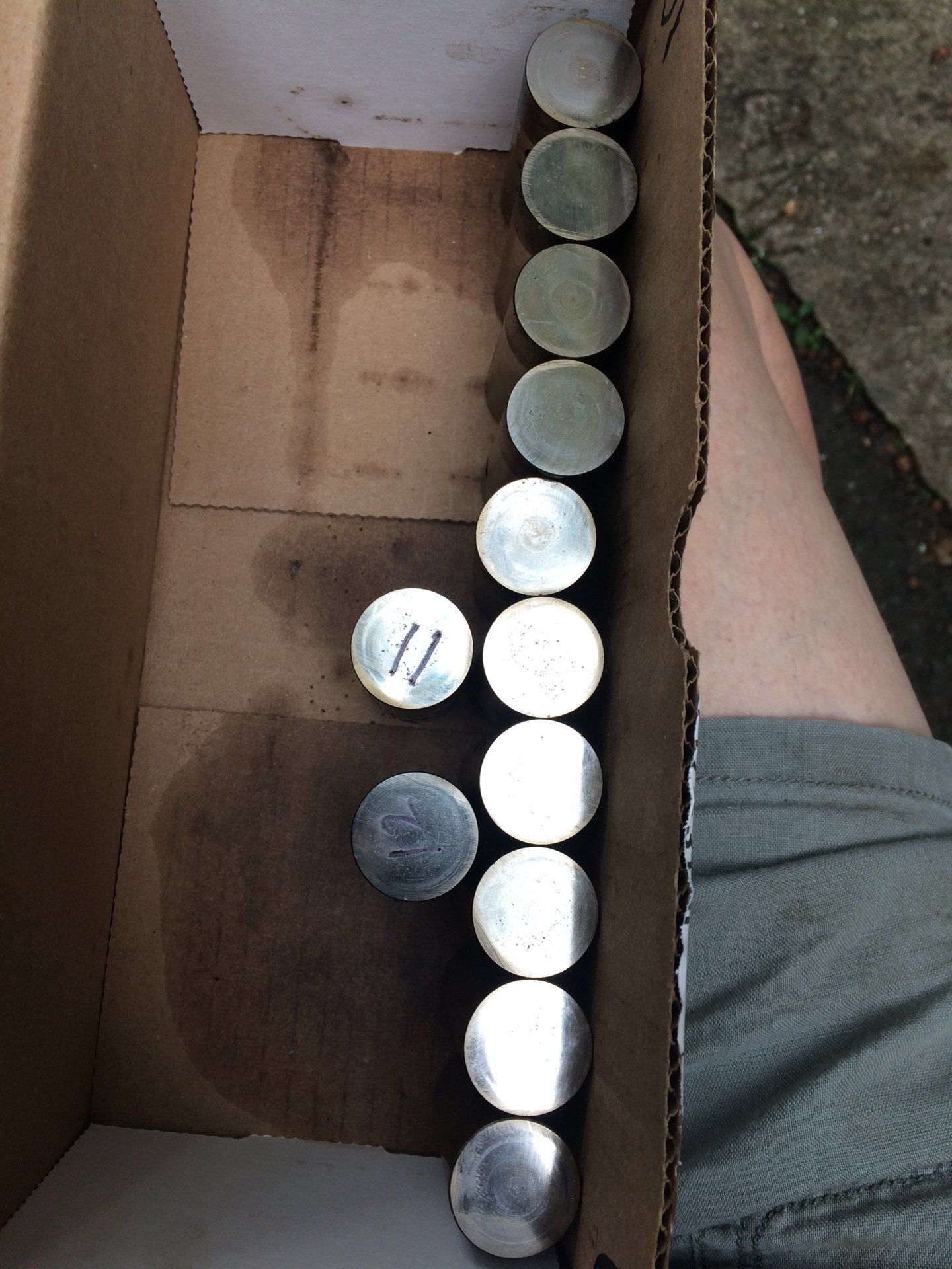

Lifters... not much in the book. Machinist had looked at them and said they looked to be in very good condition. Should I lightly clean the OD where they dip below the block? As well as dip the ends that touch the lobes in oil w/ zinc additive?
Timing cover back on. HB on. But not torqued yet. Will be borrowing a friends wrench to get to 144 (mine only goes to 100).
I would lube them lifters before instal with something! You got it!
