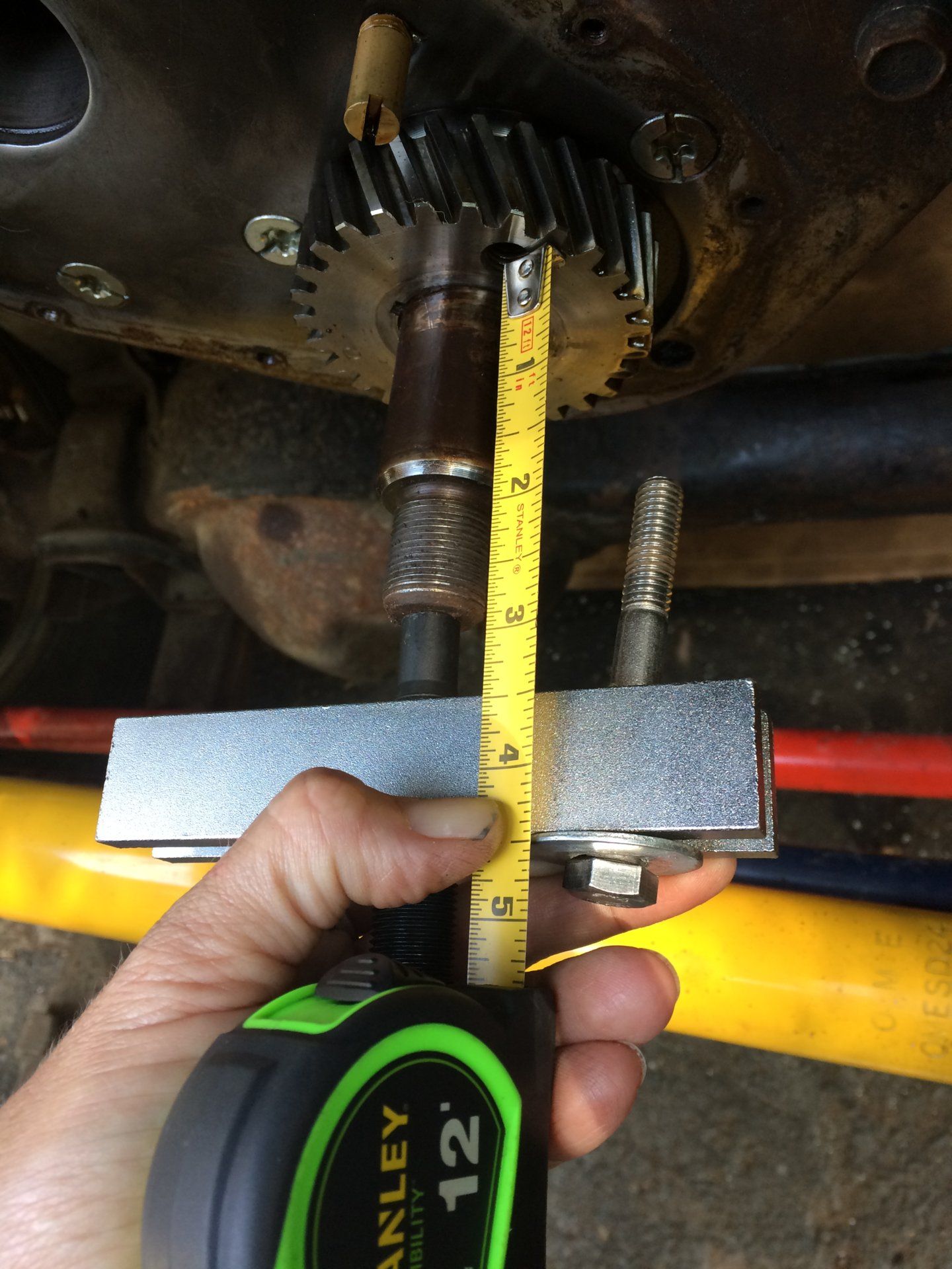

Gotta go for longer screws for my puller to take off the crank gear... I need 5-5.5” length.
Phew! Ignore most of that. No need to pull the crank gear. Hole in the plate is large enough to fit over the gear. @Godwin, glad I did a quick search and found your comments. Thank you!

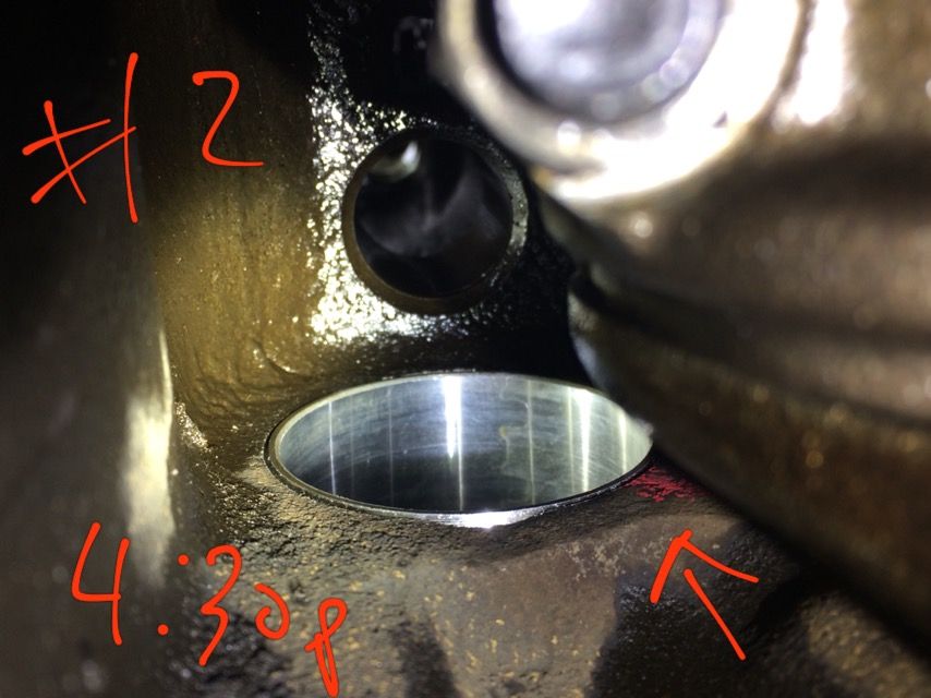

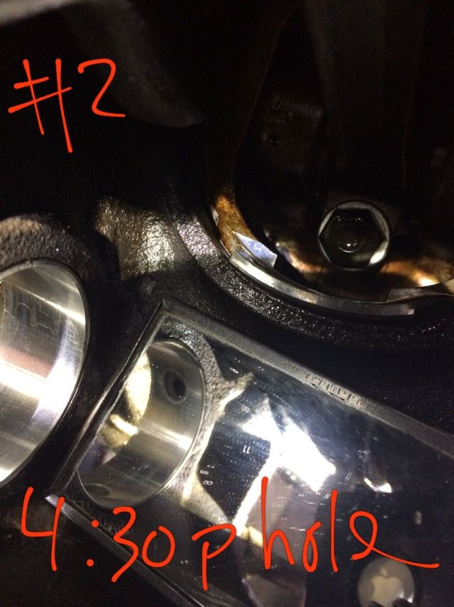

For #3 I ended up having him under and me tapping on the pipe. I had marked the oil holes (2 in the block tho there’s three in the bearing) once it was halfway we traded places and I discovered he mistakenly missed the mark at 4:30ish oil hole as he was paying more attention to the 12pm one and we had to pull the bearing back out. That’s where he was the wiser because he fashioned a slide hammer which would have worked except I had trimmed the threaded rod days ago and there wasn’t enough length to work with. But then he added a couple sockets, washers and nuts and turned the pusher into a puller.

#3 bearing has three holes of which two are oval and one is circular and isn’t ‘used.’ Oval 12pm oil transfer hole perfectly lined up. Oval 4:30pm hole that feeds to crank not as perfect as I’d like but it’s what it is.
#2 bearing has two holes of which only one is used. 4:30pm red mark showing where hole is in block. Oil hole lined up perfect.

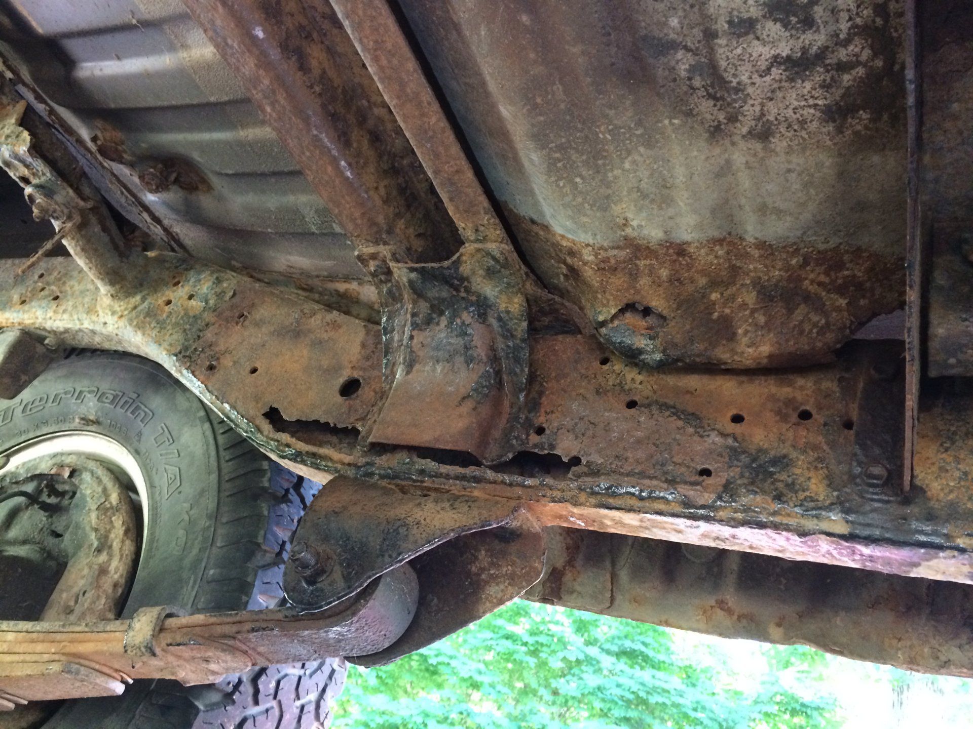

So w/ the impending lift kit coming I knew I had some cancer to face. I am now not an advocate for oil seals. That crap is a bitch to remove. It’s all over all the fuel and brake lines.
Pretty sure I know what I need to do and it’s not gonna be easy.
Clearly I have too many things at hand and a bit of ADD....
As I’m cleaning up the metal I keep hearing myself say ‘well at least it’s still metal under there.’
