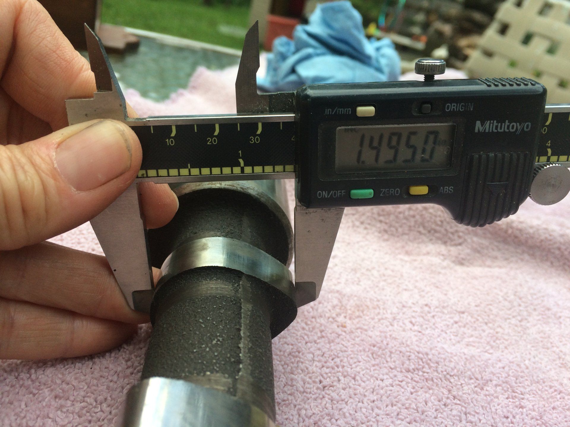

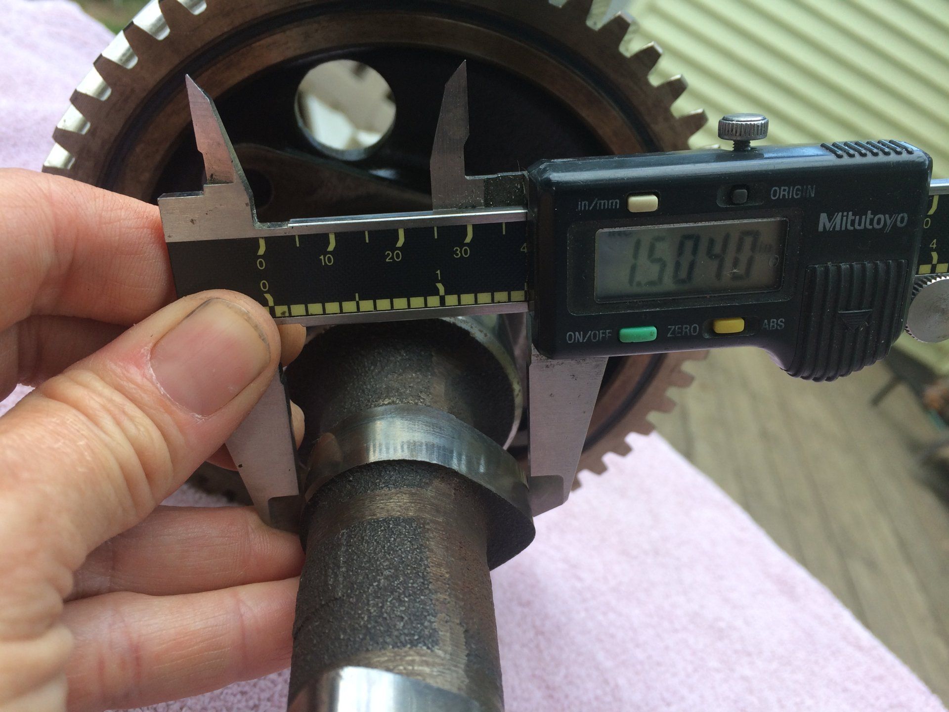

Somewhere along the way I became this girl.... measuring cam lobes on my deck table after dinner. The verdict is although mine has some scoring, the cam from the West has more wear and I won’t be using it. Lobes are far more flat and have light cracking along the edges. Reminds me of the glaze on my old guitar and a cedar chest... I know it as ‘orange peel.’ Quite sure it’s from hot and cold cycles. The wood guy can pipe in... @cps432.
Huge thanks to Drew for giving it to me. Talk about a fun new experience inspecting the two side by side.
His in first pix and mine in second.

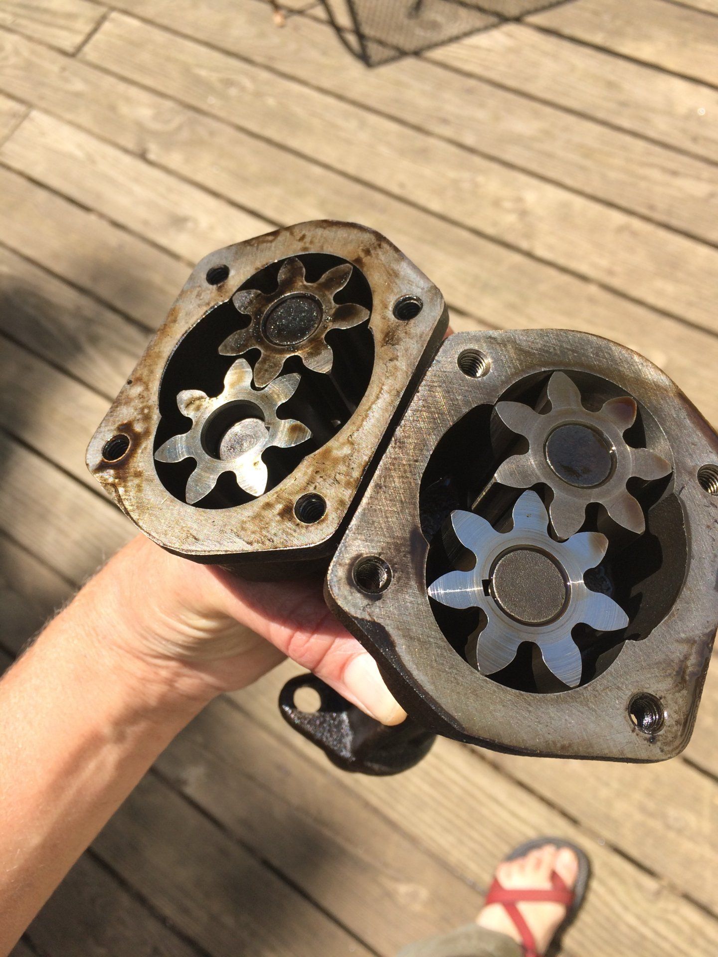

So I opened up my oil pump and the one I picked up from @4Cruisers. Interesting to see how simple they are. Initially I thought his was frozen because the oil slot wouldn’t spin but once I opened it up I found it does. Strangely the depth that the shaft seats into the gears are different, his is deeper, mine is flush. Also interesting to see that the gear on the shafts are held in place by their own small woodruff keys too.
Thankfully it dawned on me as well that the 1/2” adapter for the impact screwdriver I have fit my impact wrench. Of course I had to cold chisel one screw out first like an ass.
It’s pretty cool how simple pumps are, yet so damn important. Elegance at its finest (says the nerdy gearhead).
Strange that there are differences. I verified before sending and again this morning. Mine came off my '89 FJ62's 3FE (I'm the 2nd owner and the receipts from the PO show no oil pump replacement). The same part number (15100-61011) fits all FJ60s from at least 11/84.
At work now but will check the fsm. Pretty sure the shaft should be flush w/ the gear like mine.
