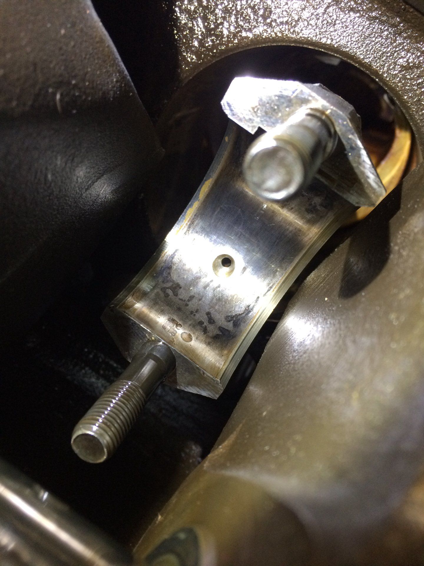

Bearing roll out then in.... but I wasn’t expecting the rod to push up away from the crank. Laying under the truck trying to visualize the placement of the upper bearing. Just carefully push it up and in?
I’ve kept my grubby hands off the journal and understand not to touch the backside of the bearings and inner curve of caps.
Someone pipe in please.
Muduploading is being a pita. Bearings in #6. Pressed up and in then tapped the edges of the upper flush w/ rod cap/bottom w/ wooden dowel. Gently added oil only to inner curves of new bearing. Gonna wait for critique before going further. Haven’t torqued nuts yet either.
Also... good call to replace the rod bearings, upper one on 6 was just beginning to break down at the oil hole.
Cover the ends of the rod studs with rubber vac line or something to keep from scratching the journal.
My bearings looked like that too. I just used my fingers on the edges to push it around I think, but the wooden dowel is probably better, and cleaner.
I was pretty sure my pistons had moved up and away also, I think that was what I had posted earlier. Your method of placing them into the connecting rod and then bringing the rod down is sensible. I think that helps keep the threads away from the journals too, but it’s been a long time since I’ve done it so I can’t quite remember. Seems like the only other way would be to bring the rod closer to the journal and then rotate the bearing into it but I don’t see any advantage to that. Maybe 6 of one....half dozen...
Tabs in the right orientation? Tighten it down and keep going.
I was very aware of any possible rubbing so I held them away as I turned the flywheel.

I figured you were. It’s not hard to keep them clear if your careful and not an impatient clutz like me. I think pulling down the piston is when I’ve caught it.

But yes, tabs correct. :)
