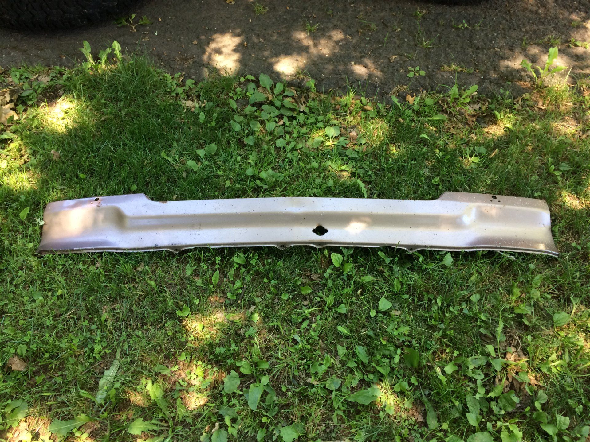

This came to me because I figured since it’s off, I’m going to have the front valance painted.... Red.

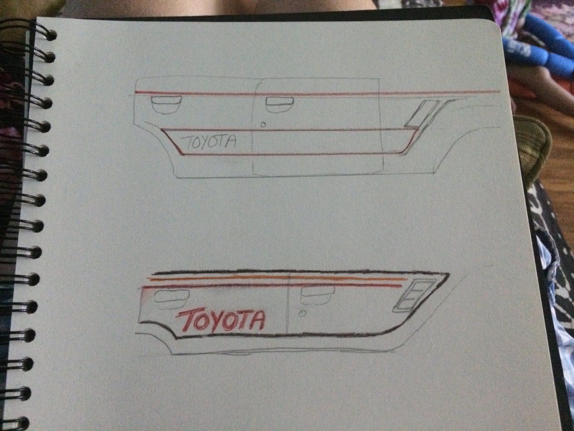

Going to blend it in w/ some pinstripes and a large TOYOTA across the bottom of the rear doors.

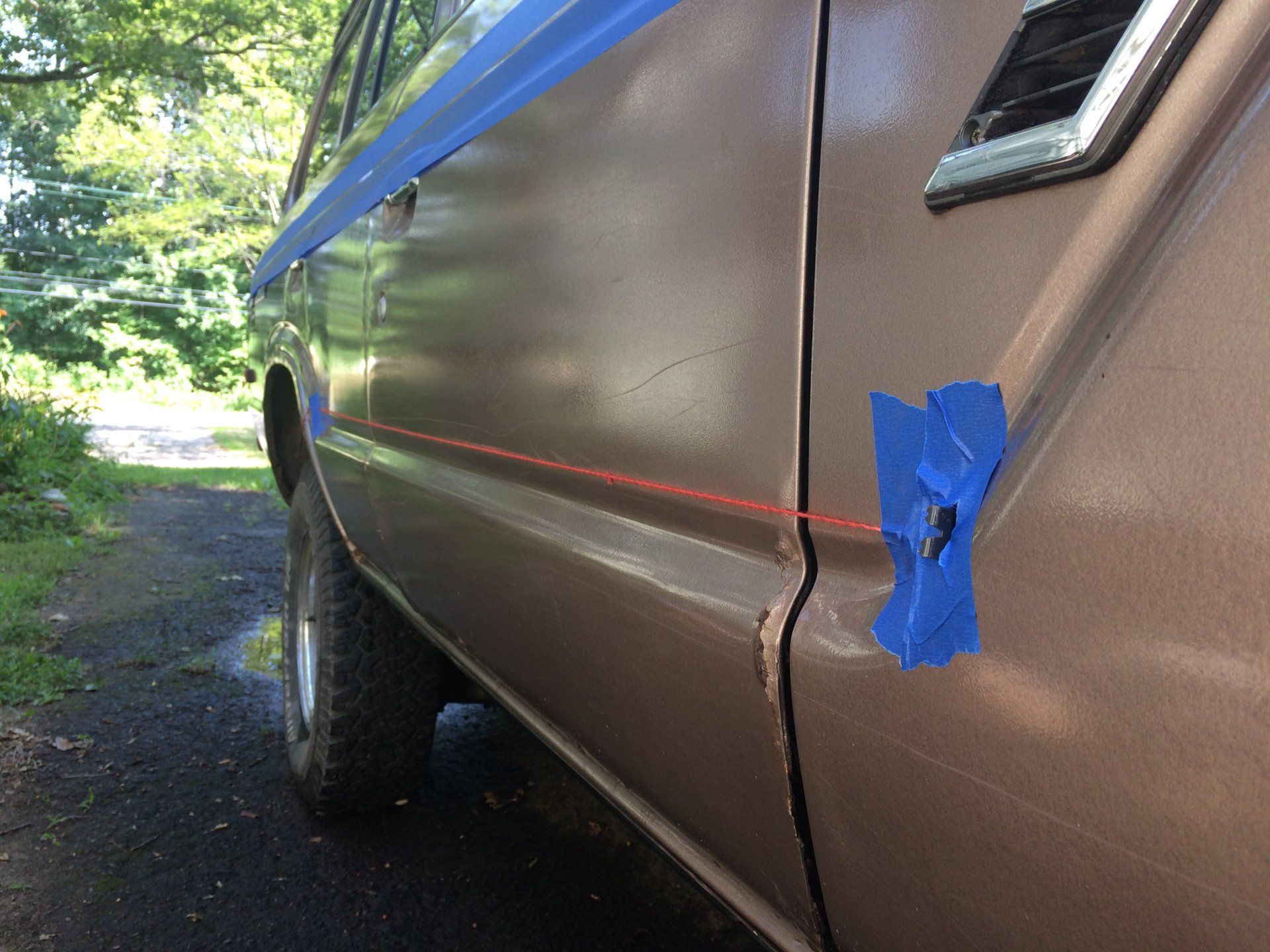

Masked out a few lines just to get an idea while kiddo napped. Couldn’t find a roll of string so used a chalk string line taped taunt.
That pinstripe will look awesome! I like it either way, high or low.

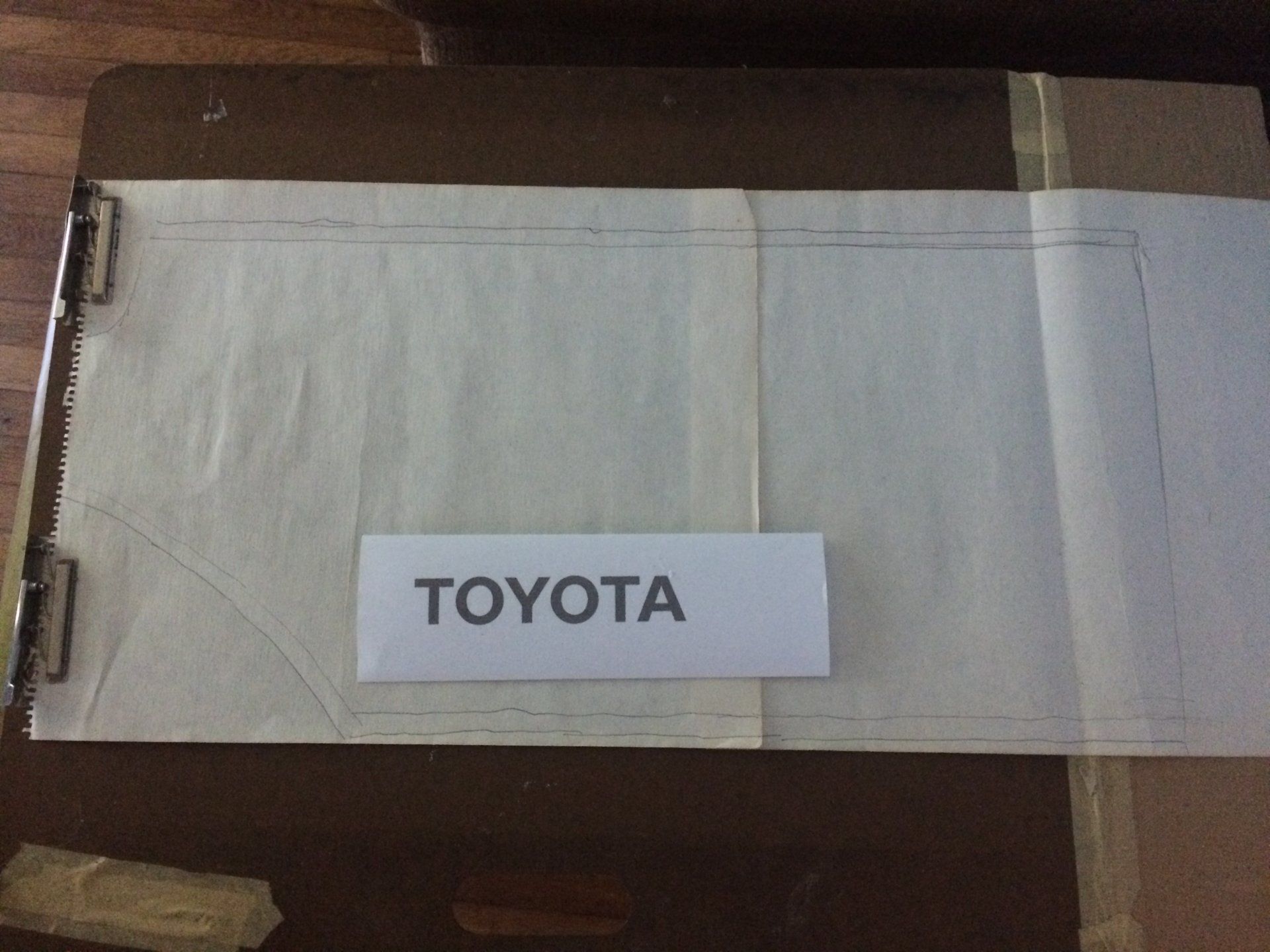

Planning on boxing in w/ red.... possibly laying an orange then a dark brown along the top... and TOYOTA much bigger but my printer is being wenchy so I’ll have to enlarge elsewhere. Plus I need to pick up plastic stenciling sheets.
Absolutely love the color and stencil! Have you mocked up putting the "Toyota" at the bottom front corner instead of rear? Might look nice, kind of forward-looking.
