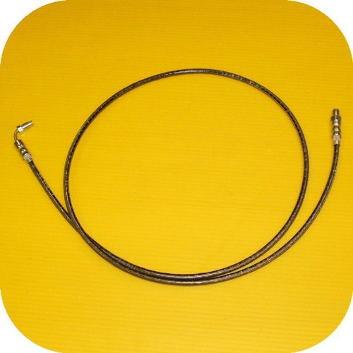

Sorry can't get any pic's, still 18'' of snow/ice on hood. I don't know the length of the braded stainless steel hose, but I have like 12" diameter loop in the hose, zip tied to the fender. My plan is cut down the hose once I can get the correct fittings to do. The fixed hose/fitting into the slave needed to be screwed in first, then the slave mounted; hose routed and finally the hose connected to the master. Or just buy the shorter hose.
Yes the ebay guy had the master with a correct length hose but it was $50 more, so I opted for the longer one and it works fine so far.

Could a person use a tubing bender and flaring kit to make a new line?
That's how I did my 55 and it works great and looks right.
Flexible line is not correct, steel line attached to the firewall, with a rubber section to the cylinder where it flexes is correct.
Anyone who can bend up brake lines can make this part. Easy peasy.
The Flexible line is a crappy solution marketed towards the "my credit card can fix anything" crowd, it ships easy, but will cause more problems than it solves, and looks like crap compared to a well routed hard steel line.
My OEM hose which I still have was a flexible rubber one. I think the fitting is a different size going into the master, which is why the new master came with a hose. I think it I got a new slave with the kit. The last time I did a braided stainless hose was oil lines for Bell Jet Ranger back in 80's. Wrap with tape, cut with hacksaw threw the tape. Remove tape and place the capture nut, work the fitting into the hose, run up the capture nut. So I think special fitting are required for braided stainless steel hoses, more than just a couple of hose clamps... On and by the way the old Jet Ranger's oil lines are on my LC to replace the Man-a-fre burst proof oil lines.

If not going for a concours restoration then the stainless hose which is easily cut and mounted is functional, good looking and causes no issues.
That being said, I wouldn't want a hose that is unnecessarily long.
Steel hard lines are great as long as you have the tools and knowledge to fabricate them properly.
Stainless braided hose is every bit as functional and durable and can be fabricated with re-useable fittings and basic hand tools.
