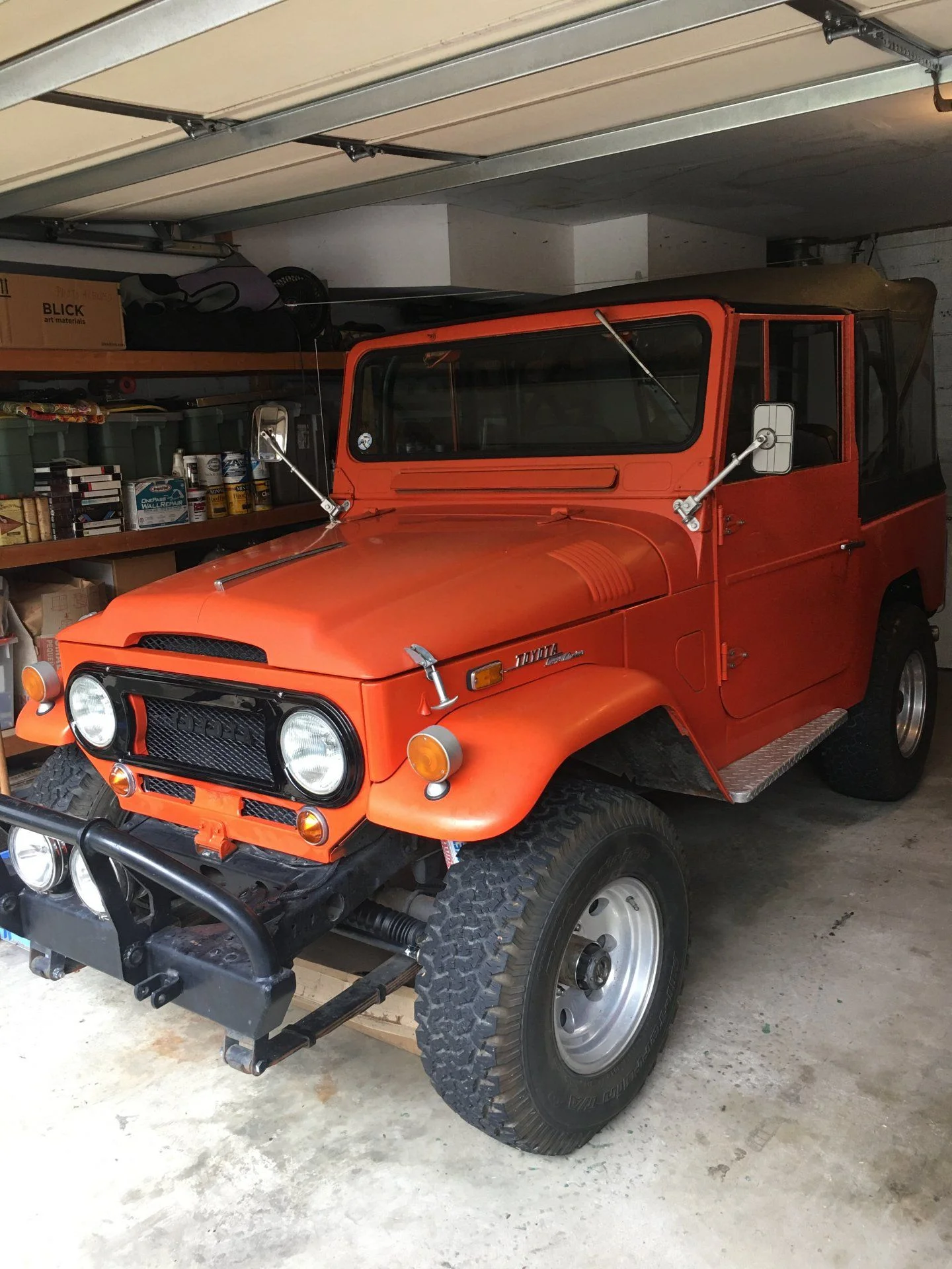

Back in Feb. I got a '63 FJ40 that looked OK from about 6 feet away and was drivable although down on power.
I got to working on it starting with all four wheel bearings and all eight brake cylinders.
The rear diff was sloppy so I found a nicely rebuilt one at SOR which happens to be about 6 minutes from home.
Saves shipping! So far so good...

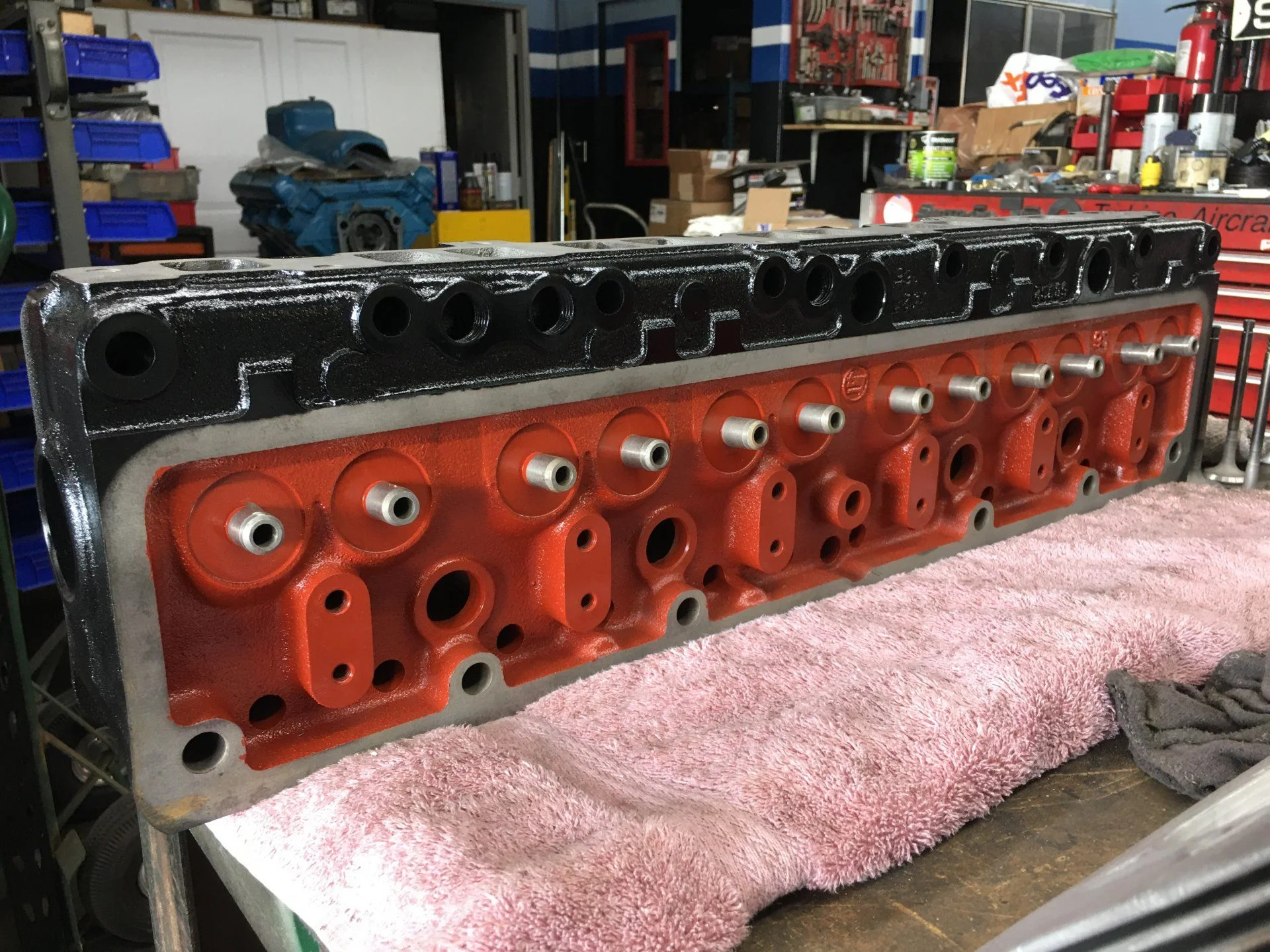

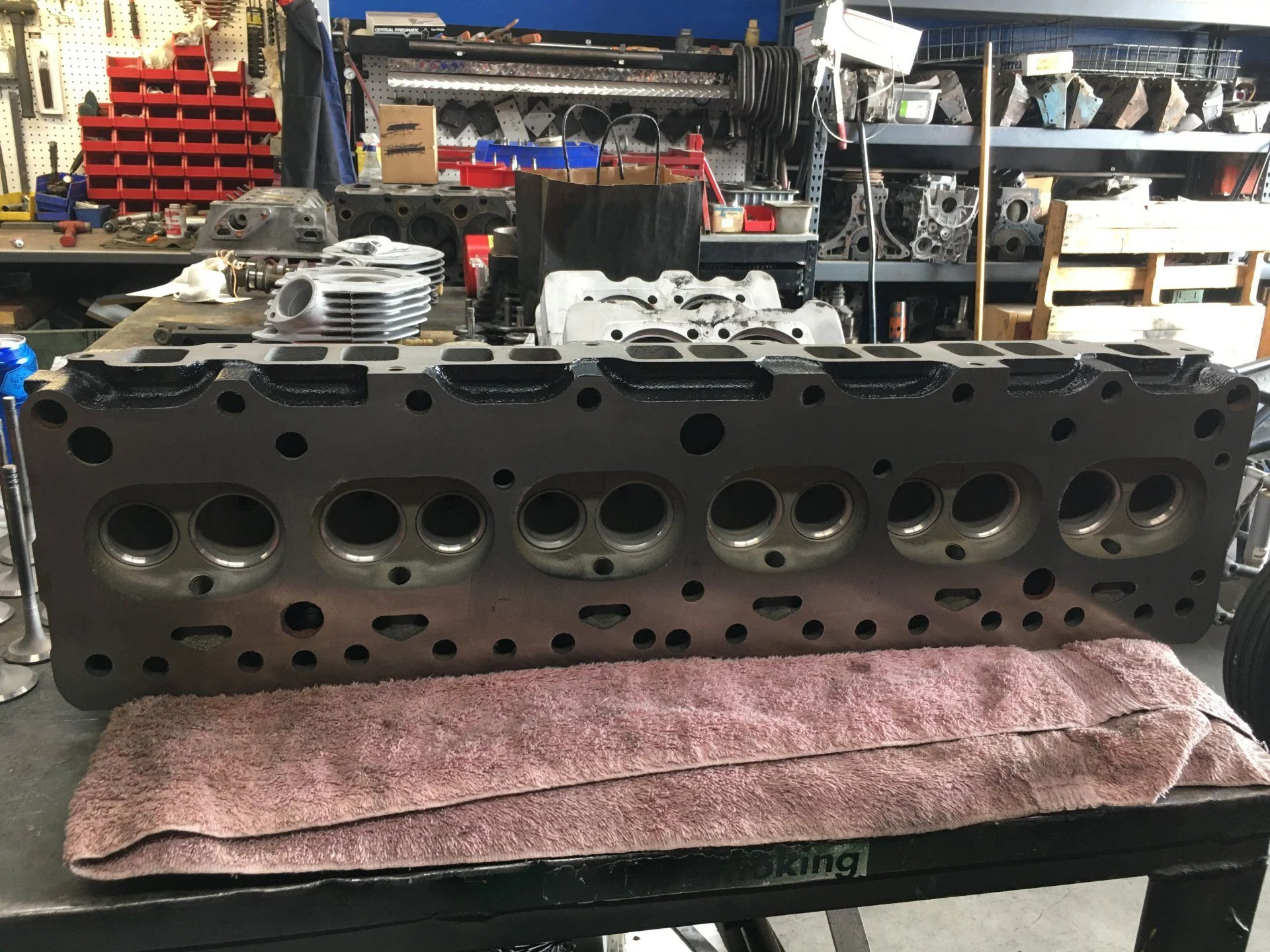

Luckily, I found a decent head on ebay.

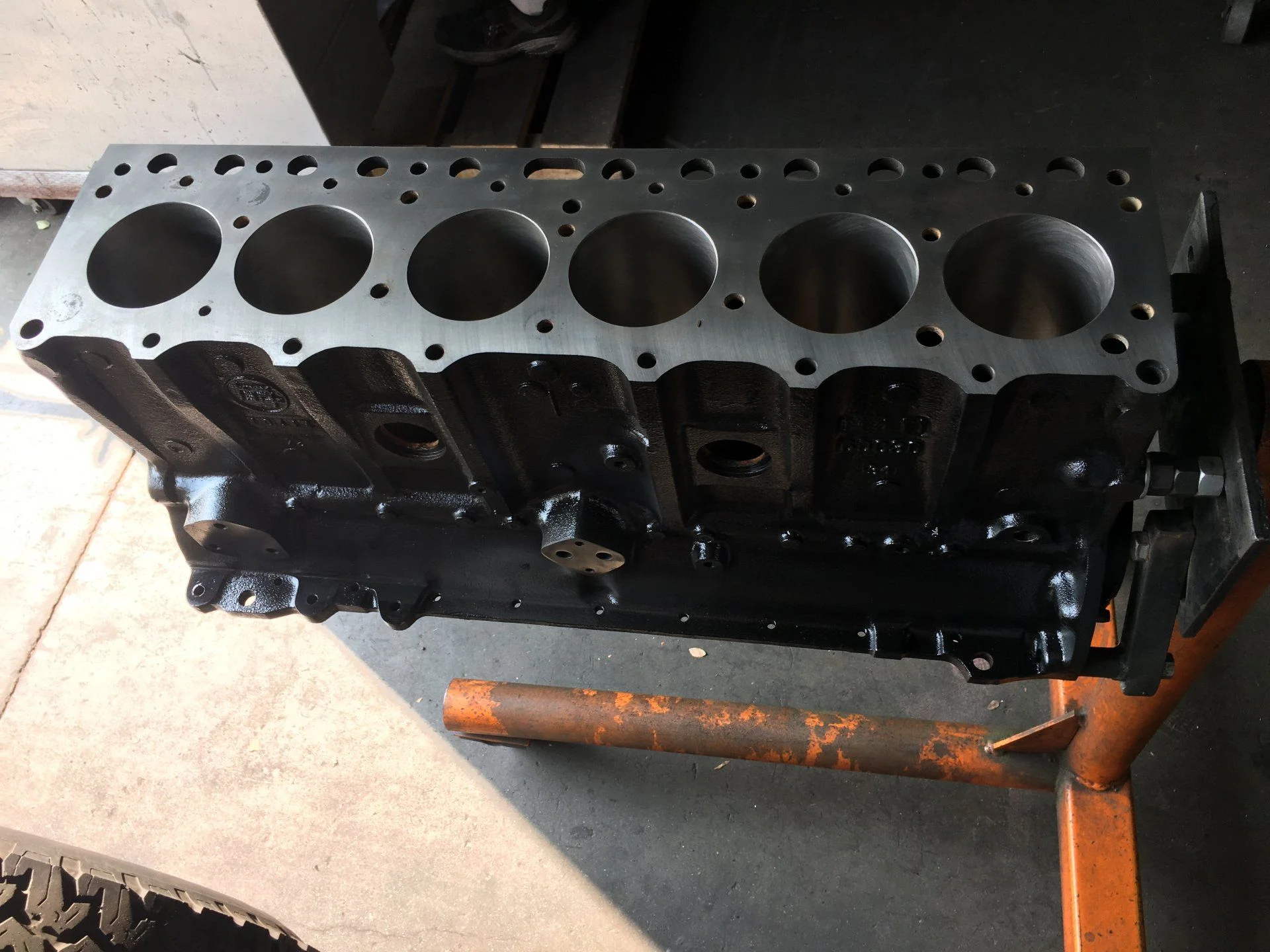

After a few trials and tribulations the replacement head is better than new and the block is bored and honed.

Any ideas?View attachment 2444313
Great looking truck. I also have a 64 but with SOA. Love the early models!!!

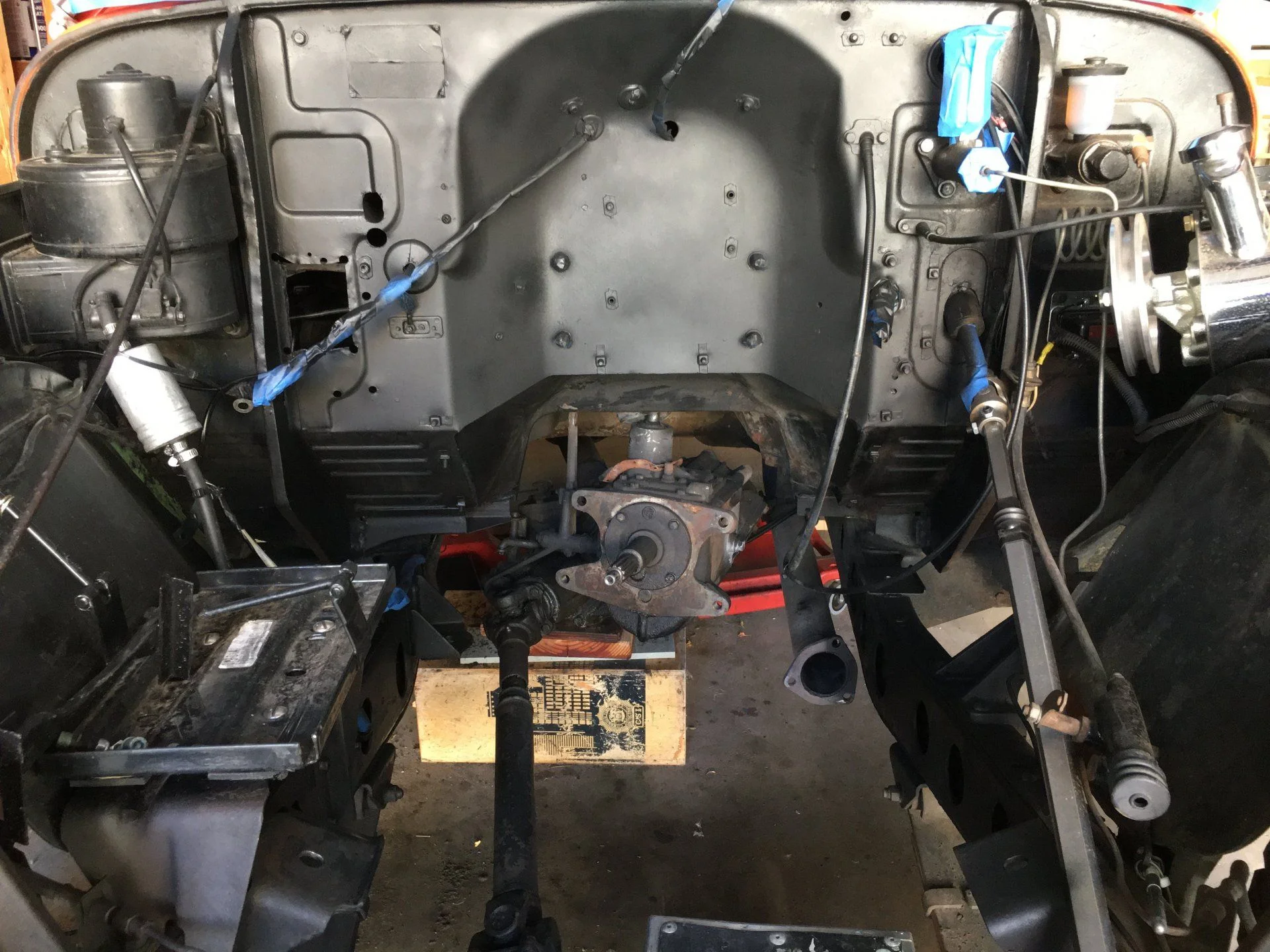

Here can be seen the firewall with wires, etc, masked and out of the way. Notice the 2.5" x 4" hole in the passenger footwell area.
Why the knuckleheads cut that out I have no idea. The holes above that are how they routed the heater hoses.

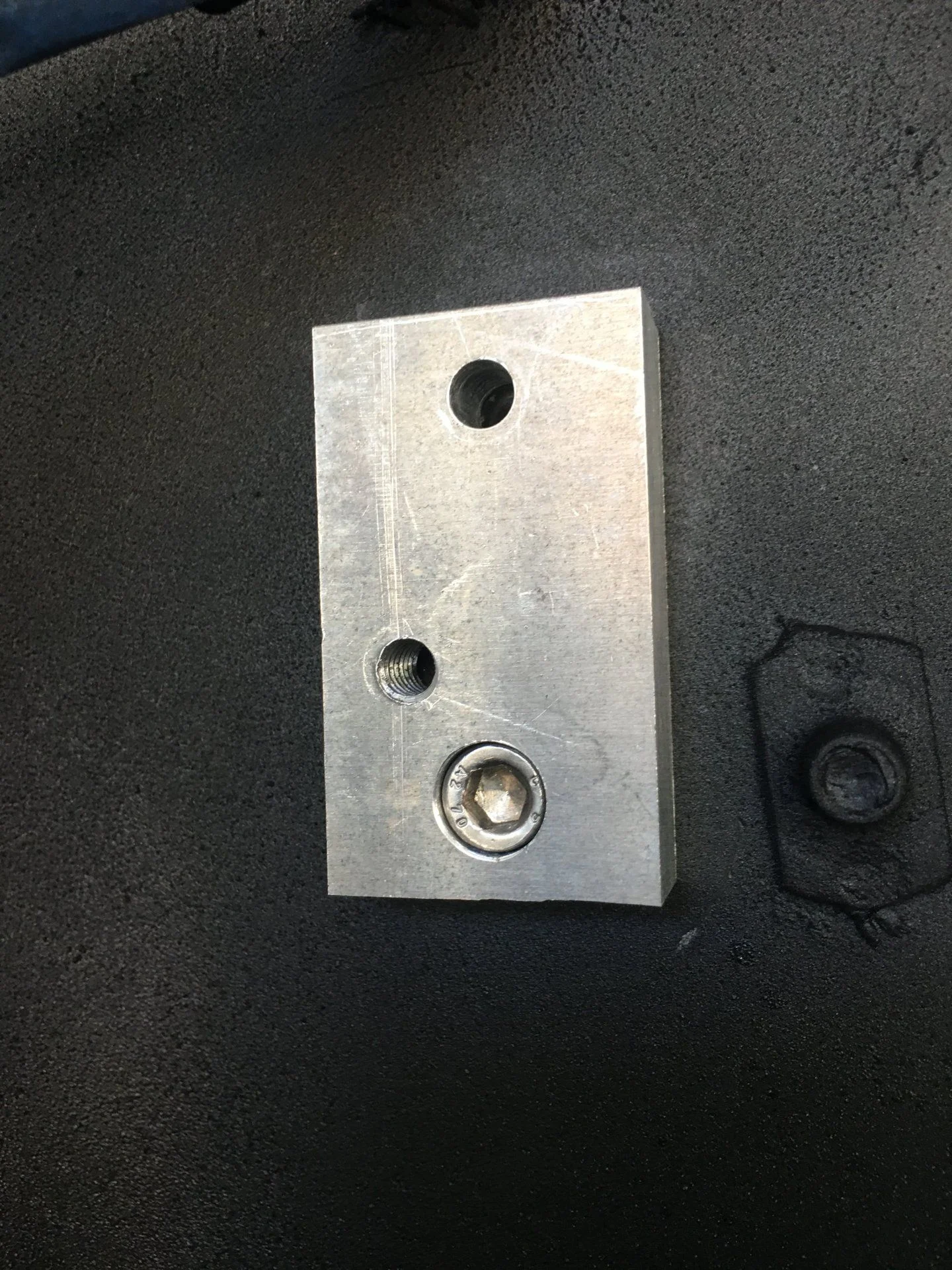

The first bit of bling is this heater control valve from Japan. I used a small block of aluminum to adapt it to the two M6 mounting holes
that were already there. I would have been a bit more careful removing the cylinder head mounted valve if I had known how rare they are!

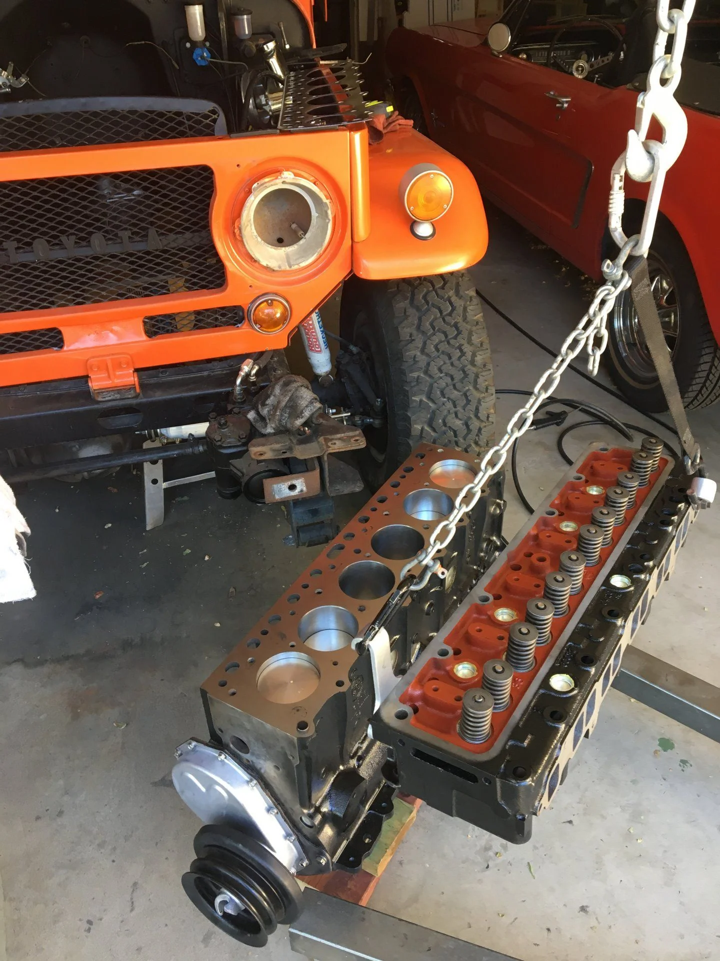

What’s that orange paint? Completely hydrocarbon proof?
That's called Glyptal. It's supposed to enhance oil drainback to the sump. Kind of a hotrodding thing.

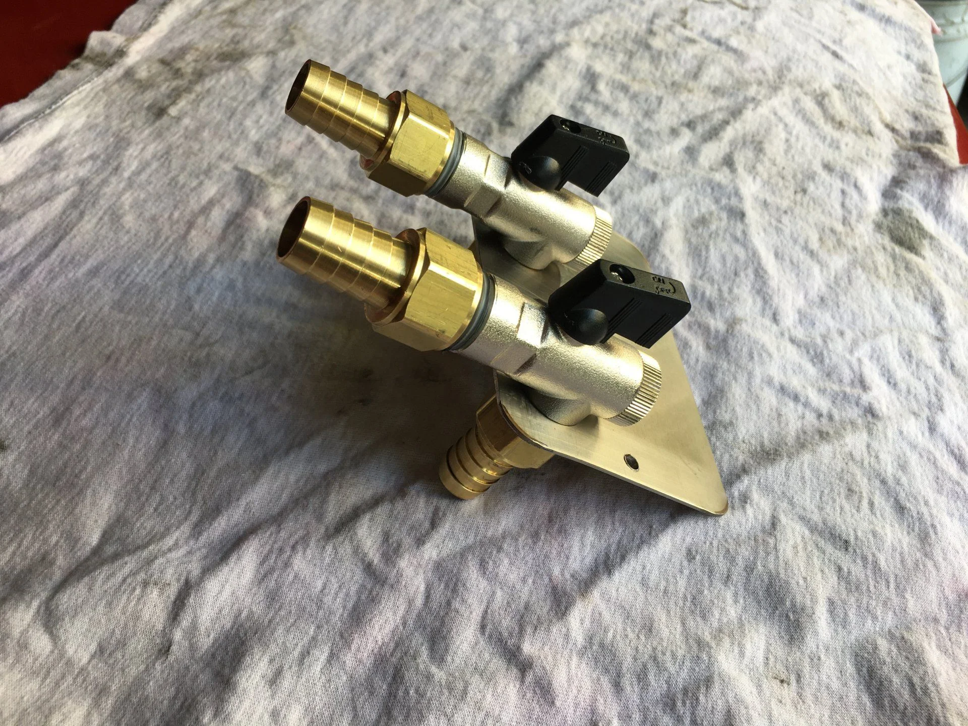

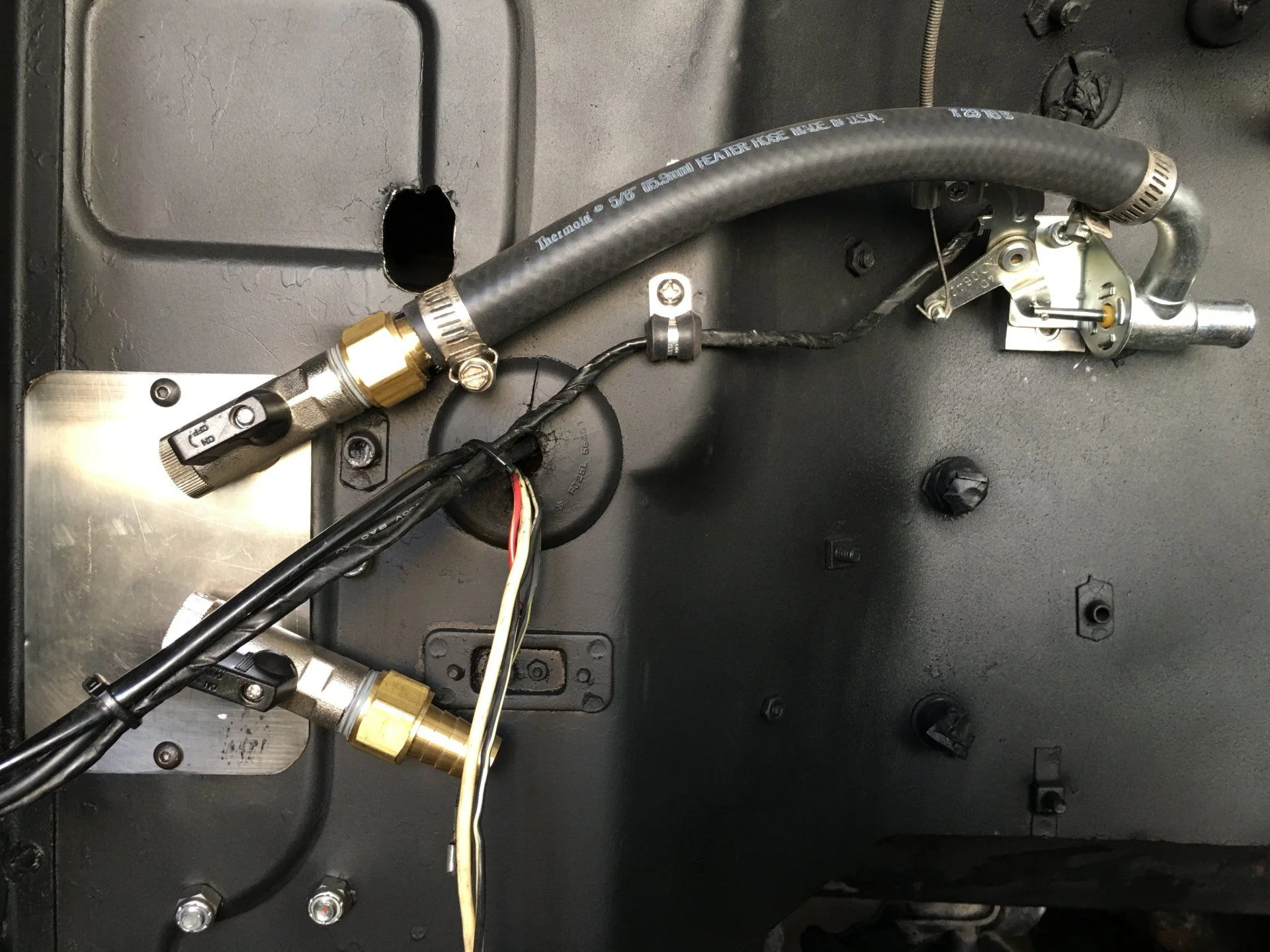

I made a stainless steel cover for the big hole in the firewall. At first I was just going to cover the hole up and paint the cover black.
But after reading some other posts here on mud I thought of using that to route the heater hoses instead of the round and oval holes
the knuckleheads had cut. I like having valves to stop coolant to and from the heater core in case it springs a leak out on the trail. So
I got a pair of slick angle valves with built-in filter screens from McMaster-Carr. I was then able to drill and tap the cover for 1/2" NPT.
Presto: more bling!

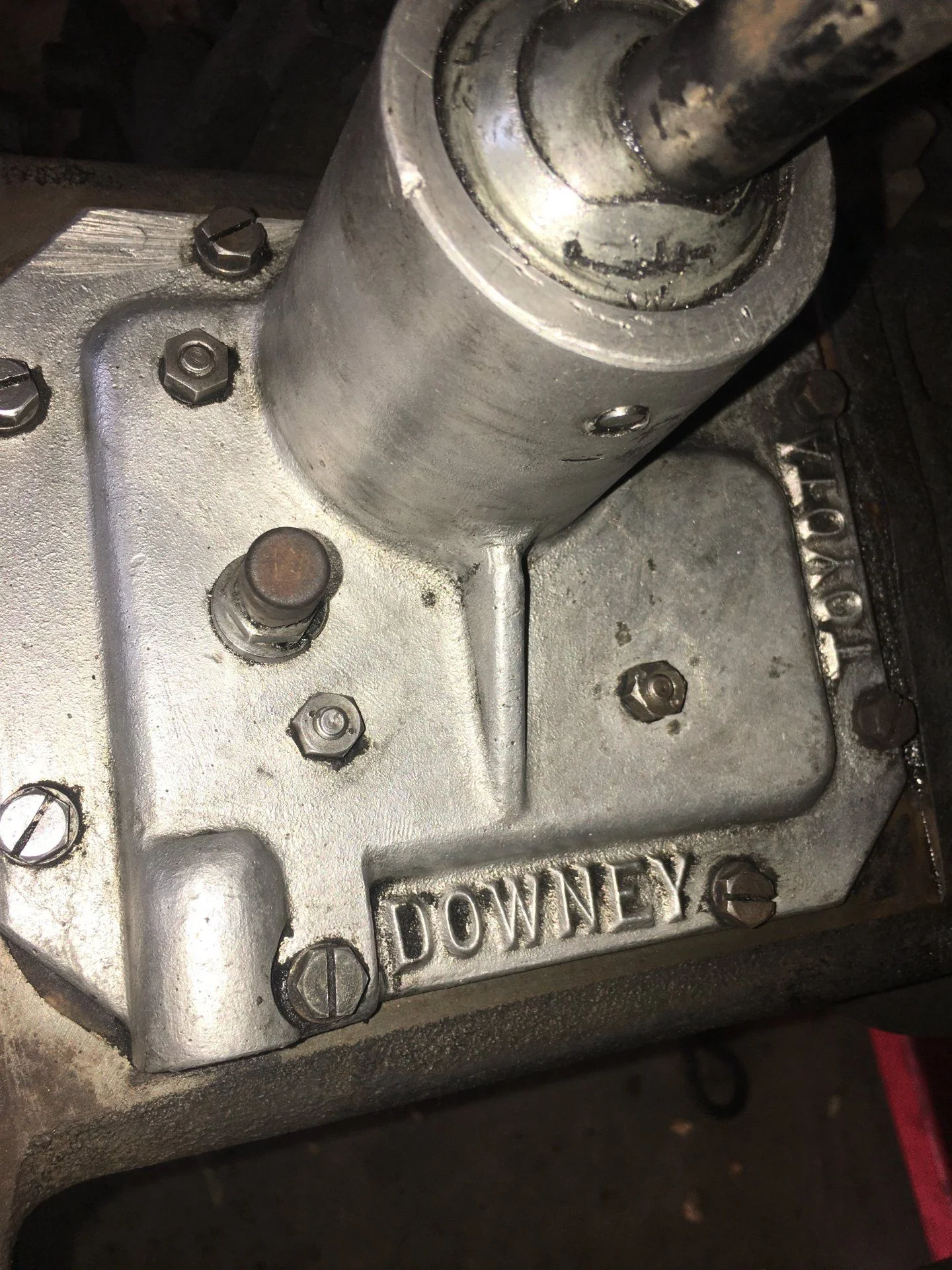

Under 50 years of grime: not exactly bling but more like a tribute to Downey Toyota's huge impact on the Landcruiser universe!
I never put one in my '70, preferring the column shift, but I'm pretty sure I bought my header and Holley 2-bbl set-up from them.

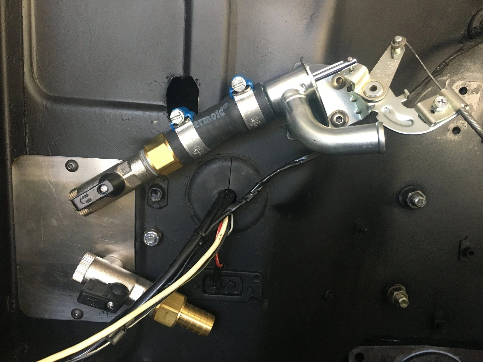

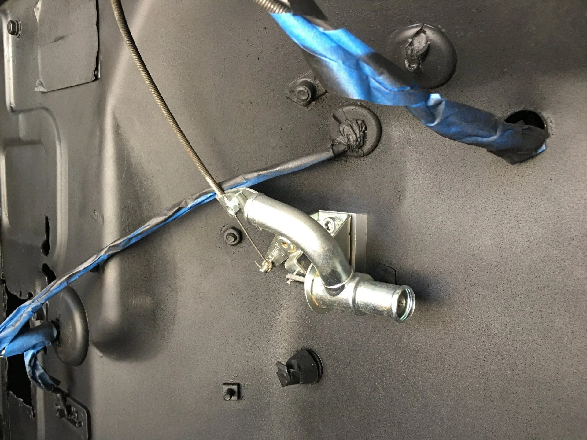

Just a brief update. I rethought the heater valve location and put it closer to the firewall holes, again using pre-existing 6mm threaded holes.
The transmission input shaft seal has been replaced and front cover resealed in anticipation of putting the engine back in next week.

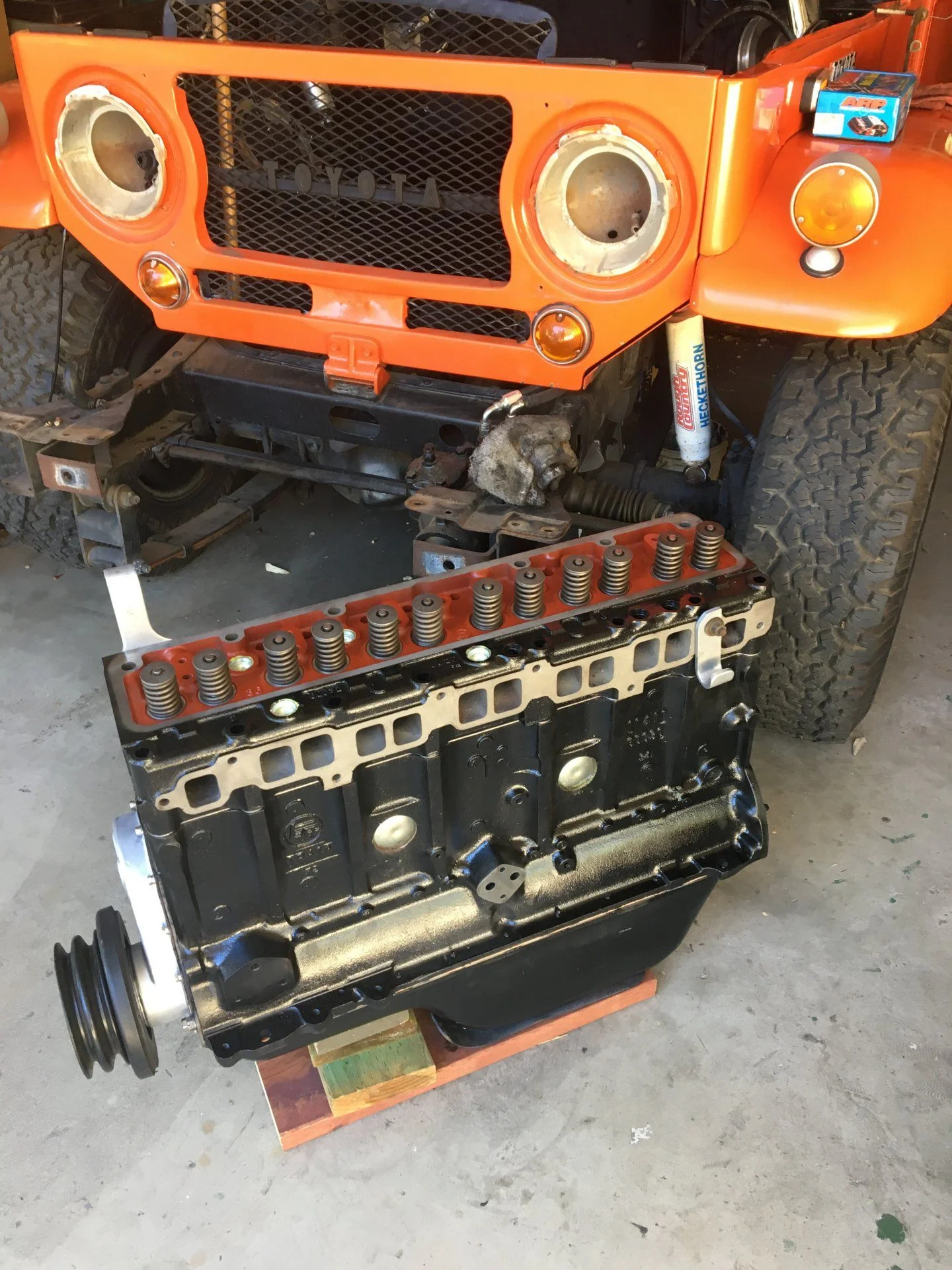

The engine rebuild is (mostly) finished and sitting back in the garage. The fun begins!

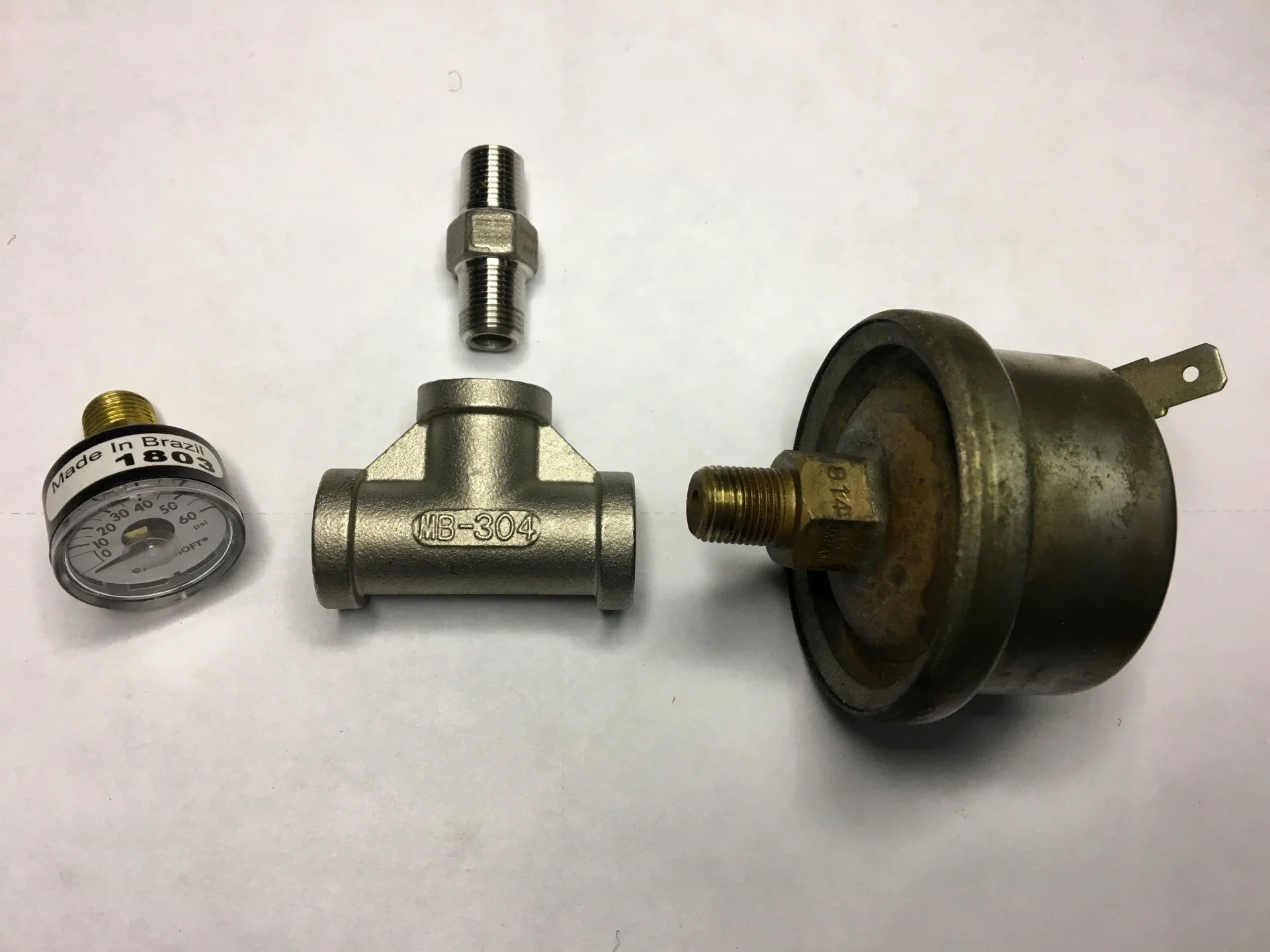

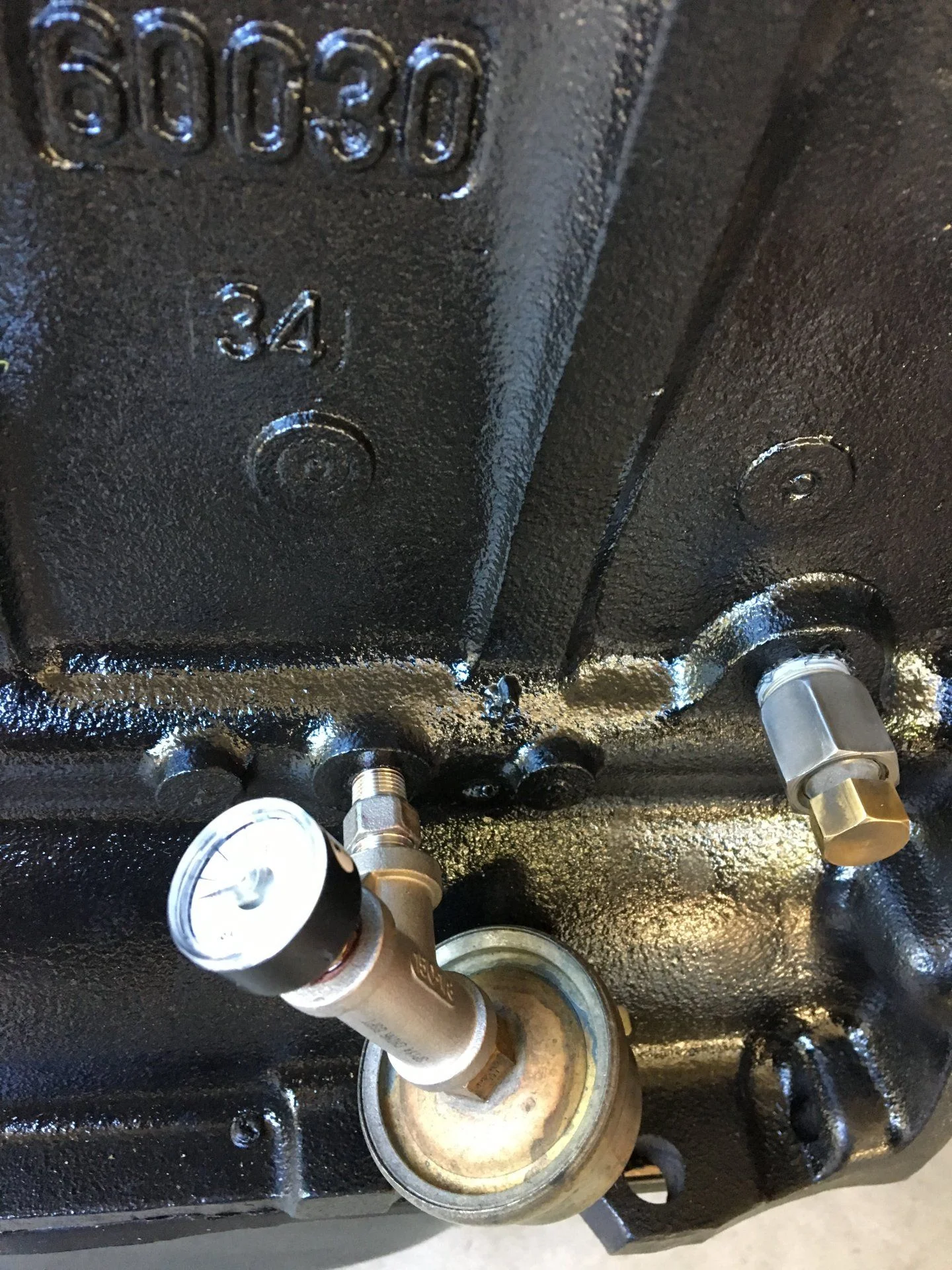

I thought it might be useful to know the oil pressure since the bearings are all new and the oil pump is rebuilt, so:
Fortunately BSPT fittings are easy to get from McMaster-Carr and others.
