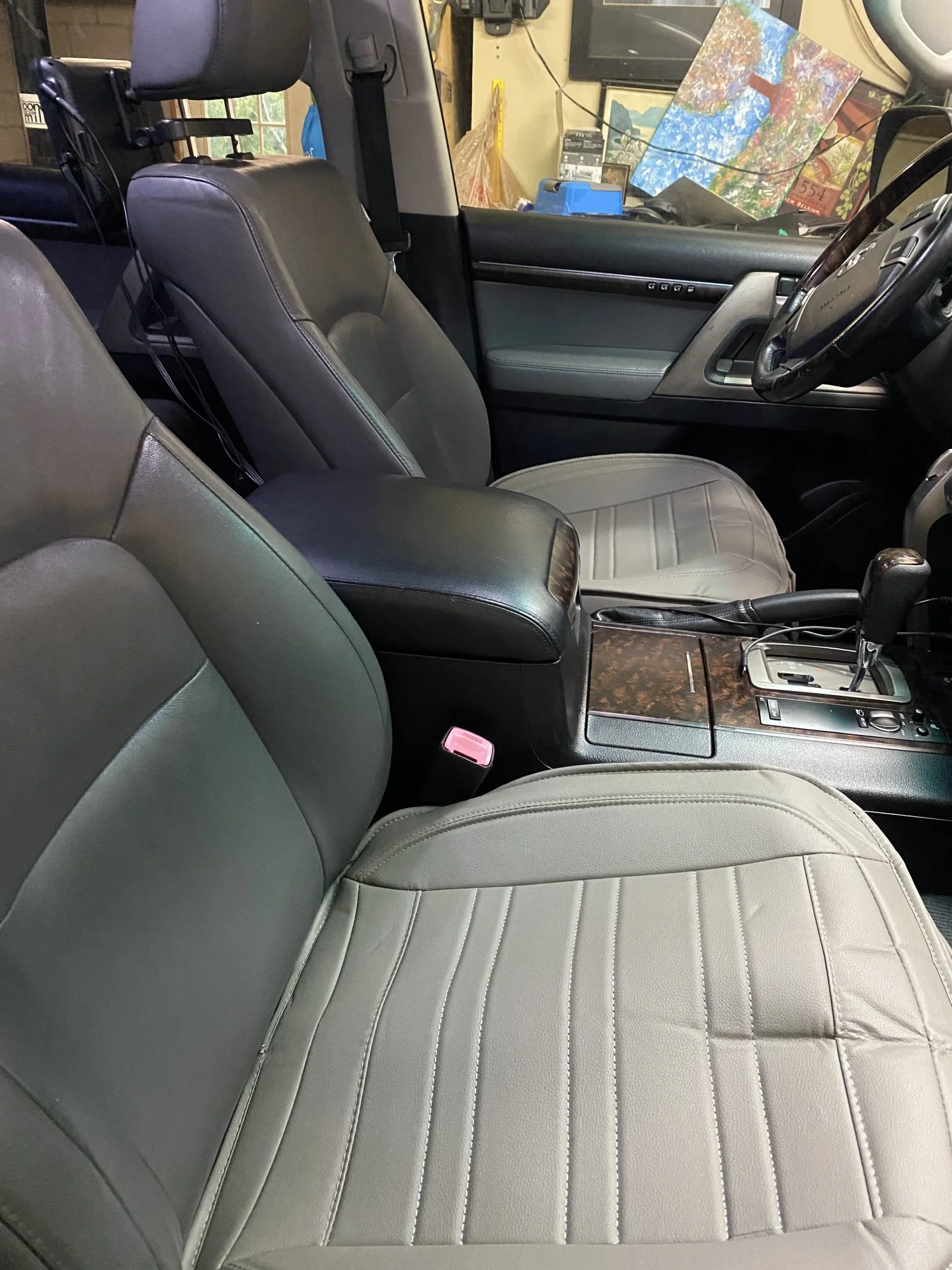

My DS seat had some type of tear or something at one point and looks like it was ‘fixed’ and painted with the exact same finish as the seat…no idea. I thought about buying som nice seat covers, but went with these and they work well. One of the reviews said they fit their LC200 pretty well so I ordered them. Once the wrinkles flatten out they will look pretty good. Seem comfortable. I’ll update on quality and the heated seat effectiveness with them on later.

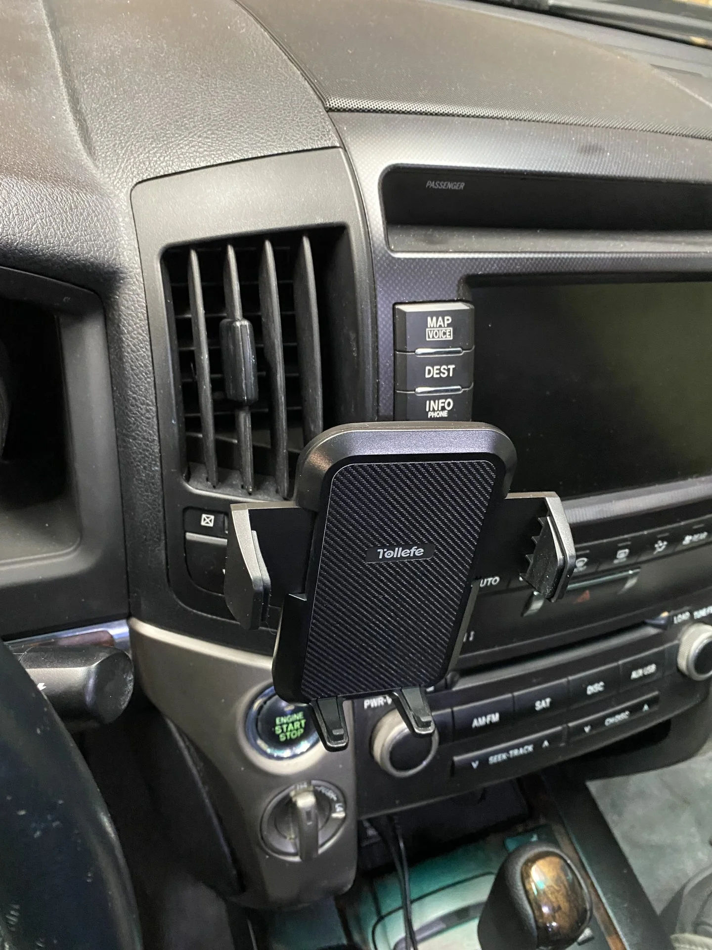

Phone holder. Not sure I’m into this one, but haven’t found one that will work well with the dash area yet. This one attaches to the vent. I have a feeling when I turn a corner it might tilt while turning. Any other suggestions?

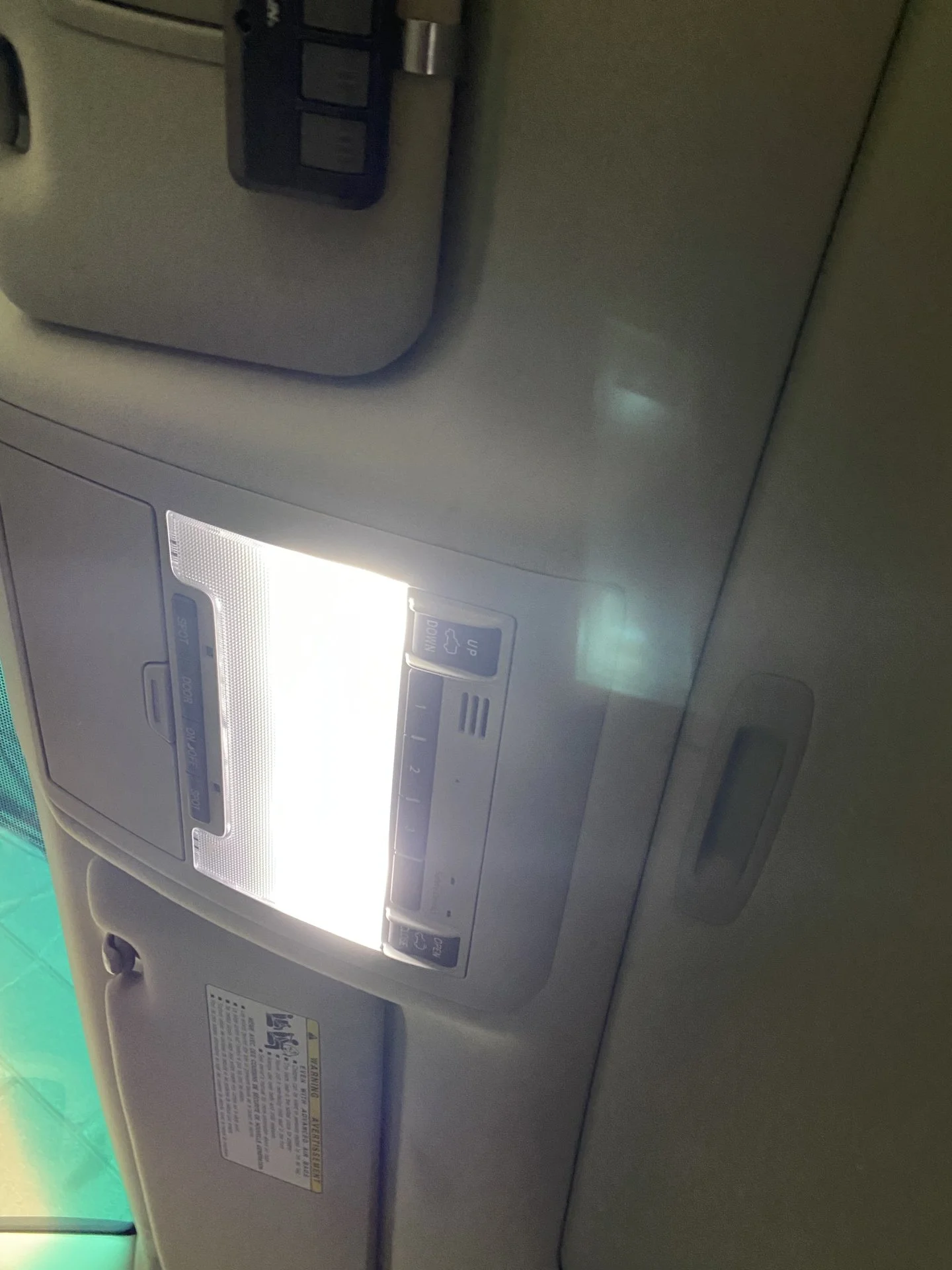

Interior lights to LEDs.
These are pretty bright. I’ll get some more pics in the dark.
A pack of 10 will get the 2 up front, 4 in the middle RES and all 4 doors.

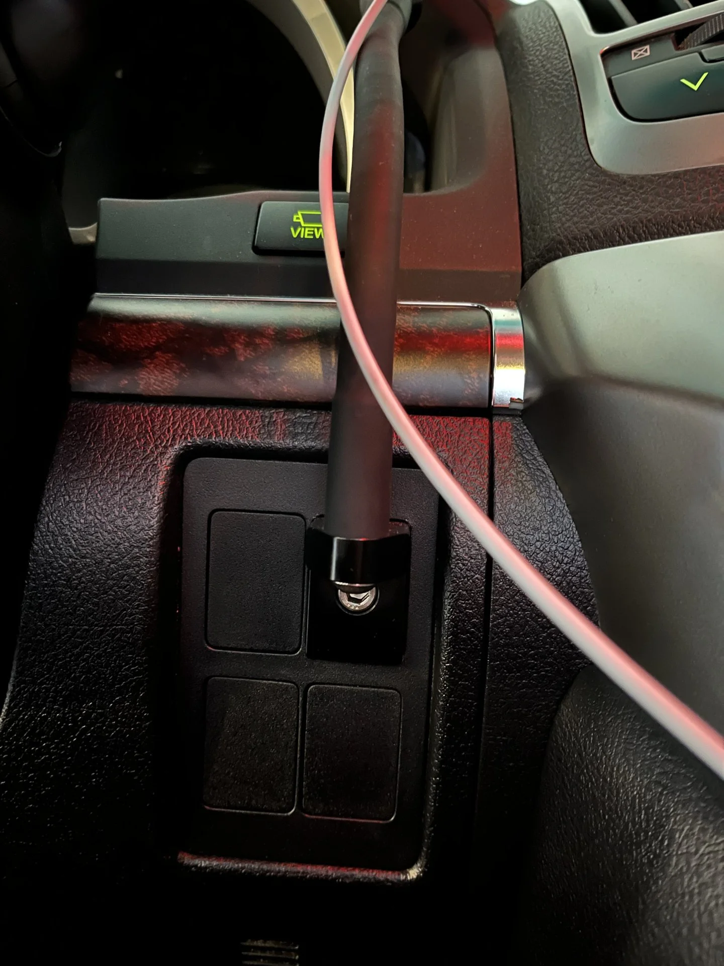

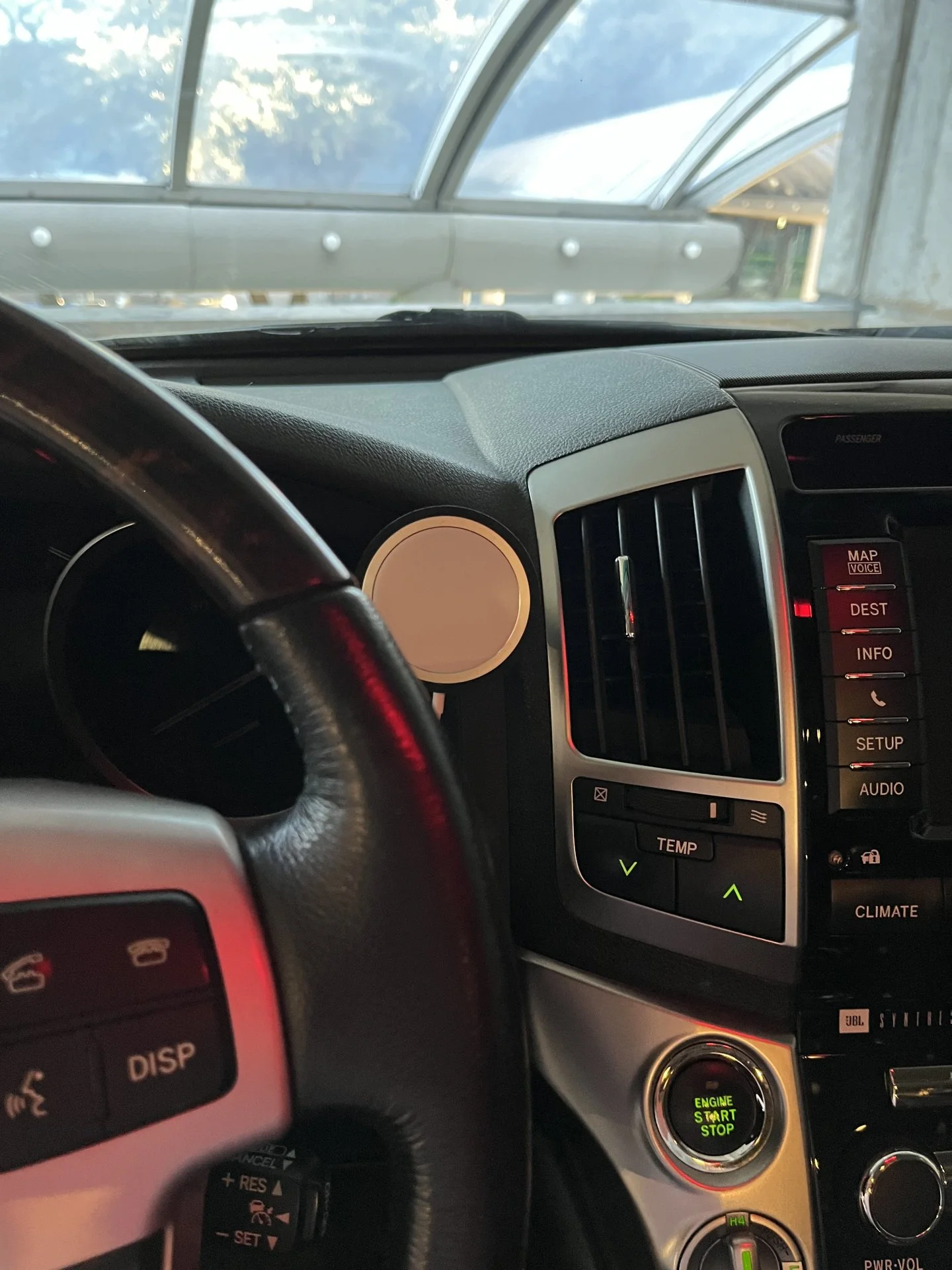

I’m using the cravenspeed mount which goes in an empty switch blank. It’s very sturdy and I like that I can adjust the position easily and out of the way of the vent flow. I also modified like this guy did to attach a MagSafe charger.

Do you have any pics of the mount in the LC? That looks like the ticket.

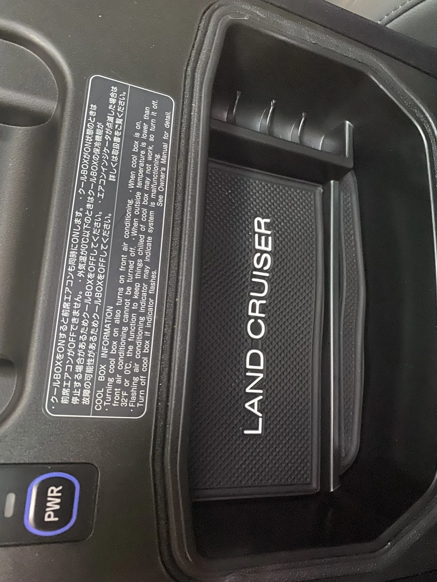

Pretty cool insert for the cooler box. The description and photos on the ad don’t show the ‘Land Cruiser’ on the pad, but it is on there.
Salusy Car Center Console Armrest Box Glove Box Secondary Storage Compatible for Toyota Land Cruiser 2008-2020 https://www.amazon.com/dp/B01KCP5VK6/?tag=ihco-20

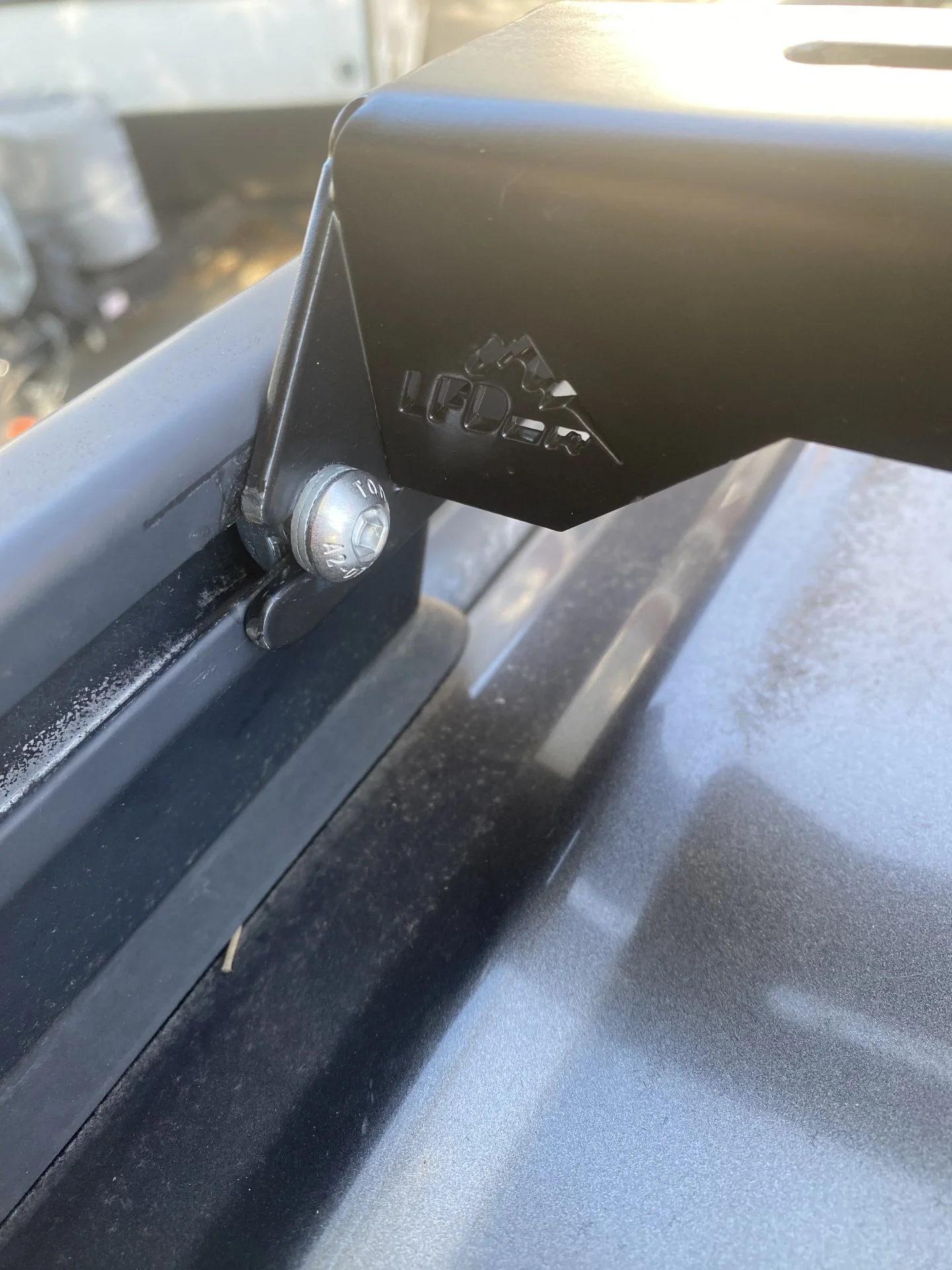

Love your updates man. Just bought a '14 200 series myself and will be doing pretty much all the stuff you've done. Love those rails bolting right into the factory rack.

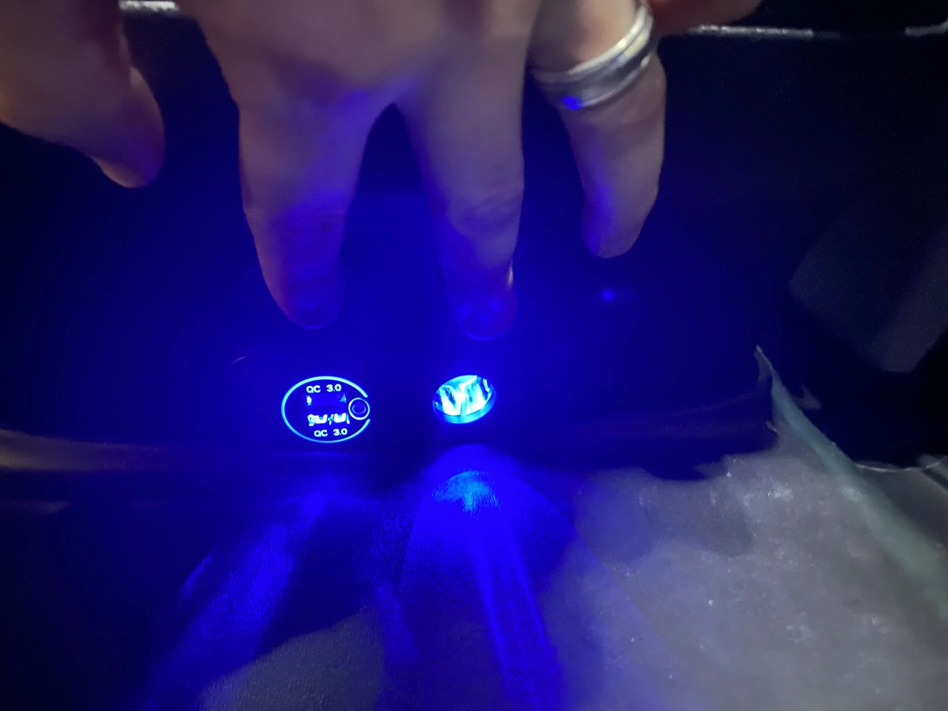

Installed a fuse block today and some 12v points in the center console below the audio/AC controls. Very cramped in there and I didn’t think I was going to be able to fit everything in there, but it did. Wish I would have been able to mount it 1” higher, but don’t think it would have worked bc of all the stuff in there.
I’ve used Blue Sea before but decided on this one. Seems well made and happy for the price.
I’m mounting it on the DS kick panel. There is an area where I can velcro it and pull it down easily to add more stuff. This is mainly for USB chargers and small stuff. A coat hanger to pull the wire though the center console from the front…pretty easy.
From the battery went to a 40a Busman circuit breaker>Relay>new fuse box. Used the 10a Ignition with a fusetap in the box under the hood yo trigger the relay. Going to mount another of the same 12v power points in the cargo area.
12 Way 12V Fuse Box 12Volt Blade Fuse Block Holder, 12 Circuit W/Negative Bus Waterproof Fuse Box with LED Indicator for 12V/24V Automotive Golf Cart Truck Car Boat Marine RV Van Vehicle https://www.amazon.com/dp/B091Y4WVML/?tag=ihco-20
[Upgraded] Cigarette Lighter Socket Outlet Splitter, Quick Charge 3.0 USB Charger Power Outlet with LED, 12V USB outlet Marine Waterproof Power Panel Adapter DIY Kit for Car Boat Marine RV, etc https://www.amazon.com/dp/B08MQBQ82J/?tag=ihco-20

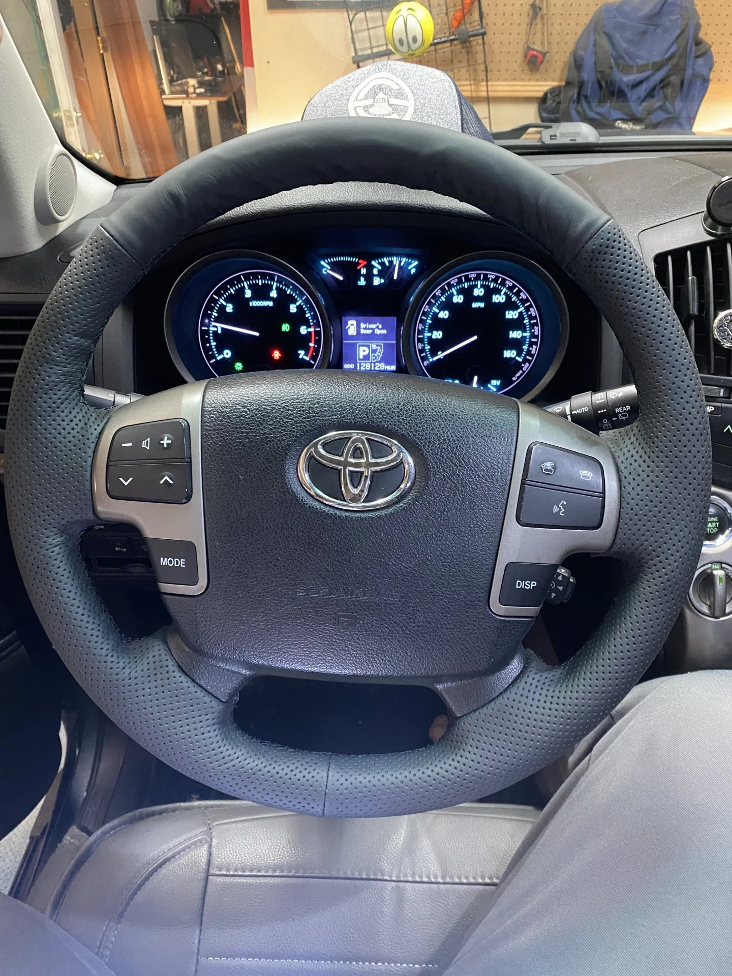

Loncky steering wheel cover. Took about 2-ish hours. Feels great.
This is the black with black thread. More like a dark grey.
Loncky Genuine Leather Auto Custom Steering Wheel Covers for Toyota Land Cruiser 2008-2015 / Toyota Tundra 2007 2008 2009 2010 2011 2012 2013/ Toyota Sequoia 2008 2009 2010 2011 2012 2013 Accessories https://www.amazon.com/dp/B00RXIQTBQ/?tag=ihco-20

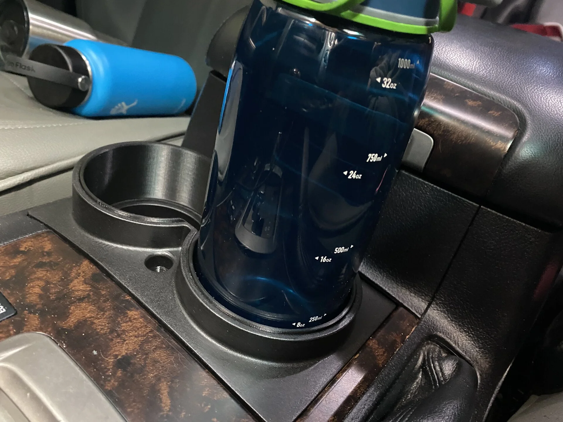

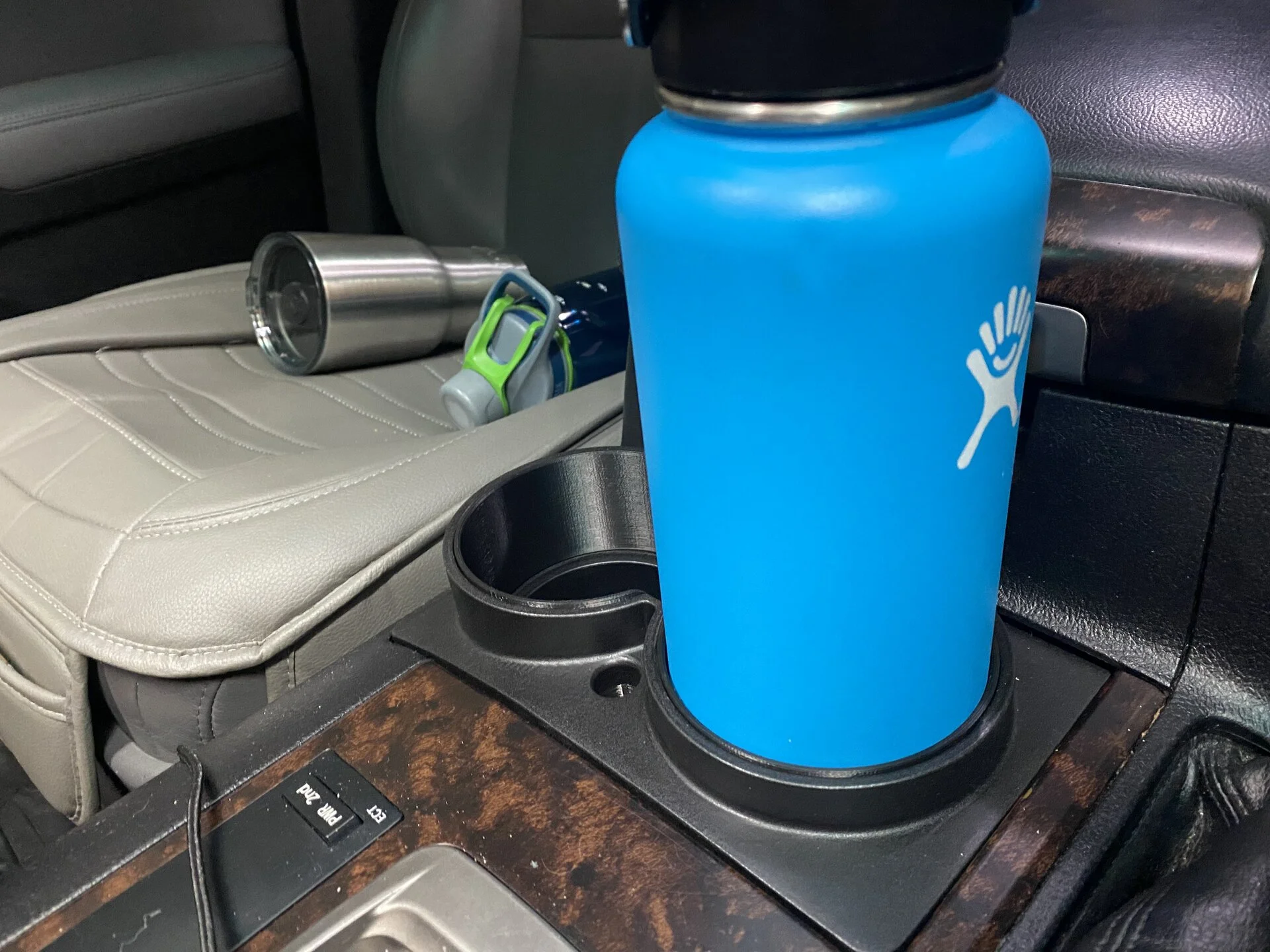

The Nalgene and Camelbak won’t seat all the way down bc of the smaller bottom, but they sit on the ridge of that bottom lip and will work fine. The Nalgene is very tight in there and the Camelbak is tight enough where it won’t fall over, which is great.
Moral: I have too many dang water bottles. My wife was more pumped than I was about this cup holder.
