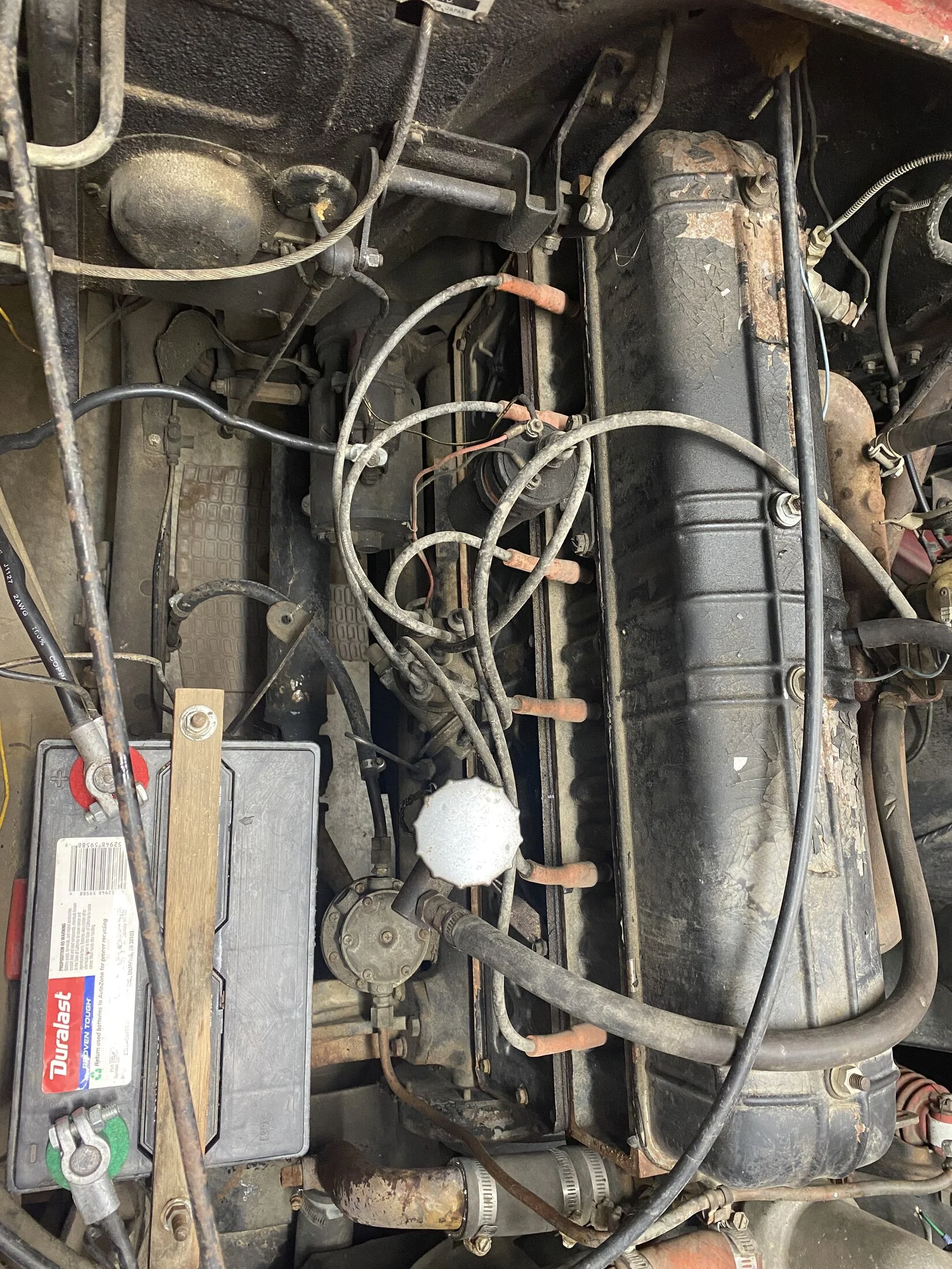

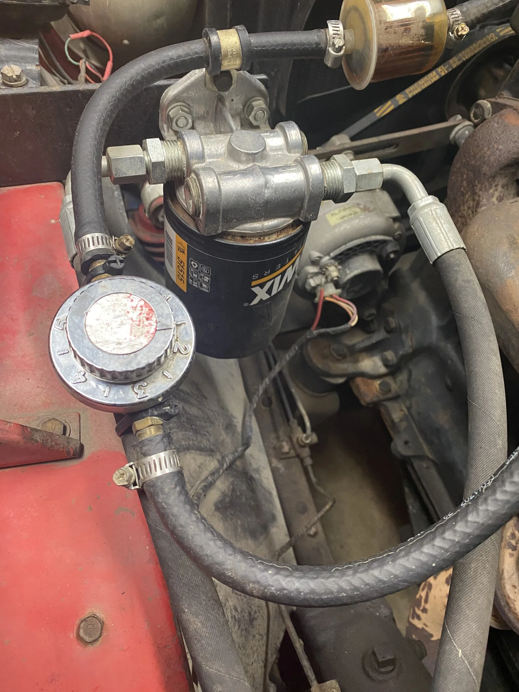

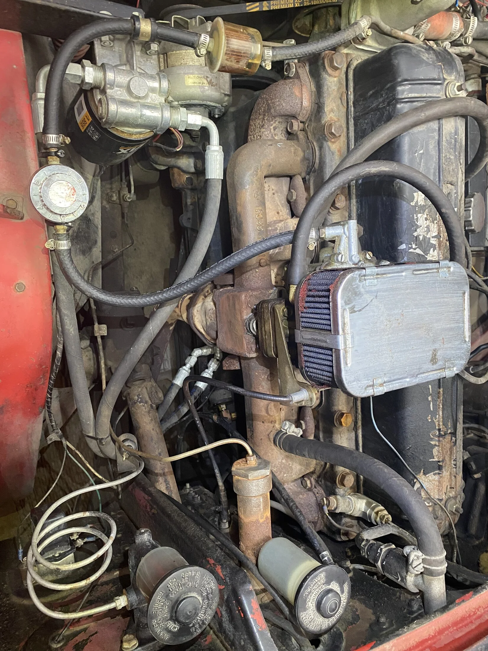

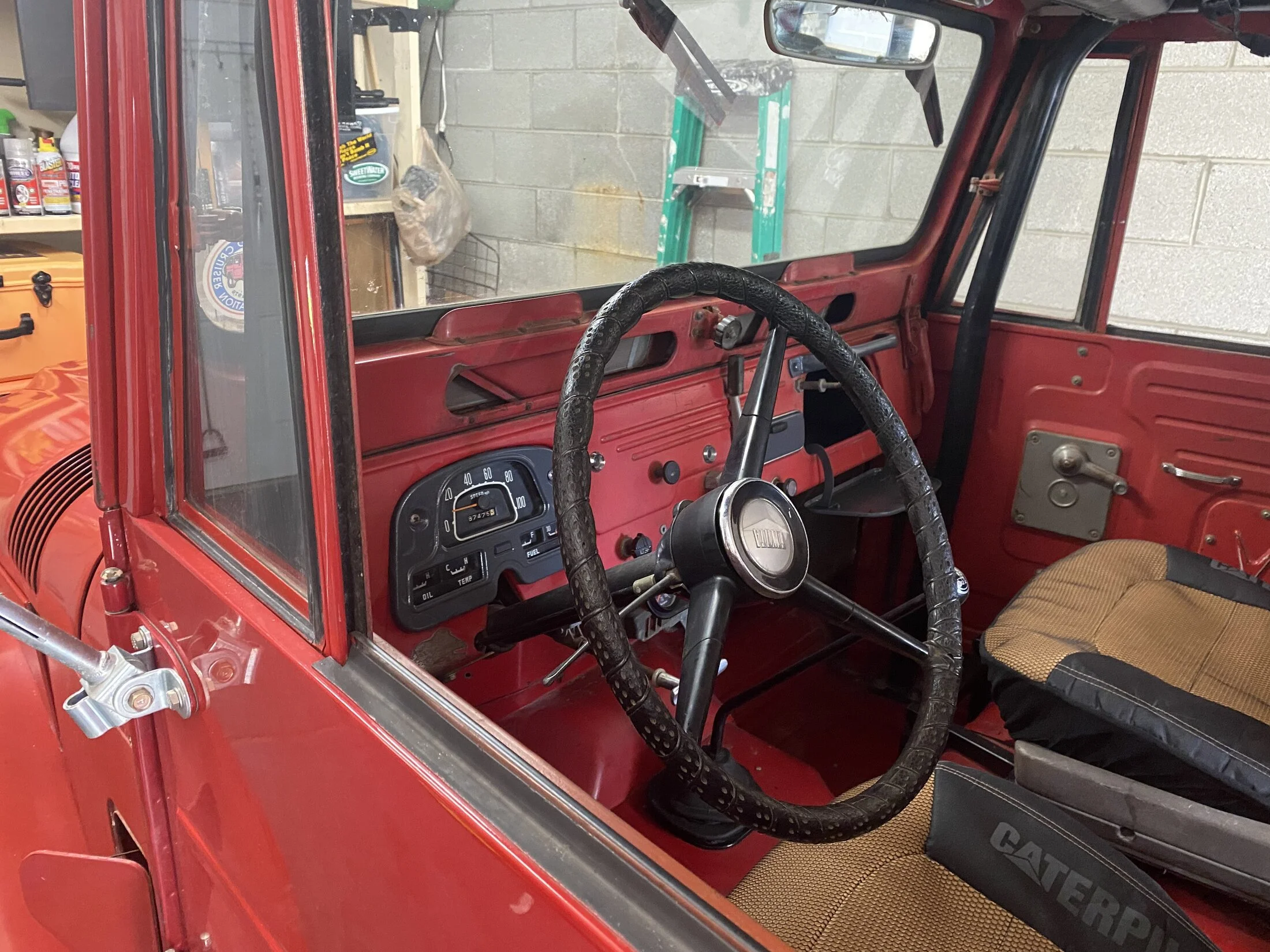

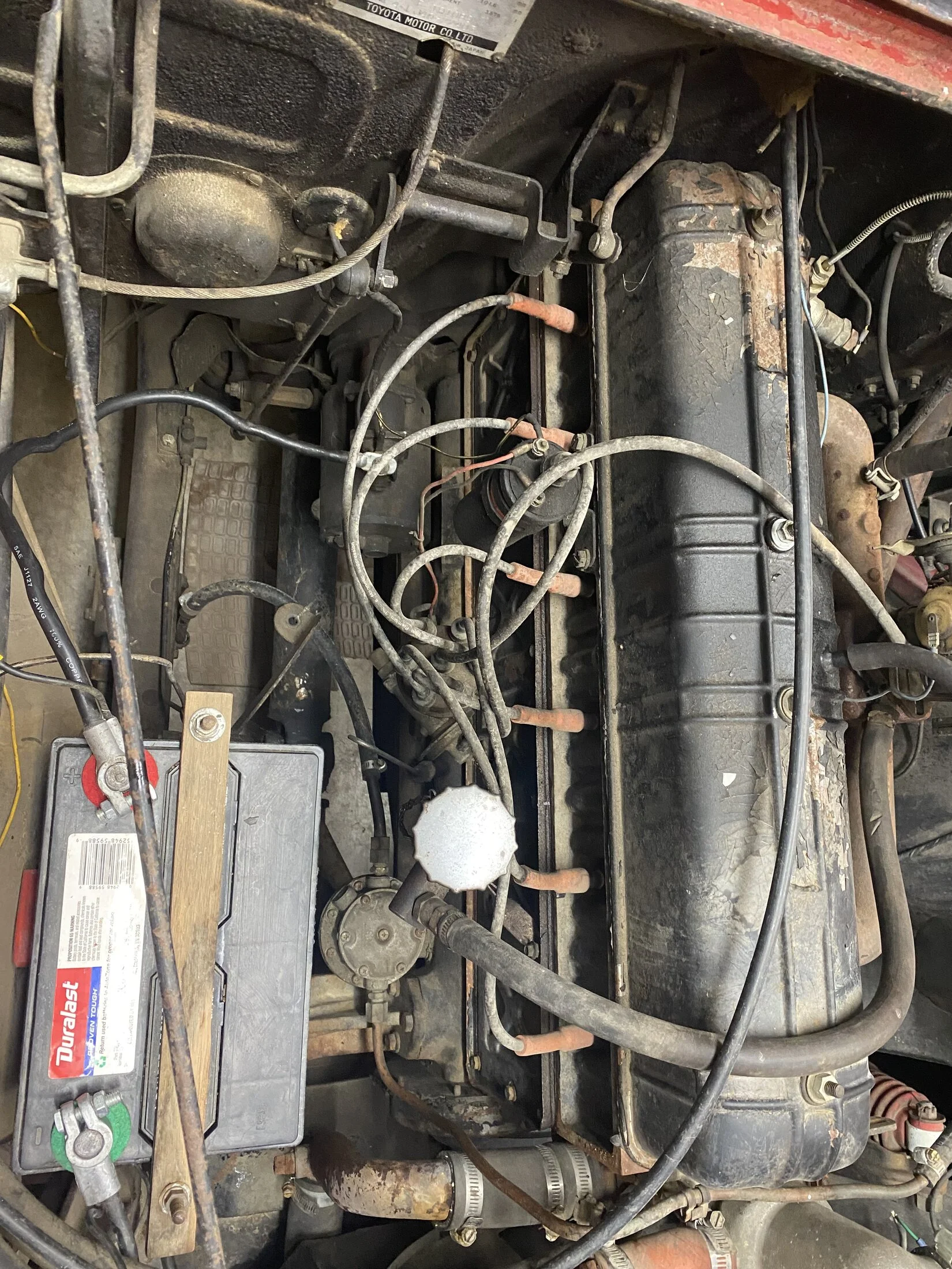

It looks like you still have all the vacuum feed and control necessary for the FD to be vacuum engaged, the FD knob was just moved over near the glove box. Your rig does not have the passenger-side factory firewall heater blower, therefore the FD vacuum engage unit is in that location and requires a longer FD cable. When the factor heater blower was introduced ('65 maybe ?) the FD unit moved more to the center of the firewall, and the FD pull cable became shorter. My guess is someone had to replace that cable (they are susceptible to rusting out) and could only find a shorter one, so they moved the FD knob location to near the glove box, hence the non-factory hole in the firewall below the VIN plate. So the remaining question is what is that shrouded cable or hose that runs along the top of motor, where does it go (in another post you said the TC) and what does it do? Also, what is the knob/switch/pull that's in the FD knob's original position that appears to be connected to this cable/hose? If it does go to the TC, could it be some sort of actuator for some type of overdrive? Is your parking brake drum directly on the back of the TC or is there another unit of some sort between it and drum brake and drive shaft?
I will get a video tomorrow when I’m home and post it here to try and figure some of this out. I’m not sure how to activate/deactivate the vacuum portion.
I’m confused on the 4wd in general between the pull knob for 2wd vs 4wd by the glovebox, the gray upright lever to the left of that for hi/lo, then the ‘turn knob’ to the left of that with the hard plastic line running to the TC (I think), and then the locking hubs. Haha…lots going on.
Wait a minute, hard to tell from the pics you've posted in several places, but it looks like that shrouded cable (with the knob next to the upright hi/lo lever) wraps back around by the battery and goes back through the firewall near where your horn relay is mounted. If so, then maybe that is some sort of control for the aftermarket heat/air conditioner (is there a ac condenser upfront somewhere)?
There is a heater there…I’m not sure if it runs an AC…haven’t quite figured that out either, but there is a fan knob next to the random knob in question.
The shrouded cable does loop back in over by the horn relay. I assumed it then went down to under the vehicle. I’ll get under tomorrow and take pics.
Finally messaged the PO…he said the mystery knob is to pull out the kick panel vent on the passenger side bc you can’t access it with the heater in the way!! I told him I was afraid to mess with it bc I thought it might be something with the 4wd.
Wow, that's quite the mod for that functionality. Wonder why he put it where the FD pull was and moved the FD pull? (See my guess above)
It is a cool mod…if it worked…haha. I can see that it is tugging at the cable to ‘try’ to work, but will need something additional to get it to function properly. Otherwise I’ll take it off and just do it manually…you can get your hand in there barely to do it manually.

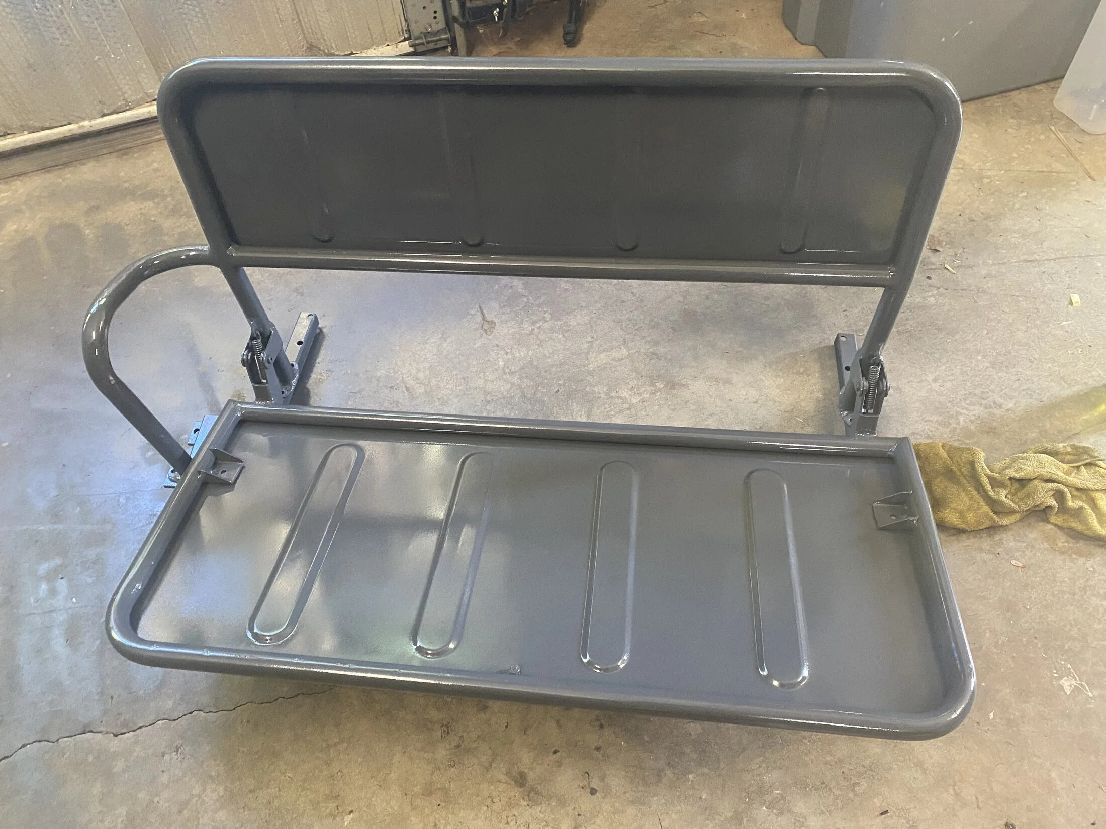

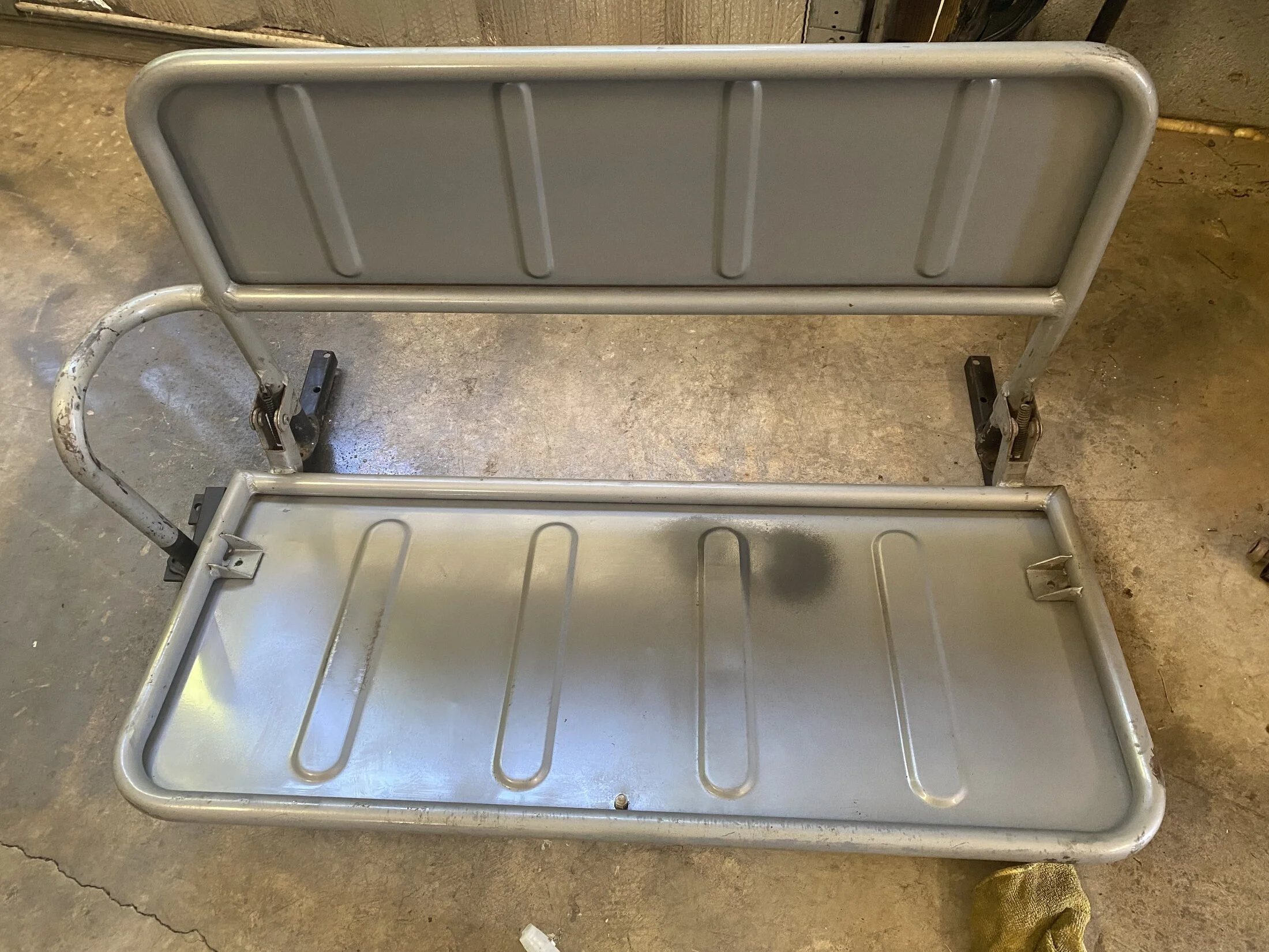

Got the rear seat frames sanded down, painted and replaced al of the old screws/washers with new stuff so it is shiny.
I also sanded down and painted some of the ‘removables’.

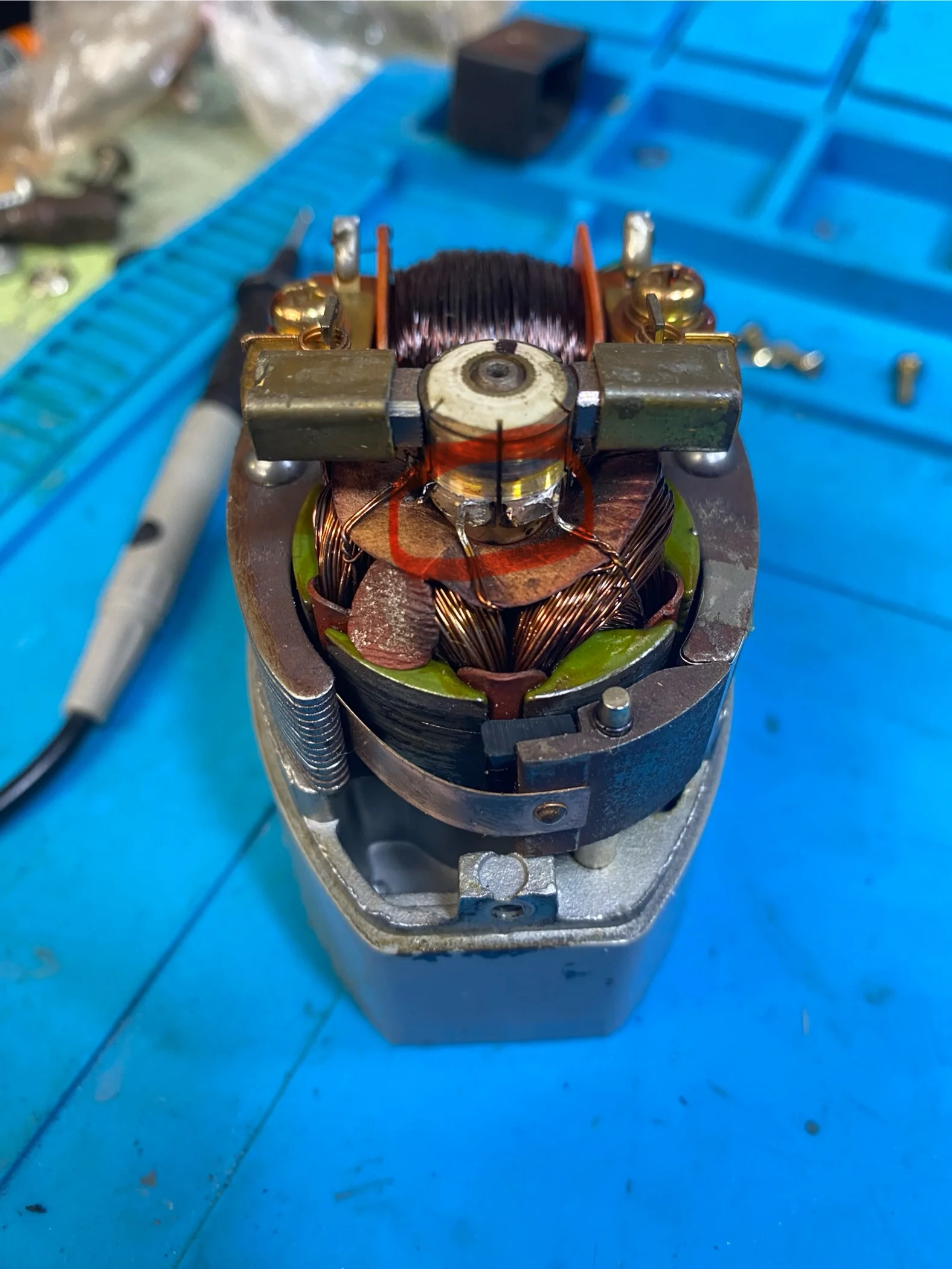

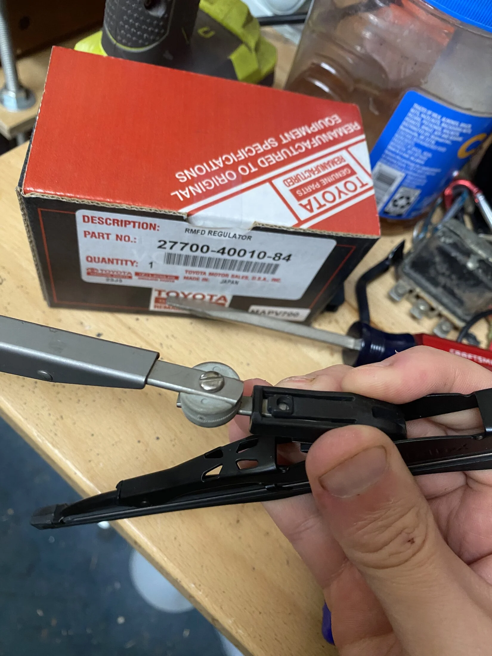

My passenger side windshield motor wasn’t working. Tested for power on ‘+’, checked the aground, and checked the ‘S’ for switch power. All of that tested good. I took the motor apart and at first wasn’t sure. Then I took some pics of it to send to another member and noticed that there were two very small wires that looked like they should have been soldered, but after 60 years might have come off. So I gambled and soldered them back…voila! It came back to life. I paln on cleaning each motor out and putting in fresh grease.
Now I just need to find some wipers that fit.

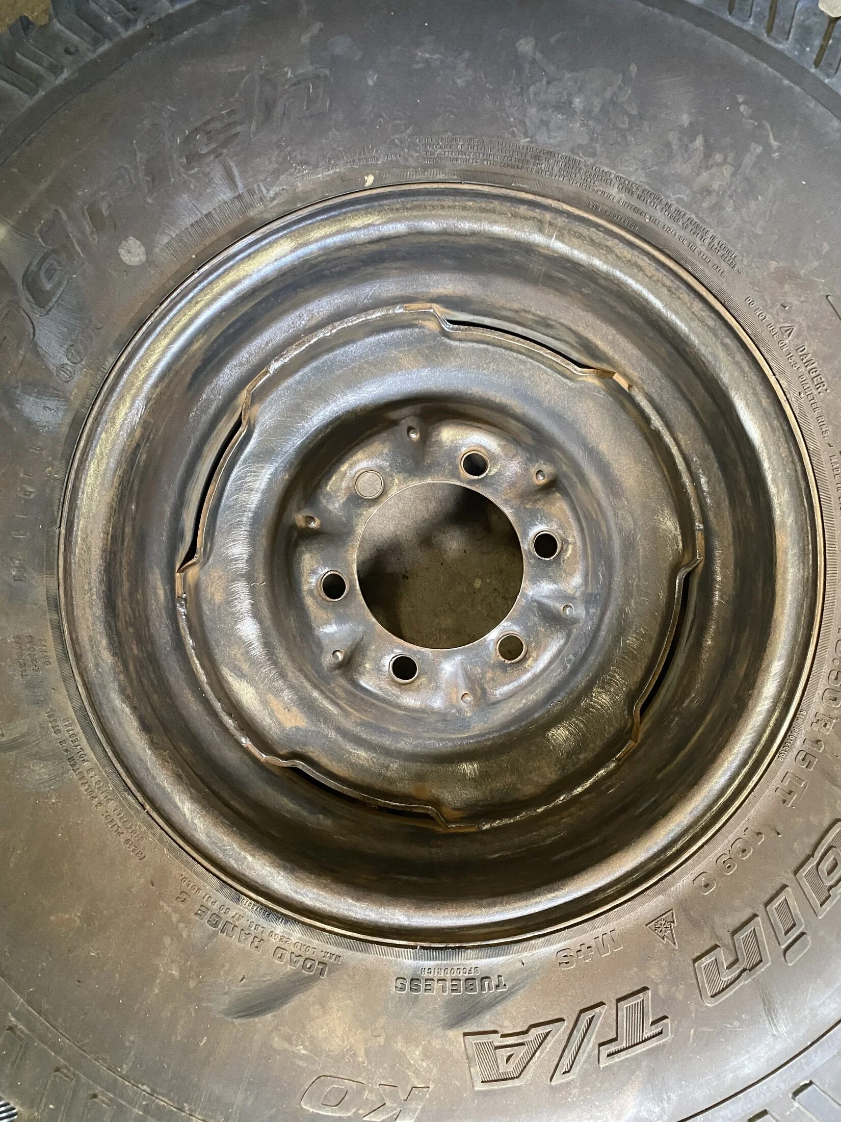

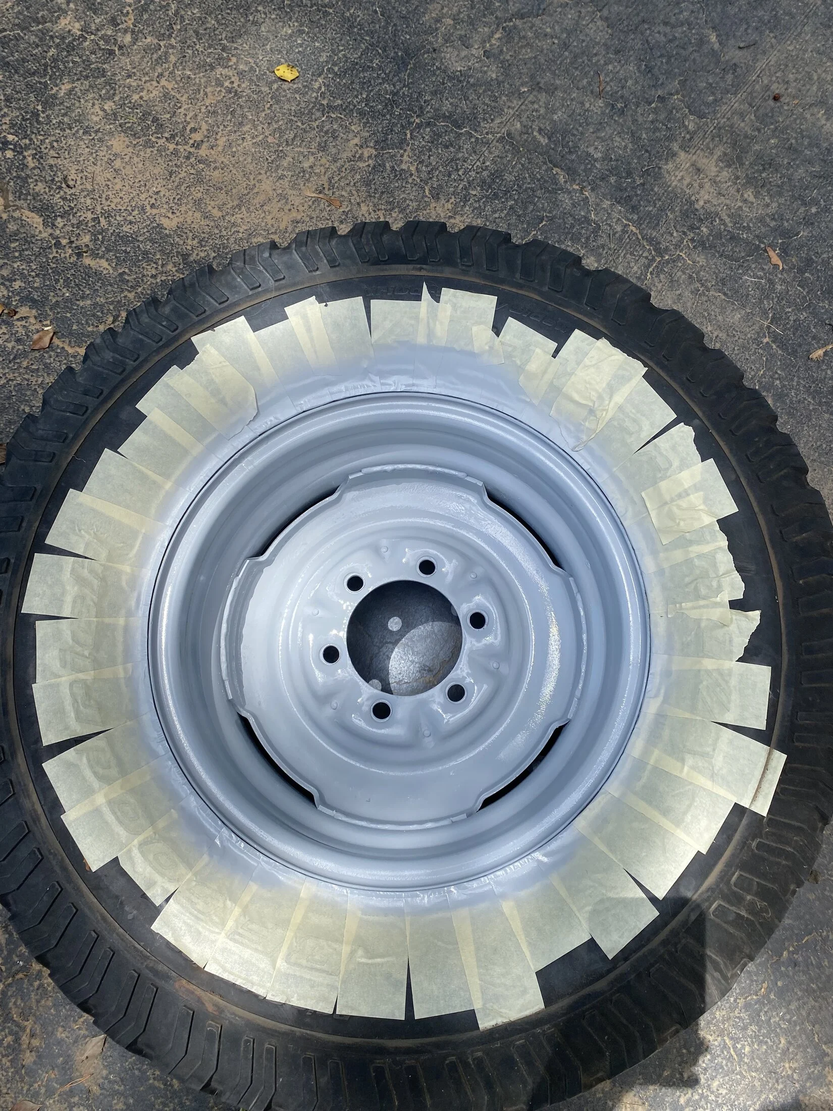

Based on some feedback from Mud, Went with Rustoleum Massey Ferguson Gray. At first it looked a little brown, but settled down over night and seems more gray. Wire wheeled all rust off the back and front, cleaned up, primered and painted. Have only done the spare. Will be doing the other wheels within the next week or two.
So hot the motor working but it doesn’t ah e enough power to move the windshield wiper. Grease issue maybe?

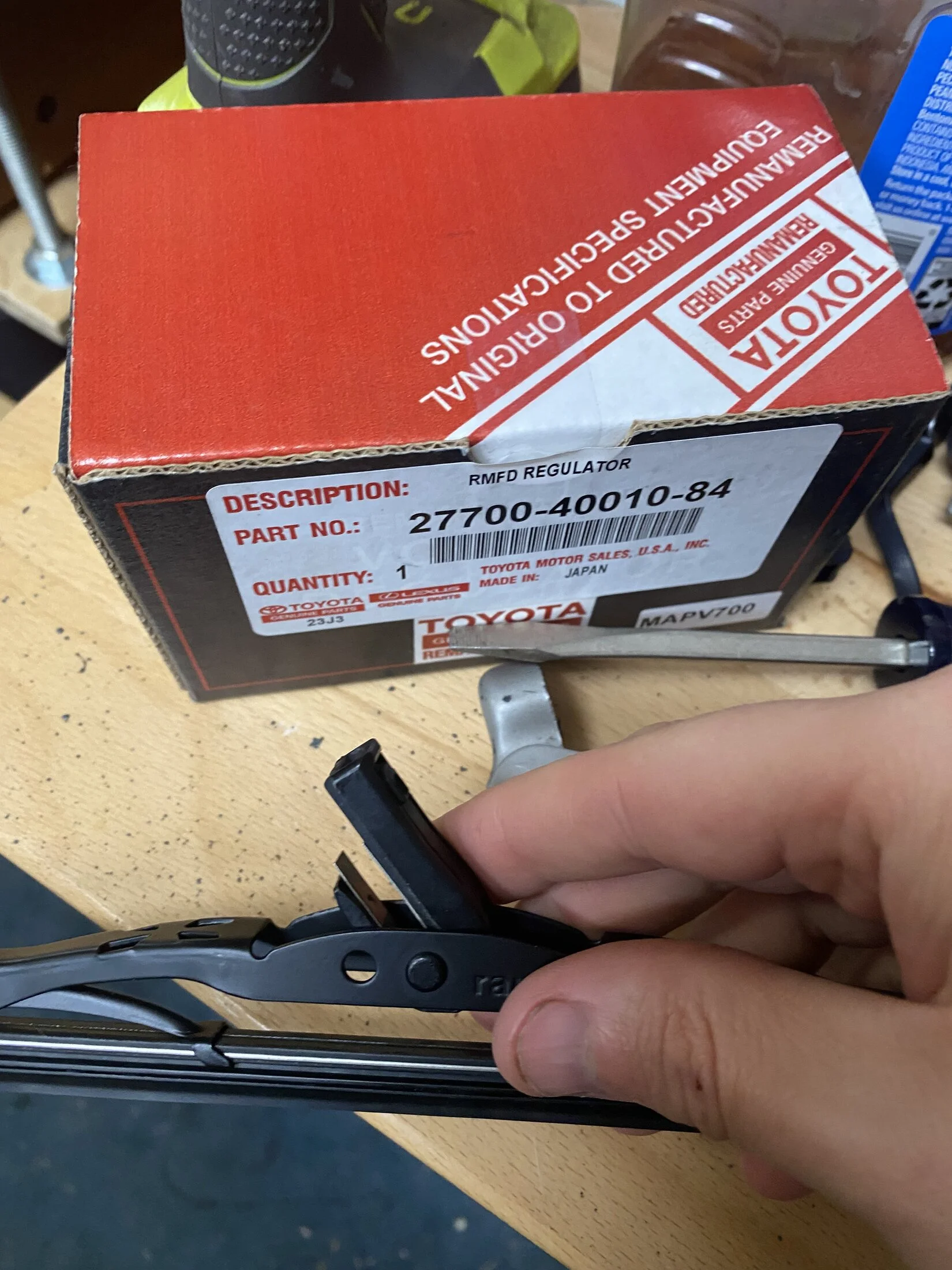

I took the original fitting from the wipers and put it on RainX wiper (C-11 Conventional)…a little wobbly, so not sure if these are the answer when it comes to wipers.

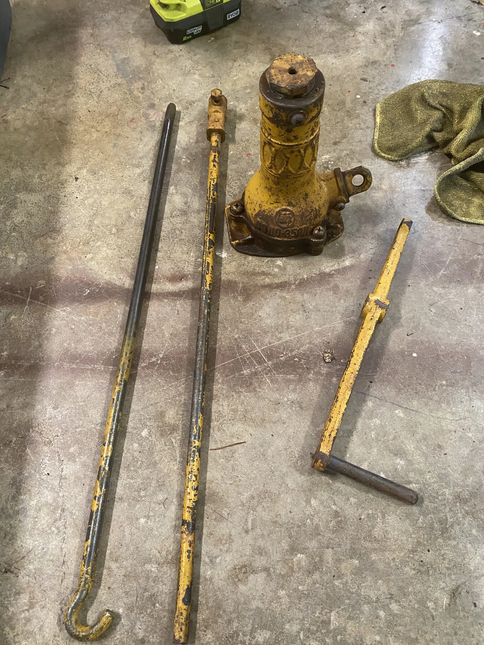

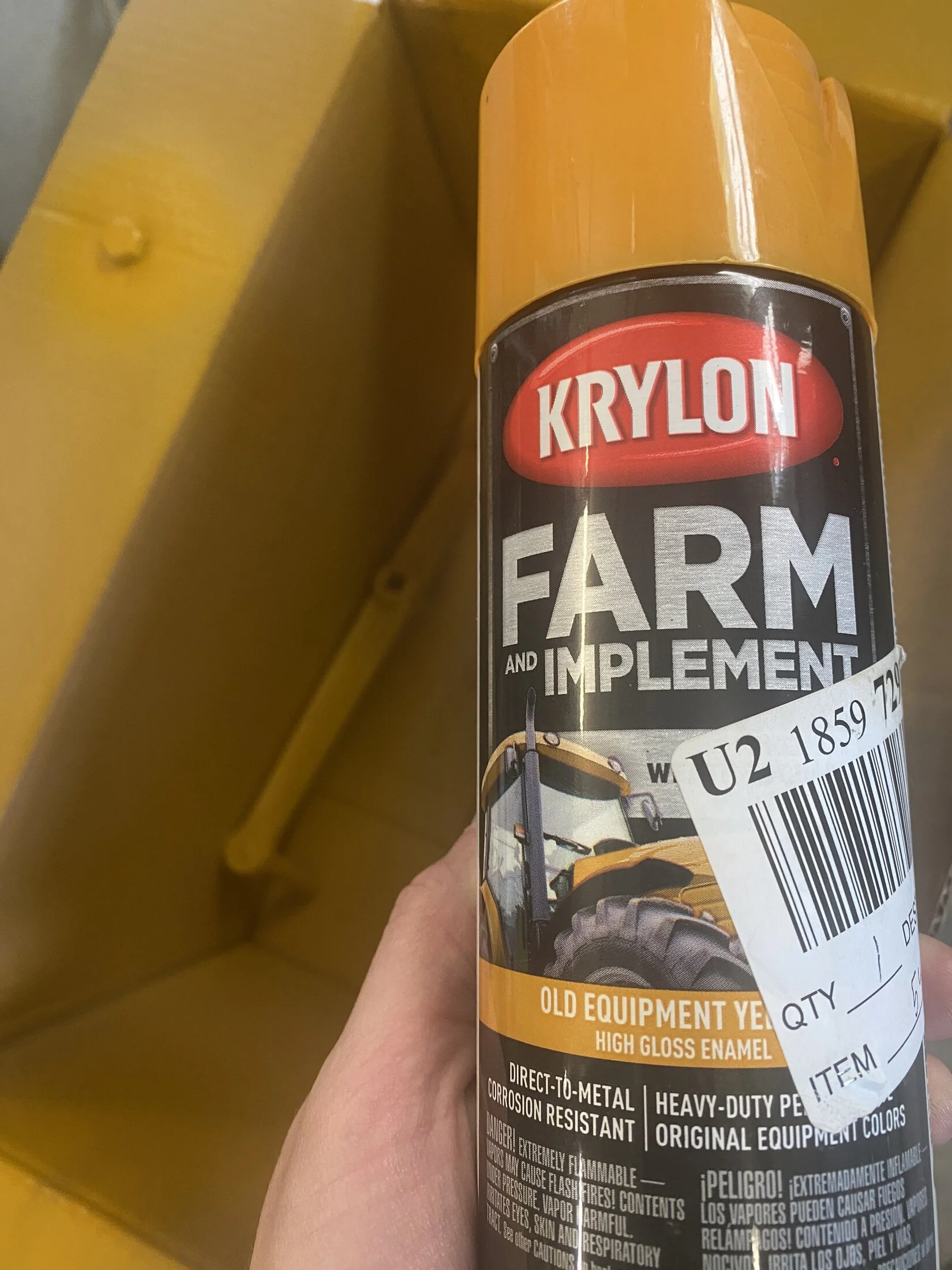

Painted the jack extensions, handle and jack (still in progress). I used Krylon Farm and Implement Old Equipment Yellow as advised on Mud. The picture makes it look brighter than it is, although the cap of the paint isn’t representative of the color I don’t think. I also took some felt with adhesive (from a Velcro pack I had) and put it on the brackets so they won’t get scratched coming in and out. Worked very well! I’ll do that on the jack bracket as well.

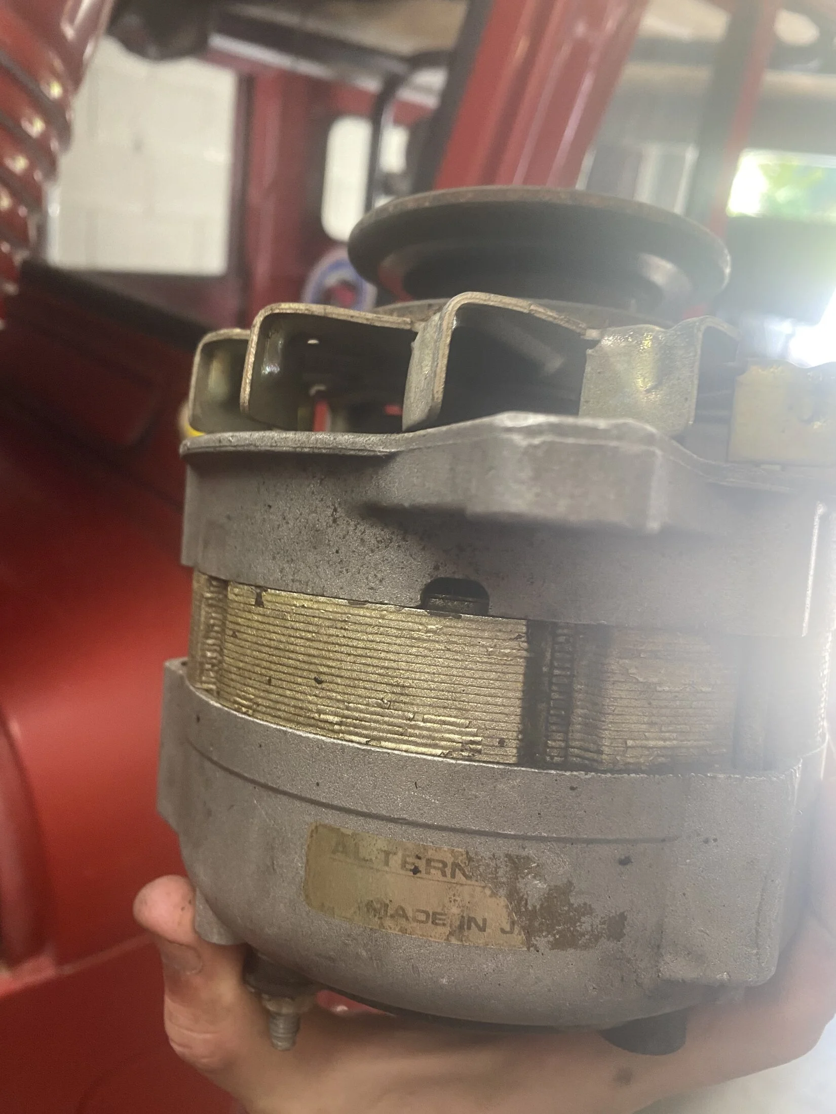

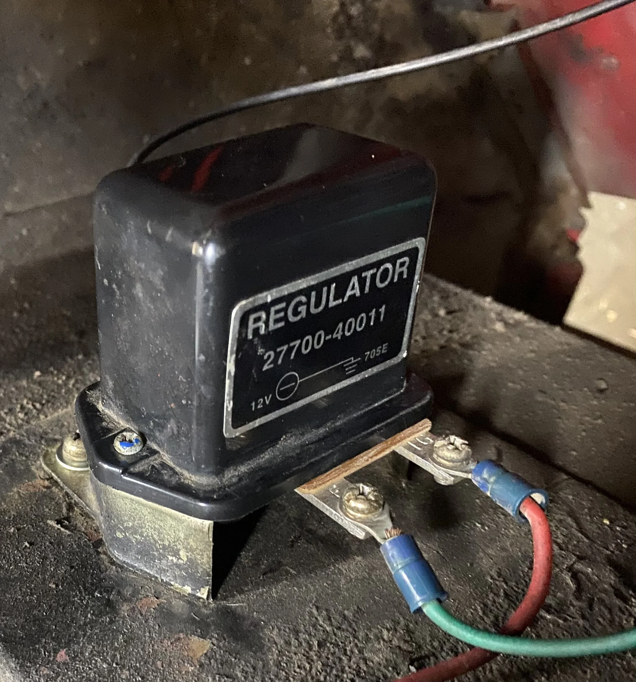

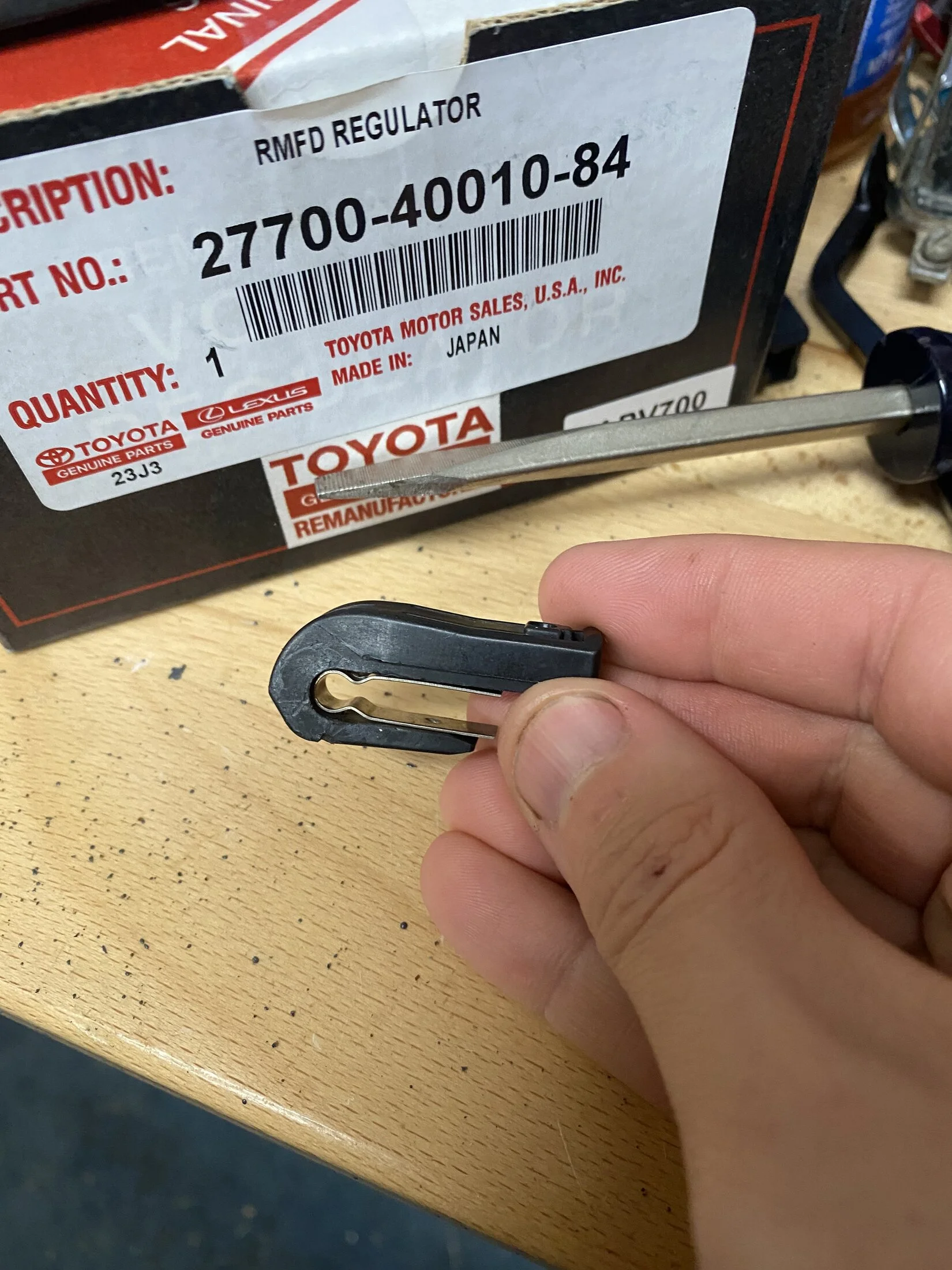

I also swapped out my VR with a reman from Toyota due to my previous alternator quest that ended up being an unhooked up VR. My voltage went from 16.5v to 15-ish..so feel good about the change. Although the parts numbers were different, the red label (27700-40010) was the correct replacement for the black one (27700-4011) and I verified on Toyota parts.
