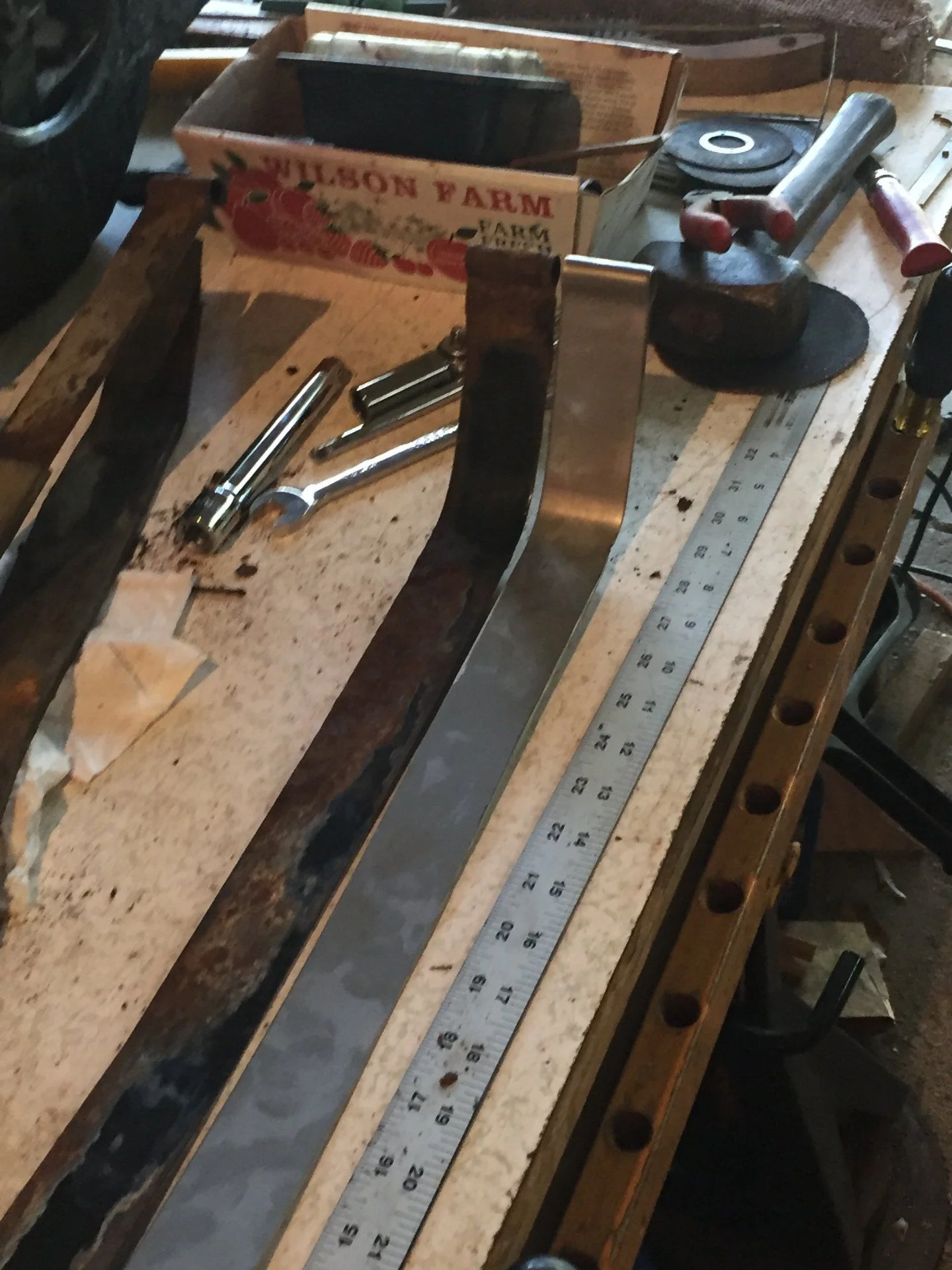

Cut out the tailgate and installing ambulance doors. starting to fabricate swing out spare tire carrier today
