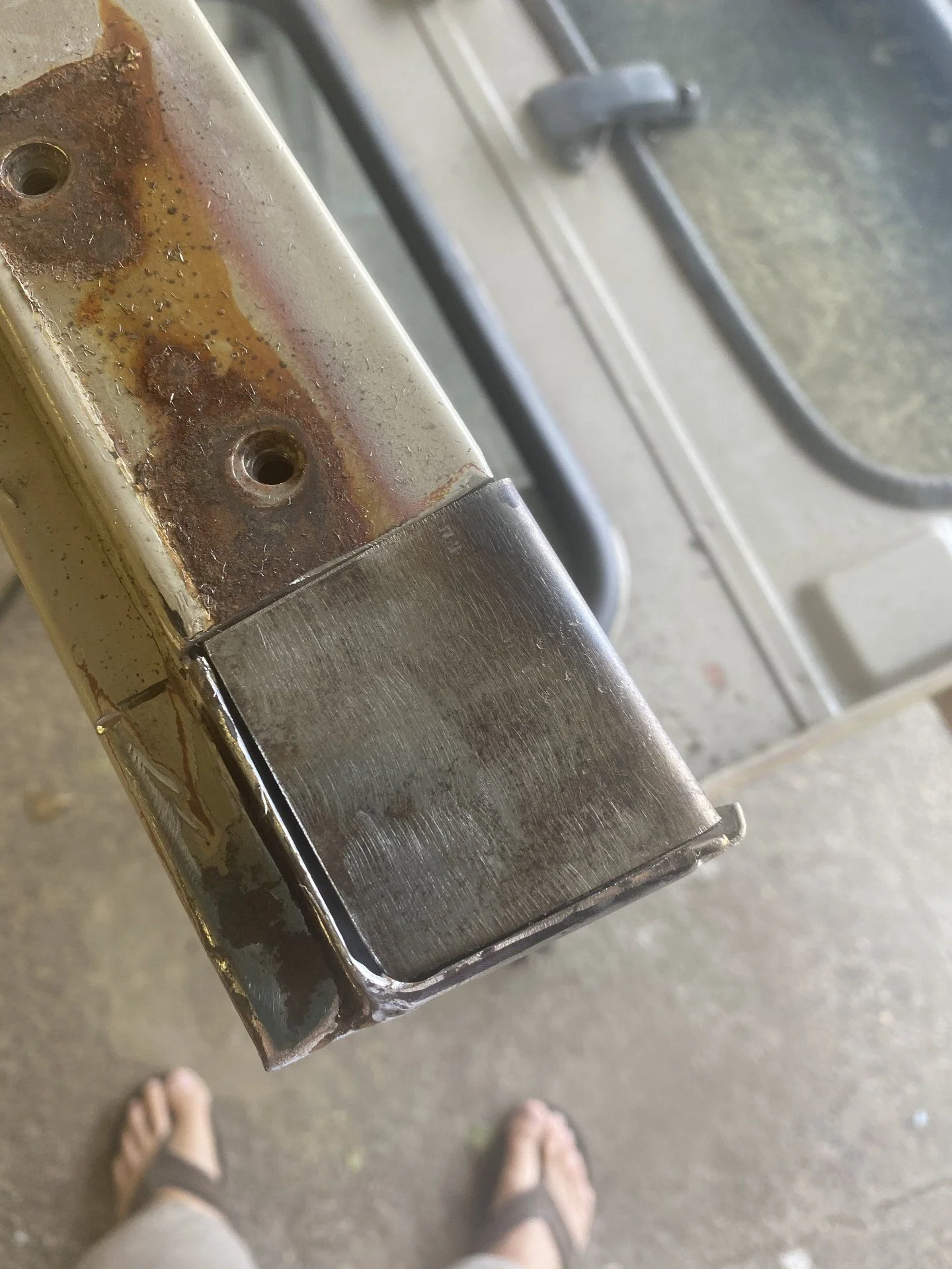

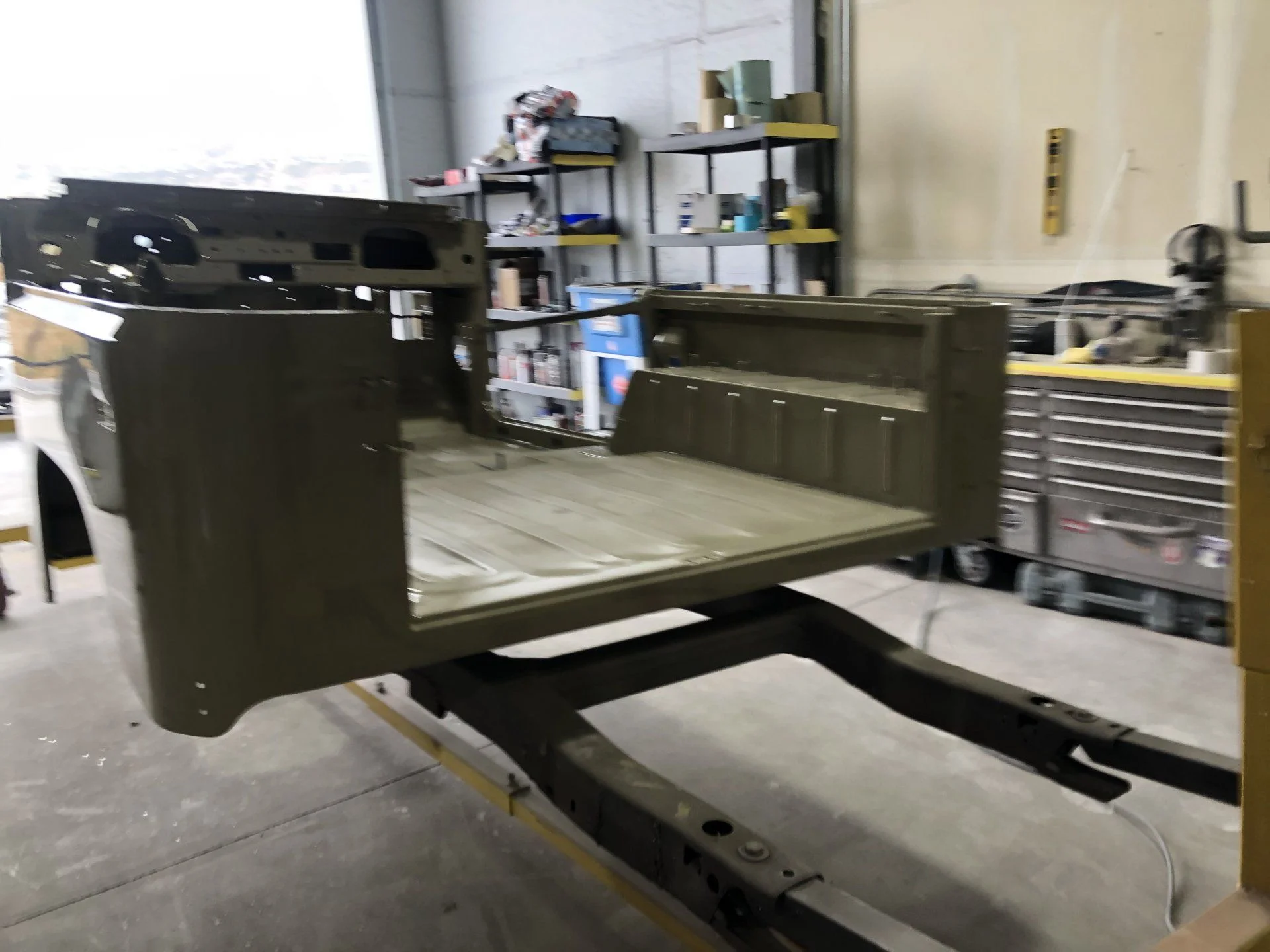

Did some rust/bondo removal on the top this week.

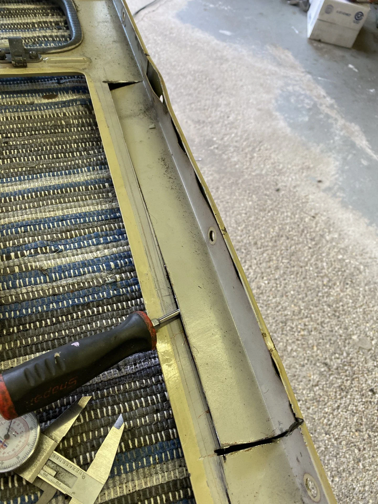

I've been using a Harbour Freight Titanium Flux 125 welder. It's an inverter welder and it works pretty good on thicker metals. Since it is flux core, it burns a bit too hot for sheet metal. It's working, but I wouldn't do this again without gas. Notice the porosity. This was caused by fighting the slag buildup while trying to fill where it burnt through.
Now just need to figure out how to fix the impact on the side. Not sure how to proceed without making a complete mess of things. Any suggestions welcome.

You can try to force It in its position and hammer and dolly the 90degree part. If you force it in the correct position you can shrink the top portion that way.

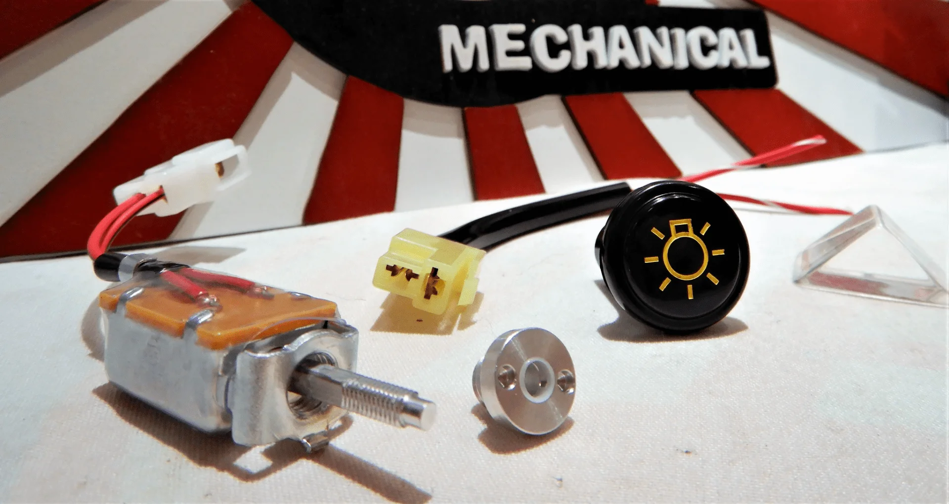

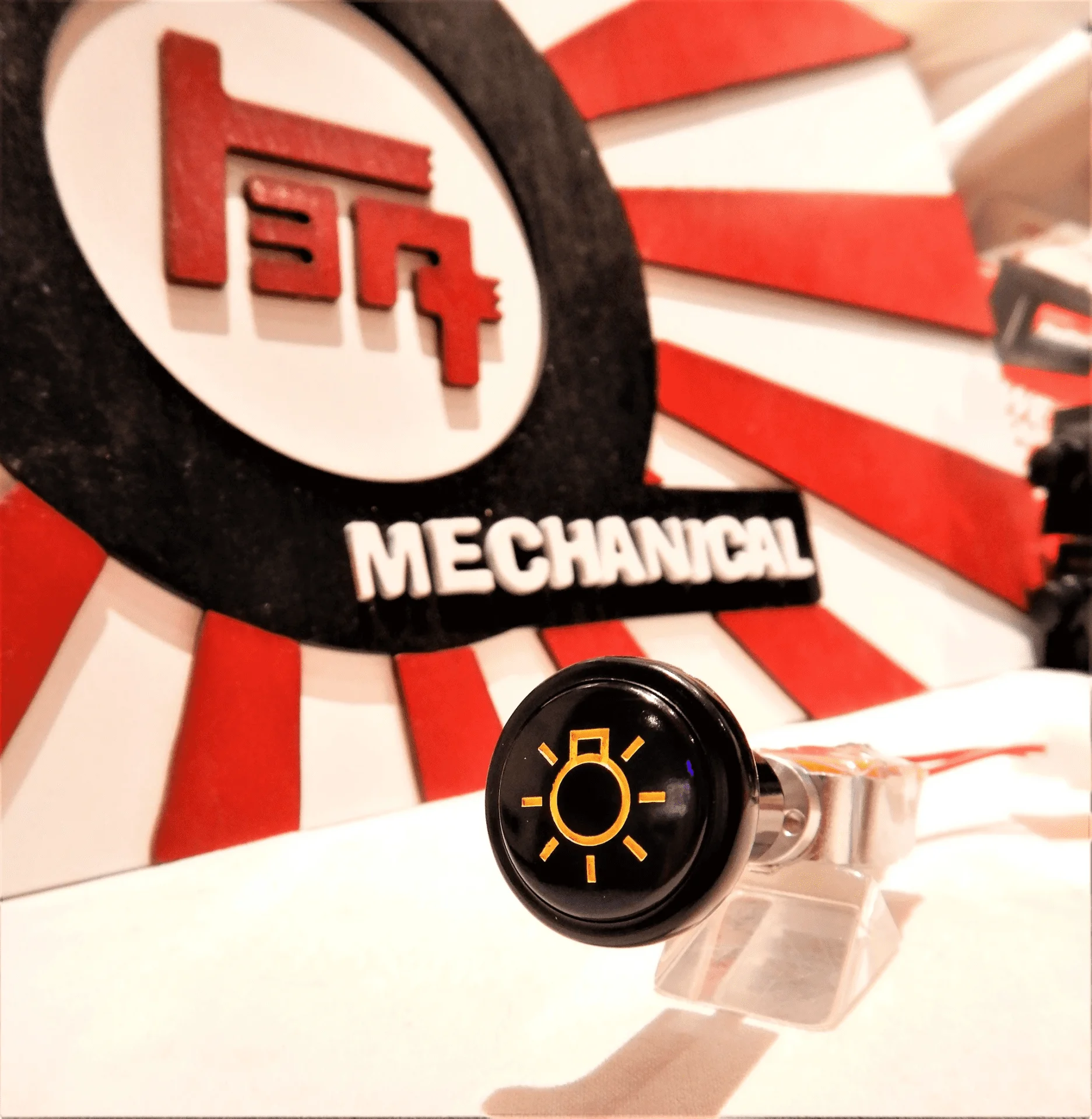

- Also , my newest addition to the line up my SEMA type inspired Amber JDM yellow AUX or Ditch Lamps Knobs , 💯 % Toyota genuine parts modified with the. Highest quality Pigment on the market today .... uv rated is only the beginning of this Sauce ..
Then my New AUX / Ditch Lamps full Switch assy. It's a modern and fresh concept vision with a purist based mind set approach...

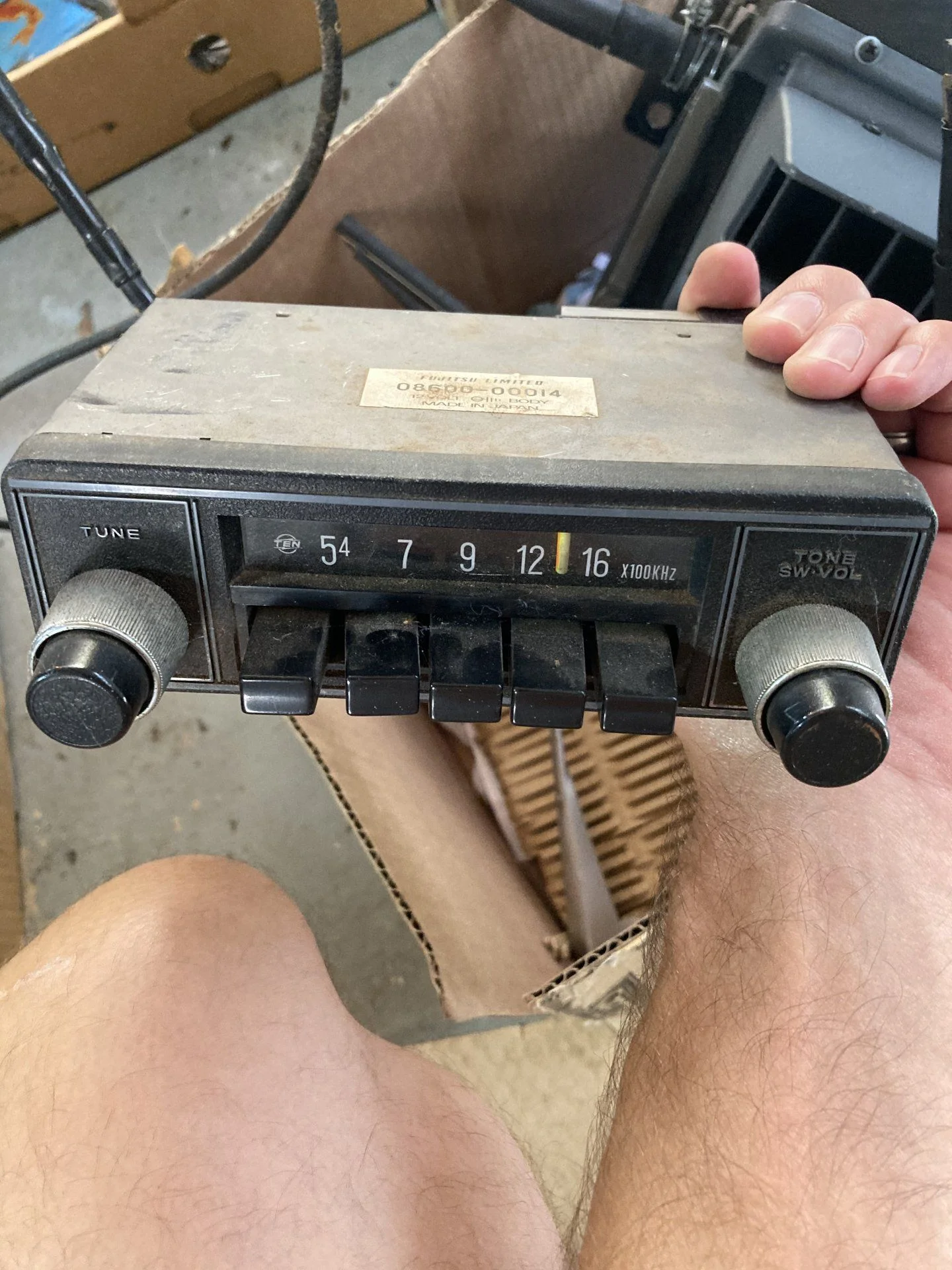

Finished bringing this back to life. I straightened the push buttons, cleaned the volume control, painted the pointer, cleaned and lubricated the tuning mechanism, replaced all electrolytic capacitors with US or Japan sourced components, and cleaned it up a little. Installed an led from @ToyotaMatt.
before (@cims1970fj40):
after
after
It looks great! Thanks you so much Russ for your time and willingness to make this happen. What great service you provide and the excellent detail you put into it. I would recommend anyone that needs there radio service to contact you.
Thanks again,
Cimarron

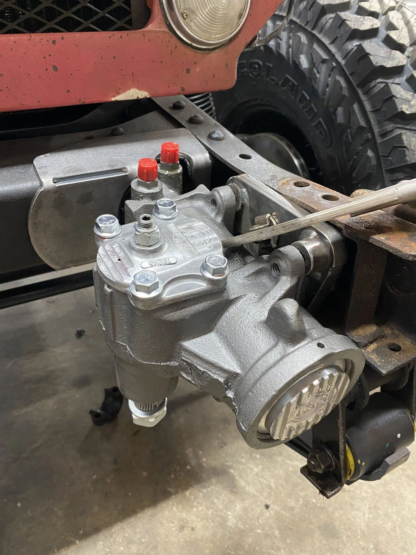

Started in on my AGR Saginaw power steering conversion on my 1967 FJ45
Whats different about the AGR units? Does something make them "better" or are they just a solid rebuilder? I'm sure google would answer this for me but first hand experience is much appreciated.

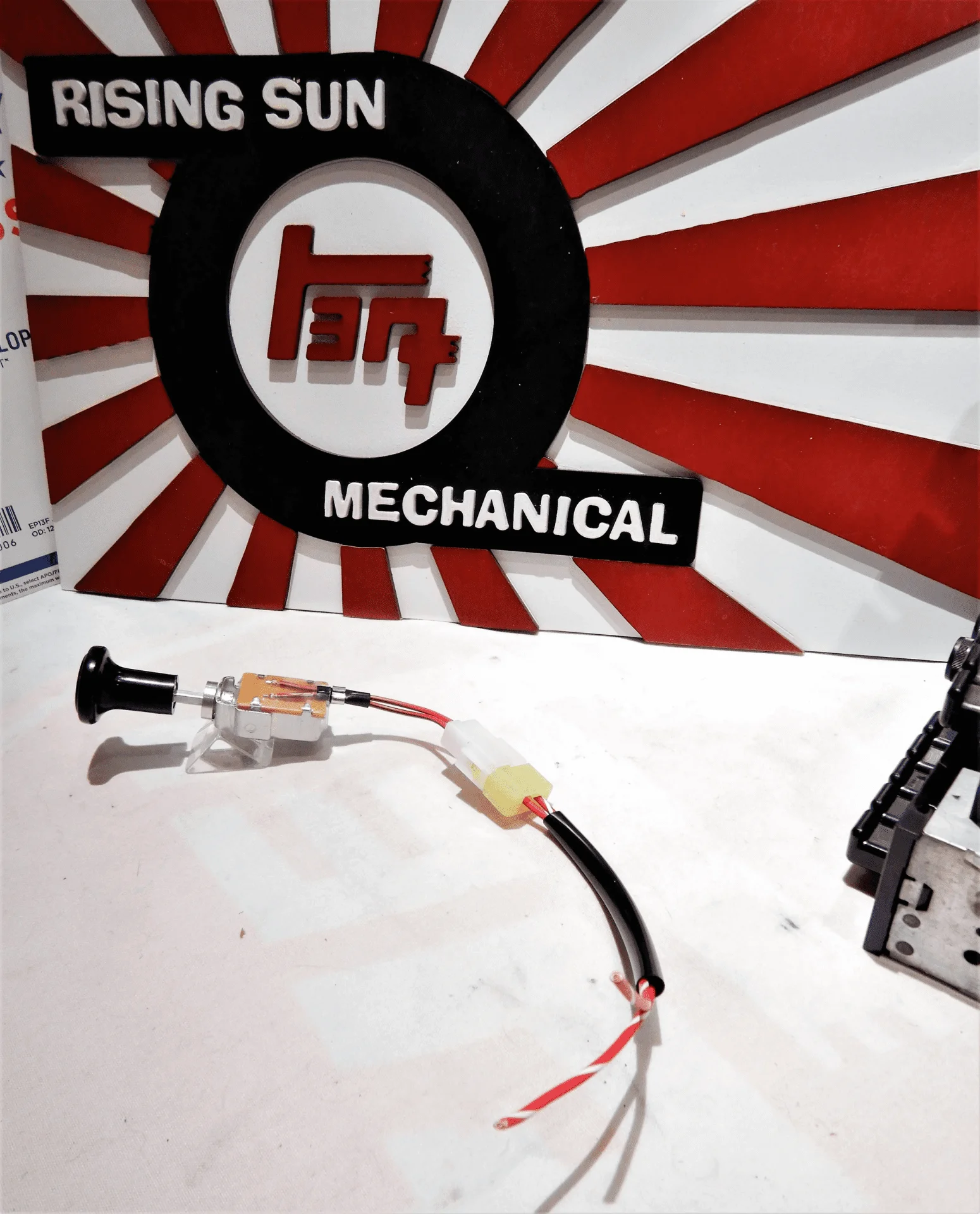

Thank you for my new hazard switch, it looks perfect!!

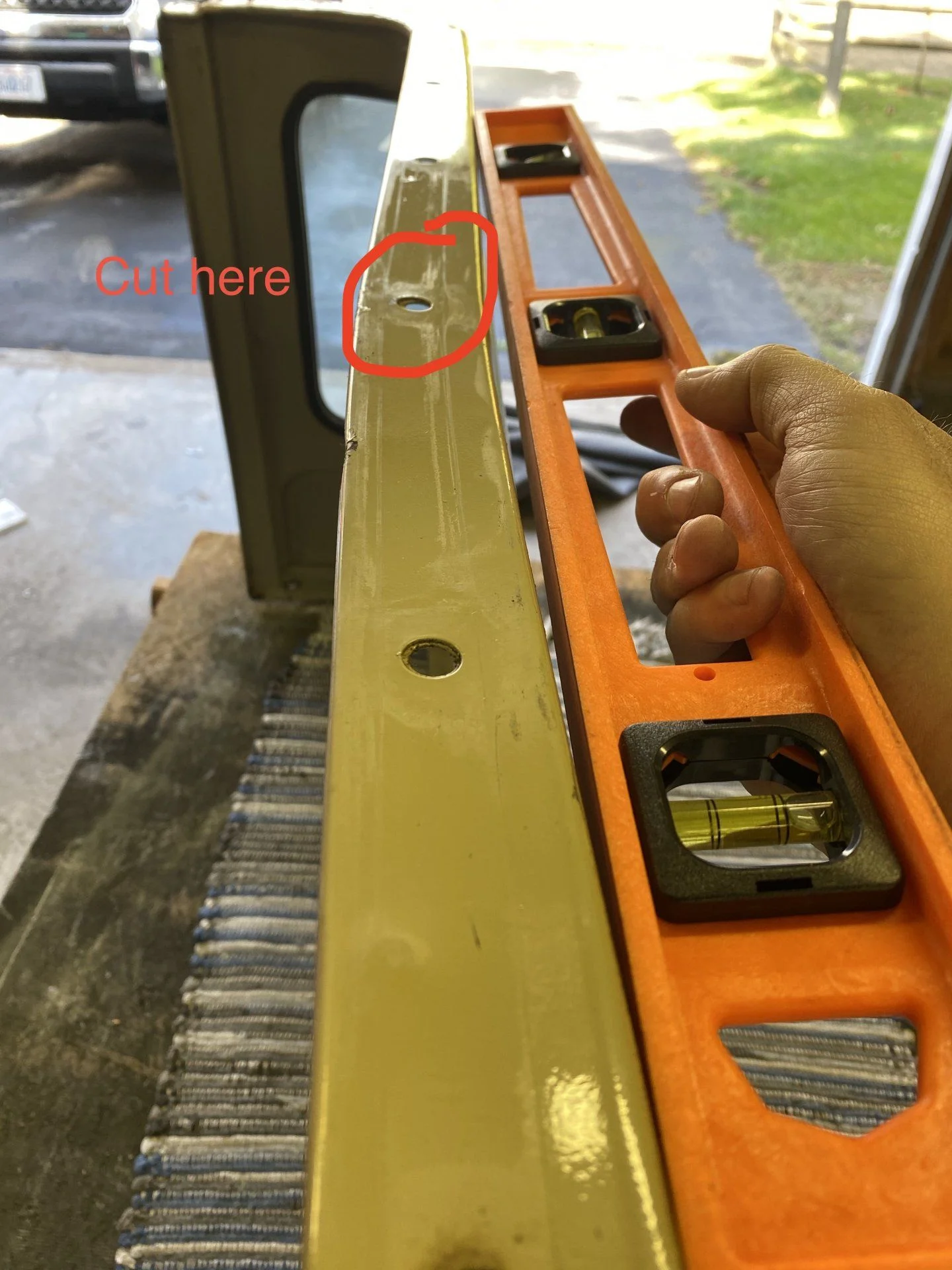

I decided to cut a section out of the inner support and make some relief cuts to the top. Then I am going to use angle iron to clamp it straight and stitch the cuts that I made.
That works too but the downside of that is that you get the bends at the cut points where with hammering it would have been evenly spread where the metal needed the shrinking. Plus the added heat of the welding requires planishing with hammer and dolly.
