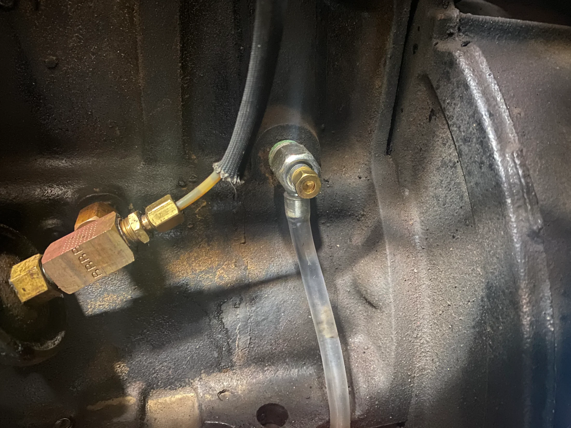

Drained the block and radiator as I filled it up with water after replacing the radiator/hoses/rebuilt water pump and put in pink coolant so now everything in my driveway uses the same type. By the way, that block drain is worth its weight in gold. Zero mess.

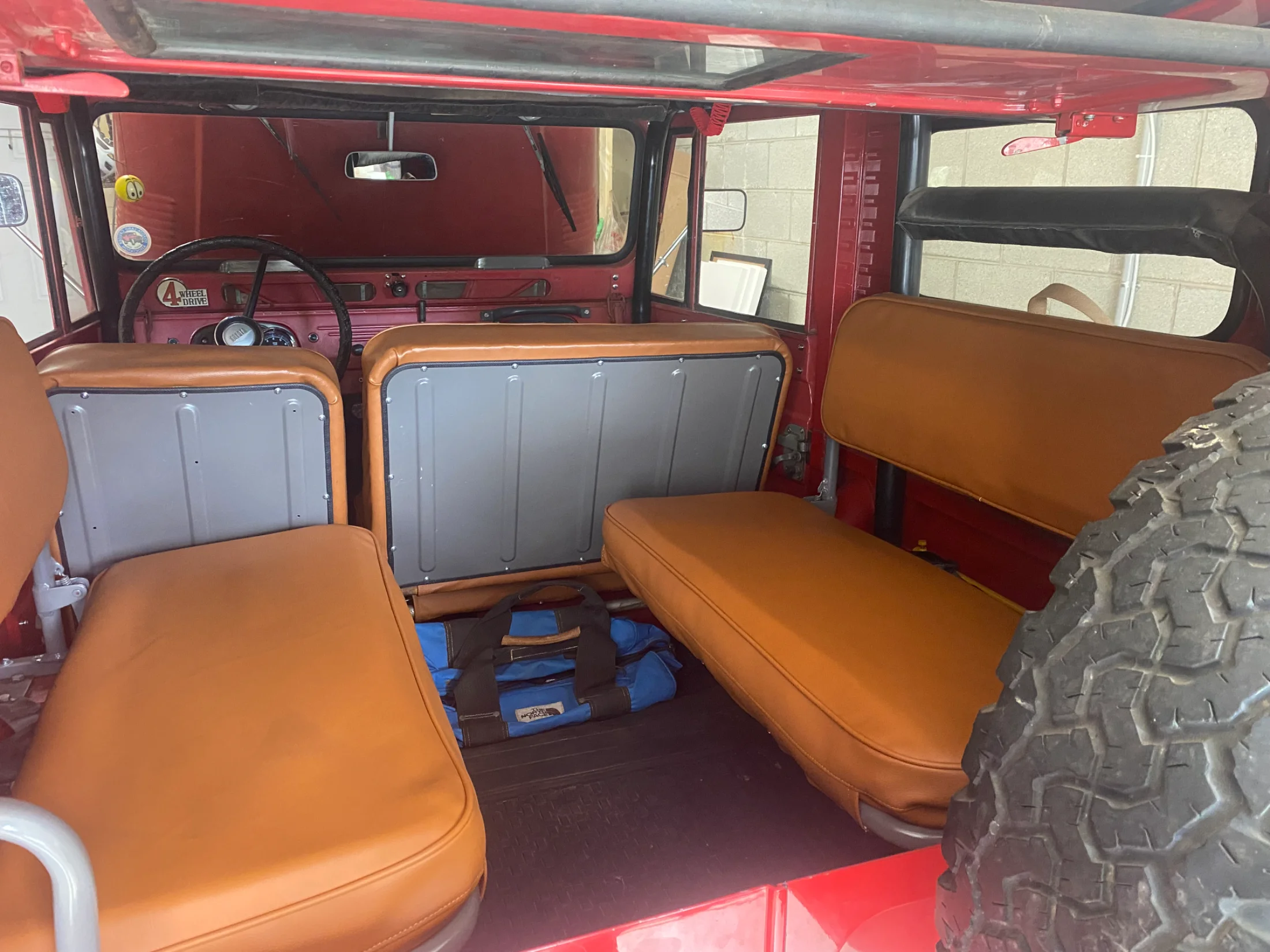

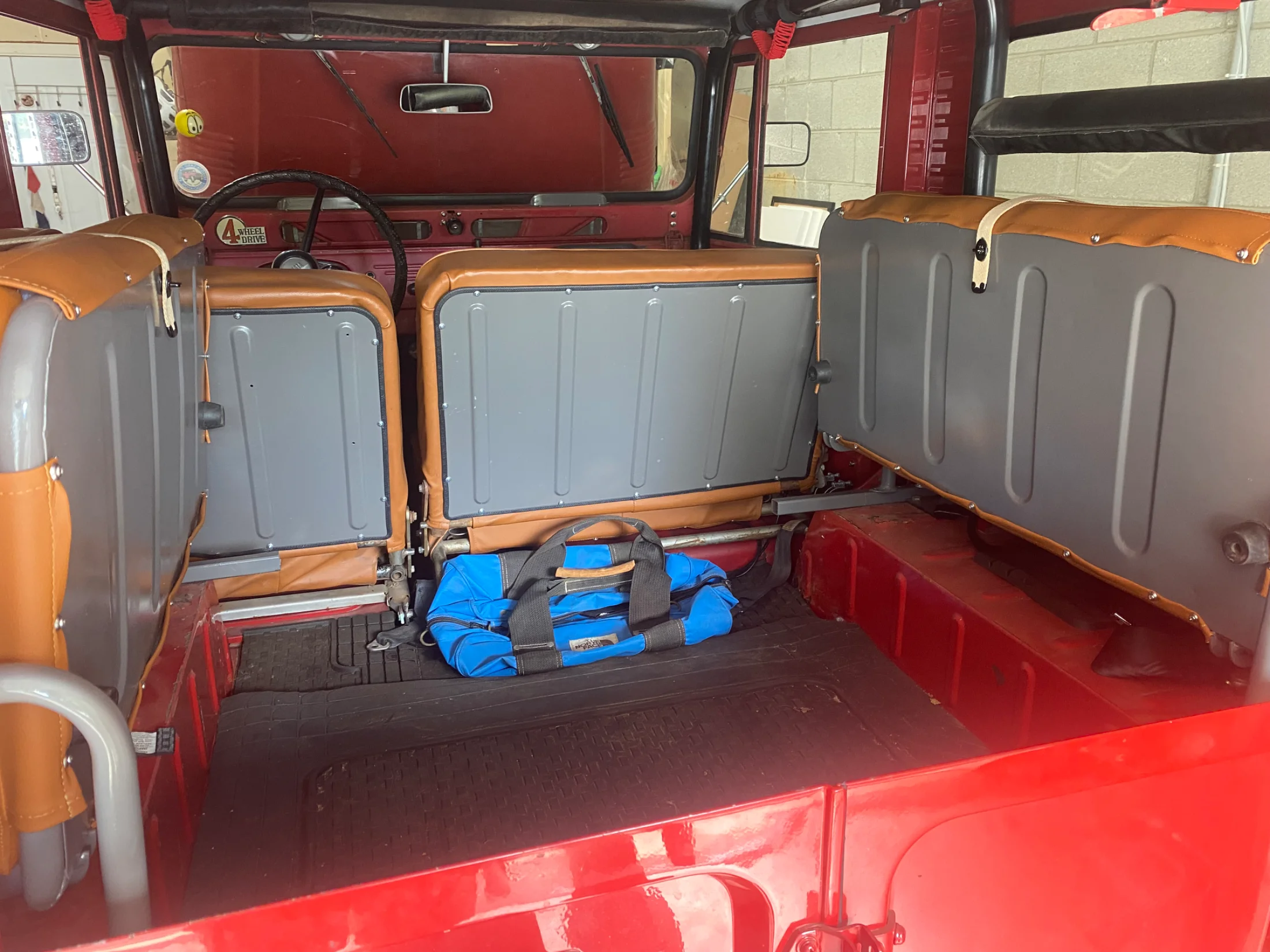

Also finally got the rear seat covers in. 4” of seat foam and some poly fill to round the edges. Could have spend a little more time, but whatevs.

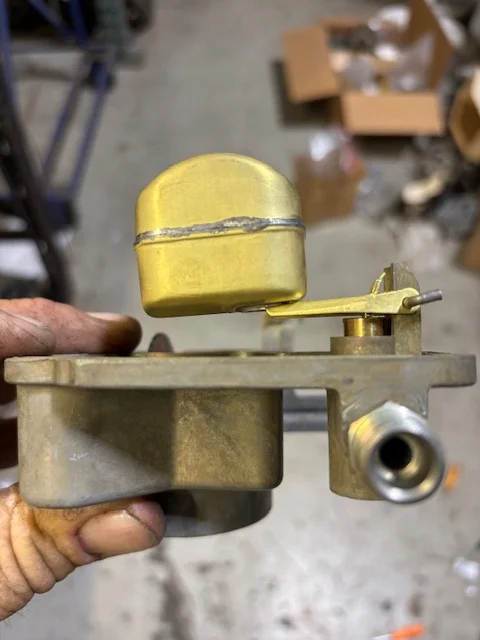

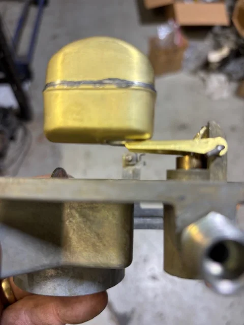

I didn't feel like making a separate thread for this, but I did want to document an unusual problem with a carburetor.
Customer already had the carburetor rebuilt elsewhere, and got a new float in the process. Sent the carburetor to me because they couldn't stop it from flooding. Teardown wasn't unusual, except for the fact that the supposedly rebuilt carburetor still had the original gasket between the fuel bowl and throttle body, as well as a few other signs that it was not a full rebuild.
When I turned the air horn over, it seemed like the float level was high (float closer than normal to the underside of the airhorn) but the mechanic's note said fuel was at the level indicated by the sight glass. I was given to understand that the rebuild kit was new, and the needle/seat assembly sure looked it.
When I unscrewed the seat from the airhorn I discovered that there was no washer! Well, that certainly could contribute to a flooding problem. But I kind of doubted it. I decided to compare the new parts to some old ones that I have onhand. Diameter, check. Height, check. Fuel oriface, WHAT? Yes, the hole in the replacement seat was larger, by at least 25%! While that would definitely help get more fuel in the carb, it would also cause the needle to drop deeper into the seat, which would affect the float adjustment substantially. 🤔 Not only that, it could (and probably did) cause the arm of the float to hit the side of the seat before it had sufficient pressure on the needle to hold the passage closed. A sly little bit of detective work.😉
I put a stock seat in. First pic: float level as it came to me. Second pic: float level with a stock seat with the correct oriface. Lesson: check EVERY component in your rebuild kit thoroughly.
View attachment 3993052View attachment 3993053
Love these tips!!! Thanks for taking the time to do these!
