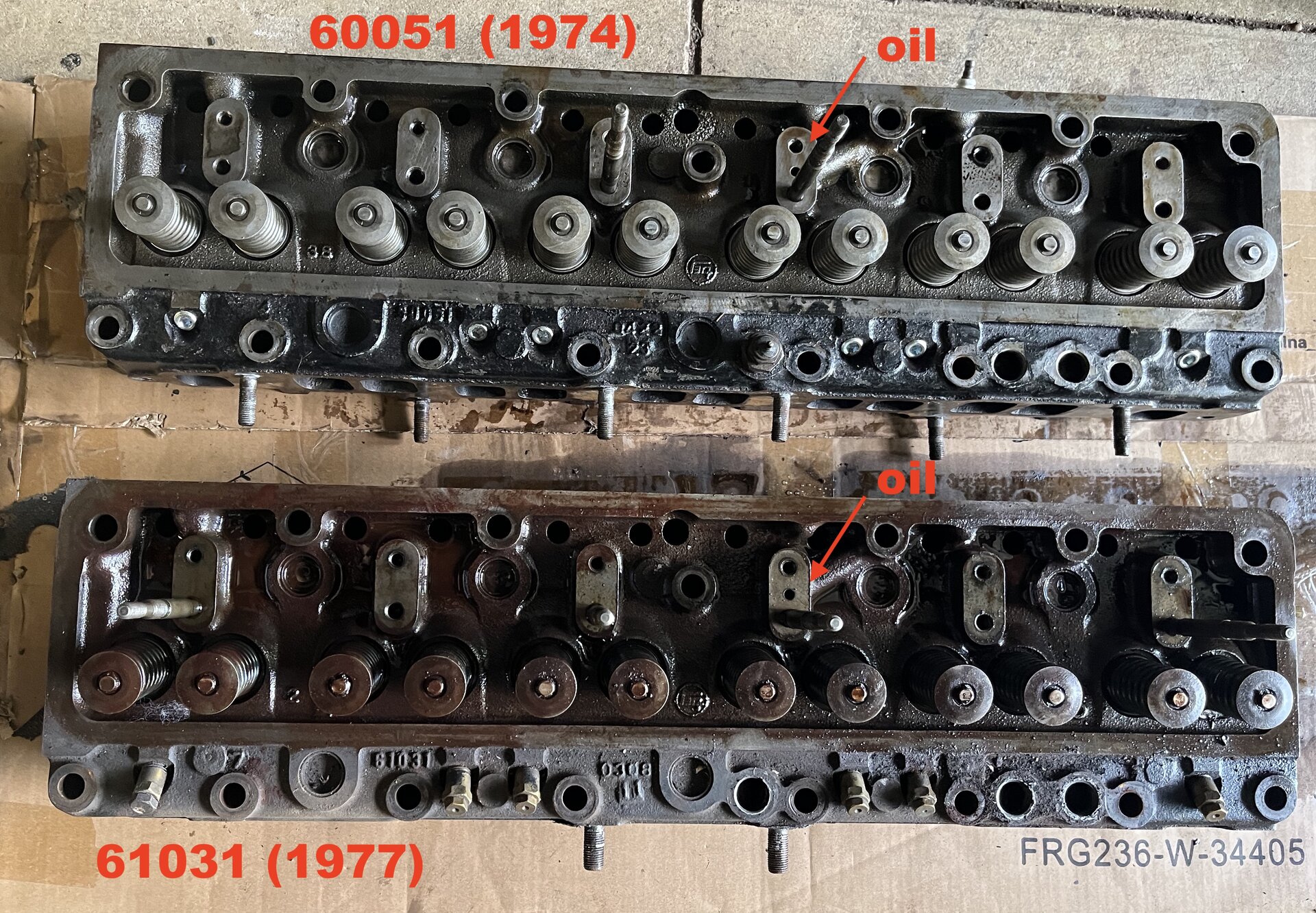

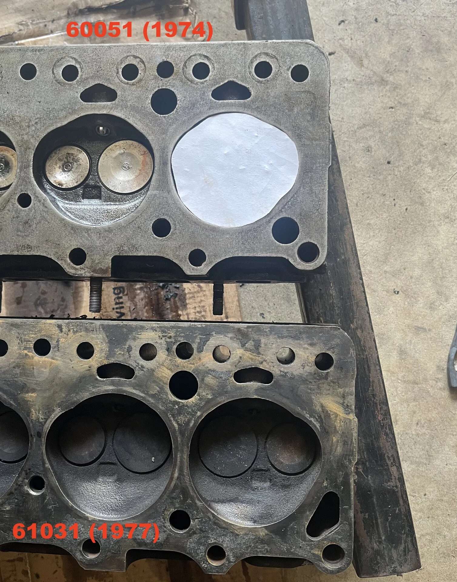

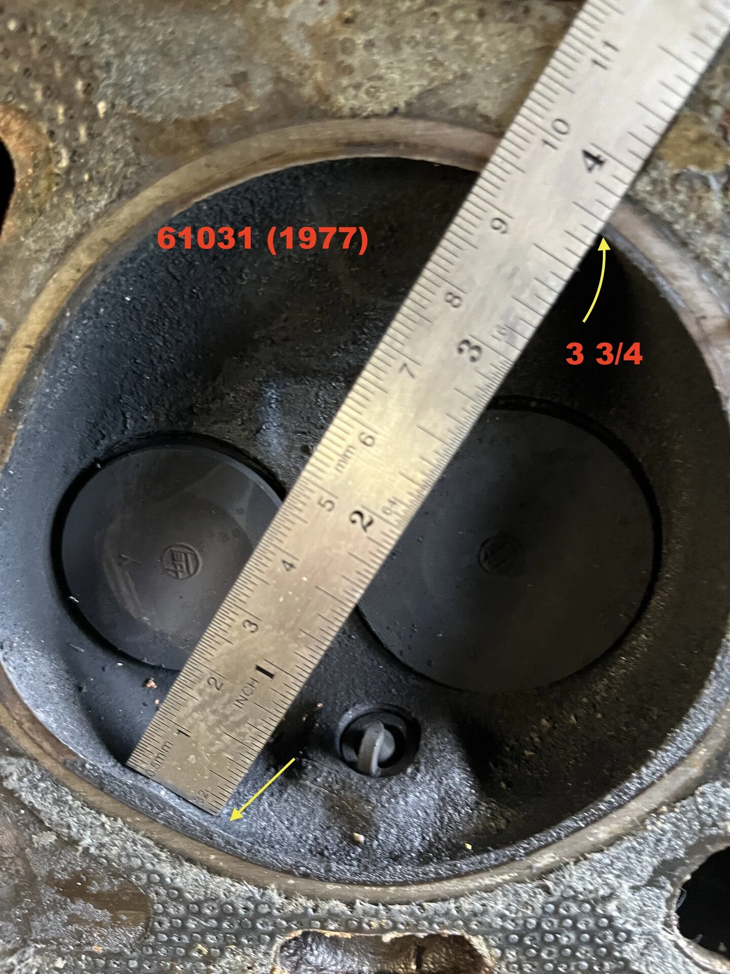

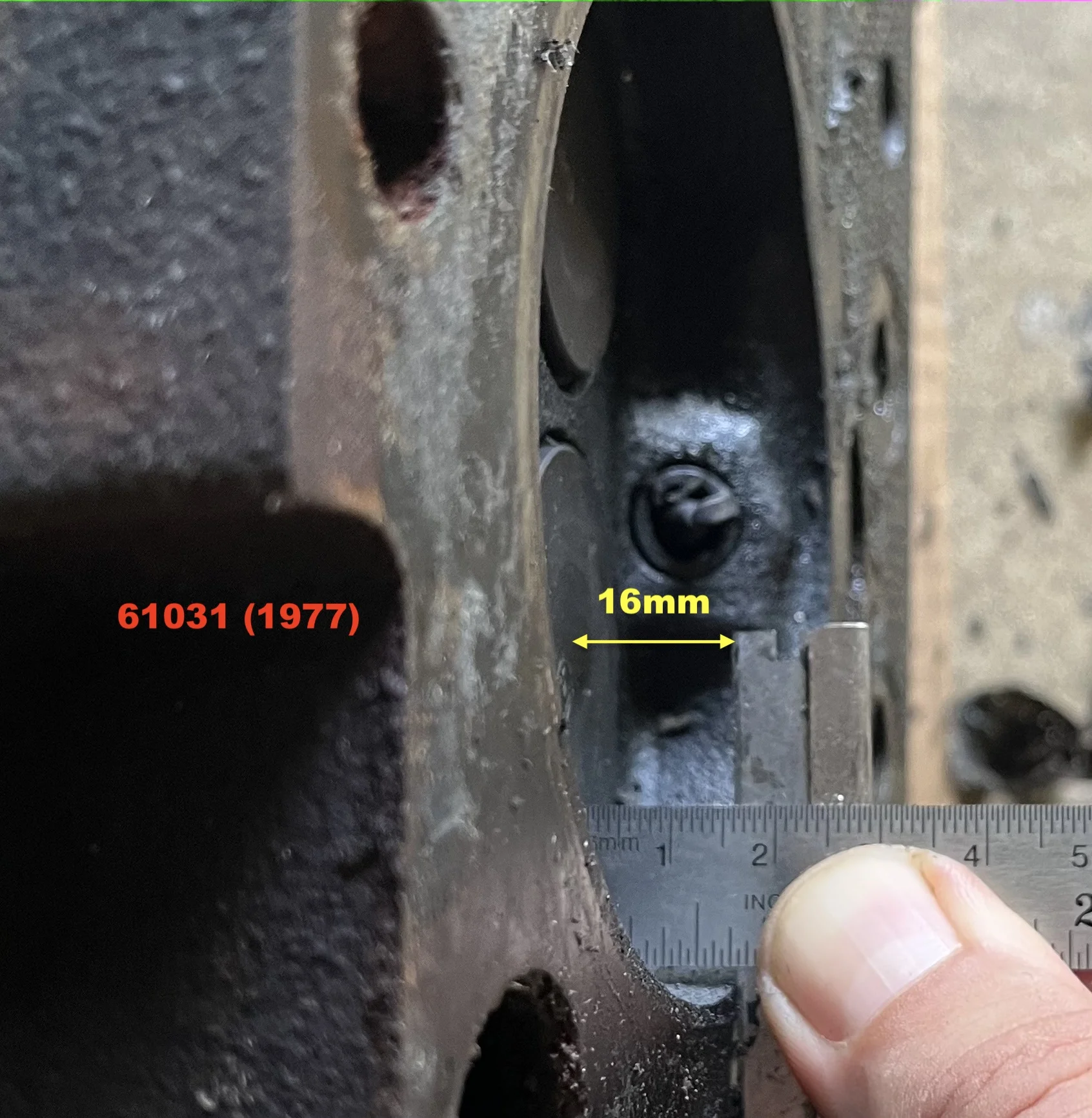

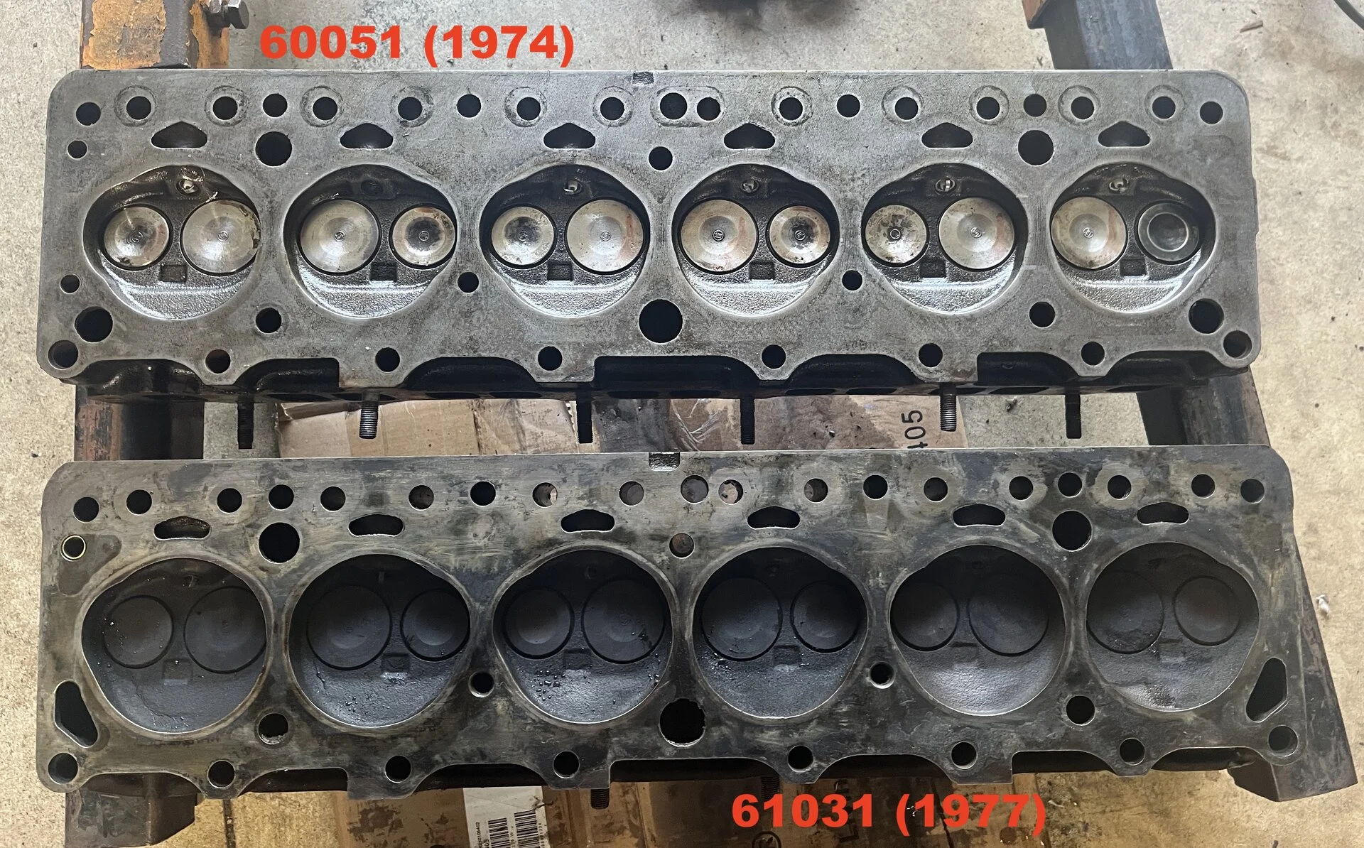

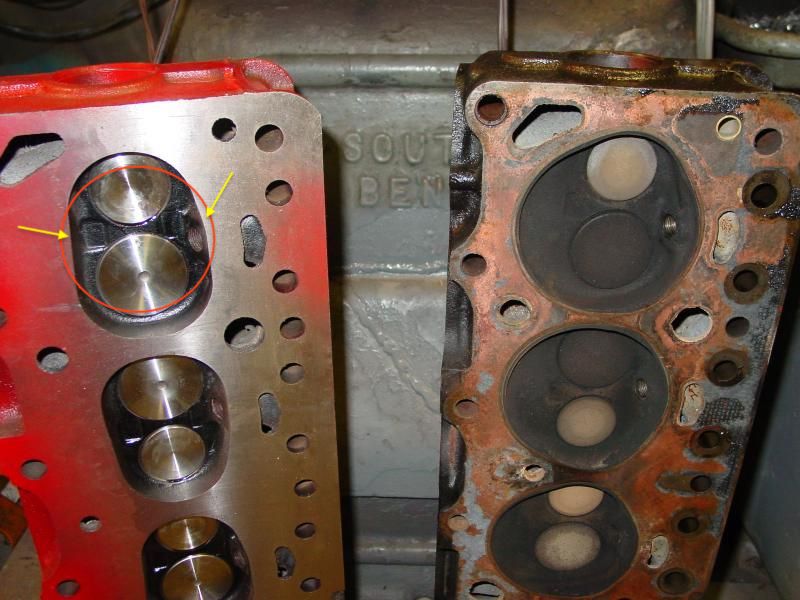

I have two heads: 60051 (1974) and 61031 (1977)
I have read many threads here, but not many really had comparisons between F.5 and F2 heads. Especially with the pictures.

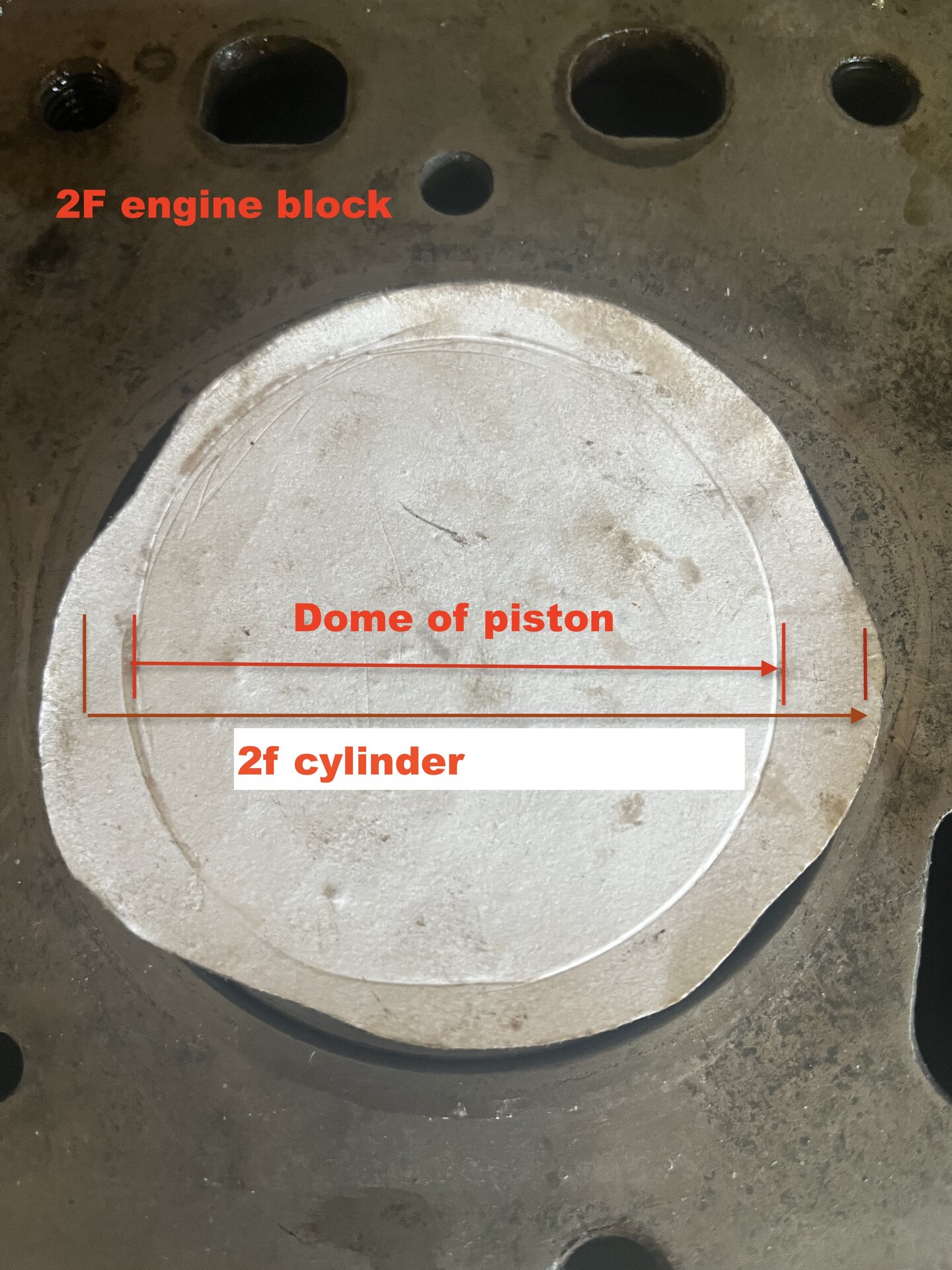

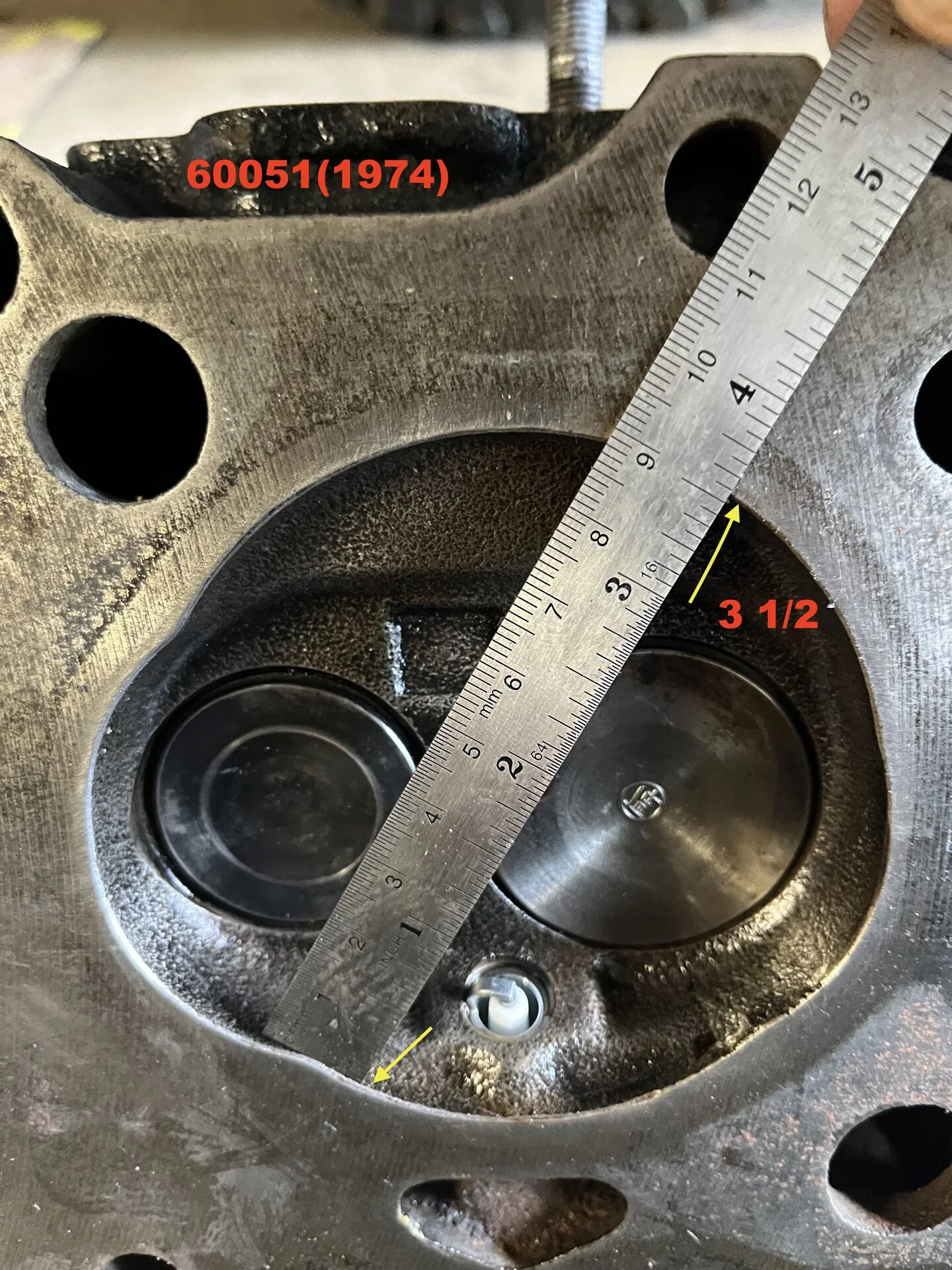

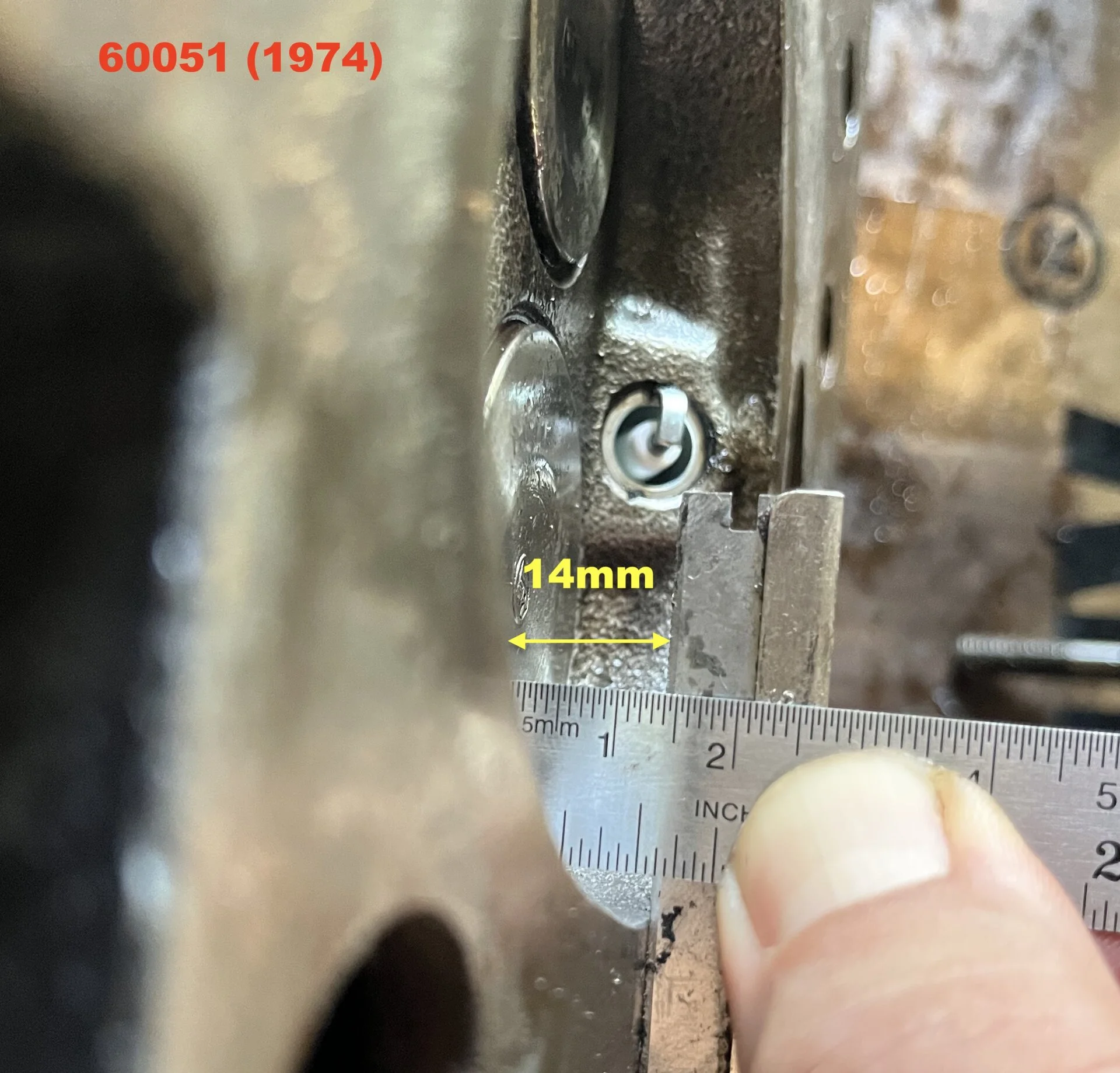

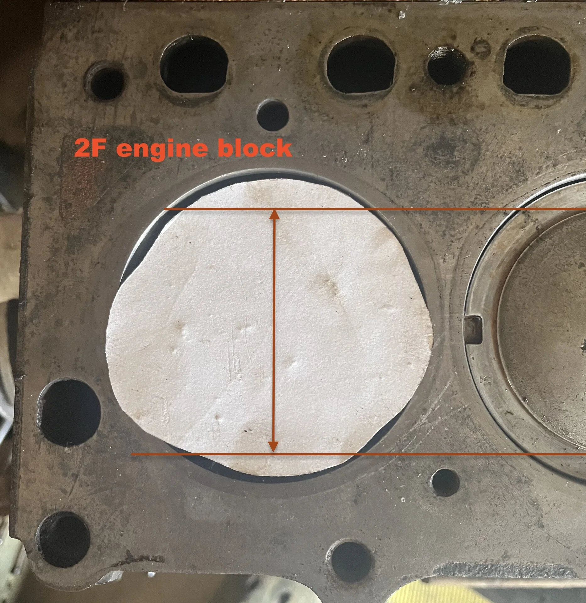

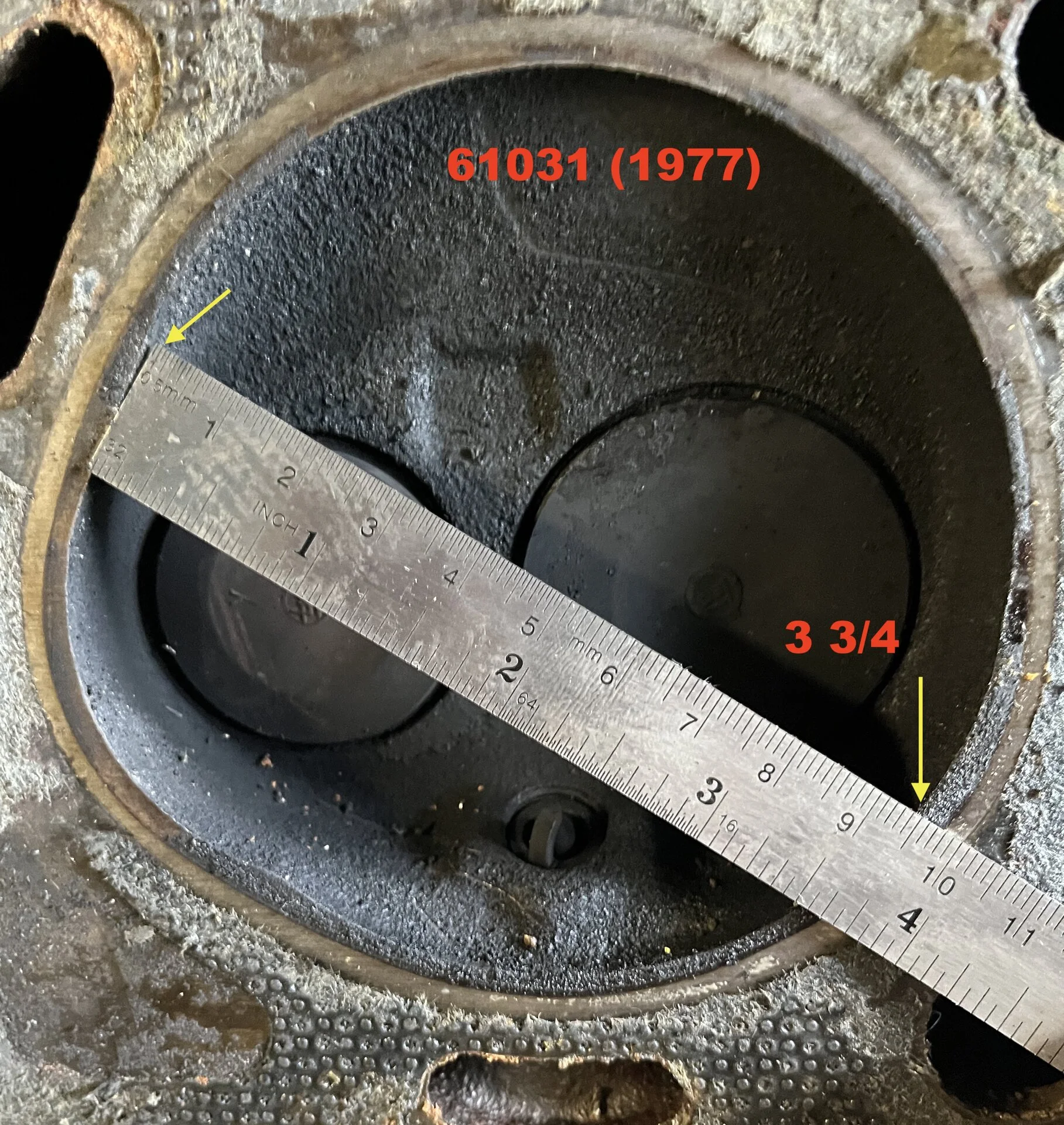

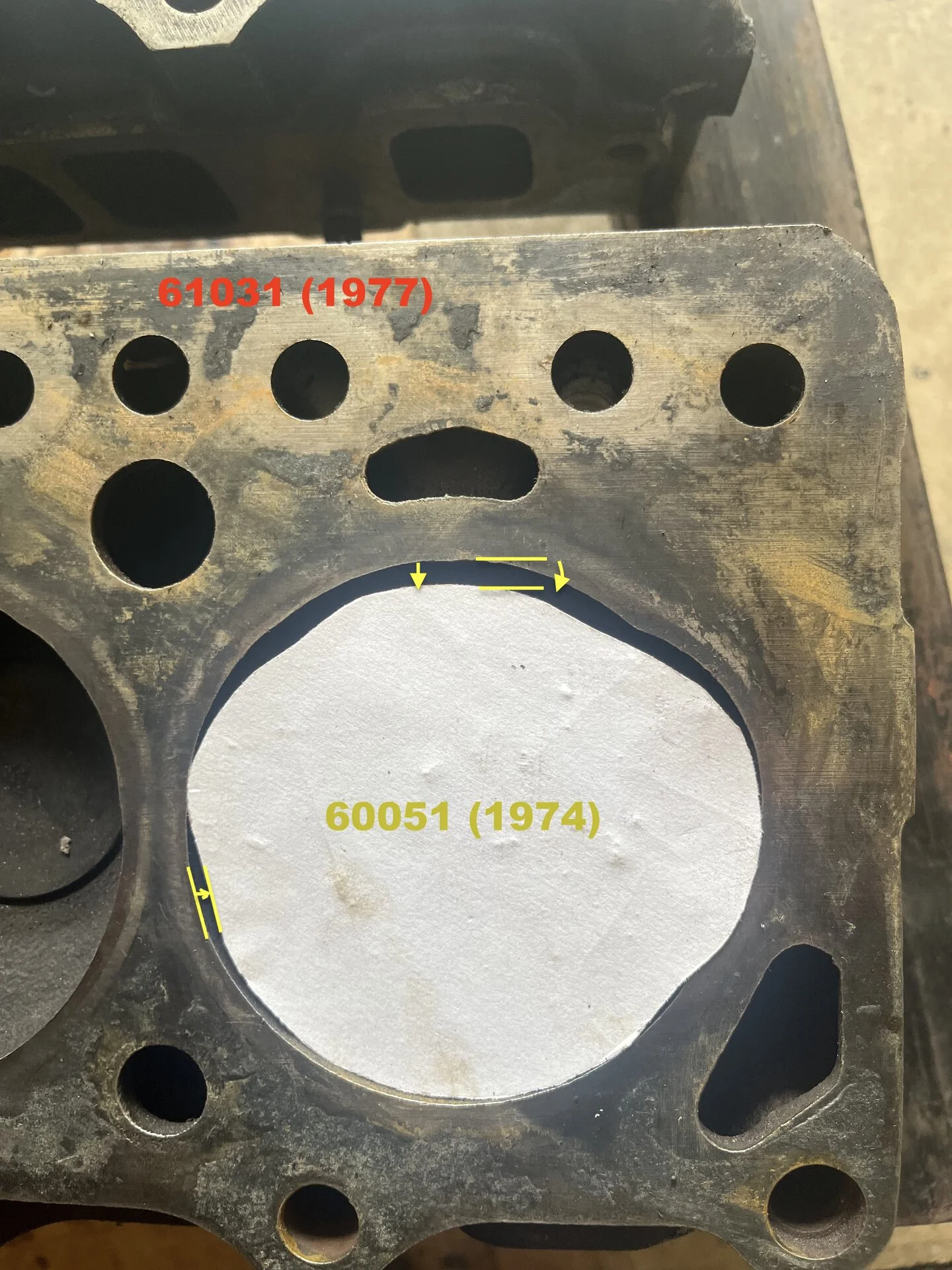

I try my best to summarize some information here. All my measurements are not 100% accurate, but give some idea of the size.
Just may be useful for anyone who thinking to replace the head from 2f to f.5 to increase compression.

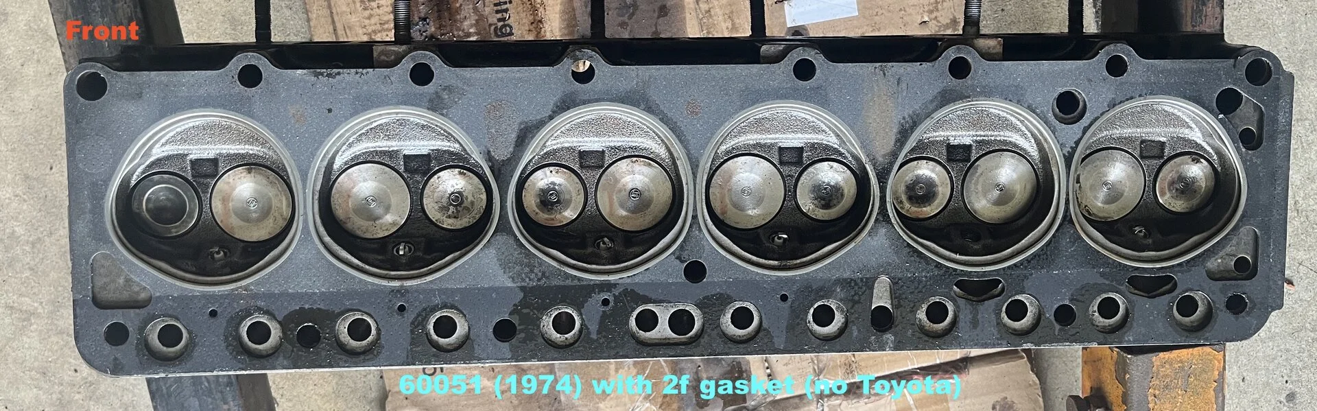

Head: f.5 (1974) model year (60051)
Block: 2f with the dome top pistons.
Head gasket: 2F

As an aside, I've got sorta the same thing. '74 1.5F head on an early 2F block. Had some pinging issues at first, corrected with timing and octane adjustments.

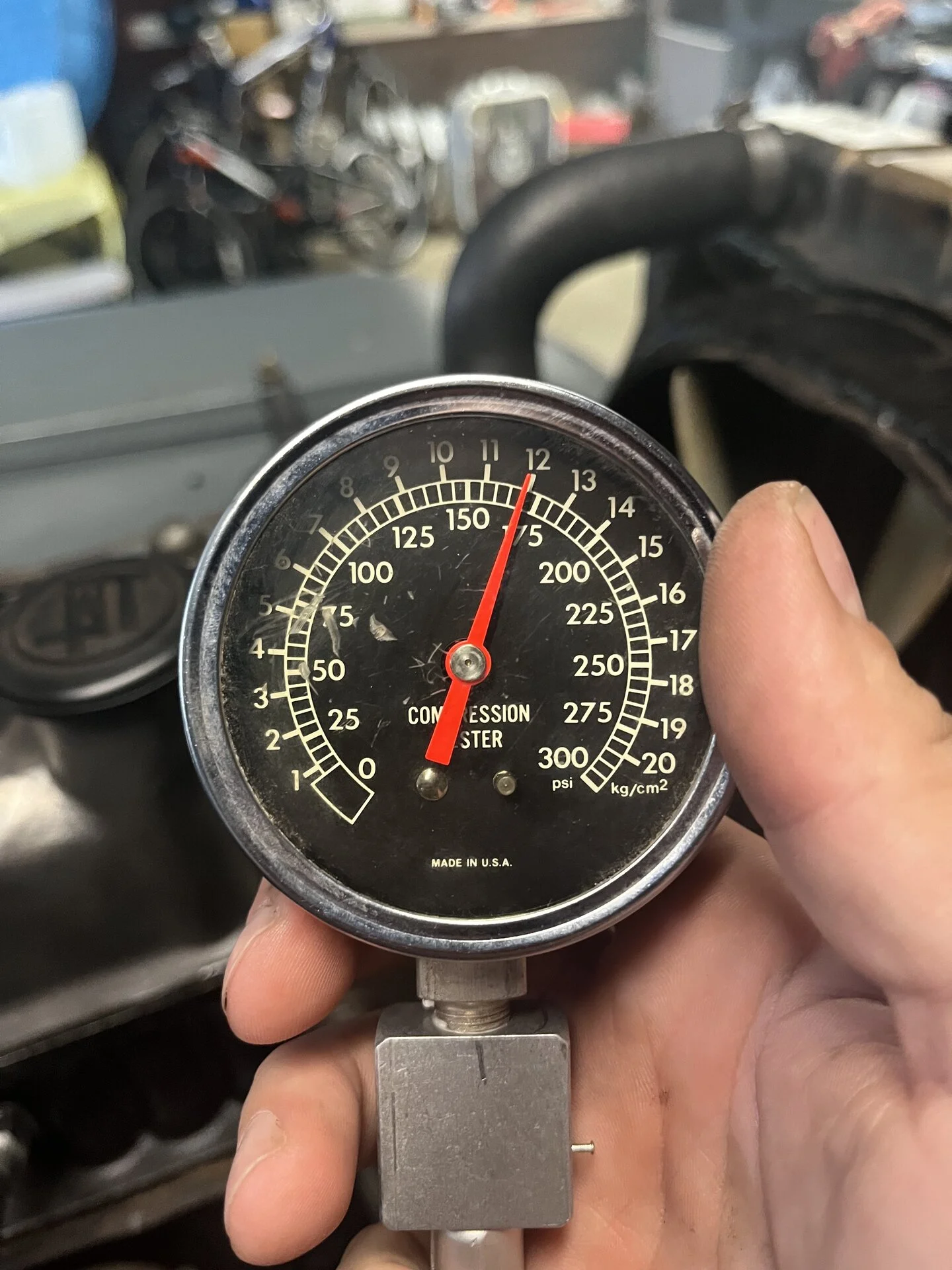

Ran this combination in the FJ40. Fresh rebuilt '85 2F block with domed pistons, and '74 F head. Compression was 195 psi and I had to run premium, but it was a strong pulling 2F.

I believe '74 F head has only an open chamber head.

Just make sure your domed piston doesn't hit the head.

Any problems with piston interference? As late ,61040, 2F motors were closed chamber, why switch to an earlier head? Was that 74 head open or closes configuration?

I did this ca. 25 years ago and don't have the head number anymore. As I recall the head was from a '74 so the later F with oiling. This was a combination that @Mark W had discussed on the old Land Cruiser Mailing List. Since I was rebuilding a 2F I decided to try it out to boost the hp of the 2F. I don't recall any piston interference issues. I ran this combination for about a year until the head cracked. I then installed a '77 2F head and think that I would have noticed any piston damage at the time if there had been any.
