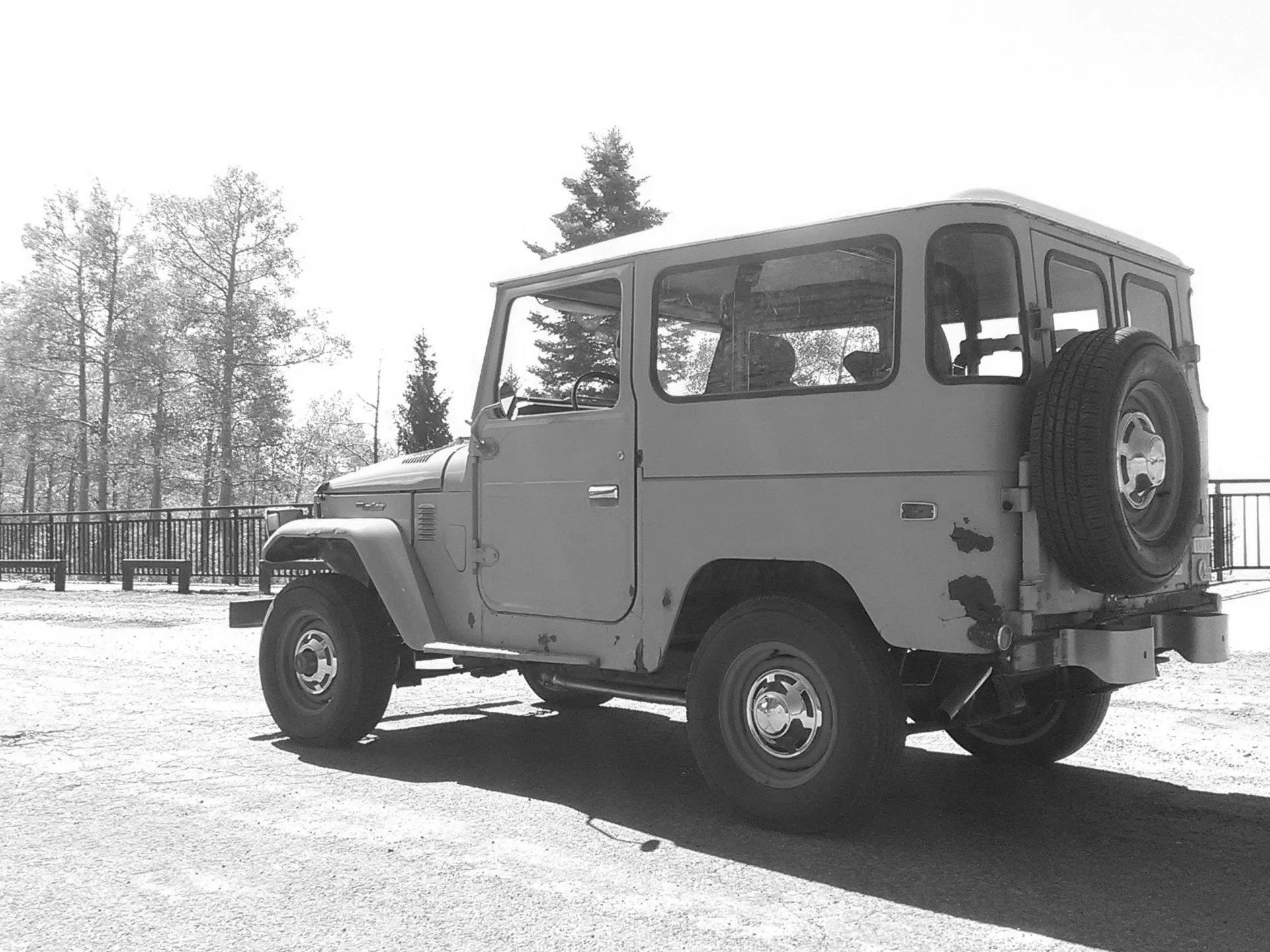

Starting to put it all back together...
They are old 33x9.5s on what appear to be 15x6 FJ60 rims powderpainted matte black. @HKforte would know the details: he gave them to me! :)
Looks great on your rig Mark! Yes, those are the old 33x9.5x15 BFG A/Ts on 15x6 FJ60 wheels. I lightly sanded/primed, and then rattle-canned a couple coats with Duplicolor Black Wheel paint followed by 2 light coats of the Duplicolor Wheel Clear Coat, 10+ years ago. This particular wheel paint holds up really nice! Those wheels got me to and from Mirror Lake and Coyote Lake in the Sierras several times, don’t think I ever touched them up.
Finished another set with the same product but in white, which has held up really nicely as well. With the white you can control the off-white tone with the added clear coat layers, and achieve that old school look, similar to Toyota color 033 white.
Mark - I think I have several cans left over if you’re interested, you could easy freshen up the visible part of the wheel or touch up any trail rash.

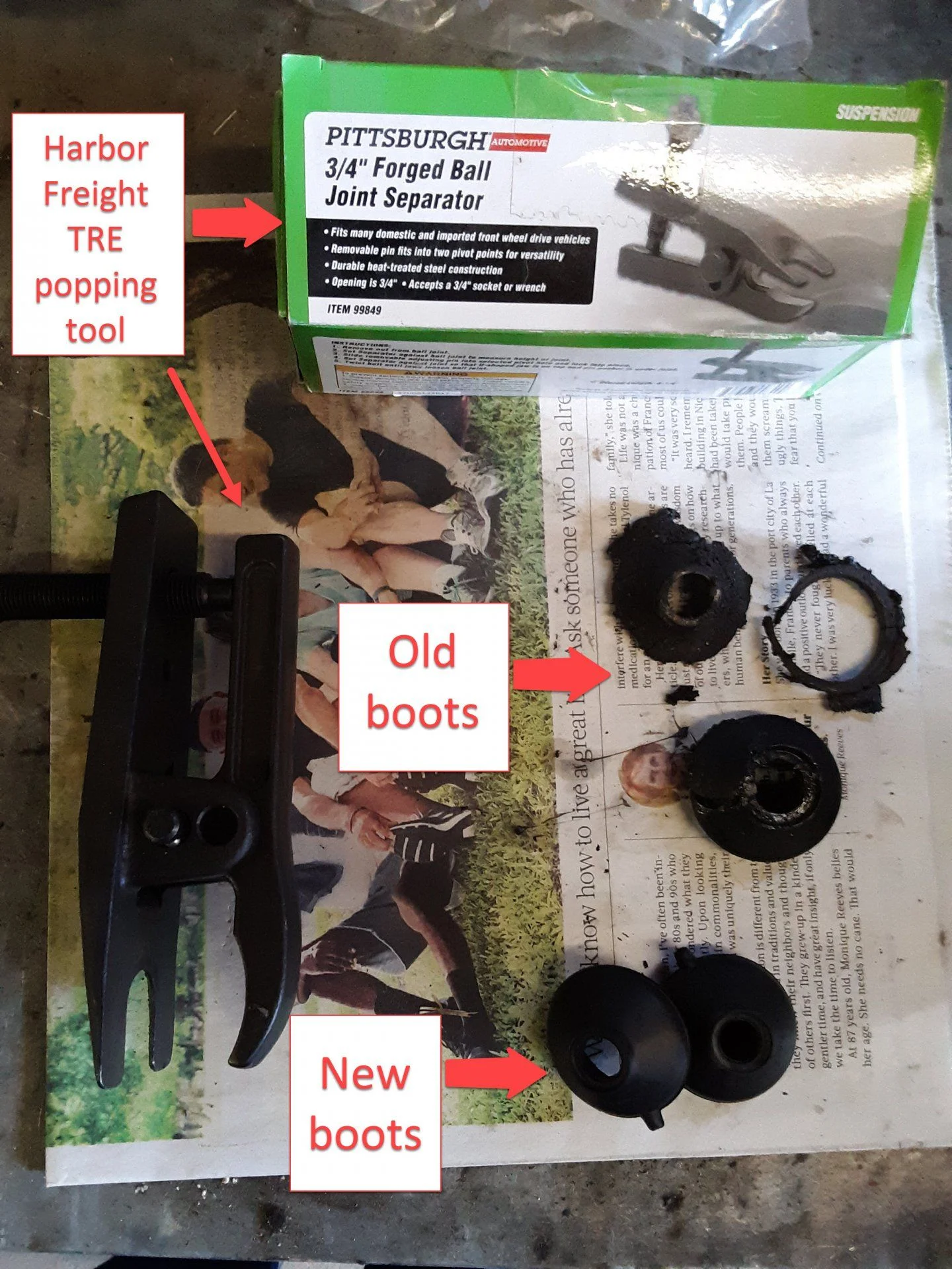

New TRE boots after 42 years. The Harbor Freight ball joint separator tool works FAR better than most HF tools - really slick, and no joint or boot damage, and the tool is precisely made.
Toyota boot part number is 45479-30030 and are ~$11 each.
