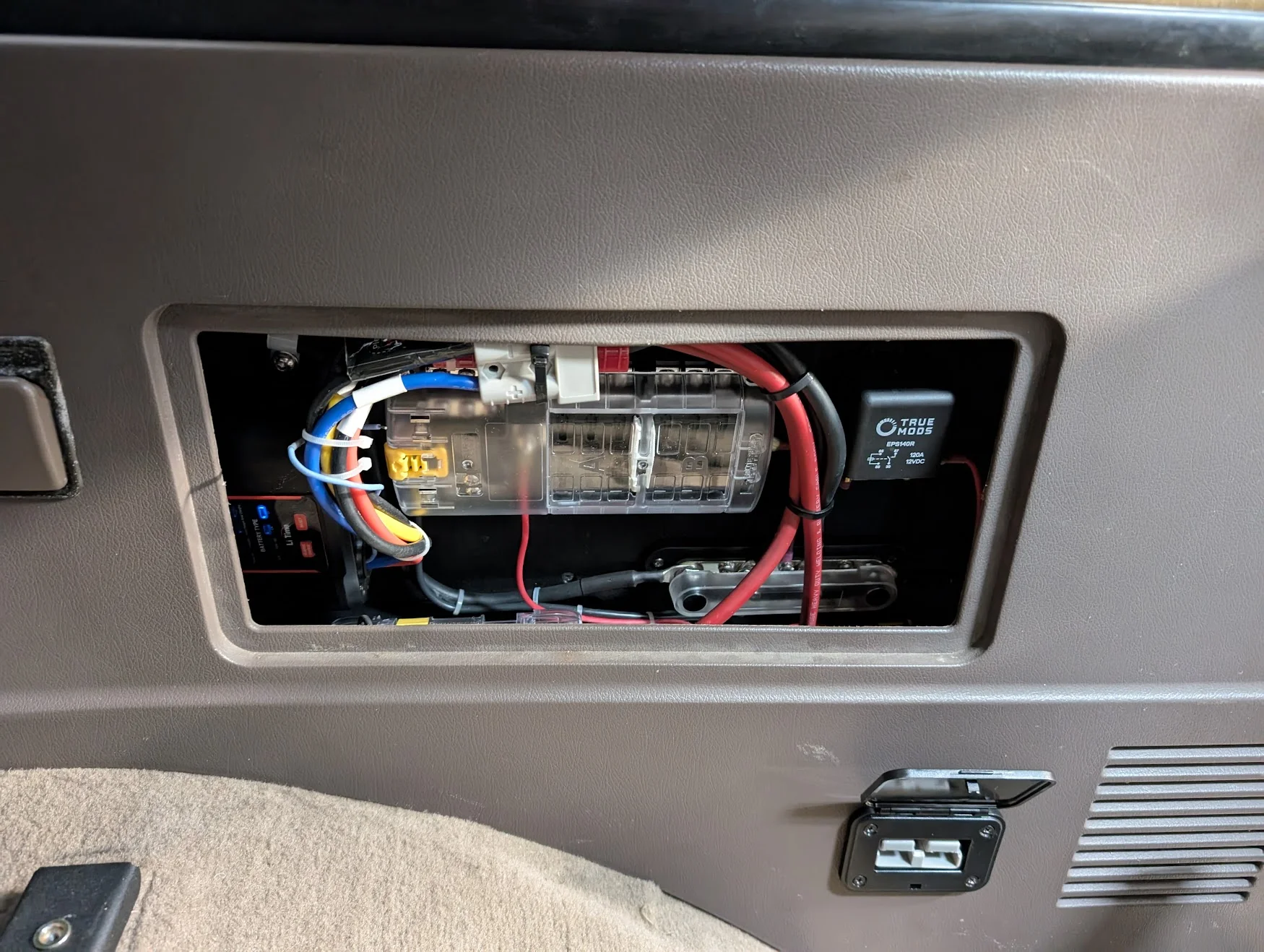

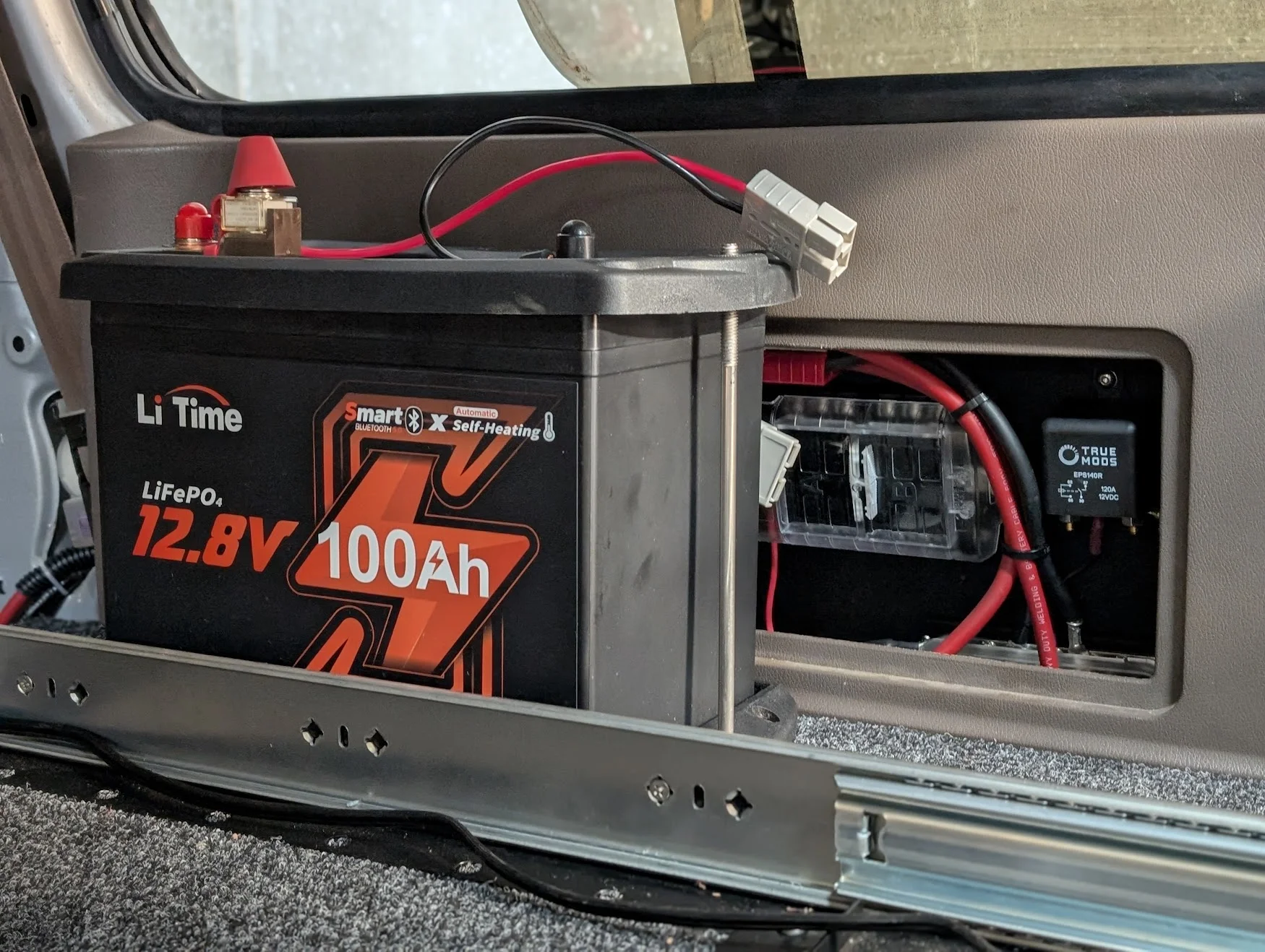

Installing DeltaVS QPM. Blue tape locates the cubby on the LX450 trim (left), and where I want to put an external switch panel (right). I am putting the fuse panel behind the cubby door for access, as well as one end of the DC to DC convertor. It has buttons to change modes, and initiate charging the starting battery.
Rivnuts going in. DeltaVS use much nicer rivnuts than what I use.
Pulled it back out to install the DC to DC converter, fuse block, and fuse panel, and 120A relay (triggered by ACC).
Blue Sea components, and LiTimes DC to DC Charger/MPPT and LiTimes 12V 100Ah battery.
Still waiting on stuff to finish up.

did you leave the plastic panel off leaving the RQPM open? if so how does it look with your drawer kit?
The plan is for the trim panel to be reinstalled.
I just happen to be test fitting today... all fuses accessible.
As shown in the above image, I am using a 120 Amp Anderson plug, lower right, to transfer power from the electronics mounted on the QPM to the battery.
Here is what it looks like with the drawer sideboard installed with the trim in place. The 120 Amp Anderson plug is hidden below the side board, and 6 AWG cables come up through a pre-existing hole in the sideboard (not shown). The anderson plug in the above image is just a 50 Amp plug used for the 120V AC to DC charger.
Nice location for the box.
Super clean install. That looks great.

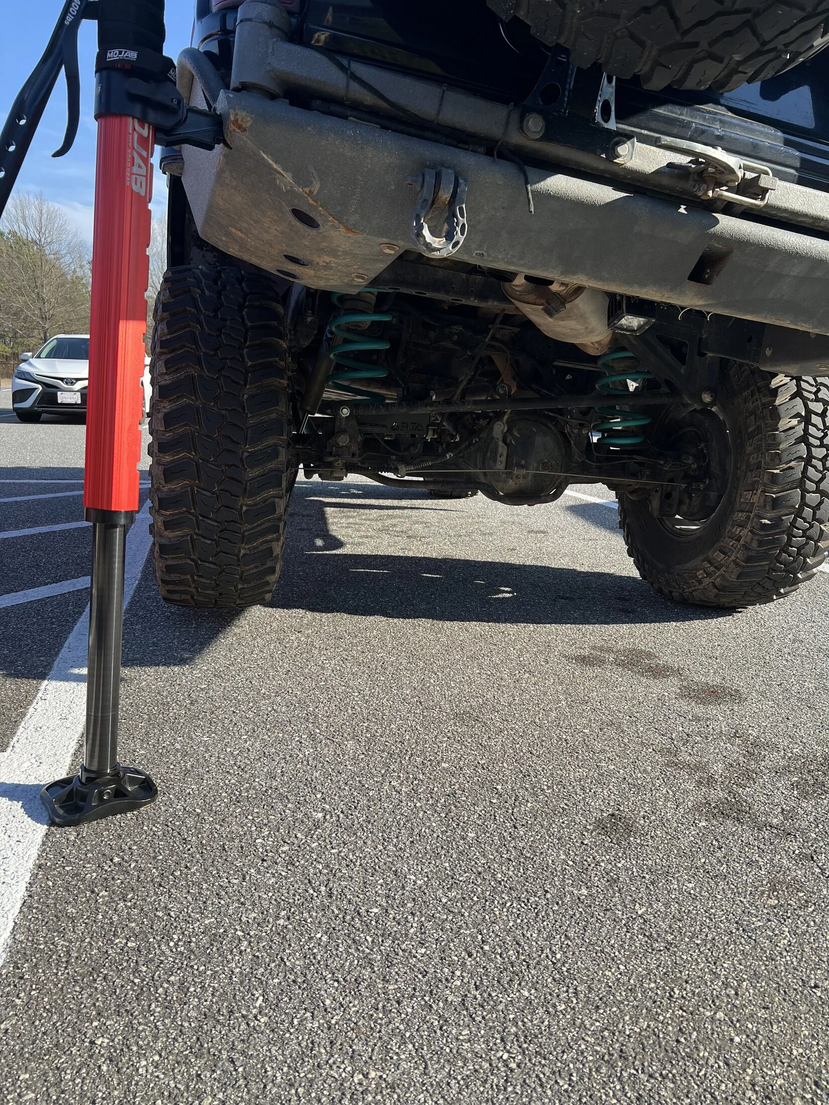

Swaped out the springs from a budget OME and spring packer setup done by the PO.
Swapped in some gently used Slinky heavies thanks @dogfishlake for putting them up for sale as take offs from a project of his. Shocks are still being debated. Also swapped the front panhard for an adjustable unit.
Picked up about an 1 1/2 in the front and 1 3/4 in the rear and now barely clears the garage door so long as I am selective with the angle I approach at.
